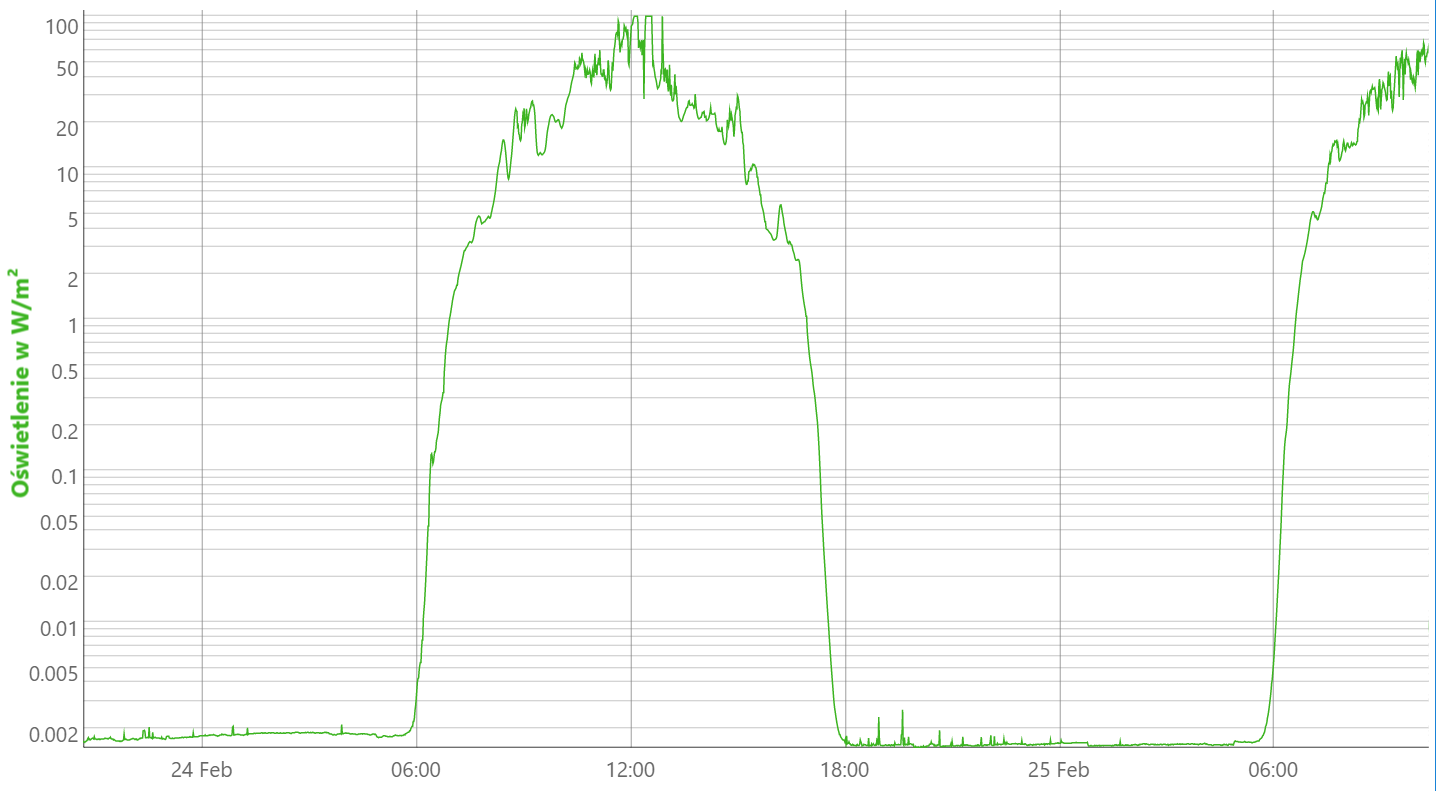

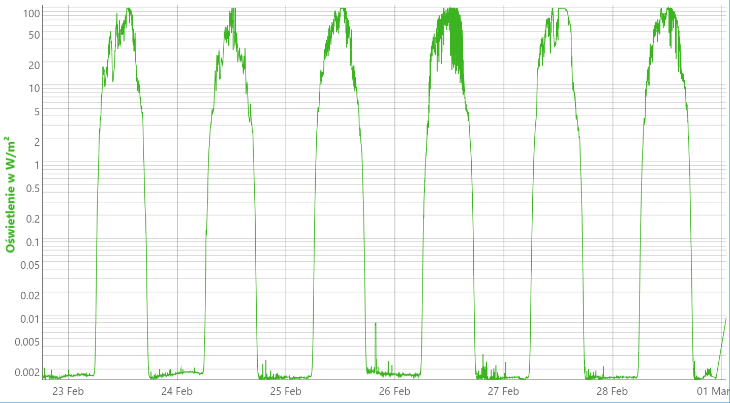

    If battery power is required, Bluetooth Low Energy, also available on Android, can be used. It has a comparable range to WiFi. There are also solutions that use BLE to create MESH networks. There are also ESP32 chips that support BLE and WiFi at the same time. In your query you also mention the CC2530 which is Zigbee. So the possibilities are many.
    You also mention a 'light sensor with ADC'. If this is to be used to measure light intensity then the matter is not as trivial as it may seem. I have such small sensors with a BLE interface and an OPT3002 chip. This chip has a 23-bit ADC. So the dynamic range is very high. In practice, however, the lighting changes to an even greater extent. See how it looks outside in the city centre, for example. The sensor was lying on a windowsill on the first floor.

    It is not known, for example, how fast the whole thing is to work and how often data is to be transmitted. It is not known what the reliability of information delivery is to be. There are formal restrictions on transmitter power, bandwidth utilisation factor, etc. These vary according to the purpose of the system. It is not possible to indicate an optimal solution on the basis of such scanty information as you have given.
    Creativemind wrote:
    simply the signal from the already finished sensor transmits a value between 0 and 999 in digital form.
    Note that the scale on the graph I have given is logarithmic. The values on it change from 1 to at least 100000. In the real world, the dynamics of change are even greater. The human eye can adapt to this. Measuring, for example, the photodiode current over such a range is not a simple problem. It cannot be done with a simple ADC. Regardless, there is still the question of the different sensitivity of the eye and optoelectronic components for different parts of the spectrum.
    You have not written what this is to be used for and what measurement range is required. A lot depends on this.
