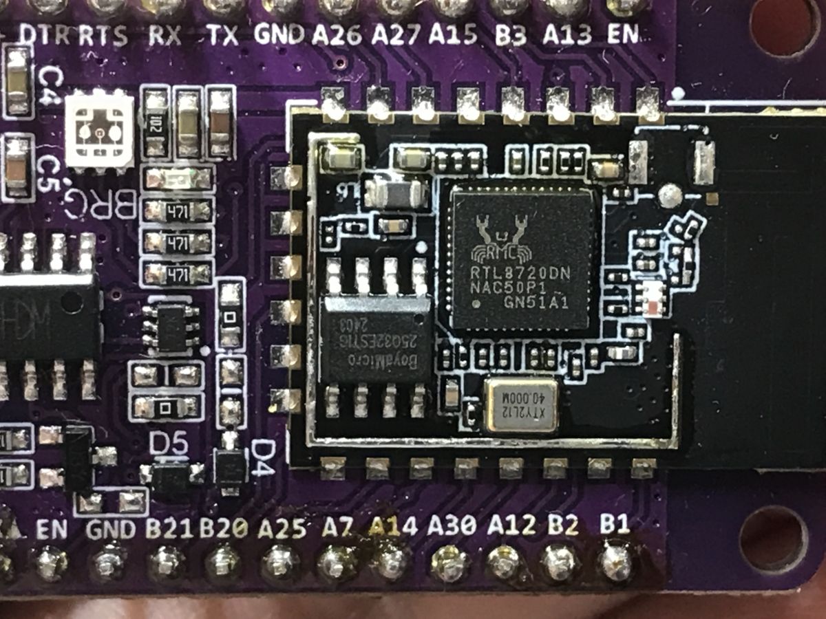

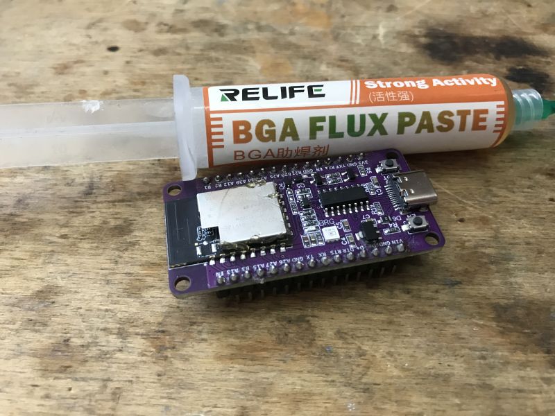

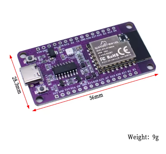

    I've been recently experimenting with simple flashing code for BW16E (RTL8720DN AmebaD) board, in theory also working for any of RTL872xDx family. RTL8720DN is a WiFi (2.4GHz and 5GHz) and Bluetooth (LE 5.0) module that features dual core CPU using KM4 and KM0 cores. It can be bought for as low as 1$. Here I will show my experiences with programming this board and briefly describe the flashing process.
    Creating a simple BW16E (RTL8720DN) DIY flash tool command line utility Creating a simple BW16E (RTL8720DN) DIY flash tool command line utility
    The goal of this topic will be to create a simple C# flash tool that can write OpenBeken firwmare port to RTL8720DN.

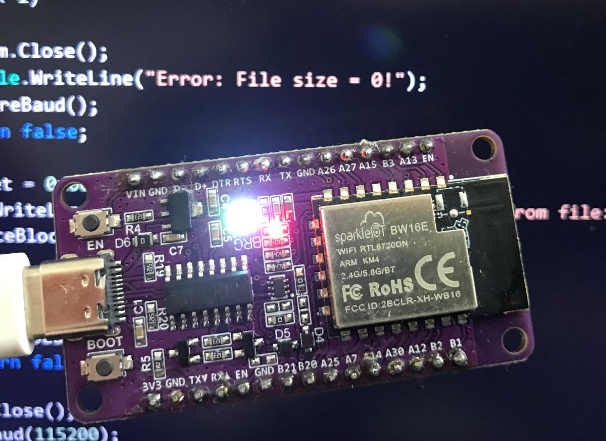

    BW16E board, like many other boards, features RESET and BOOT pins. They are controlled via CH340 DTR and RTS lines. Boot must be held low while RESET is released in order to enter flashing mode.

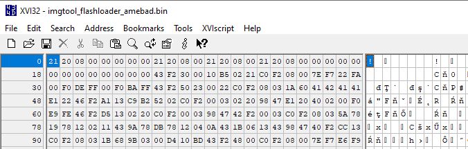

    Writing RAM code
    To communicate with flash memory, a helper binary (imgtool_flashloader_amebad.bin) must be uploaded into MCU SRAM. This file contains the flashloader used by Realtek’s official tools. Before uploading, the flasher checks whether the RAM already contains a valid loader by examining the first 4 bytes. If not present, the file is sent using XMODEM protocol.
    Code: C#
    NOTE: 33 dec is 0x21 hex, and so on.

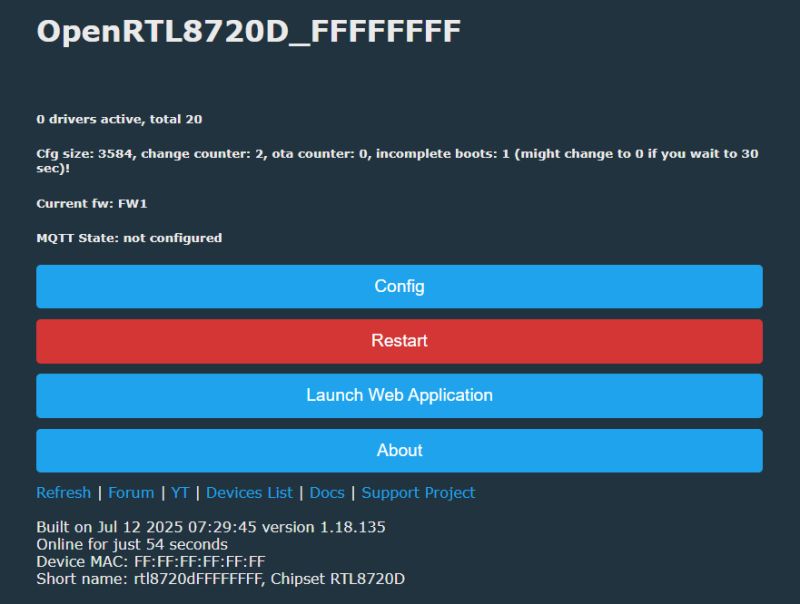

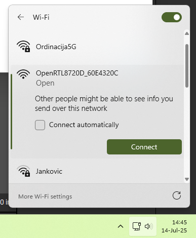

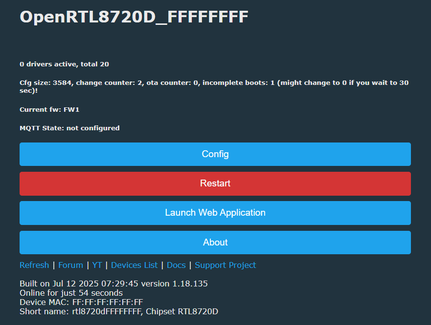

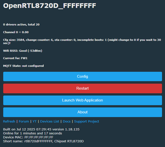

    OpenBeken then should be able to boot:

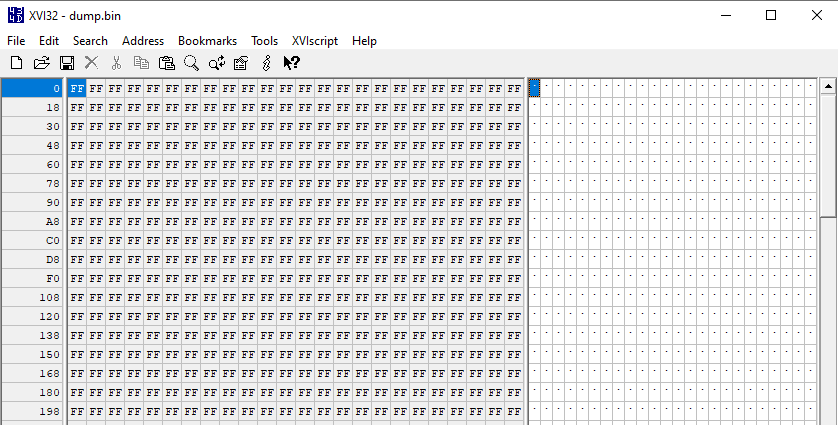

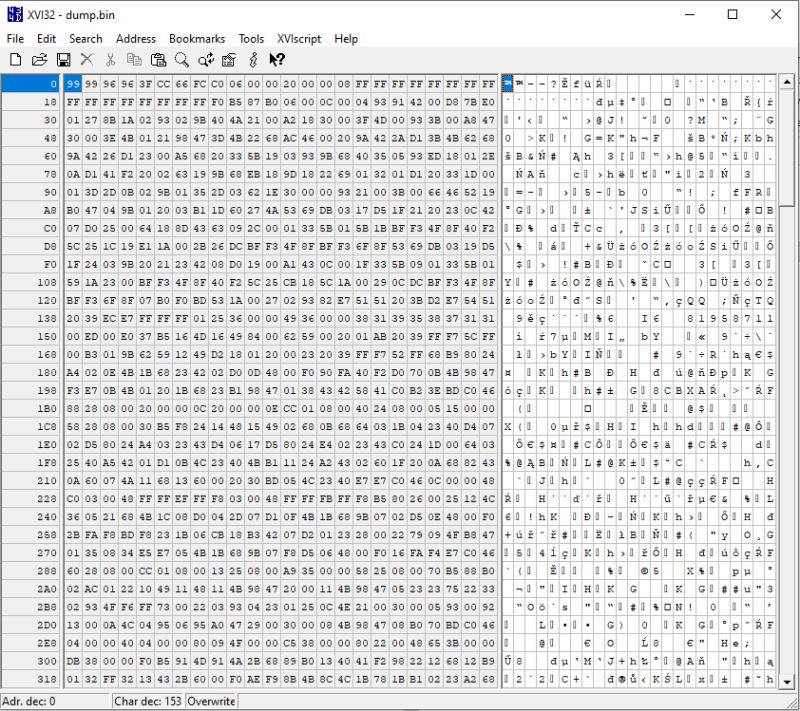

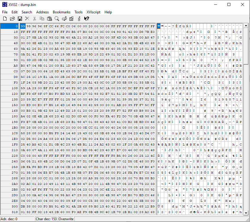

    For a simple test, try erase_4096.cmd and then read_4096_dump_bin.cmd, you should get:

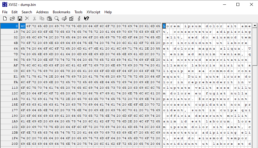

    After doing write_lorem_ipsum.cmd the read_4096_dump_bin.cmd should give:
    Similary, read back after write_obk.cmd should show:
    This way you can reliably check whether read and write works.

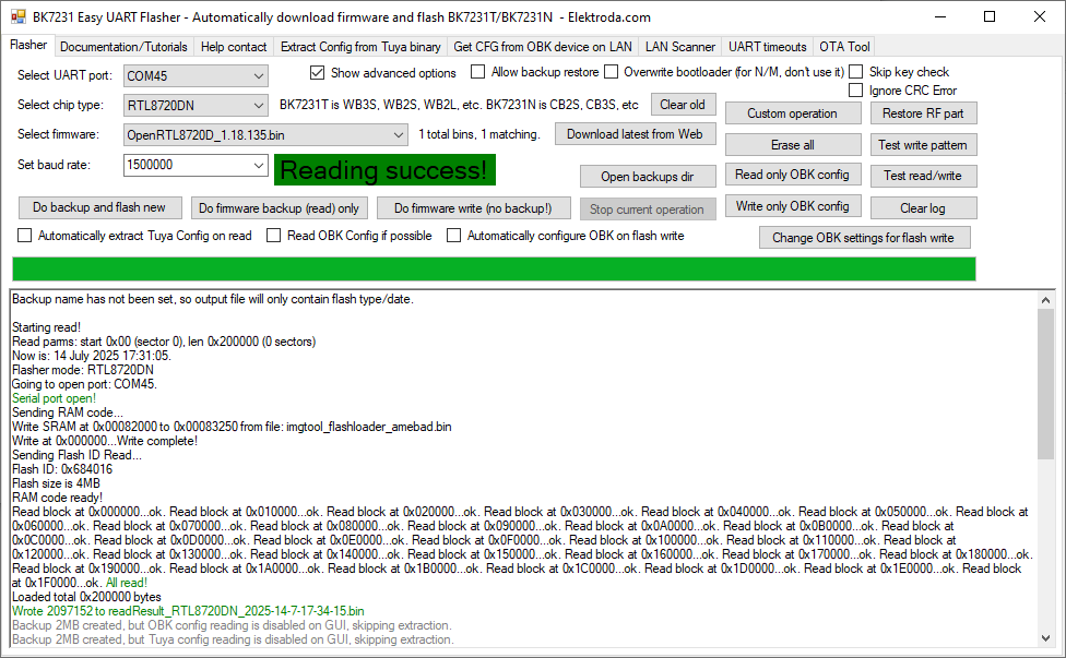

    RTL872xDx_Flasher.exe -p COM45 -b 1500000 rf 0 0x400000 dump.bin
    success.

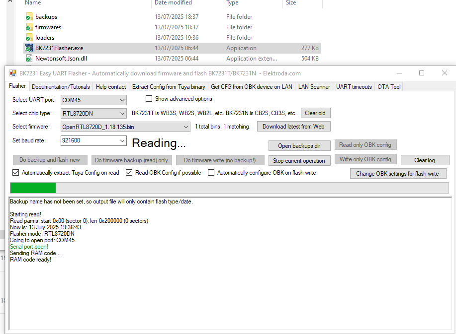

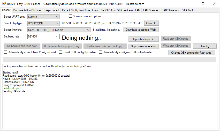

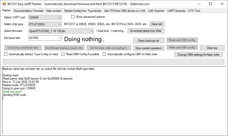

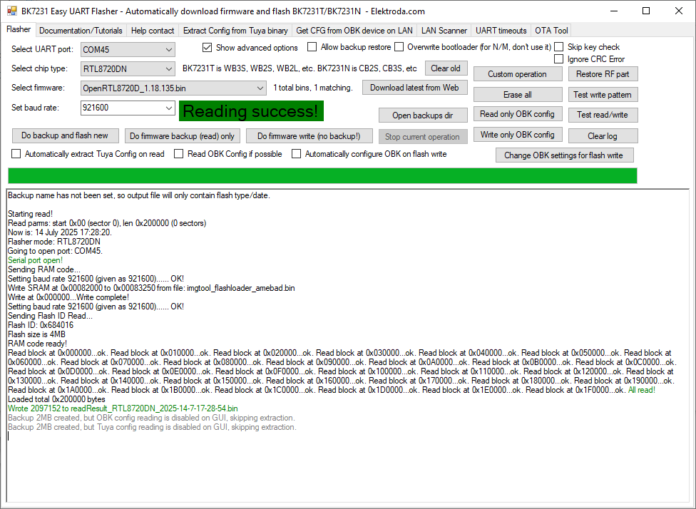

    With EF v24 the RTL8720DN read currently makes EF quit when sending stub
  • #3 21605829
    Posts: 14770
    Rate: 12913
    What? Easy Flasher can't read RTL? Let me check...
    Ah wait, you don't have stub!

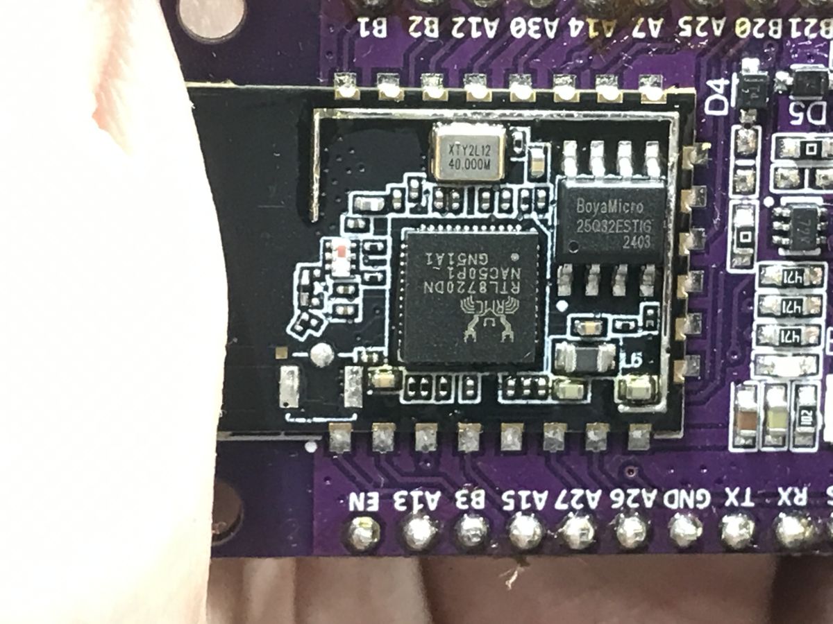

  • Flash type and size by RTL chip suffix
    #12 21606055
    insmod
    Posts: 1432
    Help: 168
    Rate: 455
    Usually, if chip last letter is F - means embedded flash, M - external.
    All RTL8710B have external flash.
    Almost all RTL8720D/CS except RTL8720DF (4mb), Normal BW16 usually comes with 2MB flash chip, which i successfully replaced with 4MB on one module. WBRG1 of course comes with 8MB.

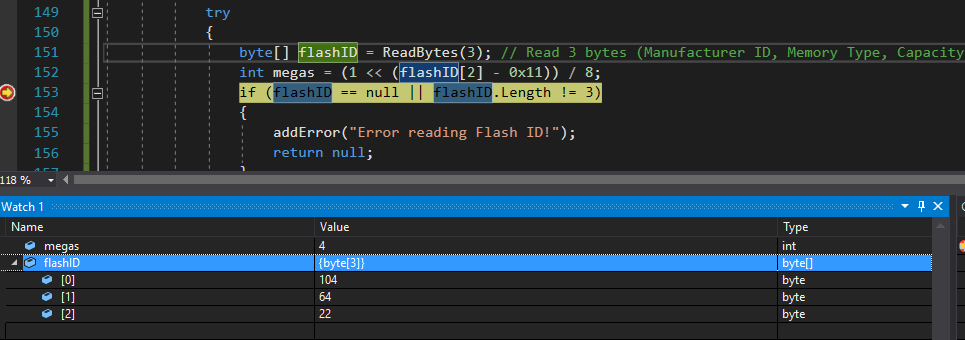

  • Need auto-detection of RTL flash size
    #13 21606153
    Posts: 14770
    Rate: 12913
    So if I unshield the board from the topic, then I can give it like 8MB flash or something, like it's often done with ESP? Nice, gotta try someday.

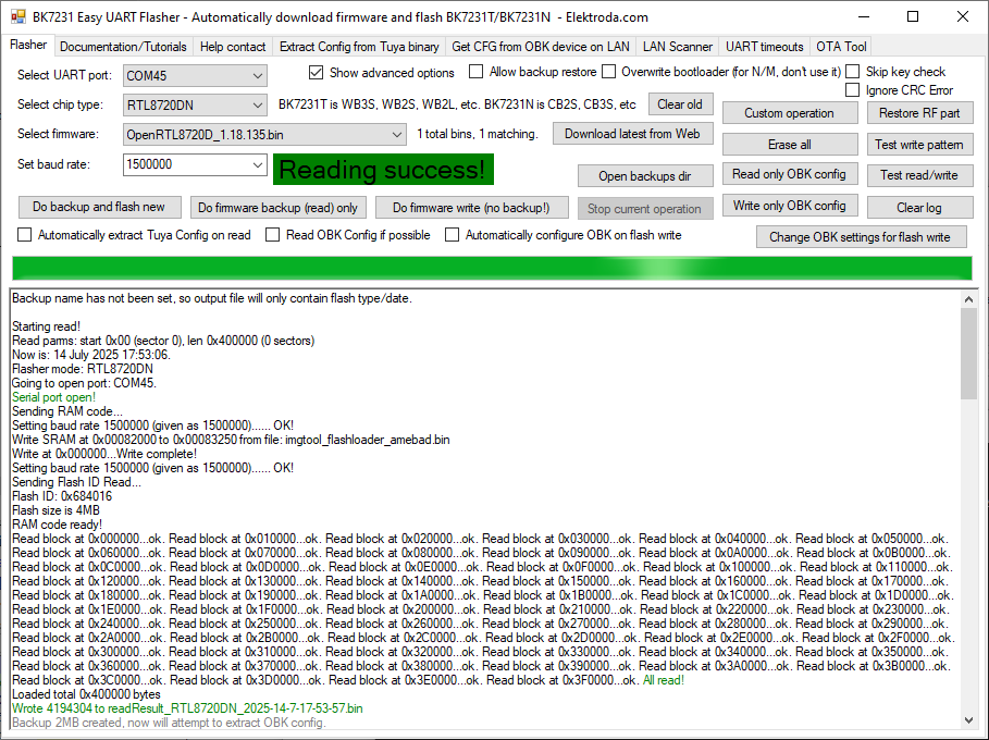

    Easy Flasher progress report - read and write are almost fully integrated now. There are still some issues coming from the fact that tool was designed with only Beken in mind, but hopefully I will manage to tidy it up a bit more.
    We need to check is there a way to auto-detect RTL flash size.
    #14 21606159
    insmod
    Posts: 1432
    Help: 168
    Rate: 455
    >>21606153
    Can you somehow get flash id?
    If so, then do it like i've done on RTL8721DA (1 << (flash_ID[2] - 0x11)) / 8
    Same method can be applied to beken (like those 4mb BK7252)
  • #15 21606173
    Posts: 5220
    Help: 449
    Rate: 918
    definitely +1 on this. otherwise users will only get half or quarter backup depending on device. custom read or another tool becomes the favourable option in this case.
    also. BK7252N/BK7252U split..? :)

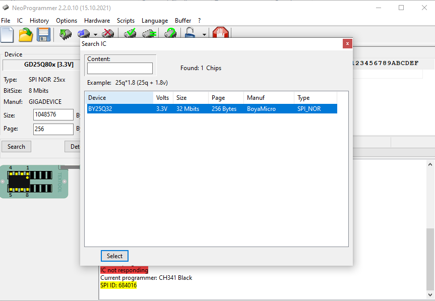

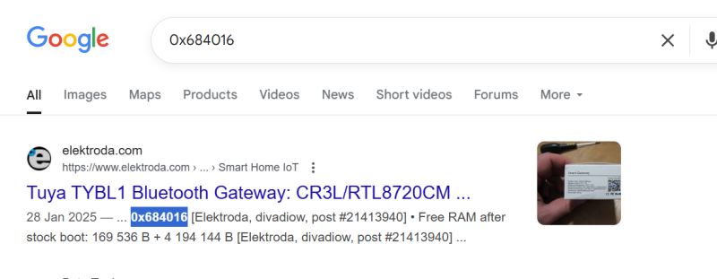

  • SPI flash ID read returns 0x684016 on BW16E
    #16 21606205
    Posts: 14770
    Rate: 12913
    Is there anyone with 2MB version of this RTL?
    I had a weird idea, because I did this SPI driver from previous article, you know?
    https://www.elektroda.com/rtvforum/topic4129001.html
    And I tried to use this CMD_GFS to plug classix 0x9F command from SPIs...
    Code: C#
    Here's what I got:
    0x684016
    Huh
    I tried the first random idea and it seems to work? What's the chance of that?

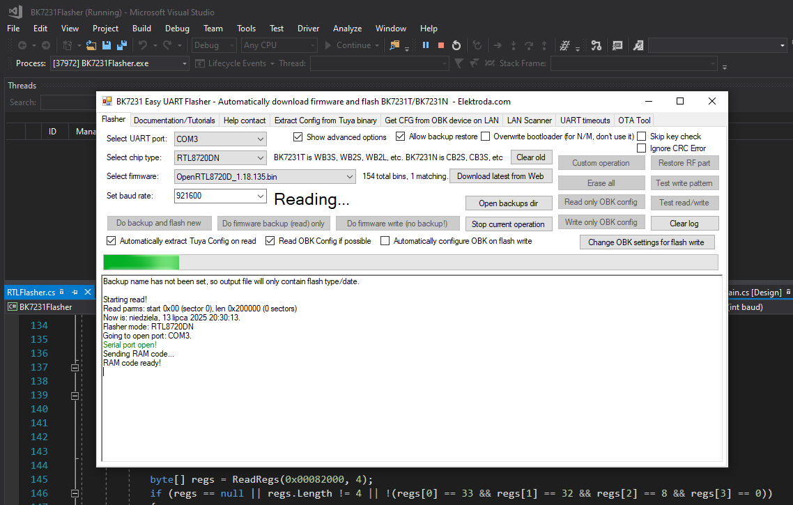

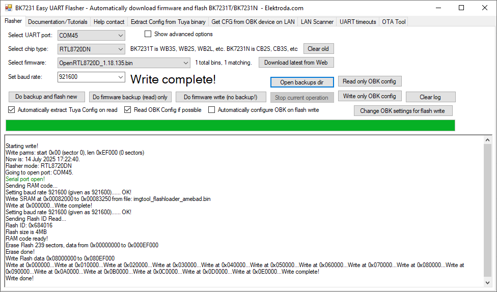

  • NeoProgrammer confirms flashing works after loading RAMCode
    #18 21606258
    Posts: 14770
    Rate: 12913
    I will push code in a moment.
    I just HAD to check.
    Added after 49 [minutes]:
    @insmod here: https://github.com/openshwprojects/BK7231GUIFlashTool binary should be ready soon.
    @divadiow if you can, keep an eye for Beken flashing, I hope I didn't break anything.
    I've did more checks and it seems that this really works, NeoProgrammer confirms, and btw, it only works after loading RAMCode

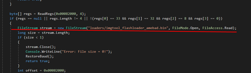

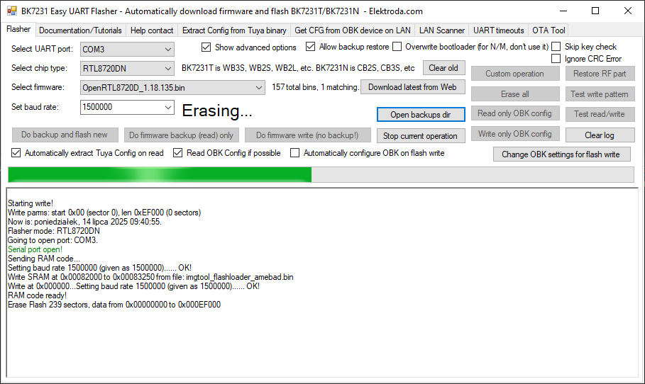

  • Embed the 5 KB flashloader in code
    #19 21606319
    insmod
    Posts: 1432
    Help: 168
    Rate: 455

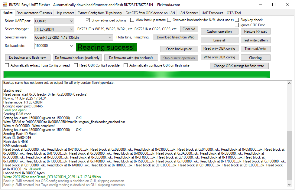

    2mb ok
    Serial port open!
    Sending RAM code...
    Setting baud rate 1500000 (given as 1500000)...... OK!
    Write SRAM at 0x00082000 to 0x00083250 from file: imgtool_flashloader_amebad.bin
    Write at 0x000000...Write complete!
    Sending Flash ID Read...
    Flash ID: 0x684015
    RAM code ready!
    Read block at 0x000000...ok. Read block at 0x010000...ok. Read block at 0x020000...ok. Read block at 0x030000...ok. Read block at 0x040000...ok. Read block at 0x050000...ok. Read block at 0x060000...ok. Read block at 0x070000...ok. Read block at 0x080000...ok. Read block at 0x090000...ok. Read block at 0x0A0000...ok. Read block at 0x0B0000...ok. Read block at 0x0C0000...ok. Read block at 0x0D0000...ok. Read block at 0x0E0000...ok. Read block at 0x0F0000...ok. Read block at 0x100000...ok. Read block at 0x110000...ok. Read block at 0x120000...ok. Read block at 0x130000...ok. Read block at 0x140000...ok. Read block at 0x150000...ok. Read block at 0x160000...ok. Read block at 0x170000...ok. Read block at 0x180000...ok. Read block at 0x190000...ok. Read block at 0x1A0000...ok. Read block at 0x1B0000...ok. Read block at 0x1C0000...ok. Read block at 0x1D0000...ok. Read block at 0x1E0000...ok. Read block at 0x1F0000...ok. All read!
    Loaded total 0x200000 bytes
    Maybe instead of loading amebad flashloader from disk, just convert it to bytes and store it in code? Its only 5kb.

    I didn't do automatic size determination yet, it always reads 2MB. The only thing you can check so far is whether flash ID read works.
    I can see in your log that it recognized your flash ID as 0xEF4016, so I guess it works. I can move to the next step and use it to set flash size for the operations.
  • Embed flashloader bytes in code

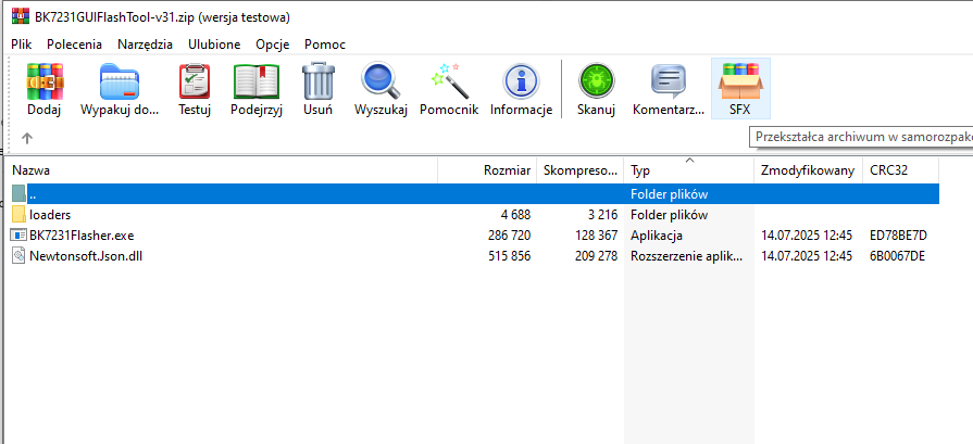

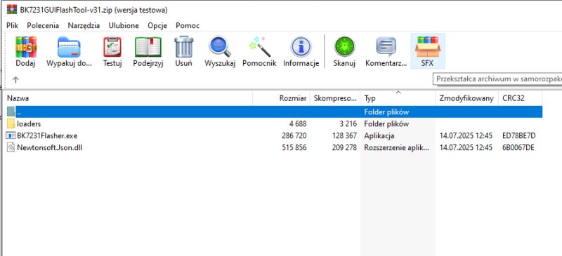

  • Include upload stub in release build
    #22 21606338
    Posts: 14770
    Rate: 12913
    I wanted to just copy that uploading stub from repository to Release archive, but for some reasons nothing is copied - ideas?

    Ah wait... I can see the issue... it's probably there:
    Code: YAML
    I can just add copy command to Easy Flasher as well, so stub is included in releases
  • #24 21606388
    Posts: 14770
    Rate: 12913
    Loaders are now included in zip:
  • RTL8720DN 4MB OBK write and EF backup verified
    #25 21606622
    Posts: 5220
    Help: 449
    Rate: 918
    v32 - RTL8720DN 4MB. OBK write.
    EF Backup @1500000
    EF Backup @921600
    EF Backup @115200

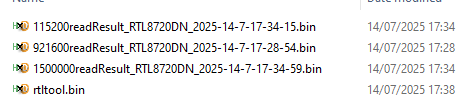

    all compare as identical to rtltool script backup (truncated to 2mb for comparison)
  • #26 21606636
    Posts: 14770
    Rate: 12913
    Thx, keep in mind that it will probably not boot OBK when second firmware partition contains garbage, so erase all is required first, just like rtltool.
  • #27 21606640
    Posts: 5220
    Help: 449
    Rate: 918
    4mb custom read EF/rtltool
    identical
