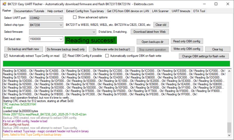

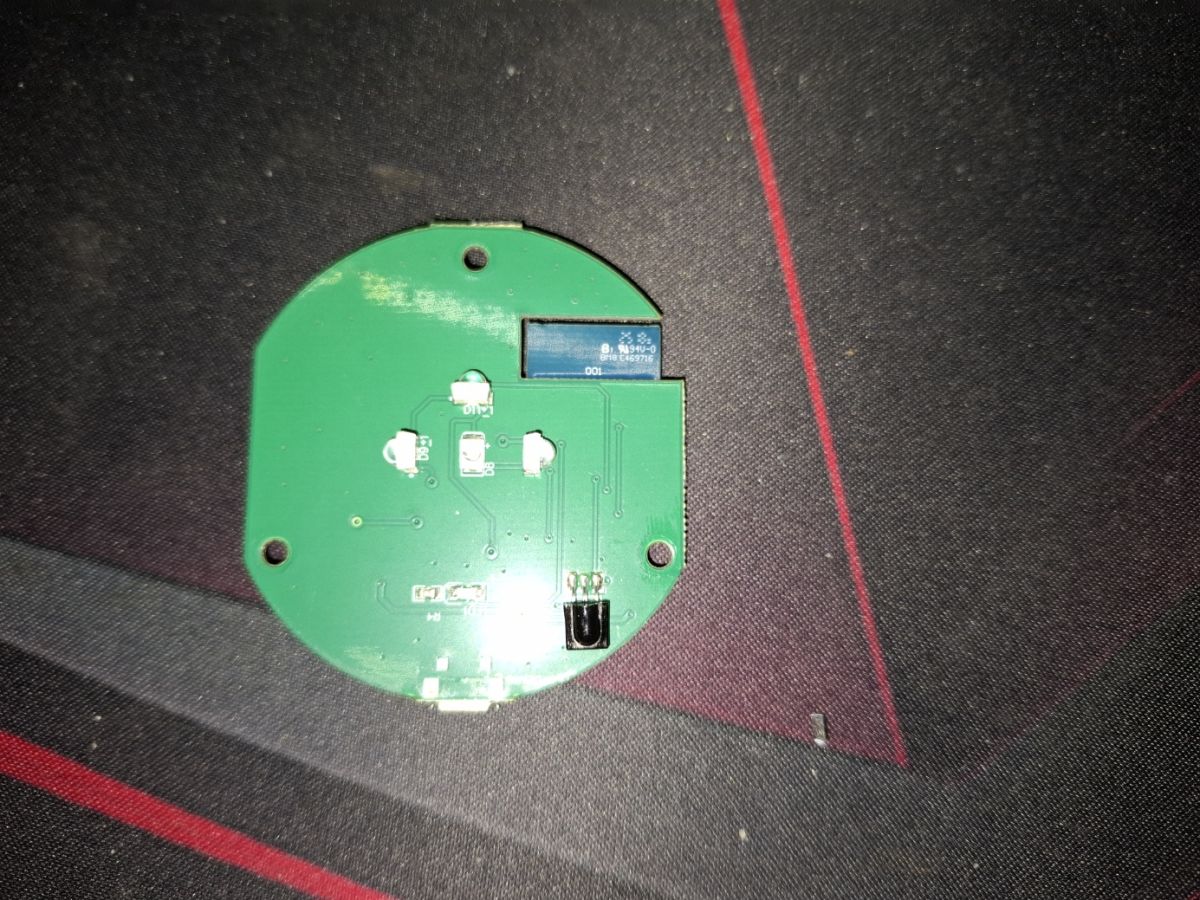

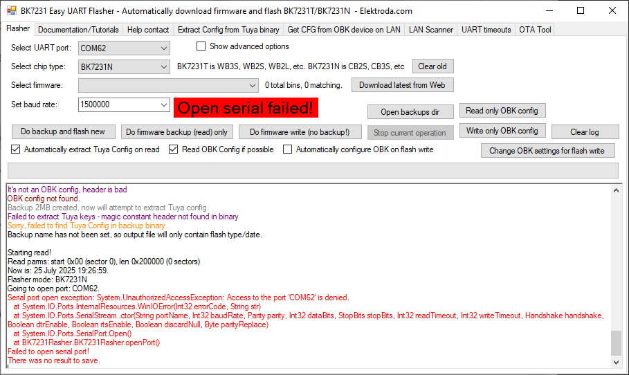

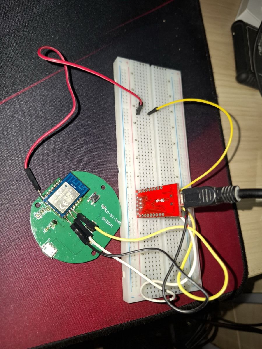

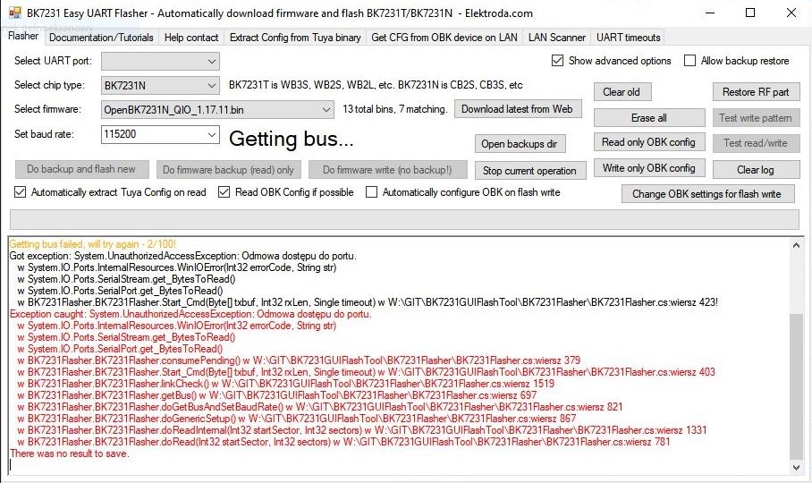

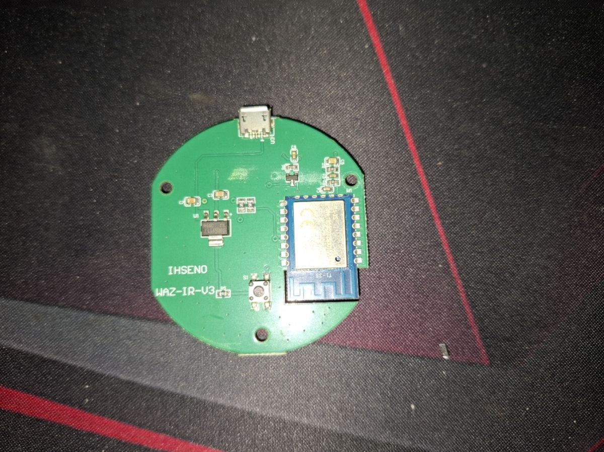

    I purchased the Tuya WiFi IR universal remote control . Upon opening the device, I encountered this measure
    Internal view of a Tuya IR remote's PCB with T1-3S module exposed .
    WAZ-IR-V3 PCB with Wi-Fi module and microUSB connector .

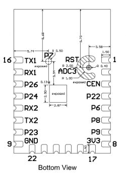

    T1-3S module. I don't know if it is supported by OpenBeken.

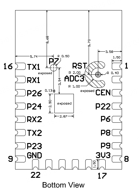

    I found documentation of the module , and link to Chip .
    When connected to TX2 and RX2 something like this appears in the terminal:

    Something like this:
    Screenshot of BK7231 Easy UART Flasher showing port access denied error during operation. .
  • #5 21617011
    Posts: 14755
    Rate: 12878
    This is more like user error. Something happened that the USB to UART converter was disconnected or overloaded. How do you connect it?

    Help: 45
    Rate: 206
    I unplug the power supply
    Breadboard with ESP-12 on PCB connected via jumper wires to USB-UART converter .

    EF v49 does work OK dumping BK7238
    Screenshot of BK7231 Easy UART Flasher with “Reading success!” message
    your com port is already open in another app?
    I get this if mine is.
    Open serial failed! error in BK7231 Easy UART Flasher on COM62 port

    are you getting the windows eject sound? are you connecting USB-TTL, 3.3V PSU and module grounds together? what does your wiring look like?
  • #8 21617036
    Posts: 14755
    Rate: 12878
    And the power supply by feeding 5V to the LDO input on the board? Or by feeding 3.3V from the USB to UART converter to the 3.3V of the WIFi module? The USB to UART converter does not have enough current capacity to power the WIFi module. And shorten the wires. Try in BK7238 mode.

  • Connected to TX2/RX2 instead of TX1/RX1
    #10 21617081
    Posts: 5209
    Help: 446
    Rate: 914
    it looks like you are connected to TX2/RX2, not TX1/RX1
    Bottom view of IC with labeled UART1 and UART2 TX/RX pins and other signal names
  • #11 21617089
    Nargo
    Posts: 495
    Help: 45
    Rate: 206
    Nothing appears on tx1/rx1. But will try it tomorrow.

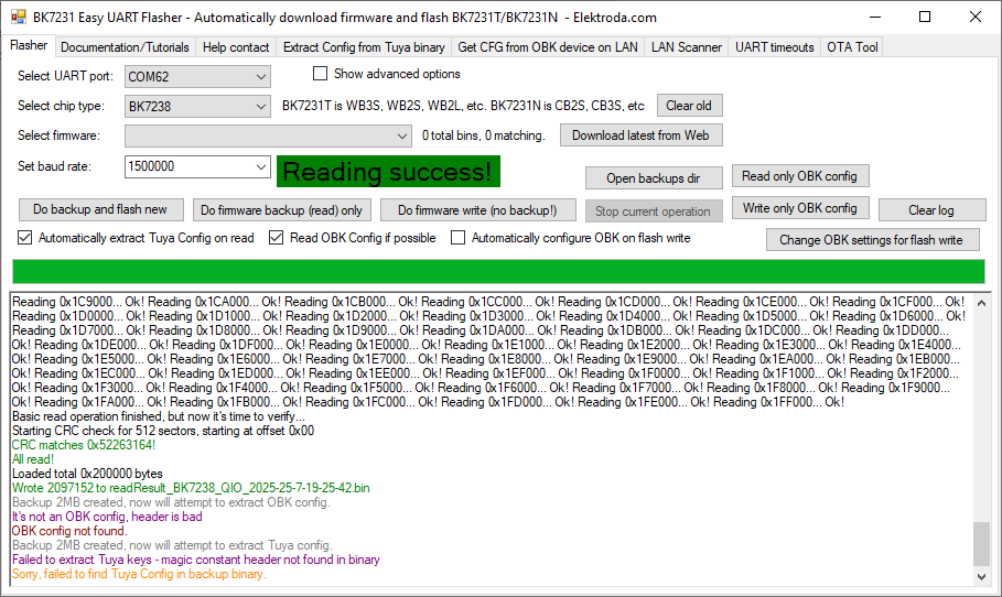

  • #13 21617307
    Nargo
    Posts: 495
    Help: 45
    Rate: 206
    Enclosed is what it reads from UART1
    • readResult_BK7238_QIO_2025-26-7-10-00-56.bin (2 MB) You must be logged in to download this attachment.

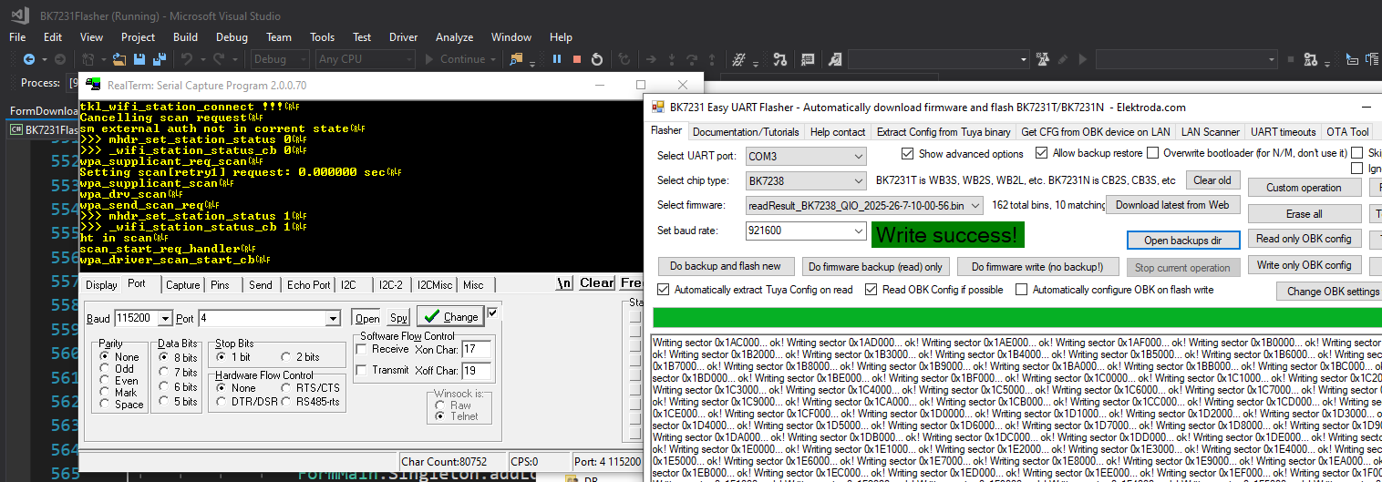

    #14 21617314
    Posts: 14755
    Rate: 12878
    What was wrong?
    Your batch runs on my BK7238:
    Screenshot of RealTerm and BK7231 Flasher showing firmware write success on BK7238. .
    Boot log:

    Writing sector 0xD4000... Writing sector 868352 failed!
    Writing file data to chip failed.
    Writing sector 0xDA000... Writing sector 892928 failed!
    Writing sector 0xD6000... Writing sector 876544 failed!
    Same every time.
    When I try to restore the backup it also gives me errors.
  • #18 21617402
    Posts: 14755
    Rate: 12878
    In a random location? Then try a different baud.
  • #19 21617407
    Nargo
    Posts: 495
    Help: 45
    Rate: 206
    Sprawdzane 115200,230400,921600,1500000.
    Overwrite on/off too.
  • #20 21617409
    Posts: 14755
    Rate: 12878
    Another usb to uart converter? shorter cables? Or is TX1/RX1 being used for something on this board and interfering with something?

    Serial port open exception: System.IO.IOException: The device attached to the computer is not working.
    w System.IO.Ports.InternalResources.WinIOError(Int32 errorCode, String str)
    w System.IO.Ports.SerialStream.InitializeDCB(Int32 baudRate, Parity parity, Int32 dataBits, StopBits stopBits, Boolean discardNull)
    w System.IO.Ports.SerialStream..ctor(String portName, Int32 baudRate, Parity parity, Int32 dataBits, StopBits stopBits, Int32 readTimeout, Int32 writeTimeout, Handshake handshake, Boolean dtrEnable, Boolean rtsEnable, Boolean discardNull, Byte parityReplace)
    in System.IO.Ports.SerialPort.Open()
    in BK7231Flasher.BK7231Flasher.openPort()
    Failed to open serial port!
    Will try from the laptop tonight.

    Interesting, when connecting UART1 to the converter without power (GND, RX and TX only) it pops up something like this in the terminal:
    [00][00]BK7238_1.0.14

    When it gets power (3.3v, GND, RX and TX) it throws this:
    [1B][32;22m[I/FAL] Fal(V0.4.0)success[1B][0m
    [1B][36;22m[I/OTA] RT-Thread OTA package(V0.2.8-beken-1133282d-20220604) initialize success.[1B][0m
    [1B][31;22m[E/OTA] (ota_main:178) App verify failed! Need to recovery factory firmware.[1B][0m
    go os_addr(0x10000)..........
    With this:
    ESP Prog USB programmer with UART interface, front and back views .
    BK7231Flasher does not work on any of my computers.

    And have you programmed other BK7231s from your PCs?
  • #23 21617748
    Nargo
    Posts: 495
    Help: 45
    Rate: 206
    CB2S and CBU modules
  • #24 21617773
    Posts: 14755
    Rate: 12878
    And the same setup worked?
    Do you have hot air?
  • #25 21617802
    insmod
    Posts: 1432
    Help: 168
    Rate: 455
    Why do all of this?
    AMS1117 is on board, just connect power via micro-usb.
    Remove 3.3v cable, keep RX, TX and GND. That should be enough.
  • #26 21617932
    Nargo
    Posts: 495
    Help: 45
    Rate: 206
    It was working until today.
    I have. I'll unsolder the module cover on Sunday if possible.
    insmod wrote:
    What is it all for?
    The AMS1117 is on board, just connect the power via micro-usb.
    Disconnect the 3.3v cable, keep RX, TX and GND. This should be enough.
    This is what I did as well.
  • #27 21618017
    Posts: 14755
    Rate: 12878
    I had indeed previously written about desoldering the module cover, but I have now changed my mind. As we already know it's a BK7238, and your dump at me starts on niceMCU, I'd suggest just desoldering the whole WiFi module and trying to program it off the board, powering it externally from 3.3V and making sure the wires are short.
  • #28 21618018
    Posts: 5209
    Help: 446
    Rate: 914
    What was wrong?
    One assumes the user switched to TX1/RX1. The pic shows TX2/RX2 soldered up.
    I don't fully understand what the issue is with flashing here. As @insmod says, any ambiguity around power can be removed by using the USB connector to device, as long as the grounds are common, this should be fine.
    Also, connect directly to USB-TTL instead of using breadboard?

    Module soldered out, cables 7 cm long connected directly to the converter, effect
    The beginning of buffer in UART contains  data.
    Writing sector 0xDC000... Writing sector 901120 failed!
