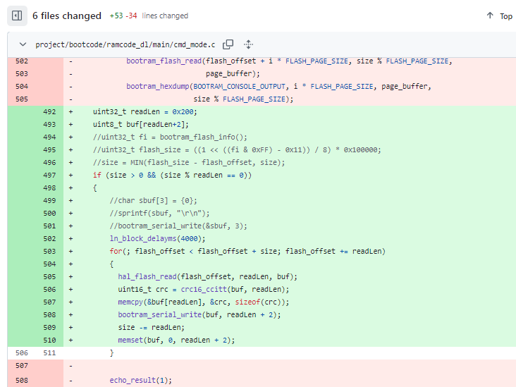

    This is very slow, but luckily, our contributor @insmod has recently changed the dump logic to use, among others, raw binary format:
    https://github.com/NonPIayerCharacter/OpenLN8...mmit/fc62bd2392bcd022b57b5ead14b04084a2456bfe
    LN882H UART flashing protocol documentation - Windows LN882H flasher with fast flash read
    The following code uses 16-bit CRC for error checking, which was already implemented in the SDK.
    Here is the matching flash read code on C# side:
    Code: C#
    As you can see, there is no more ASCII string processing and everything is done at raw bytes data. Futhermore, CRC check is also done to make sure that received data is correct.

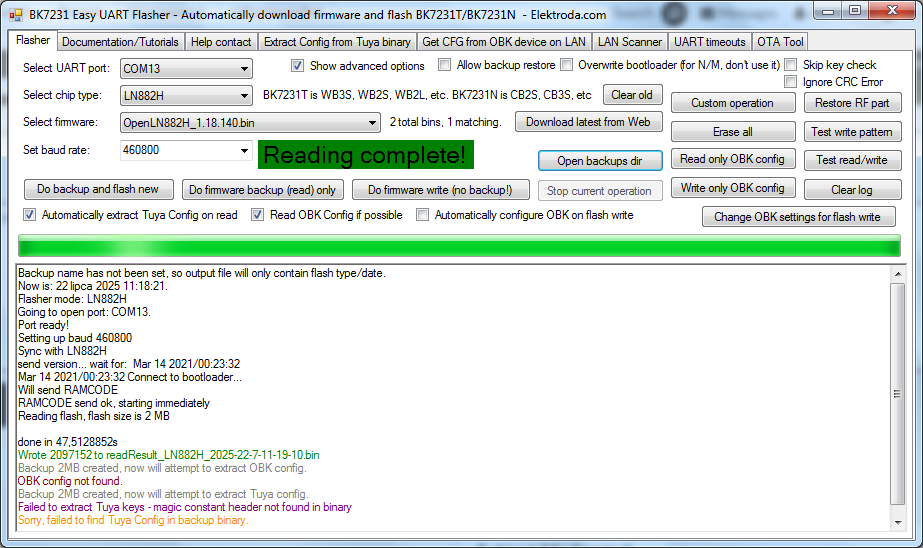

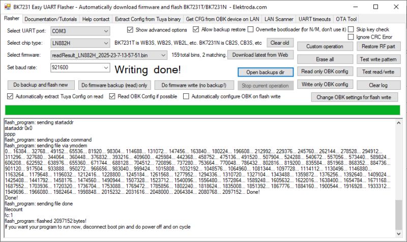

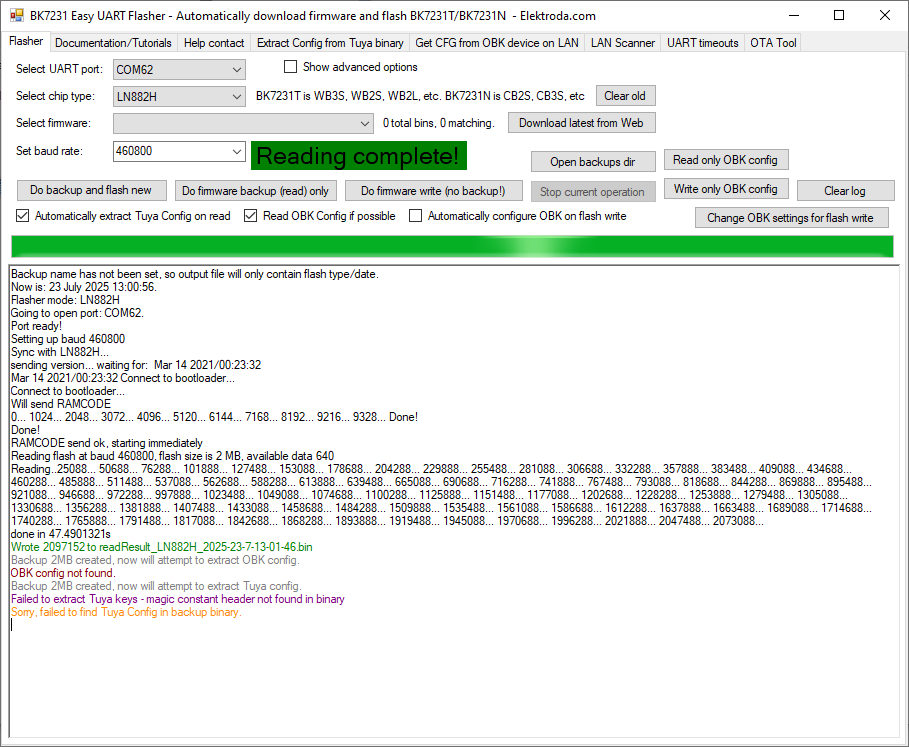

    Added after 2 [hours] 45 [minutes]:
    @divadiow reading works I think

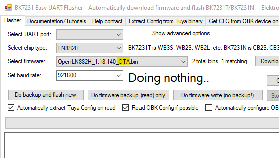

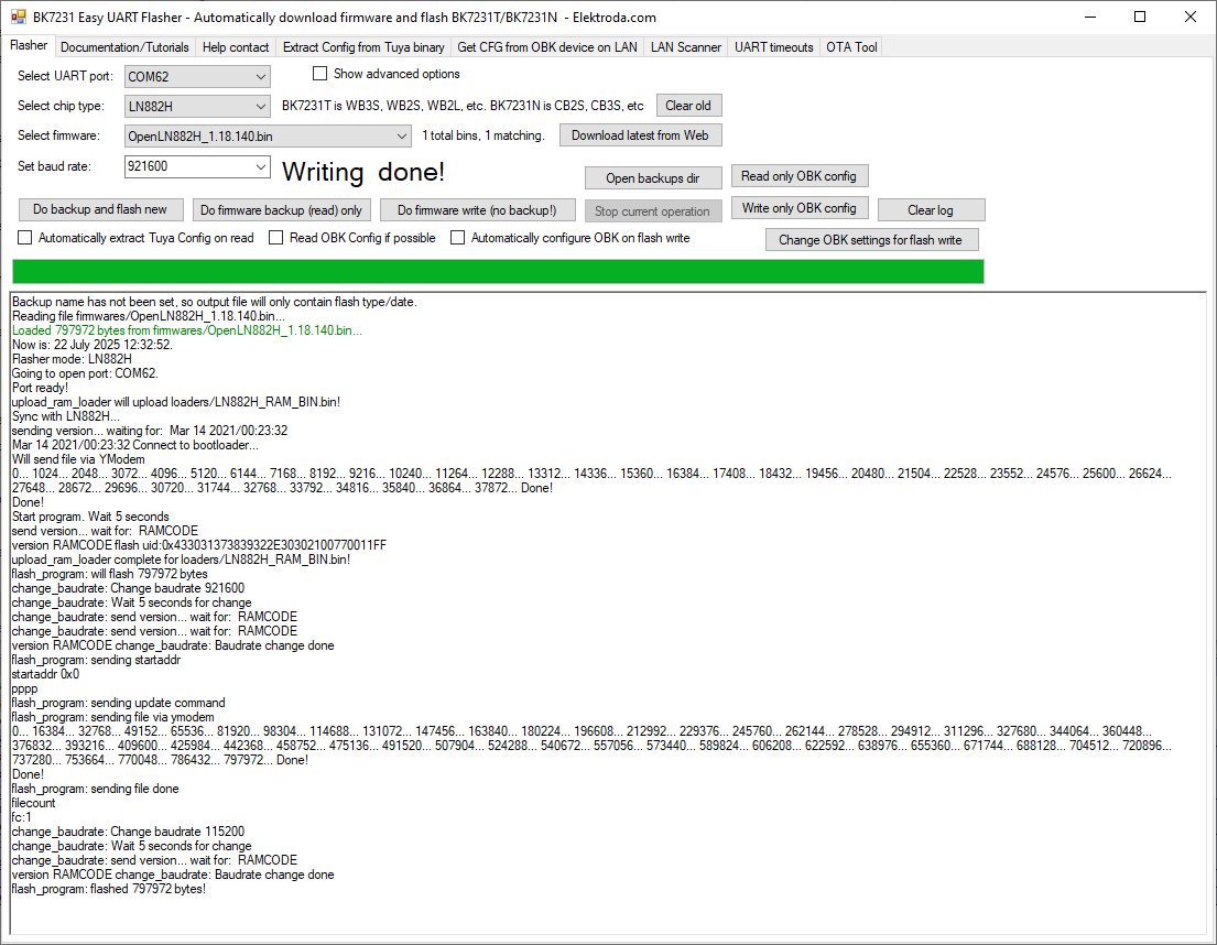

    Download: https://github.com/openshwprojects/BK7231GUIFlashTool
  • #4 21613443
    Posts: 5216
    Help: 448
    Rate: 917

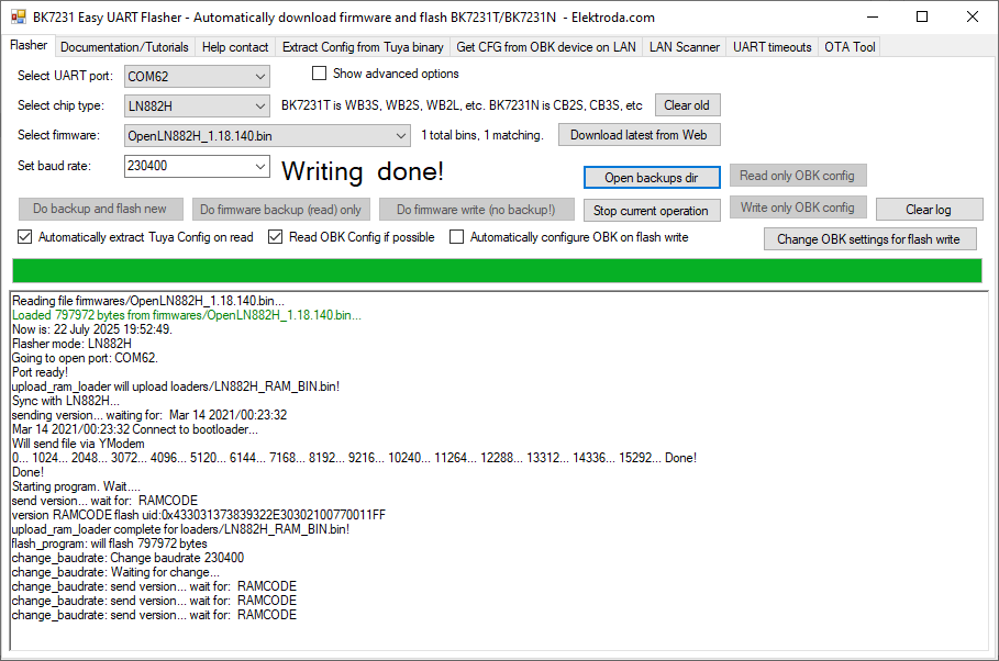

    whaat. how. program closes at this point at any baud for me
    BK7231 Easy UART Flasher interface with operation log visible
  • #5 21613456
    Posts: 14767
    Rate: 12906
    No stack trace, nothing?

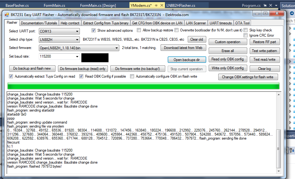

  • BK7231Flasher crashes with System.IO.IOException
    #6 21613459
    Posts: 5216
    Help: 448
    Rate: 917
    report.wer from event viewer. no error in EF before quit
    not seen this before with EF. let me try totally different machine to be sure. official flasher is still OK on same com port
    Added after 8 [minutes]:
    same on another machine. SharpTool v22 dumps OK as normal on both machines

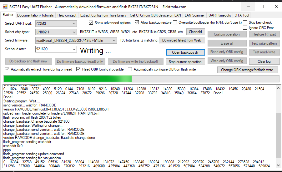

  • #8 21613532
    Posts: 5216
    Help: 448
    Rate: 917
    pS: it looks like Problem Signature 09: System.IO.IOException
    for you
    yes. researching.
  • #9 21613538
    Posts: 14767
    Rate: 12906
    Either it can't open file or can't open serial I guess... but RAMcode for flash read is embedded into binary by @insmod , I will do the same for flash later, for now i've added it as file.
    Maybe I should add realtime log dump to file

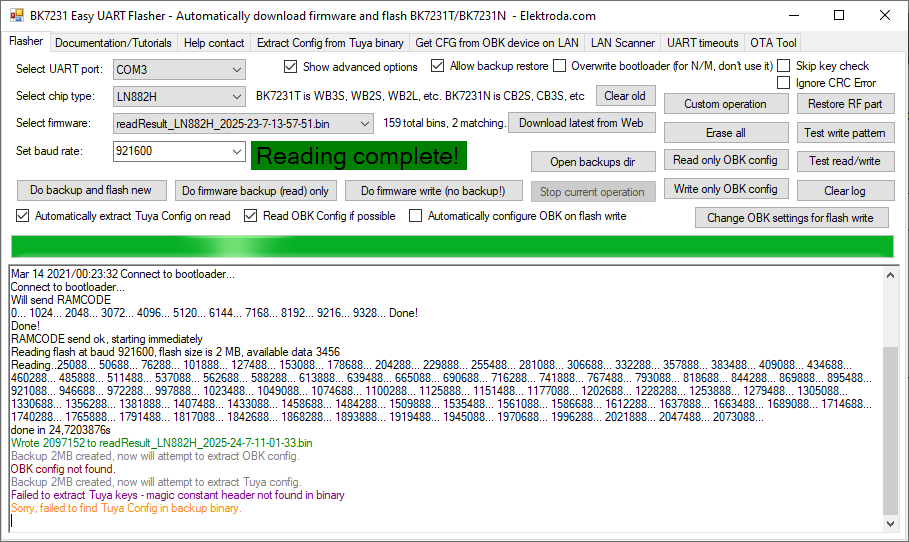

  • #10 21613583
    Posts: 5216
    Help: 448

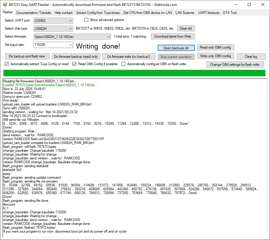

    Rate: 917

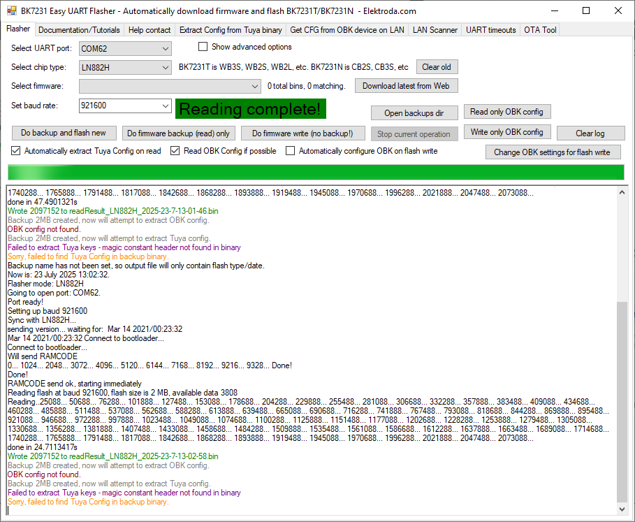

    v41
    Screenshot of BK7231 Easy UART Flasher showing Reading complete! message
    BK7231 Easy UART Flasher interface with Writing done! and flash process log.
    115200 read success
    BK7231 Easy UART Flasher interface with Reading complete! message

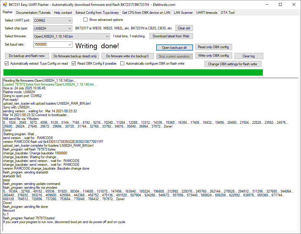

  • Removing 5-second delays from LN882H flasher
    #11 21613601
    Posts: 14767
    Rate: 12906
    I am removing those strange 5 second delays now. It seems to work without them well. Well, how could it not, considering that it still just waits for given reply in a loop... so, if there is no reply in given iteration, then it will just loop one more time

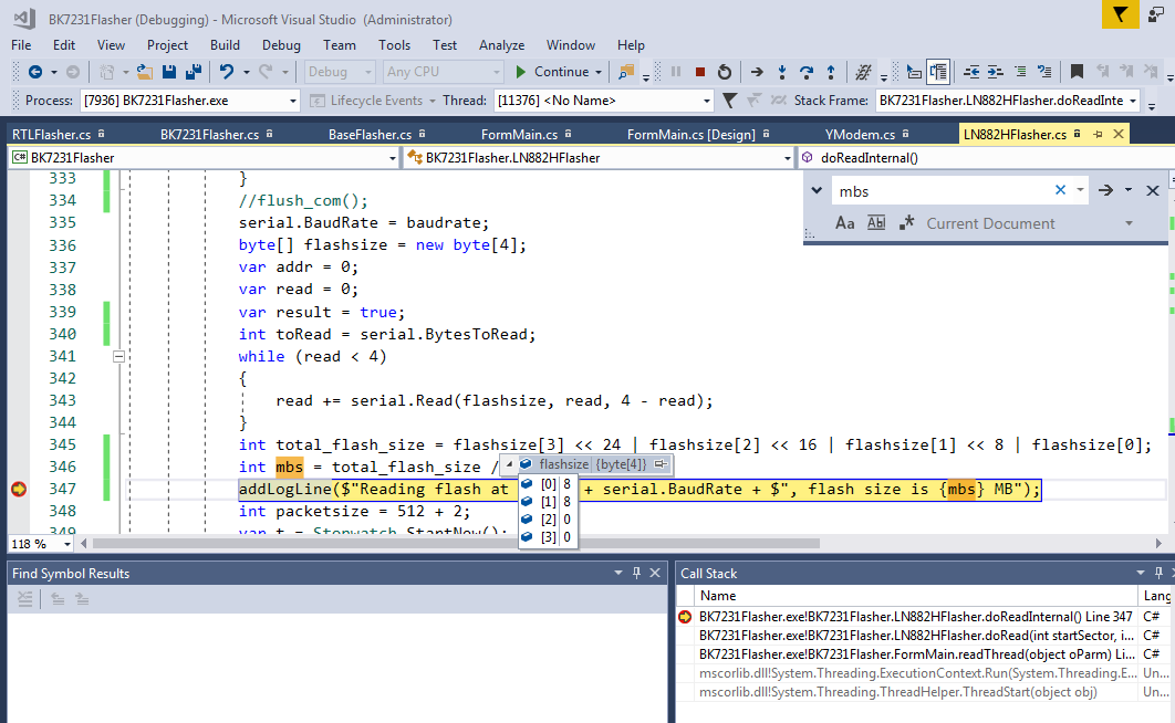

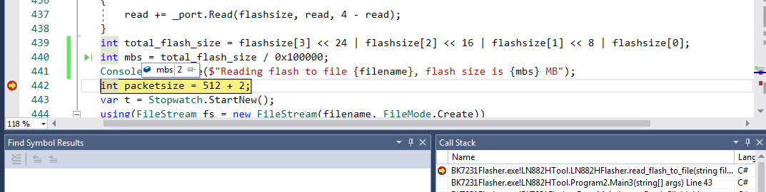

    Strange, both flashers works at 115200, but at 230400 the window one fails ,while console one works, there must be one more problem to find for me
    Code in Visual Studio with highlighted line calculating flash memory size in MB
  • #12 21613720
    insmod
    Posts: 1432
    Help: 168
    Rate: 455
    [postid:5beac62f1a][/postid:5beac62f1a]
    Perhaps this is .NET 3.5 problem? It can't handle $ string and {}?

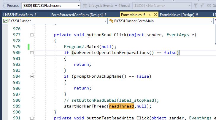

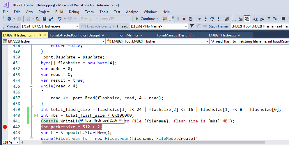

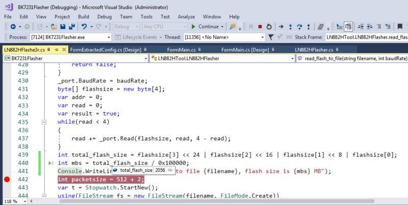

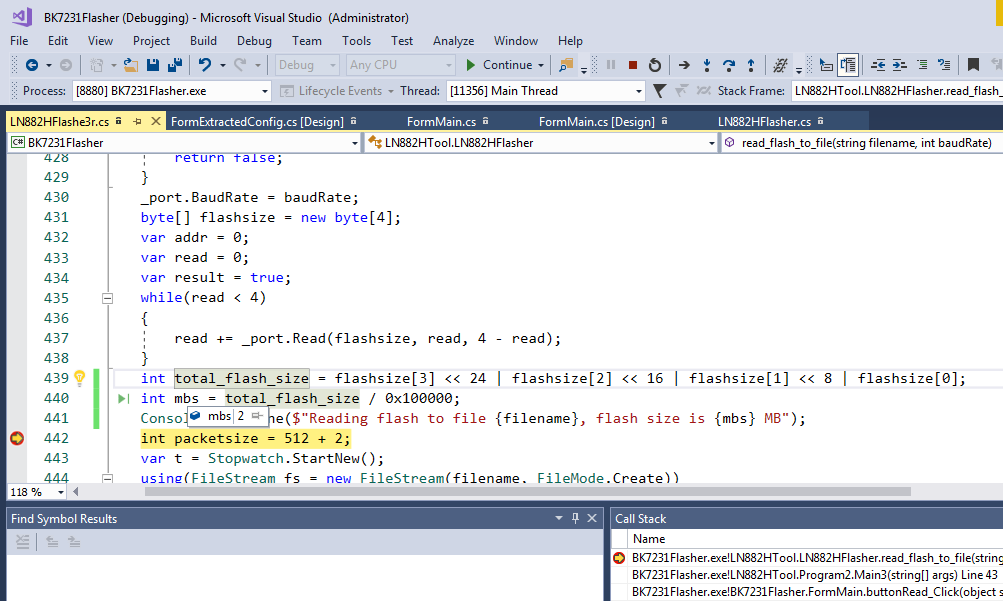

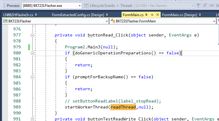

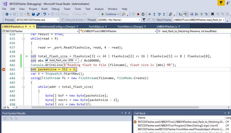

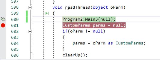

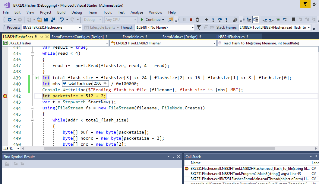

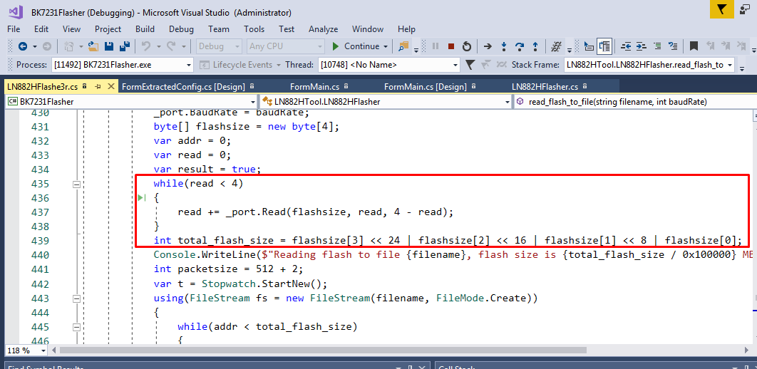

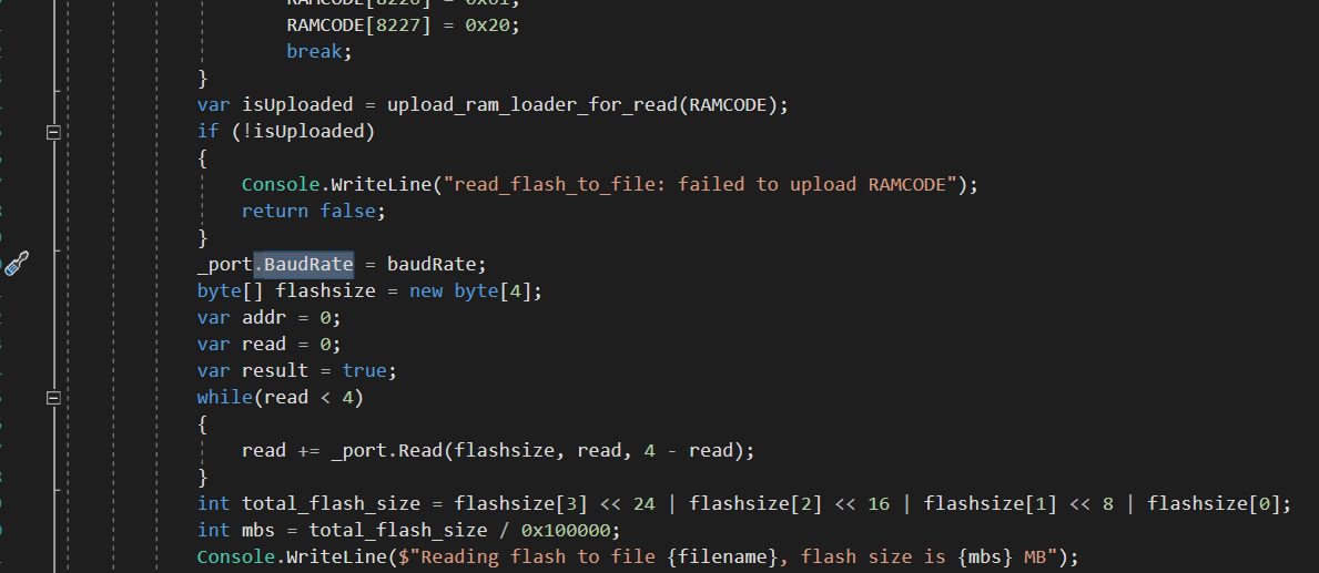

  • Read thread causes garbage after baud switch
    #15 21613745
    Posts: 14767
    Rate: 12906
    I am still investigating but my findings are very strange, I'm not even sure if it's not a fluke...
    Look.
    You know this fragment, right? That's where you RAM code sends the flash size, first 4 bytes.
    Screenshot of Visual Studio showing C# code reading flash memory size

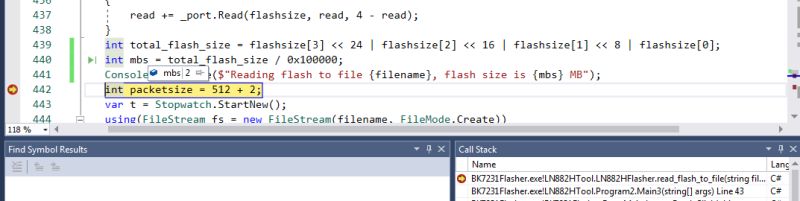

    Now check out this. I copied Sharp Flasher code without changes again, right? To make sure I didn't break anything.
    Case 1: - called from UI Thread:
    Visual Studio screenshot with C# code launching readThread worker thread
    Result:
    Screenshot of Visual Studio with C# code reading flash memory size
    2MB - ok, correct.
    Case 2: - called from read thread:
    Code editor screenshot with Program2.Main3(null) call highlighted
    Visual Studio screenshot showing C# code reading flash memory size
    Garbage is read...
    Next attempts:
    Screenshot of Visual Studio showing error on flash size read calculation line
    C# code in Visual Studio showing flash size reading and file writing process
    It's reproductible.
    Futher comments:

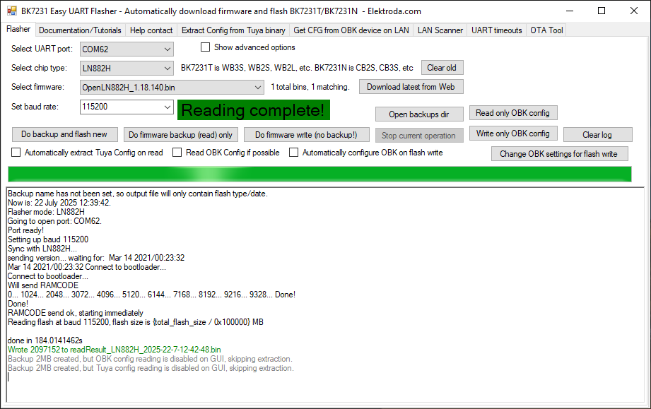

    - baud 115200 works ok in all cases
    - the read issue starts after 115200 to faster baud switch, so YModem transfer to send ram code works
    - it does not seem that buffers are full when error happens, but maybe the baud switch to faster happens too late and first 4 bytes are lost?
    Didn't help:
    Code: C#
  • UI thread may be required for baud changes

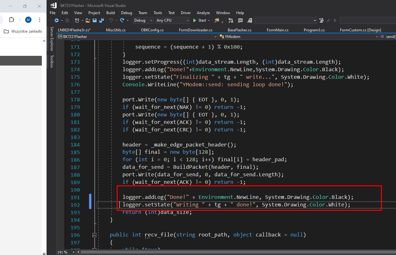

  • Logging delays causing packet loss during baud-rate change
    #21 21614418
    Posts: 14767
    Rate: 12906

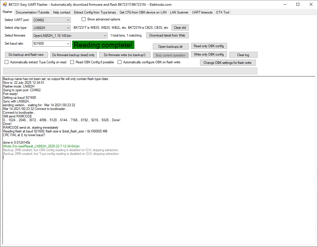

    More testing today - another machine. The first suprising observation is that there it fails to get flash size in both UI and read thread.
    I changed to same dotnet.
    It seems that invoking UI update may be that slow that it actually causes packet loss...
    It seems logger. calls are causing packet loss...
    Added after 4 [minutes]:
    I am fairly confident that those two logger calls:
    Screenshot of Visual Studio showing code that logs operation completion.
    are actually that slow, so they delay baudrate change so some data is skipped before it's changed:
    C# code screenshot setting BaudRate and reading flash memory size
    Interestingly enough, on one machine, problem happens only in read thread, and on another, in both UI and read thread.
    It seems the solution is to just avoid logging in that short timeframe , or maybe change baud rate in the same function to minimize delays

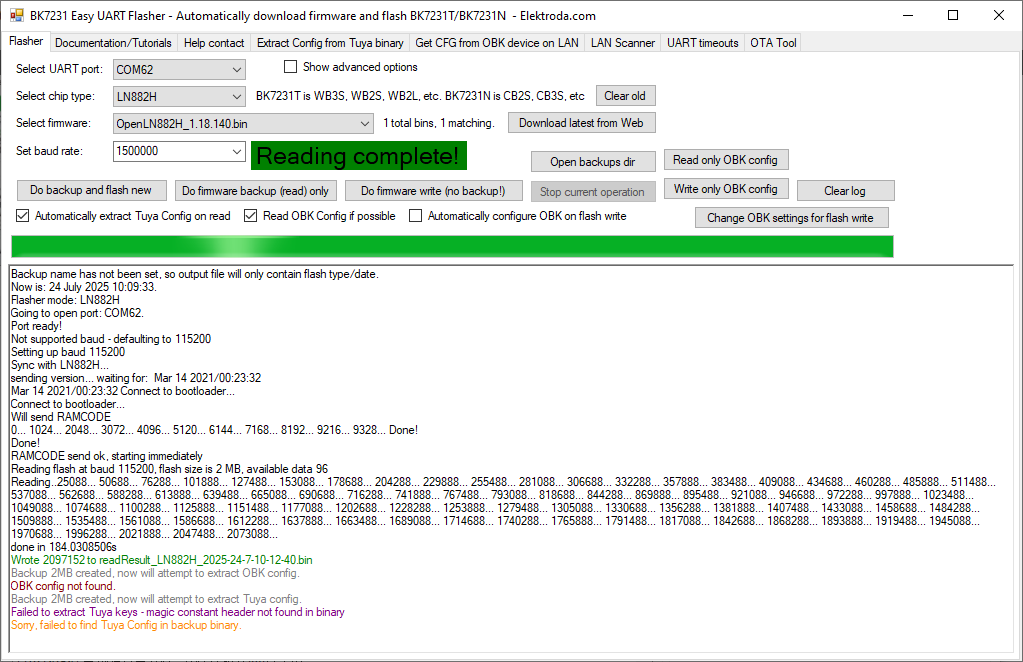

    Added after 5 [hours] 16 [minutes]:
    I pushed a fix, @divadiow read works at 460800
  • #22 21614766
    Posts: 5216
    Help: 448
    Rate: 917
    ah yes
    Screenshot of BK7231 Easy UART Flasher with Reading complete! message displayed
    and 921600
    Screenshot of BK7231 Easy UART Flasher after successful firmware read
    Added after 48 [seconds]:
    1500000 = 115200 speeds, as seen in SharpTool testing
  • #23 21614803
    Posts: 14767
    Rate: 12906
    It should print message, something like "baud not supported, using default 115200"
  • #24 21615579
    Posts: 14767
    Rate: 12906
    @divadiow I pushed some fixes, now higher baud write should also work?
    BK7231 Easy UART Flasher interface with active firmware writing
    Screenshot of BK7231 Easy UART Flasher after firmware write completed
    Screenshot of BK7231 Easy UART Flasher with Reading complete! message in green
  • #25 21615585
    Posts: 5216
    Help: 448
    Rate: 917
    indeed it does
    BK7231 Easy UART Flasher interface showing firmware writing complete
    writing is fast. read still like 115200
    Screenshot of BK7231 Easy UART Flasher showing “Reading complete!” message
  • #26 21615782
    Posts: 14767
    Rate: 12906
    150000 is not supported by @insmod flash fast read, there is a message about it in the log, I will try to make it bold
