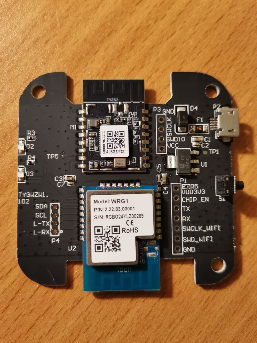

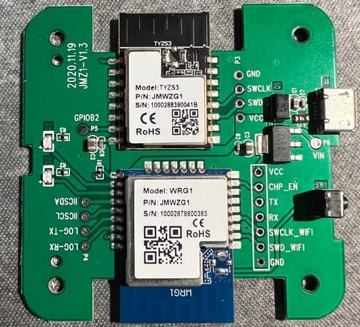

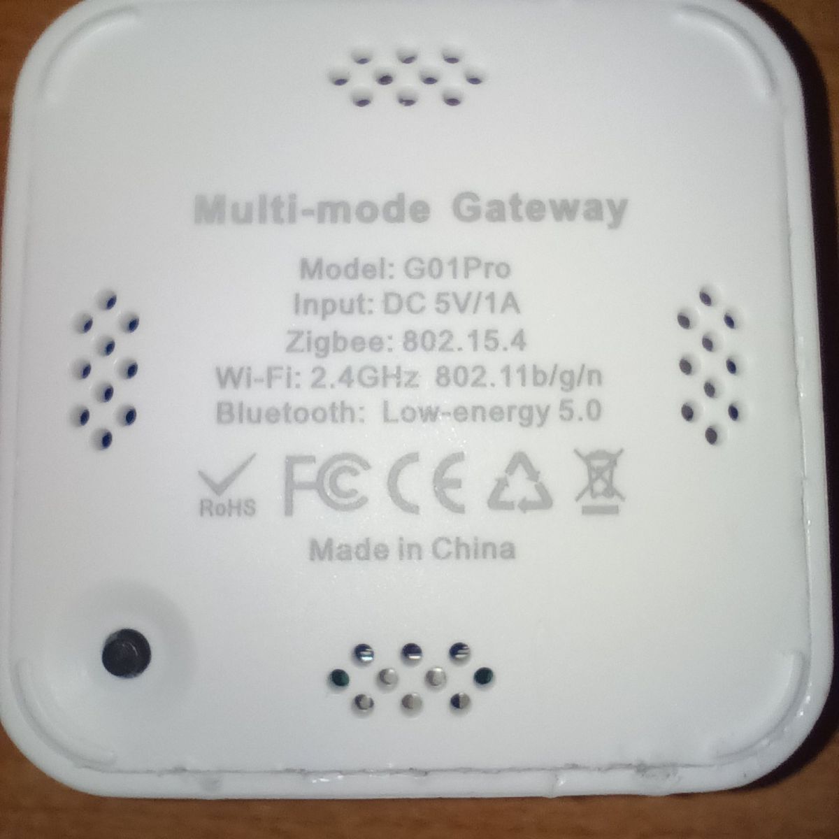

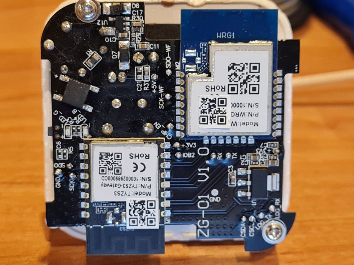

    This guide will show you how to convert WRG1 and TYZS3 Zigbee gateways to OpenBeken.
    There are several known variants using this combination.

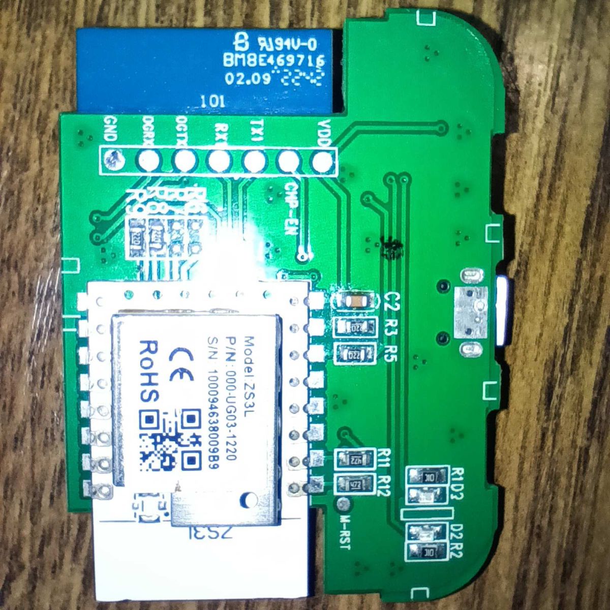

    1. ZXGWZ-04 (internal board is named TYGWZW1), seen here
    2. JMWZG1 (JMZ1-V1.2 or JMZ1-V1.3), seen here
    3. TYZG1 (JZZWD-TY1.1), seen here

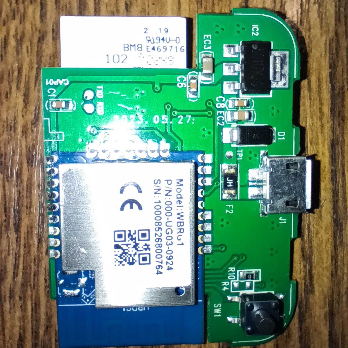

    If you have a WBRG1 module instead of WRG1, see here

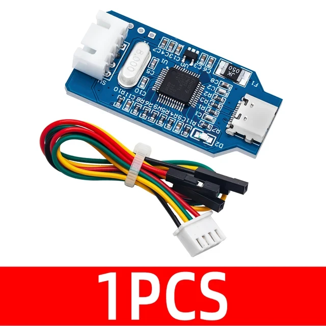

    Be warned, that they can't be flashed via UART, you would need to buy a J-Link adapter
    Chinese J-Link OB clone for $2 would work too
    Converting WRG1 and TYZS3 Zigbee Gateways to OpenBeken
    If you previously haven't used J-Link, you will need to install drivers.
    From attached rtl8711am.rar install JLink_Windows_V632g.exe
    When you've installed drivers and connected J-Link, check if you have "J-Link driver" in device manager under USB controllers, and not an unknown device.
    Connect your J-Link to SWD port of WRG1 module (SWCLK_WIFI and SWD_WIFI)

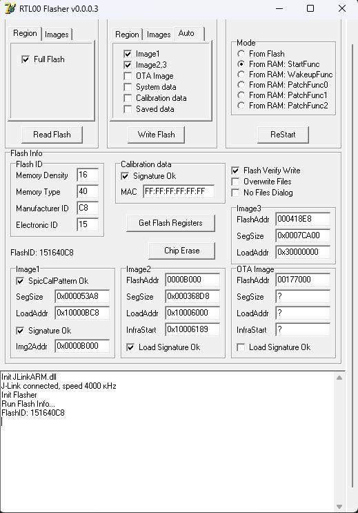

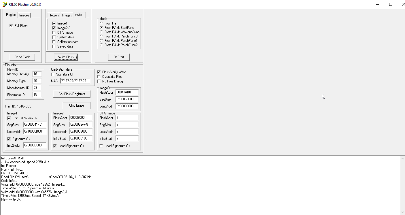

    Open RTL00Flasher (ignore Flash ID warning if it shows)
    Download latest OpenRTL8710A JTAG firmware from https://github.com/openshwprojects/OpenBK7231T_App/releases
    Latest at the moment of writing this post: https://github.com/openshwprojects/OpenBK7231...s/download/1.18.135/OpenRTL8710A_1.18.135.bin
    Open page "Auto", where button "Write Flash" is located. Check "Image1" and "Image2,3". Ensure that checkboxes "System data" and "Calibration data" are not set. That way we will preserve original MAC address and WiFi calibration.
    Then press "Write Flash" and select previously downloaded firmware. Flashing will begin automatically.

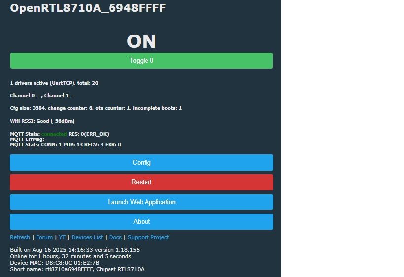

    Once flashed, connect UART to LOG-TX/L-TX and LOG-RX/L-RX, set baud rate to 38400.
    Power-cycle the device.
    If everything gone right, you will see OpenBeken boot log.

    init_thread(53), Available heap 0x23a78OpenRTL8710A, version dev_20250714_133008
    Entering initLog()...
    Commands registered!
    initLog() done!
    Connect to newly-created access point and via http://192.168.4.1 configure to your needs.

    Connect your J-Link to SWD port of TYZS3 module (SWCLK and SWD on the right side of the module)

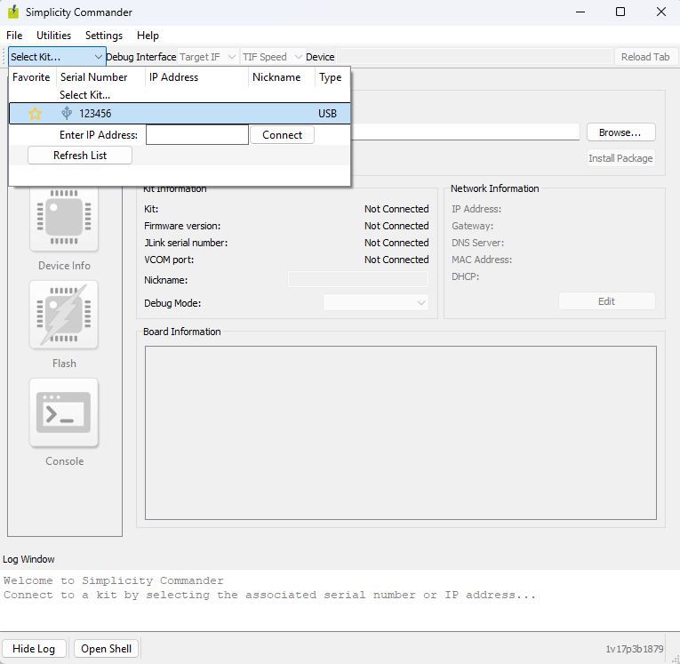

    Open Simplicity Commander and select your J-Link adapter
    Screenshot of Simplicity Commander with the “Select Kit...” menu open and a USB J-Link adapter selected.
    Open Flash category, click "Browse..." and select any of included in rtl8711am.rar .gbl files

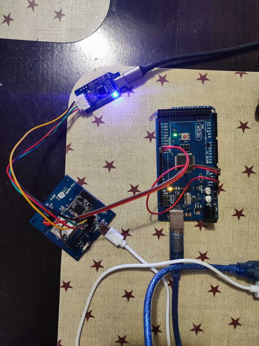

  • Restored TYZS3 boots RTL8710 but fails after Image 2 init
    #10 21636781
    svetlinp
    After restoring device, it's not booting correctly. I restored TYZS3_dump.hex to TYZS3. This is the log file for RTL8710 booting. I cannot understand where the problem is: is it the RTL or the Zigbee module?

  • JTAG wiring error may have damaged TYZS3 board
    #12 21637256
    svetlinp
    Thank you for your support.
    The mistake was made when I reconnected the JTAG from the RTL8710 to the TYZS3. The positions of power and ground are opposite, so I connected the power of the JTAG to the GND of the TYZS3 and the GND of the JTAG to the 3.3V of the TYZS3. The result was expected... the power supply chip of my JTAG has to be replaced (5V -> 3.3V). But there may be more damage to the TYZS3. I don't know if it's a capacitor, a resistor, or the chip itself. The Commander does not show any suspicious output during the flash of the EFR32MG13P732F512GM48. I want to build a Zigbee gateway that is not connected to the cloud. Can I use this platform (RTL8710A) to build this gateway, or do I have to start from the beginning and buy a new device for cloud-free use? What can I use for the TYZS3 replacement on this platform, or what device is better for this purpose (cloud-free - works without Tuya or Smart Home or other services)?
    Development setup with RTL8710A, TYZS3 and Arduino Mega connected via jumper wires.
    OpenRTL8710A control panel showing MQTT status and Wi-Fi connection details
  • Zigbee2MQTT and ZHA work after conversion
    #13 21637265
    insmod
    Posts: 1432
    Help: 168
    Rate: 455
    >>21637256
    Well, you can repair JTAG and check if TYZS3 is alive.
    But since WRG1 is alive, TYZS3 is probably too.
    This one can be converted to be free from cloud. I've tested Zigbee2MQTT and Home Assistant ZHA, they both worked well enough. Though for WIFI+EFR32 Zigbee2MQTT is better, since they've rewrote their EZSP protocol implementation, and it is more stable.
    If you decide to buy a new device, current Tuya ones are like in https://www.elektroda.com/rtvforum/topic4127578.html
    Alternative is Ewelink. Those can also be used as bluetooth proxy. See https://www.elektroda.com/rtvforum/topic4099946.html
  • RTL00 flash boots to garbled Image 2 output
    #14 21657359
    hazilo
    Hi there,
    I joined the forum for this device as I have two lying around to work with.
    I have backed up the original rom, and then I flashed with RTL00. Now when I power it on it never gets to openbeken, instead here's what I get from the log uart:
    ROM Version: 0.3
    Build ToolChain Version: gcc version 4.8.3 (Realtek ASDK-4.8.3p1 Build 2003)
    Check boot type form eFuse
    SPI Initial
    Image1 length: 0x41fc, Image Addr: 0x10000bc8
    Image1 Validate OK, Going jump to Image1
    BOOT from Flash:YES
    ===== Enter Image 1 ====
    SDR Controller Init
    load NEW fw 1
    Flash Im2:Addr 0x177000, Len 279212, Load to SRAM 0x10006000
    Im3 length: 0x8a800, Im3 Addr: 0x30000000
    Im2 Sign: RTKWin, InfaStart @ 0x10006189
    ===== Enter Image 2 ====
    =▒Ug▒q▒X▒▒▒▒p▒▒a▒▒p2▒0a2▒▒▒)▒▒5▒0a▒3Csut;;▒▒
                                                3▒▒▒▒▒k! 1sssss▒"sz▒Yu2▒▒▒R▒X
                                                                             `9▒▒▒▒▒G9`X`p▒
                                                                                           ▒▒OU▒G▒`d8▒▒9▒`111ssssss0333▒y.`)▒▒▒▒▒xOx/▒▒|acxaC3▒▒▒▒▒▒sa▒▒zu:▒▒,`i8QQu▒▒`s▒f0̳▒▒3F}▒▒▒▒r▒▒,▒Y▒-▒o1sssc▒}▒▒x▒9\▒▒3c▒bfp2▒0▒▒0▒ha8;{2▒▒ha88b▒▒t)▒▒▒```k3A0▒0▒0▒▒▒c2▒p39▒z▒3Q5▒▒=▒▒5▒▒z▒
                                                                            ▒▒▒9::C▒2sssp▒}▒x:`0▒1▒▒`132▒1▒▒Y▒`;▒▒▒CDc▒1
                     c▒22%▒c
                            EcPa▒!!!6sssss▒ !A▒▒▒▒t▒▒]▒▒e}▒▒Cc`▒q▒▒j▒h▒▒ea0▒▒`f▒ʳc▒▒▒j▒k▒▒YQ▒=▒▒걍▒YX1jz▒▒}tyyv▒C`▒O
                 ▒▒▒2▒XQ9▒c`▒qT▒▒▒a▒2▒xi▒c`▒qT▒▒▒▒▒`8:j::3▒2▒▒p2r▒▒9▒Cc▒▒q▒▒▒▒▒▒P▒▒▒f▒▒r▒▒2▒O1▒▒`▒▒
                                                                                                   ▒▒e▒▒r▒▒C_50KL
              ▒▒YP▒s▒p▒`▒▒
                          ▒=;▒z▒▒9r▒▒
                                     =}▒c`▒qT▒{]es01▒▒C▒c▒▒q▒▒▒▒▒▒P▒▒▒f▒2▒u▒▒ay5▒▒xd▒C`▒▒
                                                                                         u▒▒>YR▒CP"q▒▒▒▒▒c▒G▒qh▒pp▒▒▒MC▒WQ▒▒▒▒hpOG▒h!▒jzu▒▒a▒▒▒p("▒▒▒Pj▒j▒▒▒wQ1▒q▒a▒QAq▒j▒볨▒▒▒▒bc▒▒1▒▒1YU*c▒▒#hƮgs▒▒Ů+▒p)▒`▒O
        u▒▒=Y▒▒0▒▒|T▒jz=\▒r▒:▒▒▒▒▒▒t'C▒c▒▒u▒▒<Y`▒▒▒▒:spO
                                                        A0▒X▒`▒c▒▒u▒▒>Y▒:*▒]P▒`▒▒
                                                                                 u▒▒:9YSw▒▒00y▒Cc`▒qT�▒▒e`8q▒3de0cq▒󨹨▒3▒▒▒3▒▒▒▒;▒{▒3e!▒c▒▒▒▒▒y▒eb8;;r}j▒c`▒q▒▒2:+rYP▒▒;r}▒`▒H▒:y▒eb8▒;2▒i▒
    I get this result with every image I tried to flash (tried 135 that you linked, 165, latest), any idea?
  • #15 21657565
    insmod
    Posts: 1432
    Help: 168
    Rate: 455
    >>21657359
    Do chip erase, then restore calibration data from backup and flash OpenBeken again
  • #16 21657853
    hazilo
    >>21657565
    Thank you for the fast answer, it worked like a charm, everything's good now! I did not want to try to erase the chip without asking first!
  • #17 21699860
    ngocnguyenme
    Level 4  
    Posts: 7

    I managed to sflash a similar gate on the WBRG1 chip:
    Back of a white “Multi-mode Gateway” showing model G01Pro and Zigbee, Wi‑Fi, and Bluetooth specs
    Close-up of a PCB with WBRG1 module, micro‑USB port, and a push button on a wooden surface
    Green PCB with ZS3L module and labeled pads GND, RX, TX1, VDD on a wooden surface
    OpenBeken works when installed from the programmer. Unfortunately the OTA does not install:

  • WRG1 flashing issue with no boot or Wi-Fi AP
    #19 21885412
    aike
    Posts: 8
    @insmod, Hi, I have a similar gateway (ZG-01 V1.0) with the same chips. I'm trying to flash them, but I'm running into a problem with the WRG1 not booting after flashing and i didn't see Wi-Fi AP. I've tried several different firmware versions, the latest available one, and the one mentioned in the post, but none of them worked. TYZS3 chip seems to be flashed successfully. I made dumps and have not received any errors during the flashing process. All I get are two LEDs (green and blue) blinking every 35 seconds, which I suspect is a reboot. I also noticed that the addresses in the Image1 and Itage2 blocks in RTL00 Flasher look different than the author's. Could this affect the results? I also can't see the log on log_rix or log_tix. When I connect the adapter, the device simply doesn't boot (I don't even see the LEDs glowing). I'd be grateful if you could suggest a solution.

  • #20 21885460
    insmod
    Posts: 1432
    Help: 168
    Rate: 455
    >>21885412
    That Image1/Image2 are different is of no consequence.
    Did you disconnect JTAG probe before powering it?
    There should be at least something in log (LOG_TX at 57600 baud), because ROM bootloader can't be overwritten.
  • #21 21885621
    aike
    Posts: 8
    >>21885460
    Sure, i soldered the wires to gnd, log_rx, log_tx, open serial connection and after that power the device, but nothing happens, also try 57600. I have a cheap pl2303 adapter, maybe that's the reason?
  • #22 21885623
    insmod
    Posts: 1432
    Help: 168
    Rate: 455
    >>21885621
    Swap RX and TX to be sure.
    The only way for the module to be unbootable at all is if CHIP_EN is grounded.
  • CH341 adapter yields readable 115200 boot log
