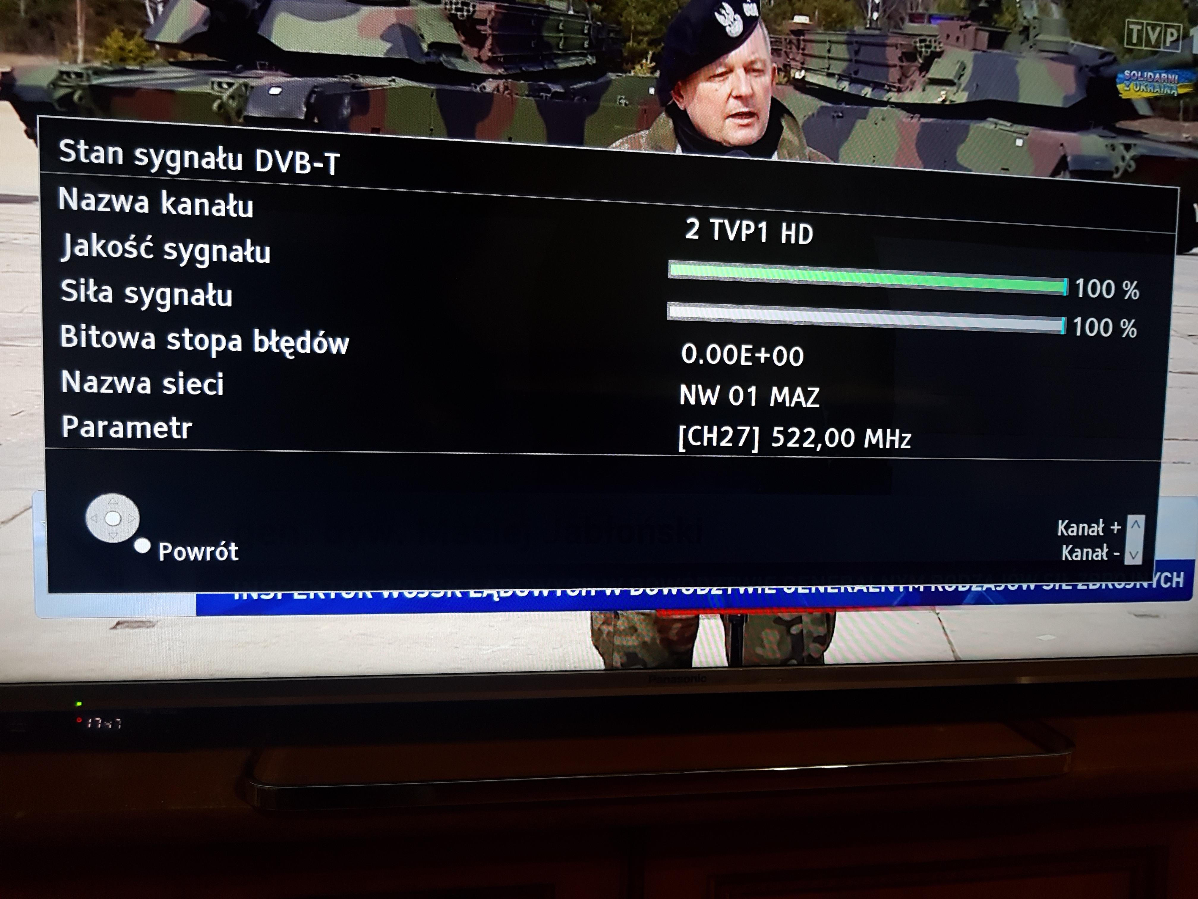

    Hello forum users. A new problem has arisen. After overcoming the difficulties with the channel search by the LXDVB1 decoder, it turned out that the image on the TV is expanded. Setting the TV to different picture types does not work, i.e. it is widened all the time. Directly from the antenna everything is fine. I replaced the decoder with LXDVB101. The picture is correct but I only have 15 channels. Many basics ones are missing, e.g. TV 1, TV 2, etc. I am asking for help, because it is described incomprehensibly in the manual. Thank you very much in advance for your help. Casimir.
  • #27 19965339
    szarik1404
    Posts: 1053
    Help: 23
    Rate: 123
    Earlier you wrote that you still need to set up the antenna.
  • #28 19965359
    celgz
    Posts: 112
    Rate: 11
    The previous decoder LXdvb1 searched for all channels. I conclude that the antenna is positioned correctly. Directly from the antenna, the TV searches for and plays all channels. Casimir.
  • #29 19965542

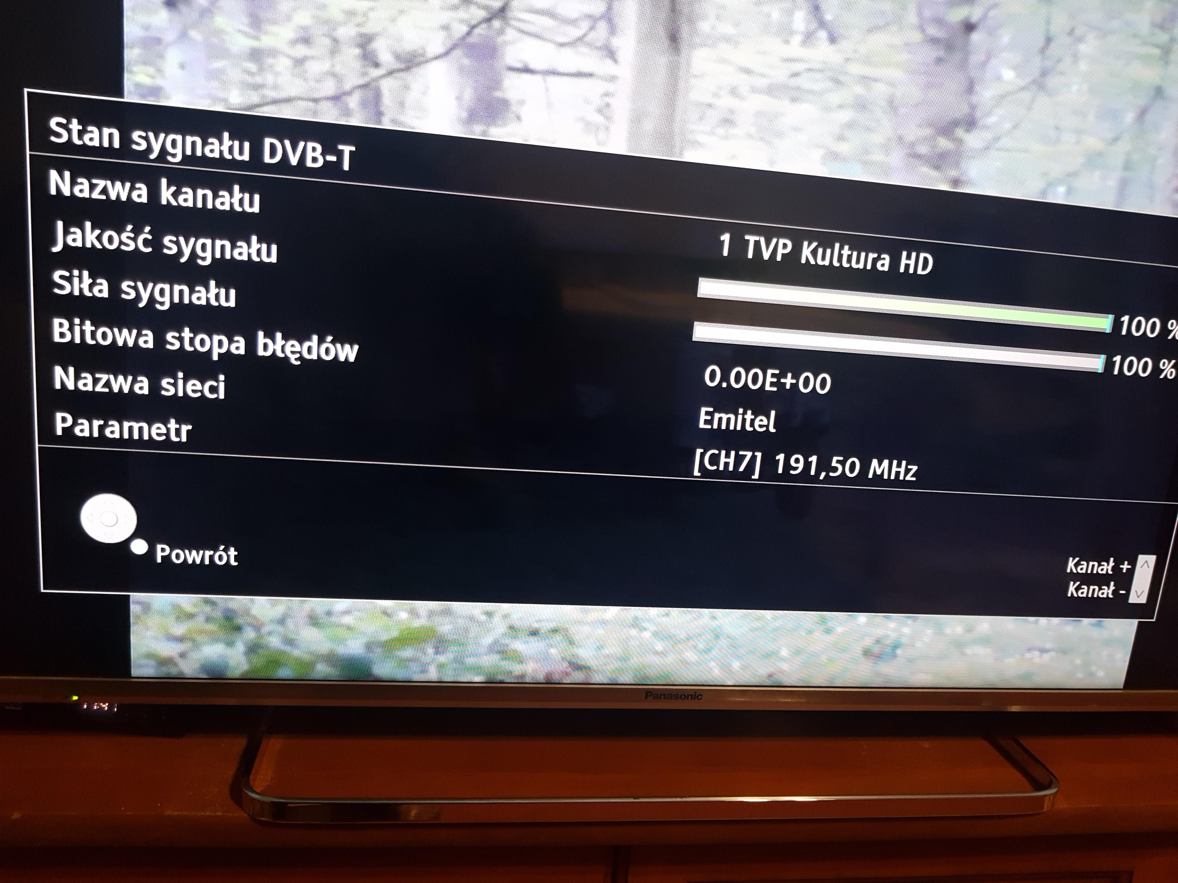

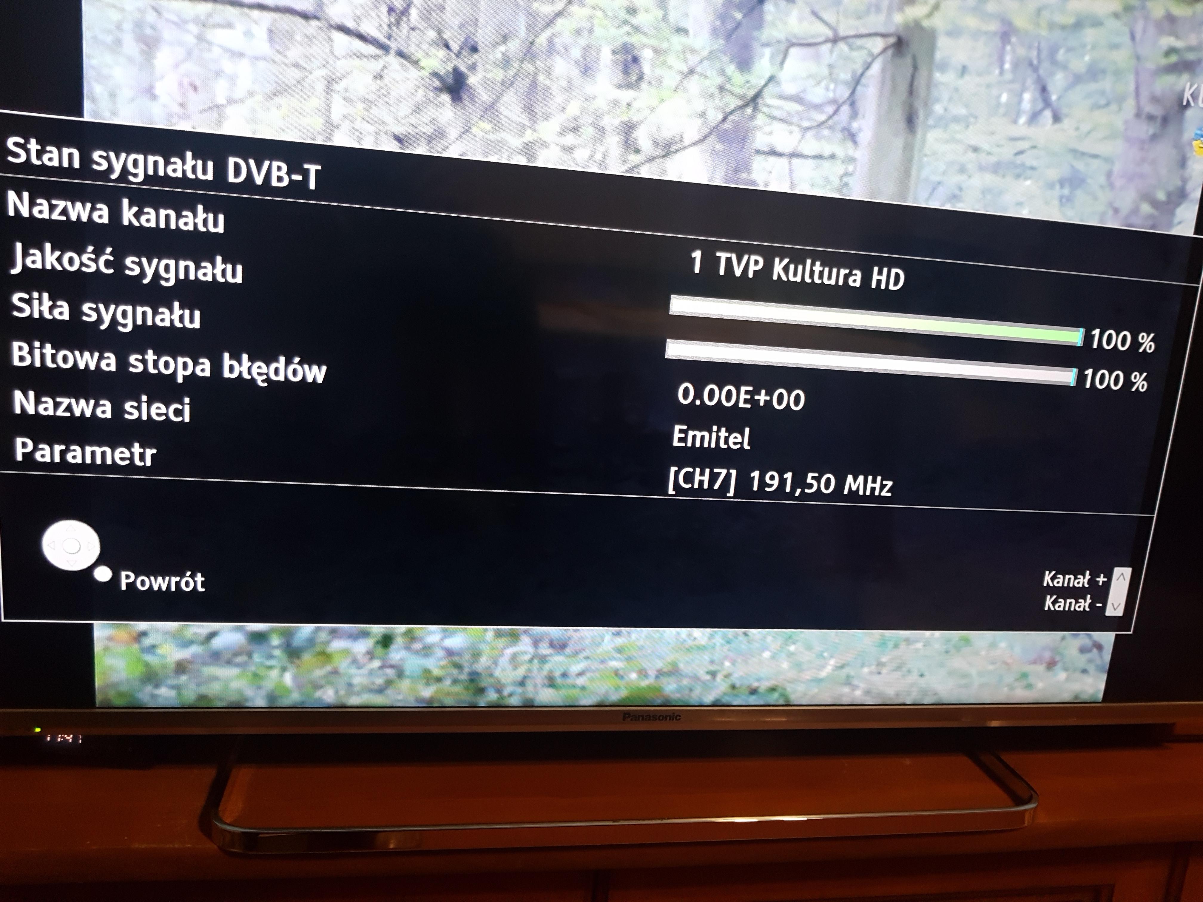

    I am weak in technical matters. As a test, I send pictures of the TV1 and TV2 signal (among other things, I miss these channels through the decoder after replacing LXDVB1 with LXDVB101. Let me remind you that on the previous decoder there were all channels, but the image was extended. The splitter has one input and two outputs to which TVs are connected. One plays without a decoder, the other via a decoder. Maybe this connection is wrong?
