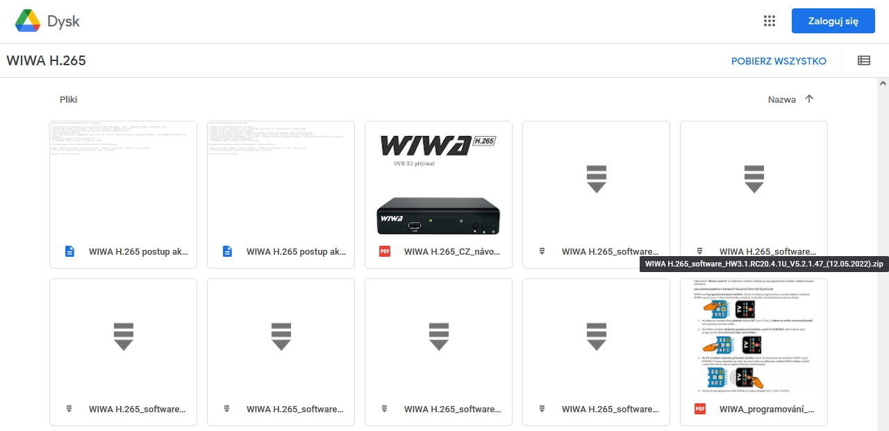

    Good morning, I would have a question where can I find a software update for my tuner: WIWA H265. Does anyone know where I can find such a software update package?
    My WIWA H265 model is: SW Version V5.1.0.93 Jul 8 2021
    And by the way, I have such a question, because when I enter the tuner settings (using the 'menu' button), although I have a device connected via a USB cable, the device shows its absence (the USB cable itself works fine) and when I enter in the update via usb option, then it shows me no connection to the network, although the device is connected to a router with WIFI. I also can't change the network settings, because when I go to the 'WIWA adapter settings' option, it shows me empty fields and I can't change the network addresses to the tuner. Can I ask for help and actions that will help me update the tuner and set its network correctly?

    When I had Wiwa with RJ input, updates were downloaded from the Internet.
  • #6 20039231
    AdW655
    Level 4  
    Posts: 10
    Rate: 19
    Okay, but how from the internet after connecting the cable? Because I am trying to connect the router to the WIWA tuner via USB and it shows no internet all the time.

    Does your WIWA have a LAN input (RJ 45)?
  • #11 20039285
    AdW655
    Level 4  
    Posts: 10
    Rate: 19
    LeDy wrote:
    The decoder was with RJ 45 input and in the menu you are looking for software update.
    From what I can see, my model does not have an RJ input, so this update option is out of the question.
    Do you know if there is any other alternative to this or possibility?

    In the menu, USB, there is an option: Network Applications?
  • #13 20039316
    AdW655
    Level 4  
    Posts: 10
    Rate: 19
    gumisie wrote:
    I do not have such an option, but I have such an option in usb as: 'adapter applications' and then: 'update via the Internet'.
    Only when I go to the last option I get the message "No network connection".

    I have such an option in usb as: 'adapter applications' and then: 'update over the internet'.
    You will need something like this:
    WiFi USB Antenna for WIWA H.265 Tuner Set-top Box
  • #15 20039334
    AdW655
    Level 4  
    Posts: 10
    Rate: 19
    gumisie wrote:
    Ok, and is it possible to set up a network connection somehow without this add-on?

    You can search the net for a newer version of the software (WIWA, no support) and try to install from a pendrive, but it is quite risky.

    Apart from that, do you know where I can find updates for the tuner?
  • #19 20039405
    gumisie
    Posts: 17937
    Help: 1667
    Rate: 2483
    AdW655 wrote:
    do you know where i can find updates for the tuner?
    I know, but it's very risky.
    Tuner, may not "stand up" anymore.

    Because it is unofficial software not supported by the manufacturer of the set-top box.
    And it may not work with your device (more specifically the integrated circuit used inside).

    And do I have a chance to find an official version of the software update somewhere? And if so, where?
  • #23 20040716
    gumisie
    Posts: 17937
    Help: 1667
    Rate: 2483
    NO.
    WIWA has long ago stopped releasing new software in the form of .bin files.
    There is a site where you can download unauthorized updates WIWA H265 tuner - the issue of updating via usb / network and network operation , but such an update, as I wrote earlier, may end up killing the decoder.
