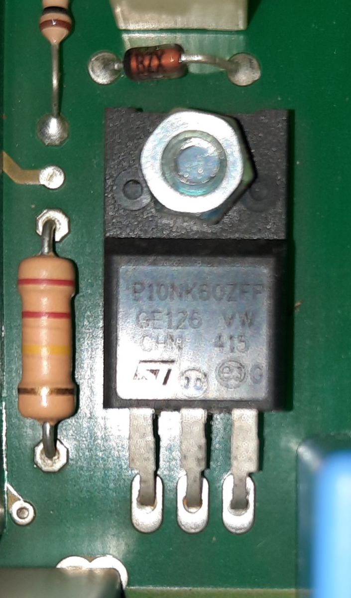

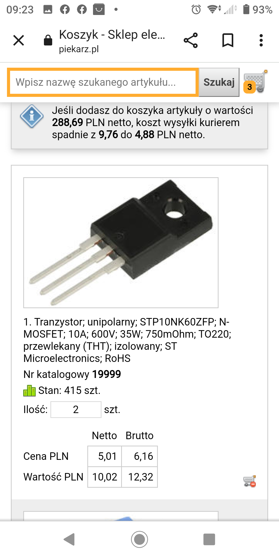

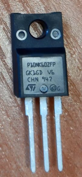

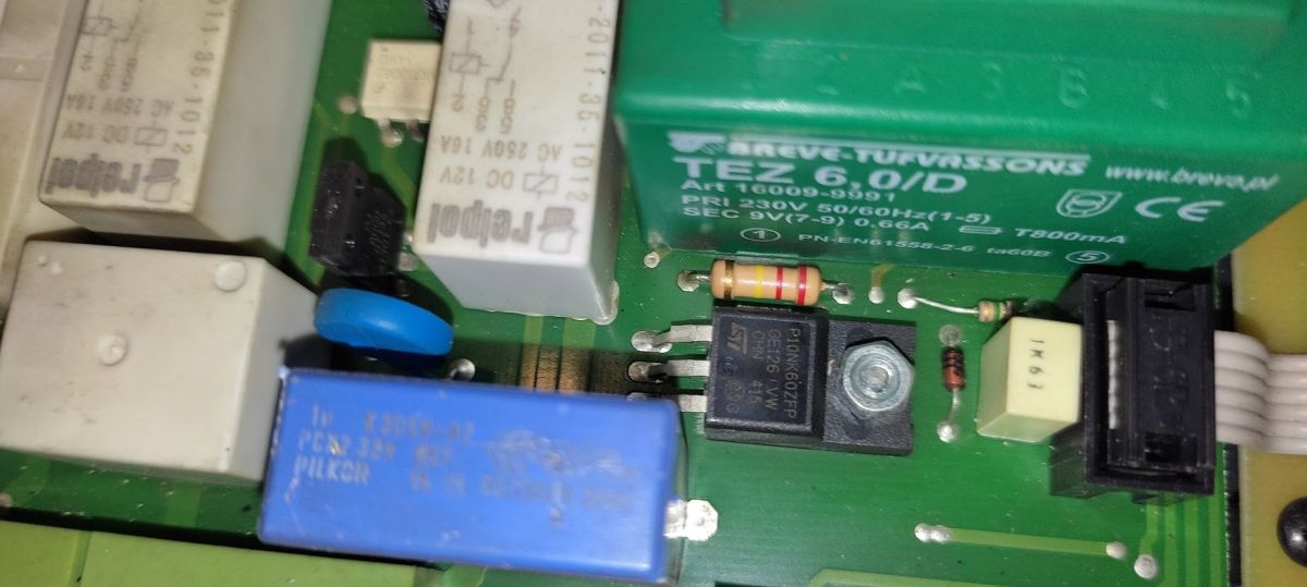

    Gentlemen, I'm green with electronics. Please advise:
    In the oven I have a transistor as in the picture on the board, but I bought one as it lies on the countertop.
    Are these other markings important? They should be the same or I can safely mount this new transistor
    Defro Komfort EKO 15KW failure "Mosfet temperature too high"
  • #33 20239660
    djluki2013
    Posts: 257
    Rate: 116
    The markings on the first line are important. As far as I can see, these transistors are the same.

    I also had the message "mosfet temperature too high" after replacing the capacitors and the transistor, the message "mosfet sensor damaged" Anyone?

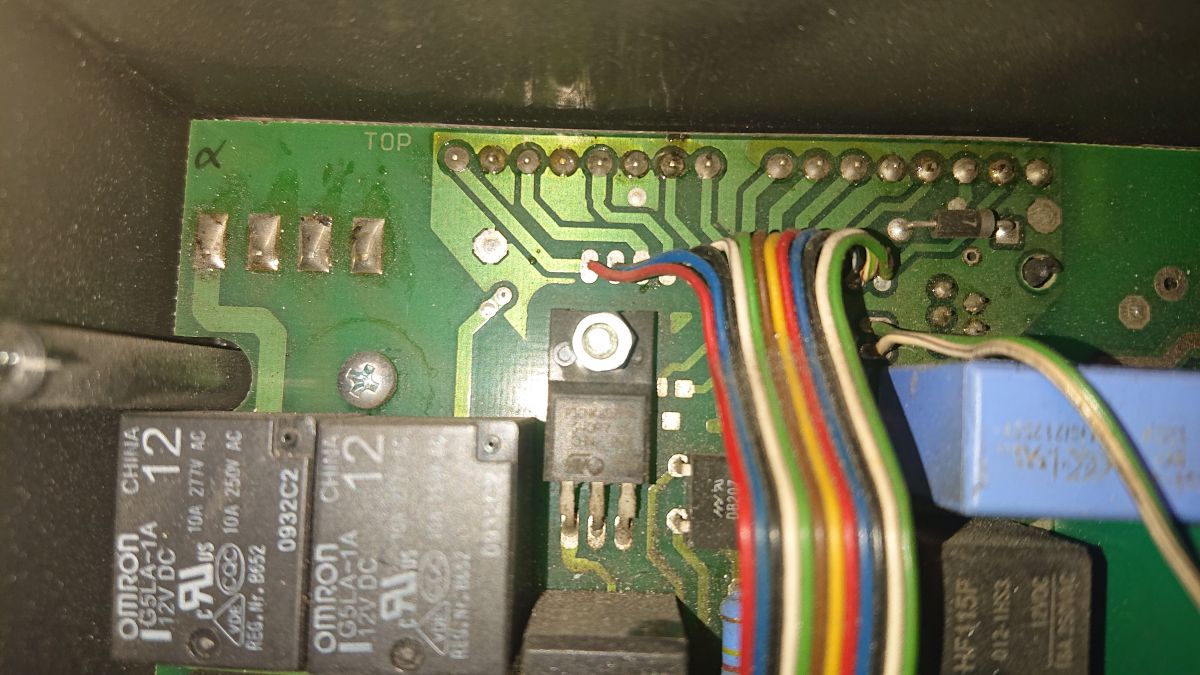

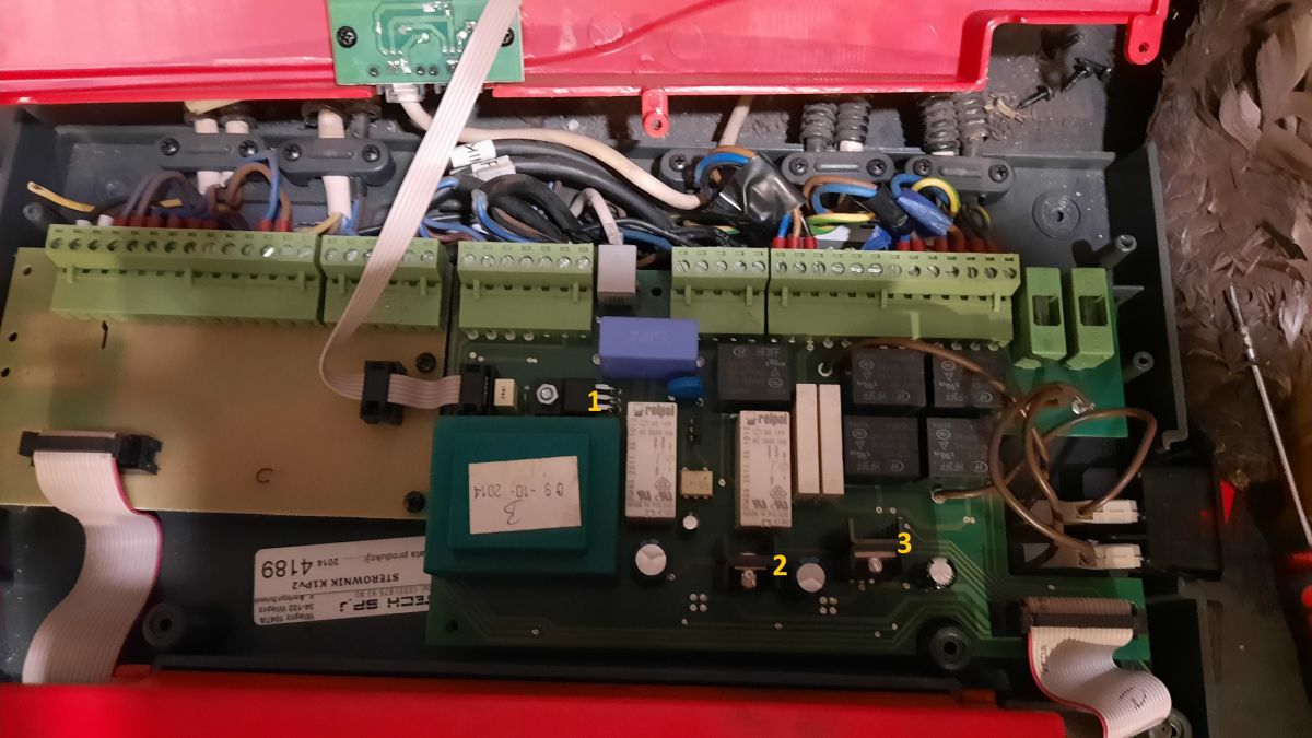

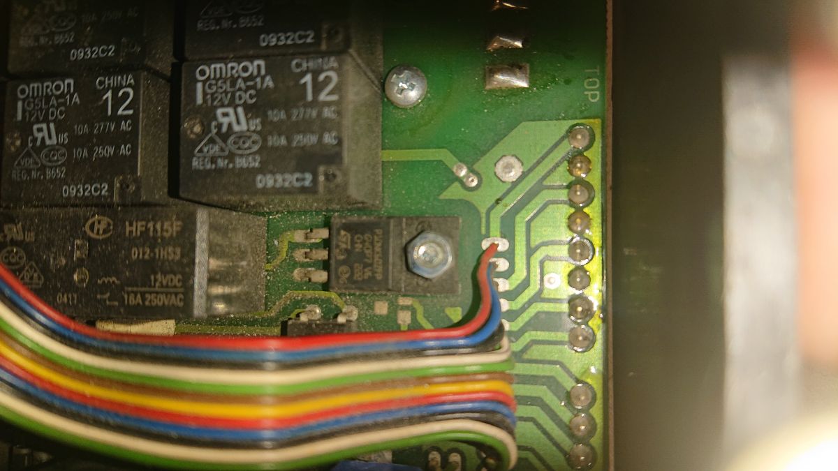

    ezop9
    Posts: 10
    djluki2013 wrote:
    Replacing the mosfet with another one will help.
    So the one I installed may be faulty?

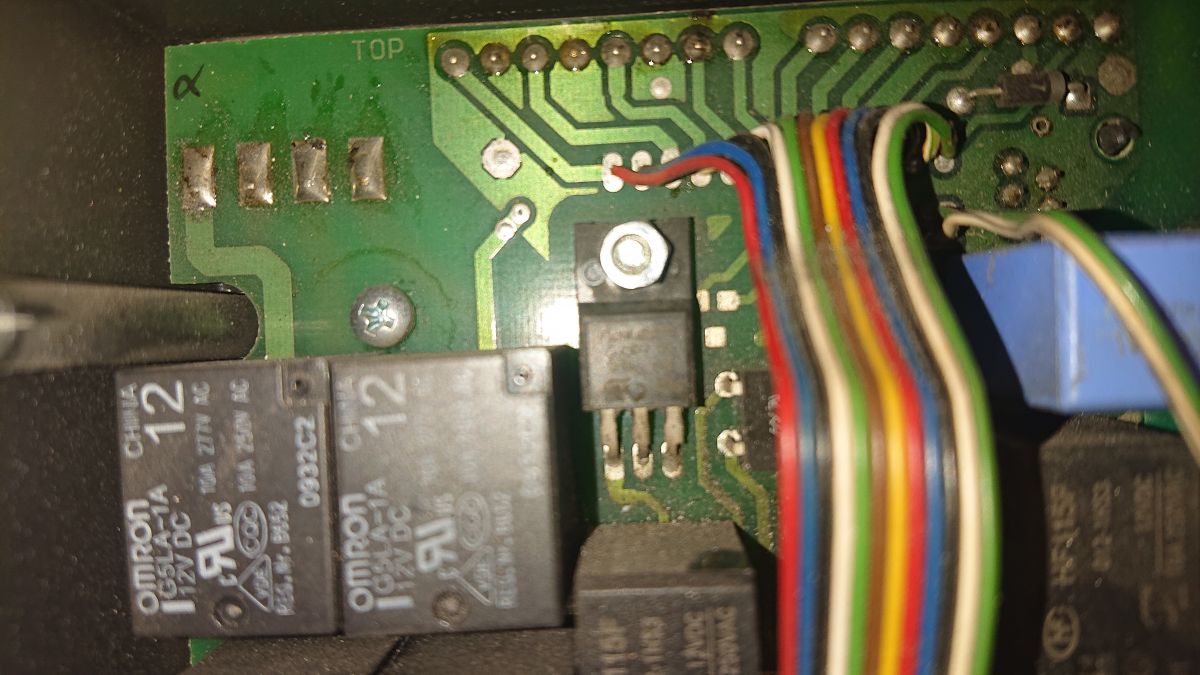

    Defro Komfort EKO 15KW failure "Mosfet temperature too high" Defro Komfort EKO 15KW failure "Mosfet temperature too high"
    Added after 8 [minutes]:
    I replaced the blue capacitor and transistor marked "1" and the capacitor at the blower
    Before, I was getting the error MOSFET TEMPERATURE TOO HIGH, after these exchanges, a DAMAGED MOSFET pops up
    Let me just mention that transistor 1 did not overheat and now it does not heat up, while the warm ones (hot) are those with the markings 2 and 3, but it seems to me that 2 is more

    I did a few of these drivers, the habit of replacing the 1qF capacitor helped. Once I replaced the transistor and capacitor in the blower. These new transistors are produced as soon as possible, sometimes with 10 pcs, one is damaged at the start. Once I had 10 IGBTs, before assembly I checked and 4 were shorted. The changers were with the word Toshiba. The wholesaler guaranteed that the originals are but they were not, Sent me good.

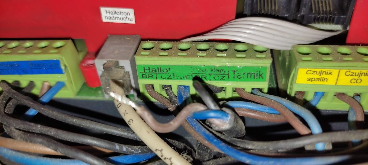

    Happy new year. For present I have "Mosfet too hot" error. Burner is DEFRO agro uni with K1Pv2 Feeder and fan works freely, no obstructions. I opened the cover and measured the temperatures by hand - the hottest thing was the green transformer. Mosfets were fine I suppose. What will be the reason for the transformer to run hot? The part is TEZ 6,0/D art 16009-9991 https://www.tme.eu/en/details/tez6_d_9v/pcb-transformers/breve-tufvassons/tez6-d230-9v/
    I ordered some blue condensators and waiting for them...
    Also will be very thankful if anyone posts a link to schematic for wiring the K1Pv2 I have one wire unconnected: Defro Komfort EKO 15KW failure "Mosfet temperature too high" Defro Komfort EKO 15KW failure "Mosfet temperature too high"

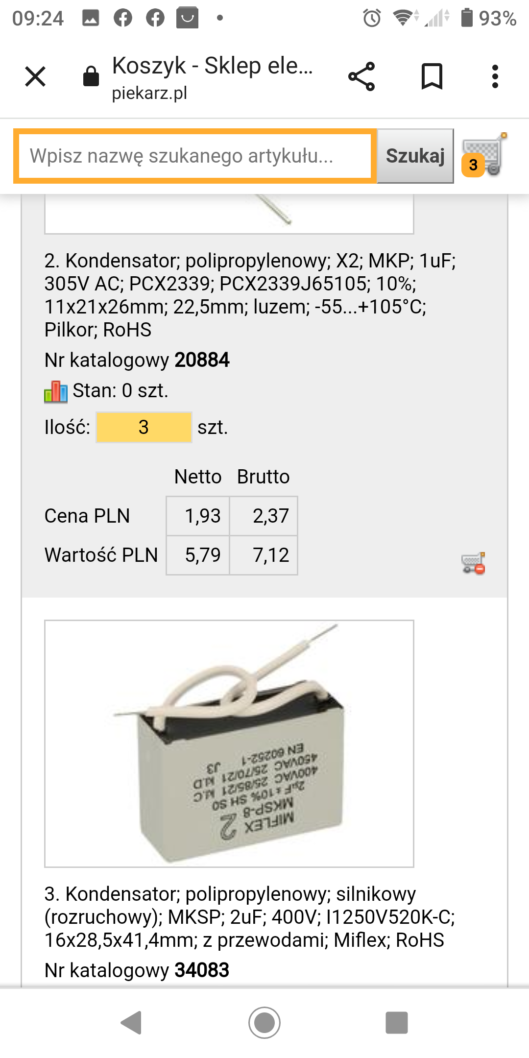

    I replaced the transistor and the 1 uF 400 V capacitor today, there is no error so far and I am optimistic.
    But I have a question, where exactly is the second blower capacitor 2 uF 400 V. I ordered it just in case, I haven't replaced it yet. But I don't even know where it should be. I don't see any on the blower. Regards

    In this black housing by the blower where the power cable goes.

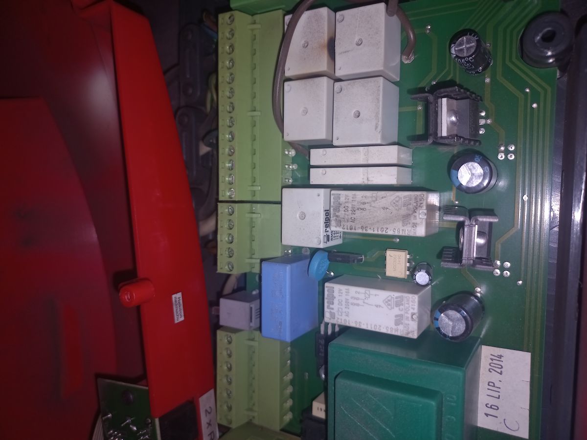

  • Suspect controller capacitor or MOSFET fault
    #46 21570358
    jarek-ja1
    Posts: 67
    Rate: 61
    Hello everyone and please help.
    I have a Defro duo 15kw cooker, the controller for it is kp1v2. I got a message on the controller display "temperature not rising" the feeder ejected Coal as if the fan was not working. I turned the cooker off and on after about 3 hours. The cooker started up but the fan ran for about 5 seconds and then stopped, I could not turn it on in manual mode. I did this several times and always the same thing.
    I connected the fan briefly without switching on the cooker and it runs continuously. I connected it to the cooker and it ran until the speed was reduced on the controller, after which it was the same. It comes on for about 5s and that's it. I checked the capacitor, its capacity is 1micro and it should be 2micro. I replaced it. The same thing still happens, I should add that a month ago I also got the message - Mofset temperature too high, but then I turned the cooker off and on and the problem disappeared.
    Added after 1 [hour] 26 [minutes]: .
    I have read on the forum , that replacing the capacitors may help, please suggest which ones.

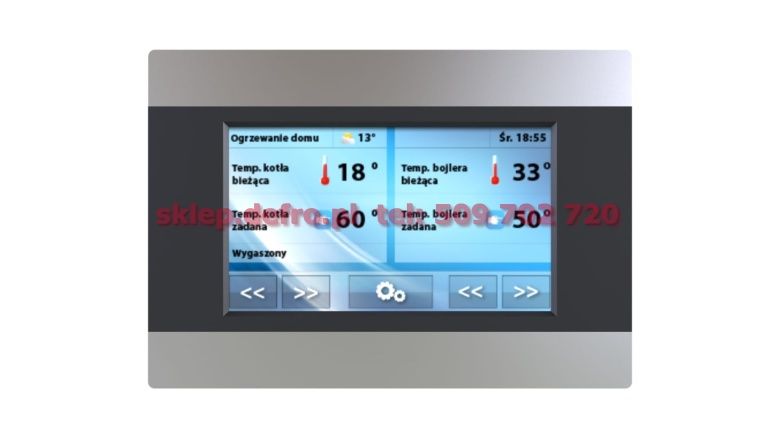

    Defro Bio Slim BS 20 pellet boiler, 15 kW, with 5th Class and Eco Design certification Hello. I didn't want to start a new topic, so I will write here. I have the same problem with the temperature of the MOSFET. I have purchased a blue capacitor, but there is none in my controller. The boiler is a Defro Bio Slim. There is not even a place for this capacitor in this controller. Please help me with the location
    Defro Bio Slim boiler controller screen showing boiler and tank temperatures .

    Hi. The screen you are referring to is the part of the controller that is connected to the executive module and that is where this capacitor will be.
    I don't know the design of this boiler, but all the sensors, fan and feeder are connected to the executive part.
