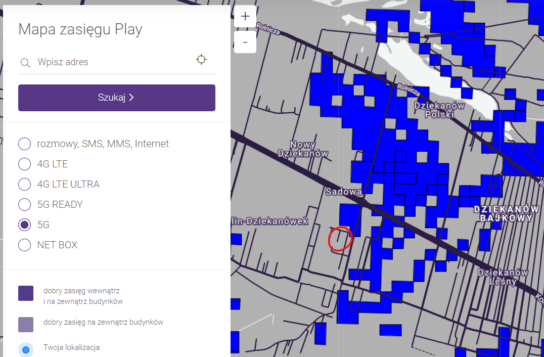

    matek451 wrote:
    For Huawei and its mesh only its production equipment, i.e. https://consumer.huawei.com/pl/routers/q2-pro-3pack
    but I don't need 3, only 1
    matek451 wrote:
    Where are you using 5G Play, what are your aggregation results with LTE?
    a bit north of Warsaw. The modem only shows me 4G, and BOK says that I should be within the 5G range, so I will continue to investigate

    What BOK Play says does not interest me because they are dilettantes, they do not have any knowledge about this 5G shell on the DSS2100 and its range, for today it is a marketing linden that you have caught, unfortunately, but Pro2 does not have external antenna connectors, a bit no localization. And as for the mesh, the Huawei AX3 Pro and more at http://www.bez-kabli.pl/viewtopic.php?f=11&t=52141&start=2235 and ask @atento, he has B818 and this AX3Pro, maybe someone has it with 5G Pro2.

    matek451 wrote:
    for today it is a marketing lime that you have caught on
    I am aware that this is not 5G, but by signing a contract for 2 years, I assume that I will wait before its end
    matek451 wrote:
    a bit of no localization
    forgive me for not disclosing where I live in public.

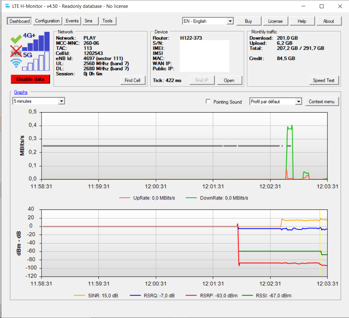

    matek451 wrote:
    You made a mistake with PRO2
    I didn't really have a choice. With a demand for 500 GB / month with a minimum of 20 Mb / s, I had only one operator with one tariff.
    matek451 wrote:
    the basic question is how the aggregation of LTE bands on PRO2 works and, above all, what are the parameters of the signal inside it on LTE2600 / lte2100 / LTE1800?
    Could you suggest how to check it? Preferably some android app. huaCtrl?

    matek451 wrote:
    But you had the option to choose B818 in Play
    unfortunately not. even now this is not possible: https://www.play.pl/dlafirm/sklep/routery-dla-firm/?oid=4012575129
    now there is an additional "UZZ" which was not there before, but still not B818
    Added after 13 [minutes]:
    matek451 wrote:
    what exactly should i do to check what you wrote about?

    But this is not the only sales channel of Play, B818 is in showrooms and in the proprietary offer with an additional payment for 24 months and not in installments for 36 months, the same is the case with PRO2, i.e. installments for 36 months or in a subscription from once owned.
    Added after 9 [minutes]:
    Aggregation of LTE bands with LTE2600 as the baseband but signal parameters at 2600MHz only sufficient, what speed tests look like in such conditions, especially in the evening ones, see also what it looks like with Pro2 outside the window, i.e. signal parameters at 2600MHz and speed. And the selection of bands in the Configuration tab. With these signal parameters on the basic LTE2600, you can see that the external antenna would definitely improve them to optimal values, but this is already fun at a different level, i.e. pulling the antenna connectors outside and if it is a router bought in installments, it remains the property of the operator.
