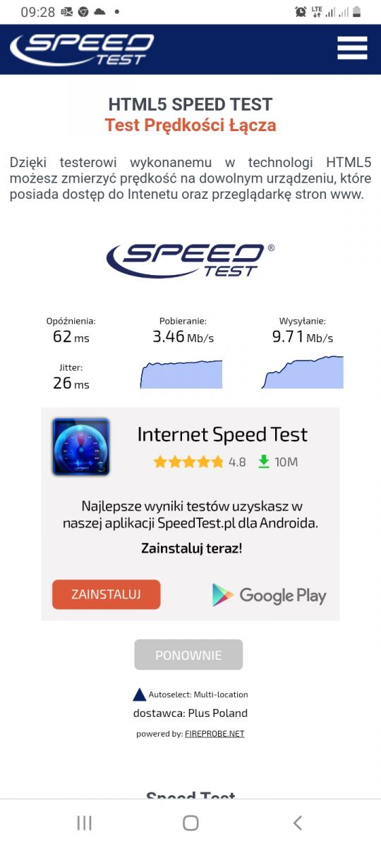

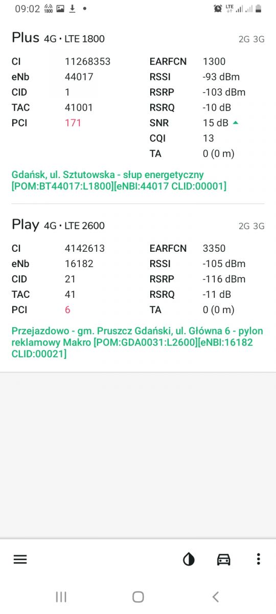

    The location is Gdańsk ul. Owls. I know that Plus works because I use it on the phone, but not on 5G. I understand that I should find out what the maximum speed is possible with different operators. NetMonster showed me for Plus as in the attachment. Indeed, it has not helped me at all and I am now at the starting point.

    The plus point at this location is a bad joke, even on the phone. This operator is not taken into account at all. On the phone, there is a sufficient signal on this pseudo LTE900, BTS on the Sztutowska power pole, this is a station with LTE1800 + 900 aggregation, the same for Szpaki 13. On the latter, there is the 5G2600 license, but it does not work. On LTE900 you do not have a chance for normal internet, LTE1800 on 20MHz band works better, but the ass does not break off, the historic network of Plus on LTE without FDD LTE2600 will not provide you with normal performance there.
    At the beginning, the Play test, which has BTS stations in the vicinity at Falka 3 and Rozłogi 11 stations with LTE2600 + 2100 + 1800 + 800 aggregation on 55MHz band, then Orange and T-mobile, on Rozłogi 11 station with LTE aggregation 2600 + 2100 + 1800 + 800 and on Sienna 48 3 bands without LTE800. Always outside test and screen from the app and speedtest, the same for Plus. Of course, you do not learn anything from the operators, Play has a range on the pseudo 5G2100 N1, DSS, so the 2100MHz band is dynamically shared with LTE2100.

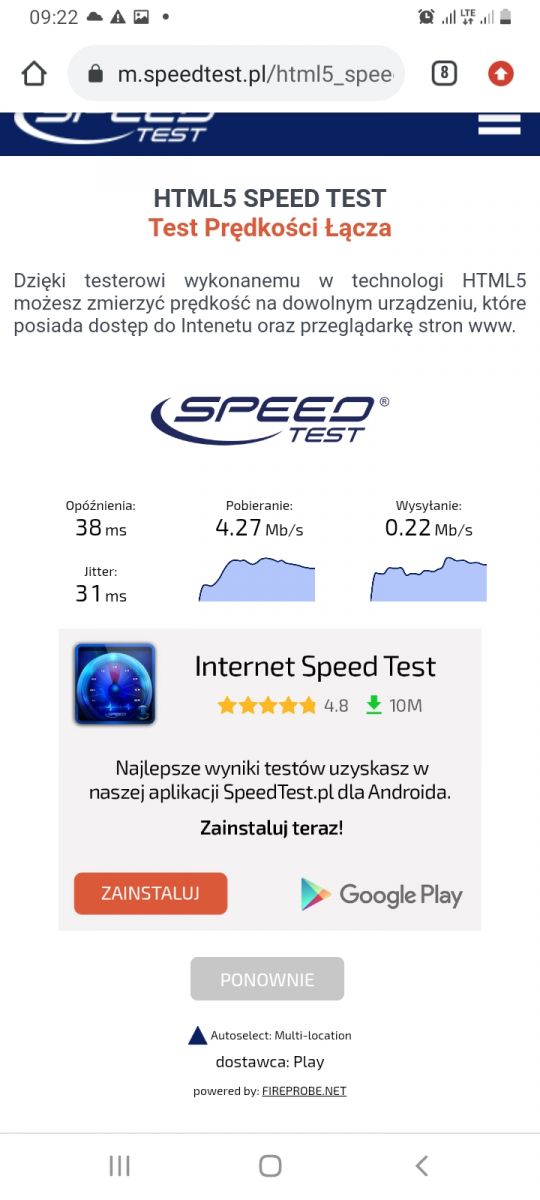

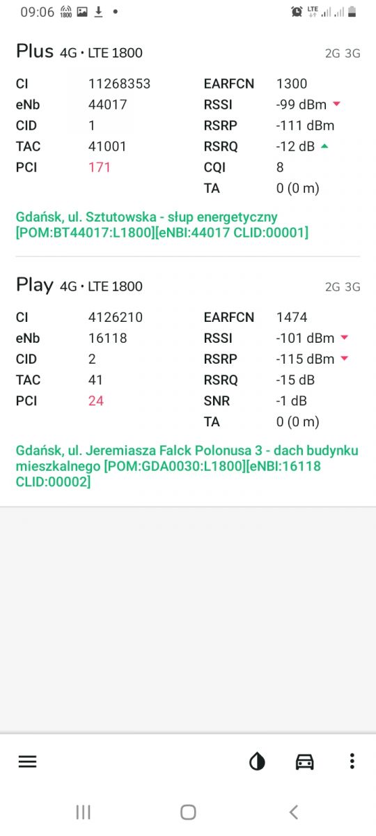

    Play most often switches to LTE1800 from Falck. 1/4 speeds faster than Plus. You can catch LTE2600 from Pruszcz for a few seconds, but I won't be able to do the speed test. Is it possible to make a conclusion on the basis of the ones I enclose? Do you try to continue, for example, to look for a place where LTE2600 is stable, or to perform tests for other networks?

    The test is always on one active card, haven't you healed with Plus yet? After all, this is a drama, at 9 am the LTE1800 band from Sztutowska is already overloaded and the signal parameters are quite weak. In the evenings it is a bottom and a meter of silt but I wrote about it right away. Play a weak signal at 2600MHz from the BTS on the Makro pylon, the speed is OK, a 4CC CA station with a 1107Mb / s radio link from the Modra 101 fiber optic node. without an external antenna, there is no need to count on much, BTS Rozłogi beyond the forest. Overall, PLAY has potential, test it to catch LTE2600. Of course, you do not give up on Orange and T-mobile because behind Martwa Wisła there are two NetWorks stations with 4 CC CA and there is good coverage in this direction. T-mobile now offers unlimited DL data up to 30/60 / 90Mb / s at nice prices with great equipment for half free but verified based on the location.
    Of course, you exclude Plus, you can see for yourself what a mistake it is.

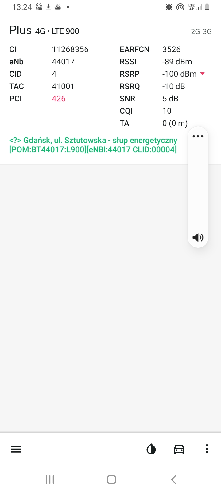

    I found a place where I caught the best, I did speed tests for 4 operators, the best is T-mobile about 49Mbps (Plus 20, Orange 11, Play 2) so it was on Sunday morning. I did not do it on the same phone and Play describes the 100GB promotion not as "top speed internet". Maybe you have to repeat it to be reliable, or decide on T-mobile?
