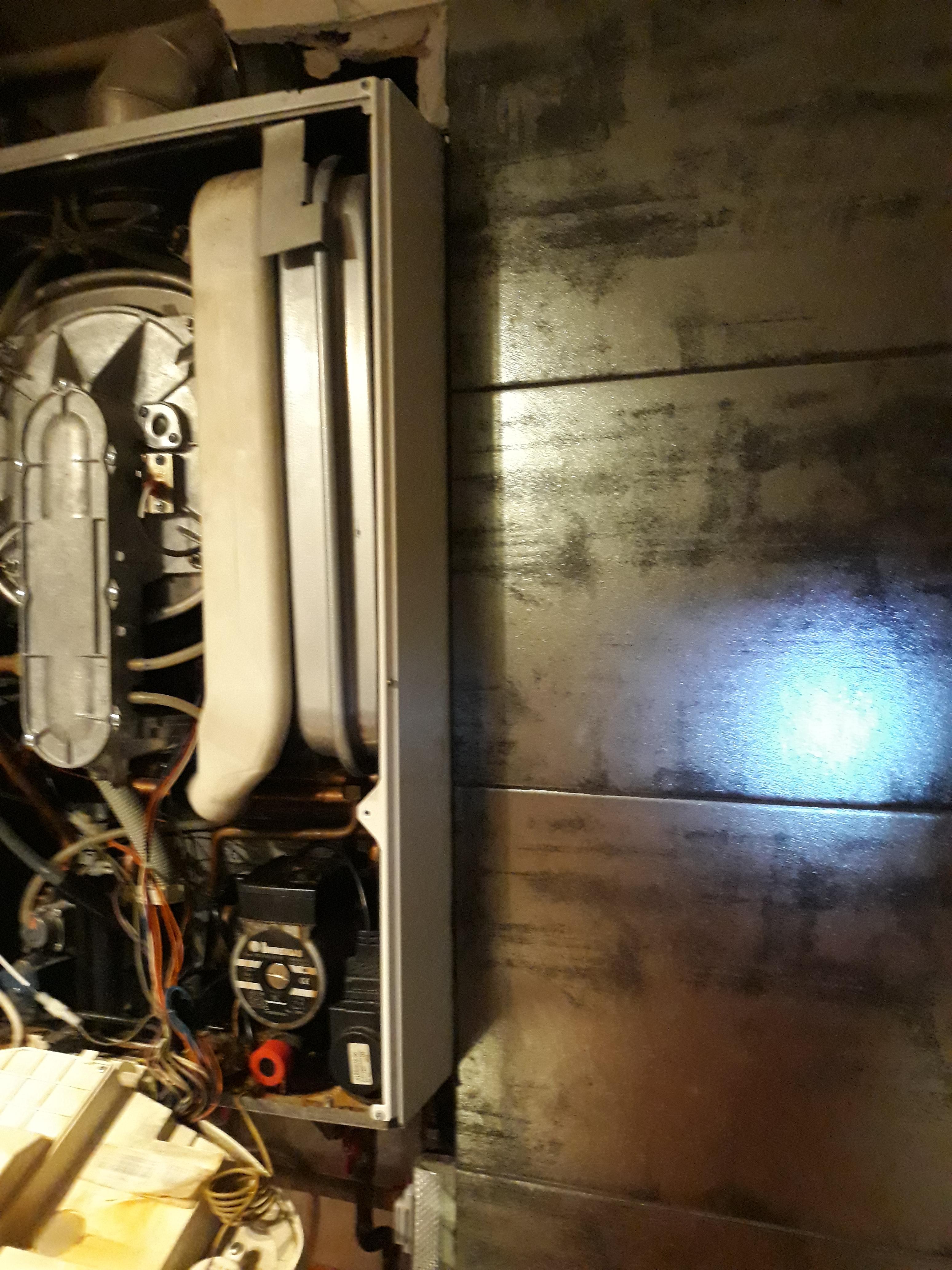

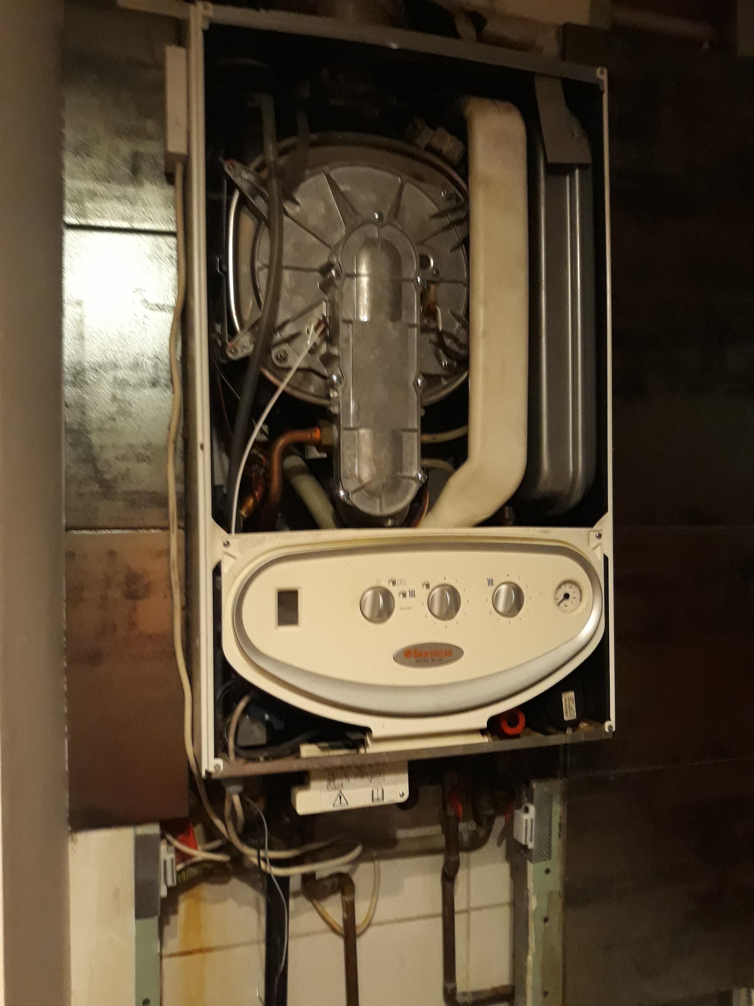

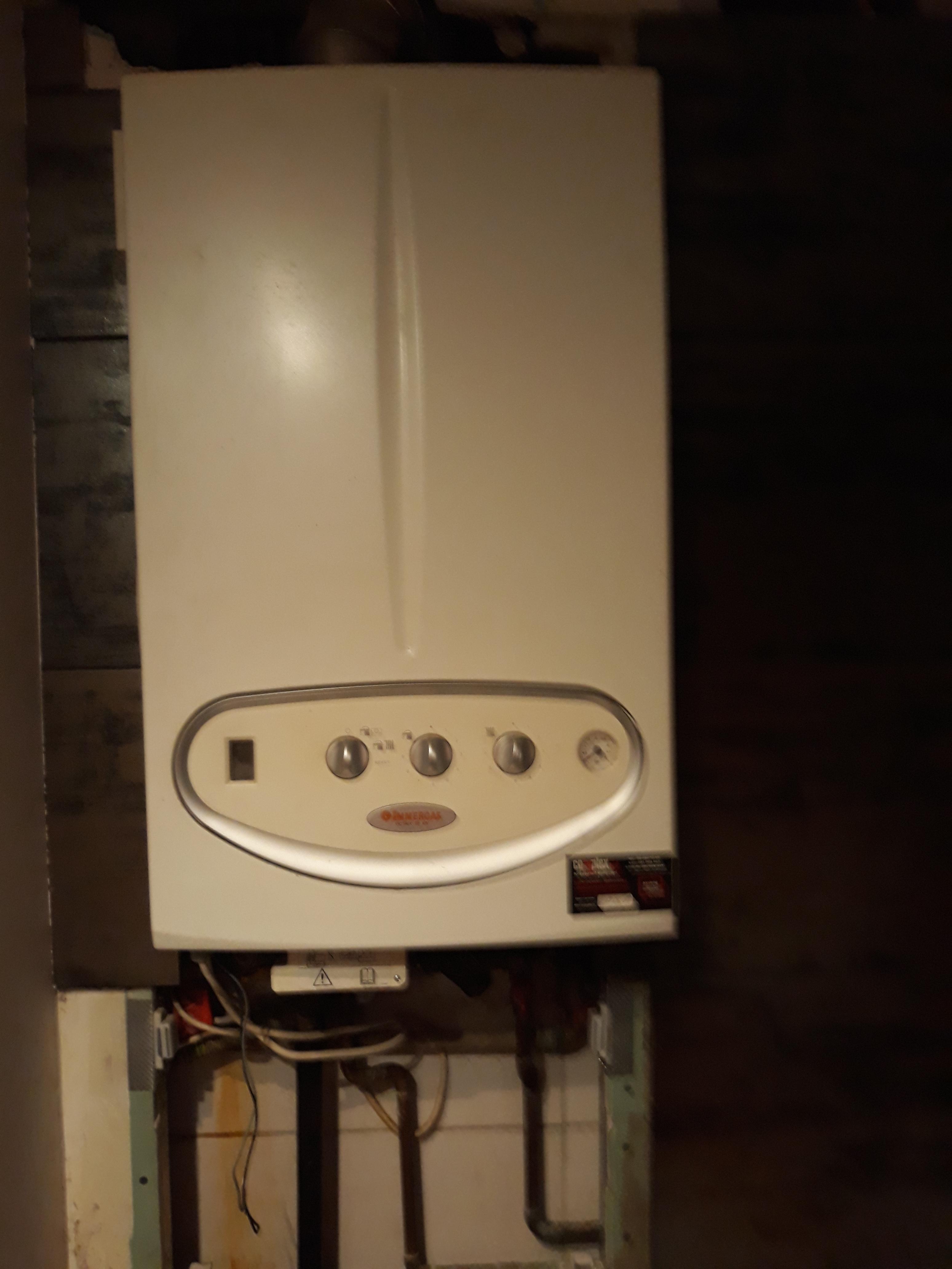

    After switching the boiler on, the error digit 10 flashes. What is and what can be done and how to fix this error? The pressure shows 1.3 a can be finished and higher, but the furnace does not ignite only the pulsating 10. There are no leaks anywhere. I called a specialist from IMMERGAS SERVICE and sang 1,200 PLN for repair. He said, from e is a circulation pump and also a safety valve. Added, from eh yes, when he puts on a pump with a valve, it may turn out that the stove is not shutting down !! would L I have literally 2 minutes ... at the door step, he said that in 2 days he will answer or have already bought a pump - to this day the guy is playing. Without from no response. This is an authorized IMMERGAS service technician. I can't afford such a repair. Mo from someone will help that? I am disabled, it is hard for me. I would forget that
    service technician on June 8 this year 2017 conducted a review of this furnace at the request of the Municipal Buildings Department, issuing a SERVICE PROTOCOL allowing the furnace to be operational in the presence of the Supervision Inspector of the Municipal Buildings Department. I picked up the flat as a tenant on 14/06/2017. So, six days after positive servicing, and here comes the awl from the sackcloth, namely that this furnace has been approved for use despite gross installation, because this furnace is encased in a structure made of profiles up to kg, this placed kg plates and ceramic tiles. The depth of the furnace is 24 cm, of which 14 cm is embedded permanently at its depth. To get inside, to remove the side walls of the furnace, you need to demolish / demolish the wall. The walls align directly with the side walls of the furnace, it is about 2 mm clearance. I repeat 2 millimeters. Maybe someone competent and helpful will read my post from e not only remove the failure but help from e, what to do with this pseudo professional!

    Invite another person who will want to know how to diagnose the boiler. It should have a photo badge with current dates and personal authorization of Immergas, as well as a current stamp, also a personal stamp with a service technician, not an installer. Don't be ashamed, check it out. List on Immergas website.
    First check the primary circuit pressure sensor in the boiler, then by checking the pressure with a car pressure gauge in the expansion vessel, verify the boiler pressure gauge.
    For now, use the reset button to start and let the water reach 2 bar.
    Regards
