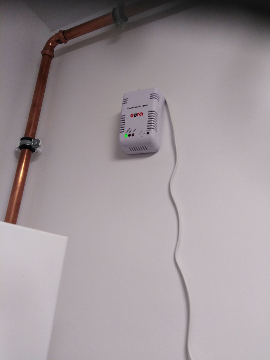

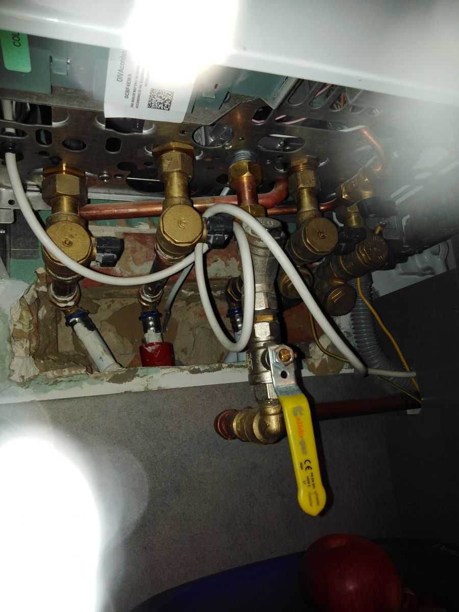

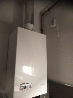

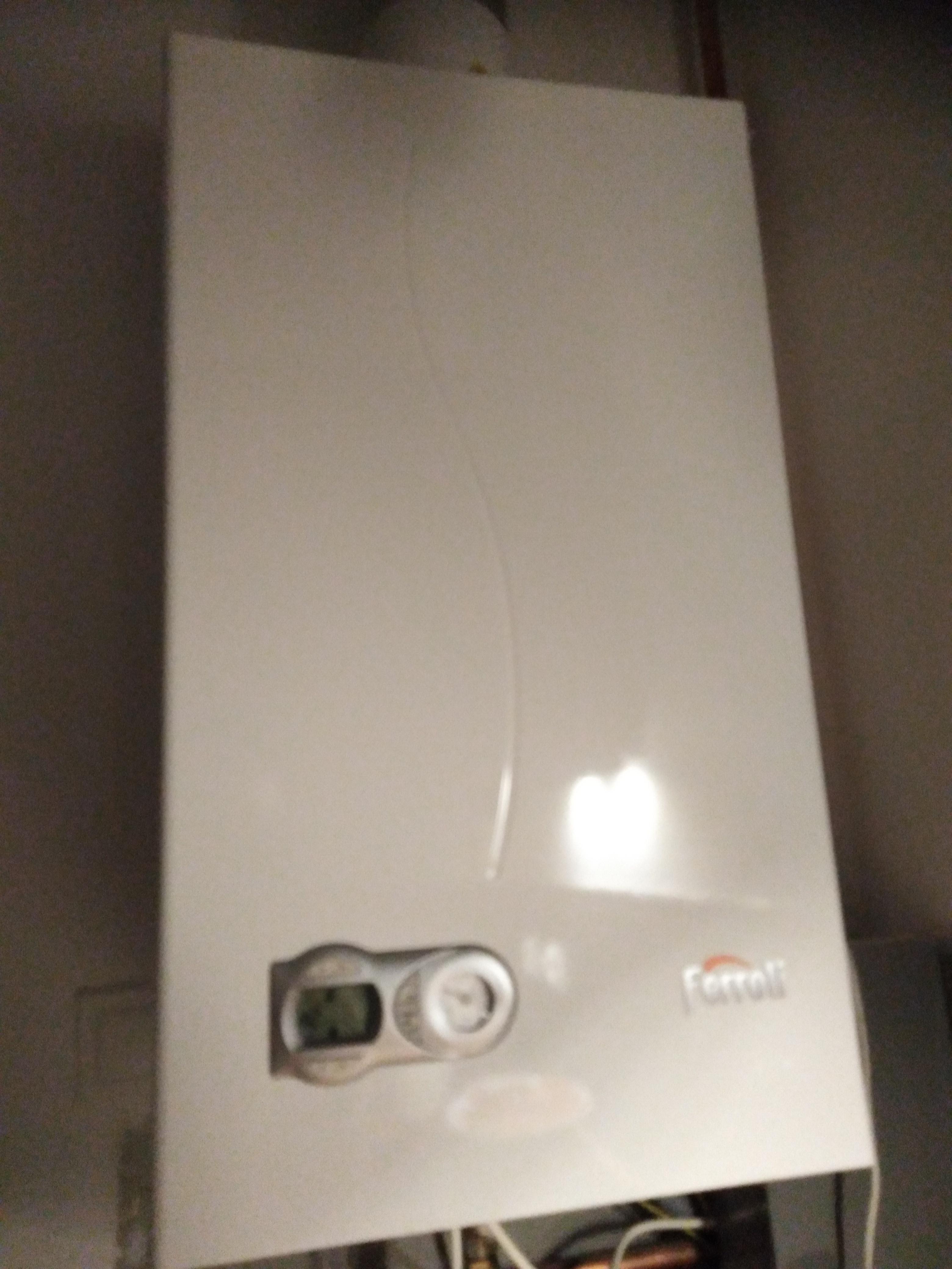

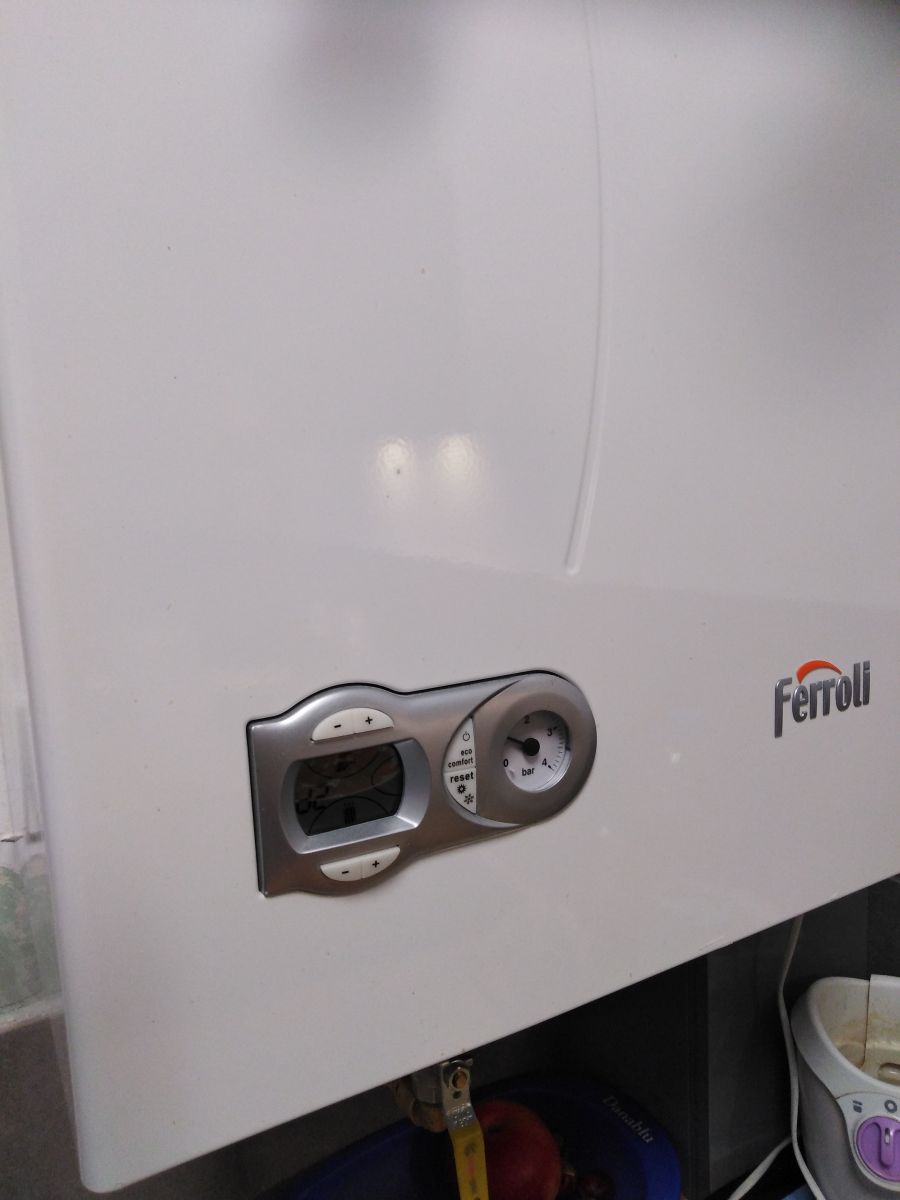

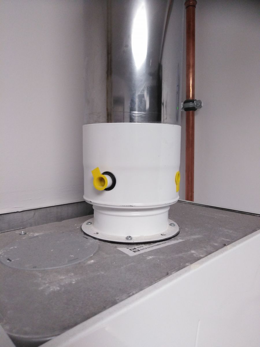

    Intermittent Activation of Gas Detector in Ferroli Divacondens Furnace and Gas Setup I added a picture
    The sensor and boiler are new. We live here for two months. We did everything new from A to Z

    1. What sensor such security and alarms. Buy something decent, not market cheap. Your friend suggested Gazex.
    2. I can't see the boiler from the pictures, but if it's an open chamber and an uninsulated chimney, the sensor is quite close and may heat up, and the measurement may be disturbed. Most instructions state about 1m or even 1.5m from the chimney, ventilation inlets/outlets, windows, etc.
    3. The sensor can react to other gases appearing in the air (e.g. propane-butane from deodorants or hairsprays, alcohol from perfumes, etc.) so it is worth checking whether, for example, we did not do something and then the detector worked.
    4. Semiconductor detectors can react to water vapor (mainly rapid changes), so a lover of an intense, hot bath can trigger an alarm.
