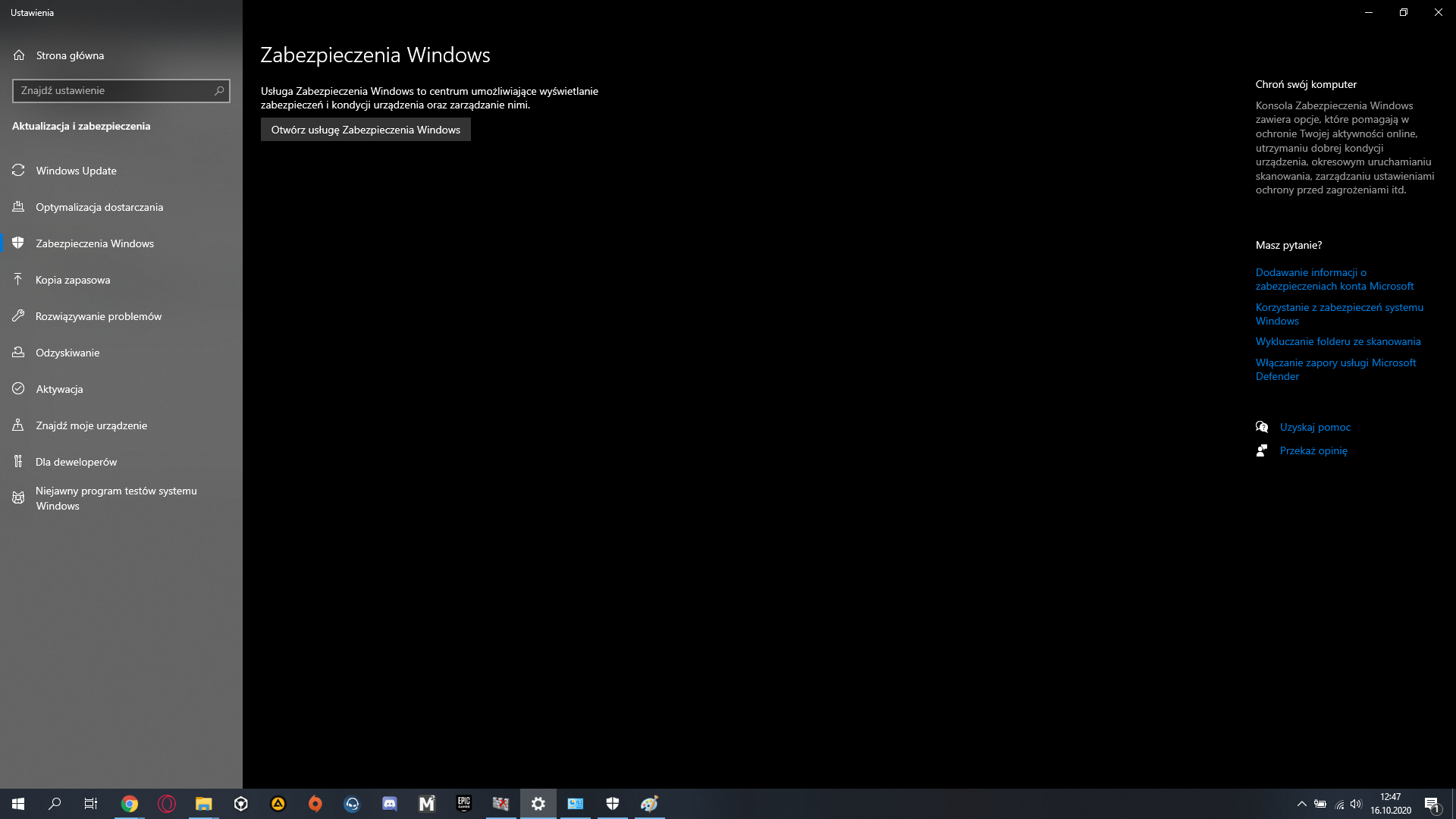

    Hello to all forum users. I come with a problem that I can't update my windows. I go into Windows update and I get this message "Your device is missing important security and quality fixes." When I press the button to search for the missing update, it takes forever. Windows Defender is still missing with this problem, but I have no idea how. It just seemed to evaporate. I would like to ask for help ;)

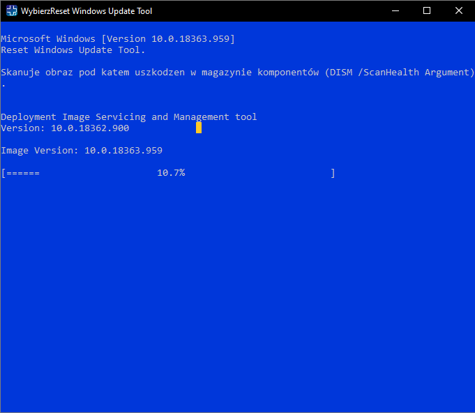

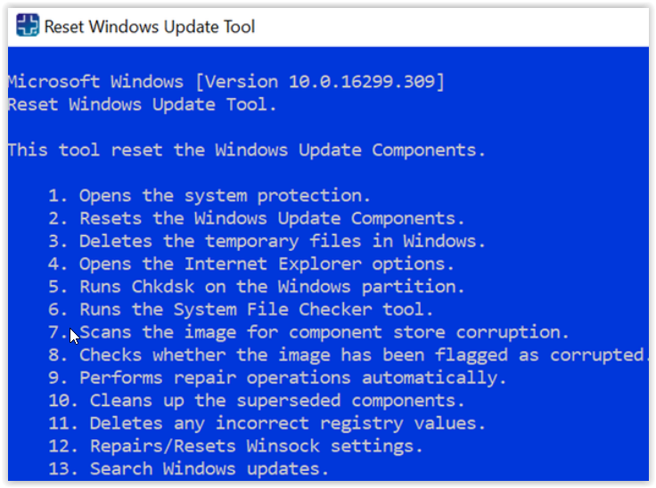

    I recommend trying the tool in my attachment.
    • Reset Windows Update Tool for Windows 32 and 64 bits.zip (4.76 MB) You must be logged in to download this attachment.

    And later FIX from the attachment.
    • PC-WELT-Fix Windows Update.zip (2.6 MB) You must be logged in to download this attachment.

    #15 18983050
    Kolobos
    IT specialist
    Posts: 85178
    Help: 17171
    Rate: 10455
    Broken WU service:
    Description: The wuauserv service terminated; the following error occurred:
    The specified file could not be found.
    Additionally:
    S2 wuauserv; C:\WINDOWS\system32\svchost.exe [53744 2019-03-19] (Microsoft Windows Publisher -> Microsoft Corporation) Microsoft Corporation) C:\Program Files (x86)\Common Files\Java\Java Update\jusched.exe [645648 2019-10-05] (Oracle America, Inc. - >Oracle Corporation)
    HKU\S-1-5-21-1708957488-3411949693-374295663-1001\...\Run: [CCleaner Smart Cleaning] => C:\Program Files\CCleaner\CCleaner64.exe [24552064 2019-10-14] (Piriform Software Ltd -> Piriform Ltd)
    HKU\S-1-5-21-1708957488-3411949693-374295663-1001\...\Run: [ALLUpdate] => C:\Program Files\ALLPlayer\ALLUpdate.exe [3930344 2018-11-10] (ALLPlayer Group sp. z o.o. -> ALLPlayer.org)
    HKU\S-1-5-21-1708957488-3411949693-374295663-1001\...\Run: [Subtitles24Update] => "C:\Program Files (x86)\Subtitles24\Subtitles24Update.exe" "sleep"
    HKLM\SOFTWARE\Policies\Mozilla\Firefox: Restrictions C:\Program Files\CCleaner\CCUpdate.exe [608384 2019-10-14] (Piriform Software Ltd -> Piriform Software Ltd )
    Task: {A7D0C650-57E8-426A-8C0B-7B14E7A56FF8} - System32\Tasks\CCleanerSkipUAC => C:\Program Files\CCleaner\CCleaner.exe [18458752 2019-10-14] (Piriform Software Ltd -> Piriform Ltd)
    Task: {B1419CFC-8547-4430-9365-CCAC74D4BD1C} - System32\Tasks\Opera GX scheduled Autoupdate 1589362342 => C:\Users\hugix\AppData\Local\Programs\Opera GX\launcher.exe [1654808 2020-10- 07] (Opera Software AS -> Opera Software)
    • wuauserv.zip (1.24 KB) You must be logged in to download this attachment.
