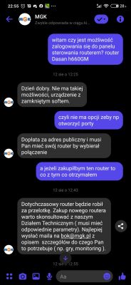

    Hello, I have a problem with the DASAN H660GM fiber optic router, I got the router when installing the Internet, but it is not possible to log in to it to even change the password. I have dynamically assigned IP of course, I tried all the addresses 192.168.xx, in ipconfig the local address is 172.17.1.1 but it also doesn't work. I would like to somehow unblock the ports in it.

    At the moment, the only thing I learned from BOK is that the router has soft blocked, today I asked about the ports, they wrote back that they would send a message to the technical department, we'll see what's next, the technical department did not write back today.
    Added after 6 [minutes]:
    Problem with logging in to the DASAN H660GM router, site unreachable
    I can also attach a conversation with a Consultant

    I would like to find a way to log in to this router panel. Nowhere have I seen such a problem that it is impossible to log in the same way as I have not yet encountered a router with IP 172.17.1.1 instead of the standard 192.168.1.1
  • #25 18982692
    jimasek
    Posts: 35287
    Help: 3783
    Rate: 2681
    rezzox wrote:
    At the moment, the only thing I found out from BOK is that the router has soft blocked
    I do not understand what you are looking for, since BOK said that there is no access to the router? That's their security policy and that's it. By signing the contract you agreed to it.
