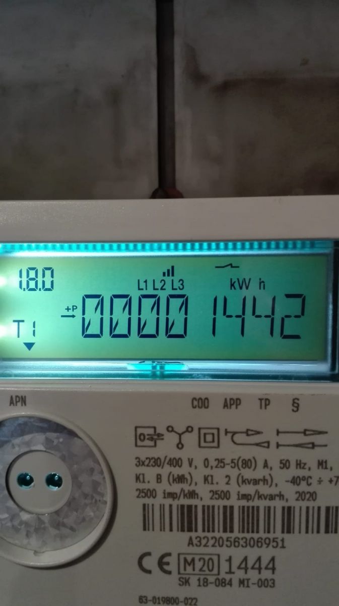

    I have a problem because I don`t know how to read the counter. When I watch some guides on YT, there is a visible comma everywhere, but for me it looks like in the photo.
    And now the counter reading is 144.2 or 1442 kWh?

    For me it`s 1442 kWh

    Otus counters do not display a comma in their default configuration. These are full kWh, i.e. 1442 kWh. The comma may only appear after entering the counter into test mode.

    So it looks like it has been working in test mode for me for a year? I have one digit after the decimal point displayed.
    I also have a question. What does the "flashing" N mean? Phases L1, L2, L3 are "on" constantly, but N is "flashing" next to them?
