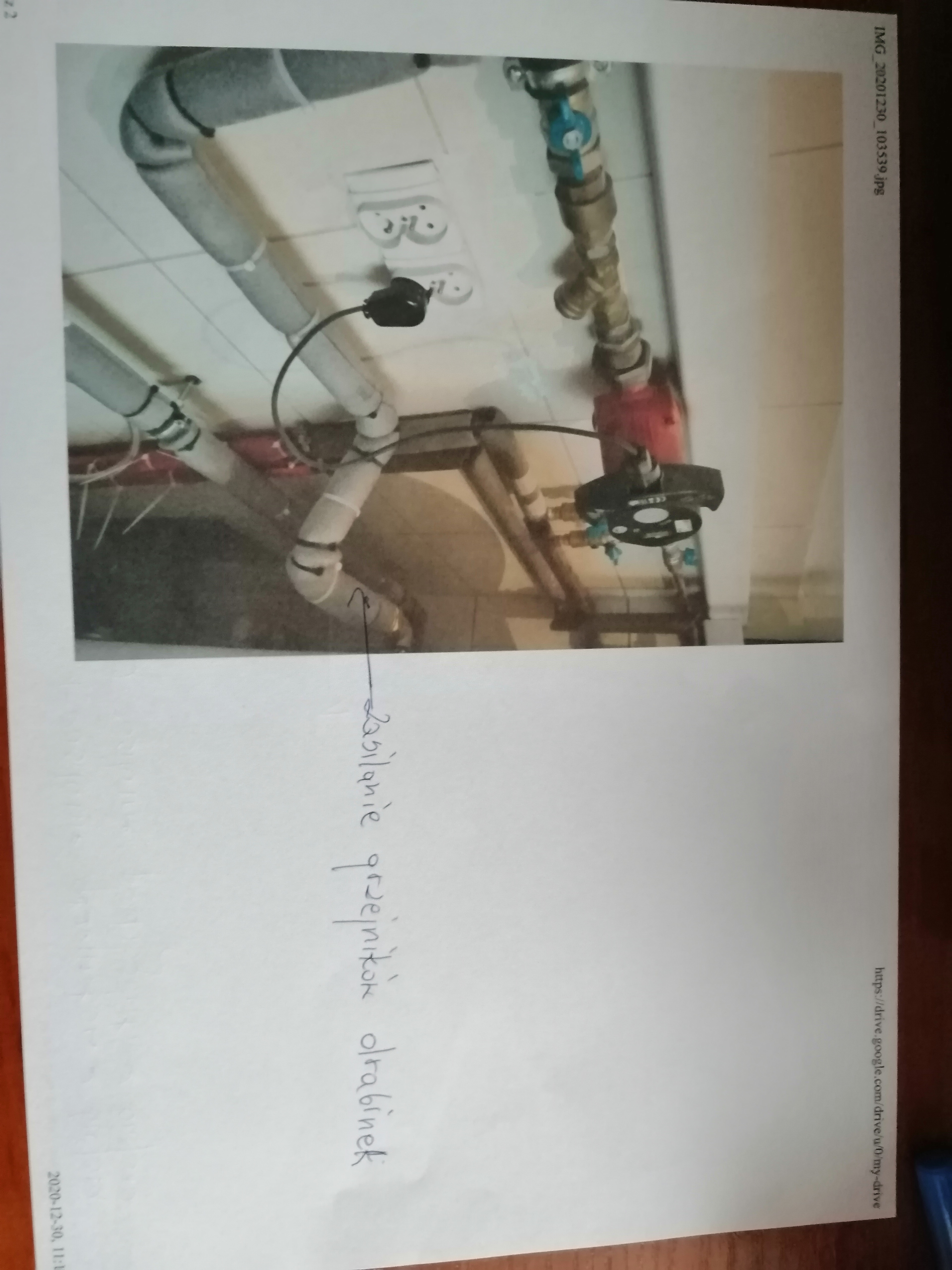

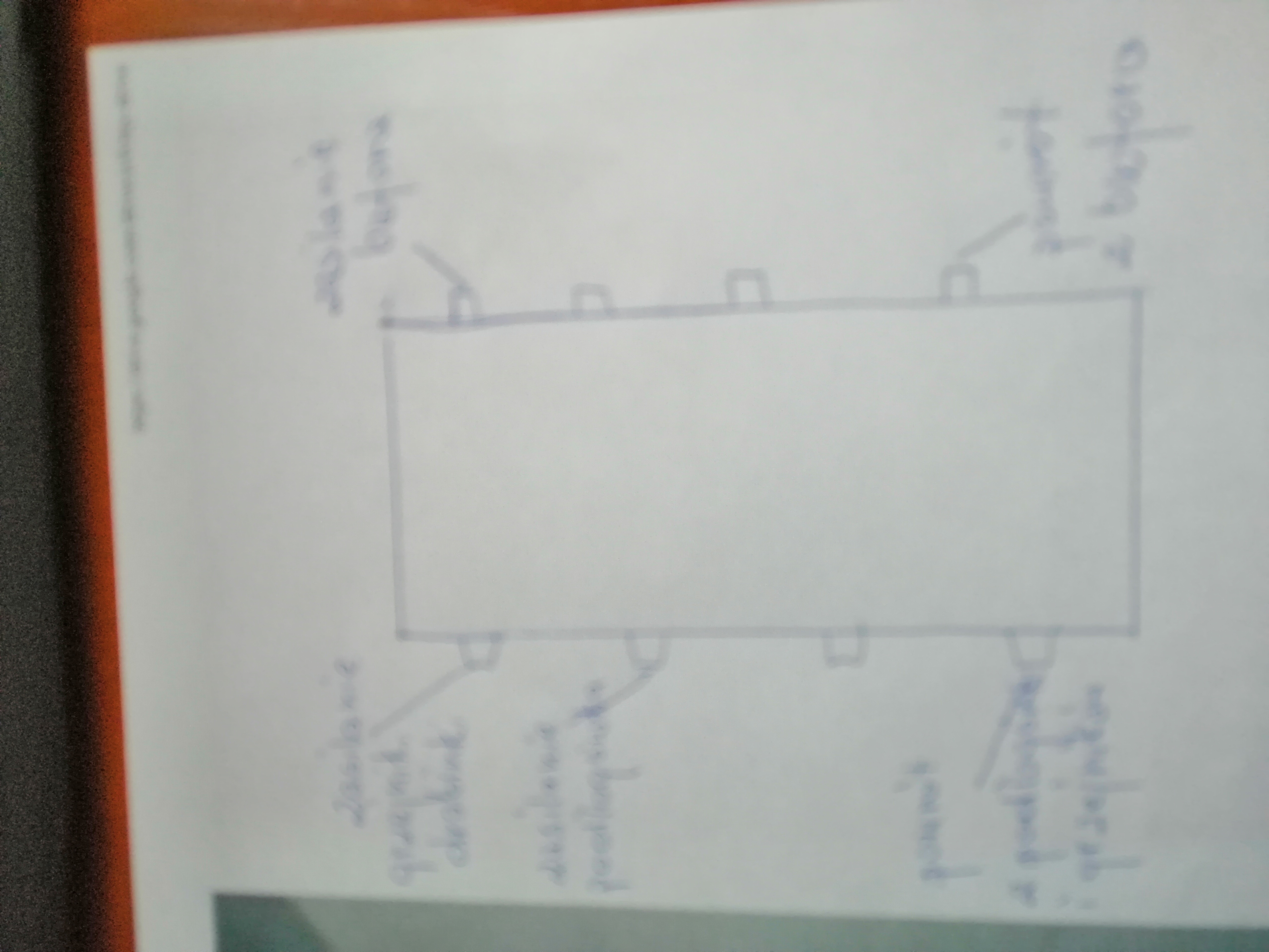

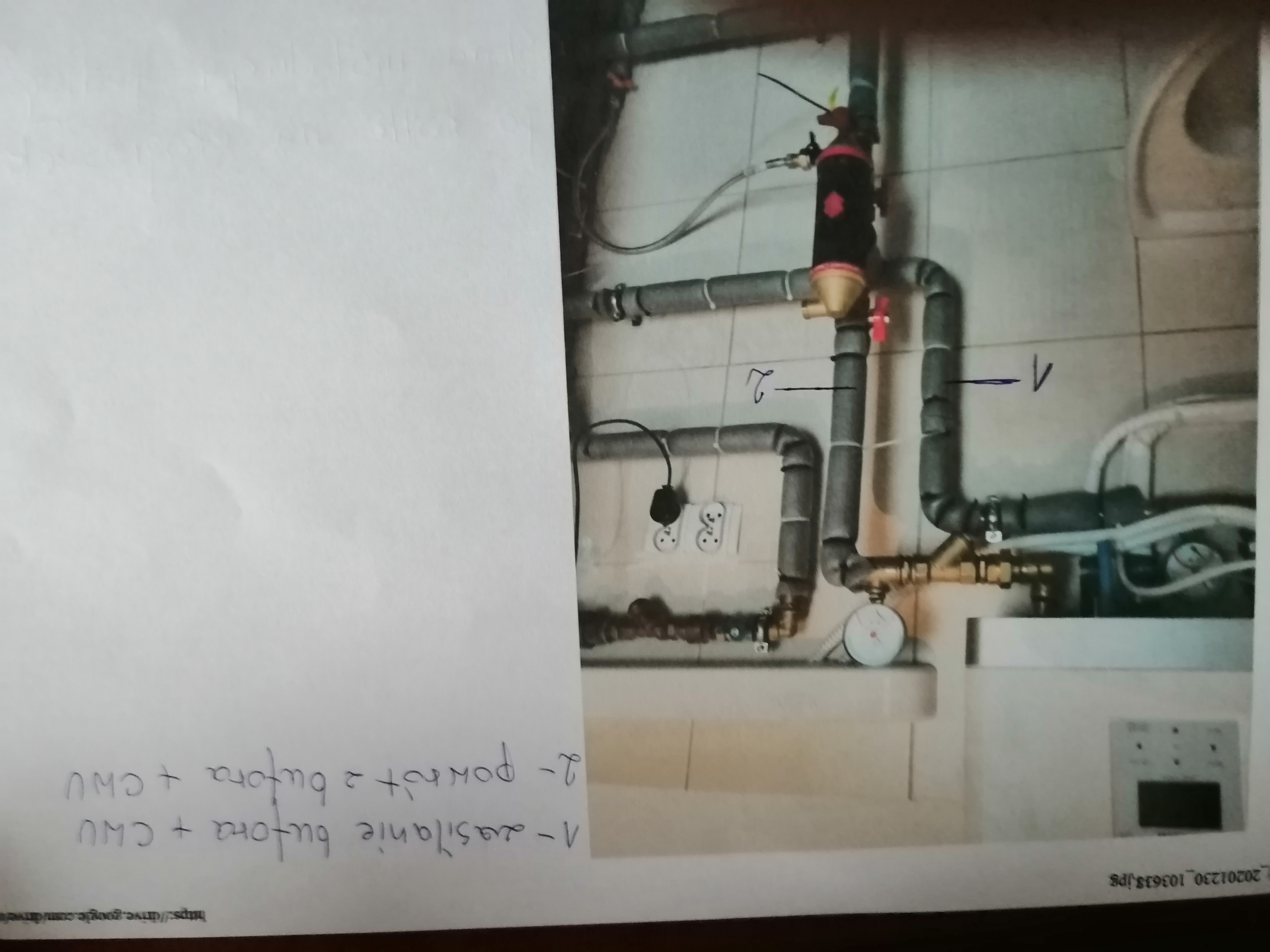

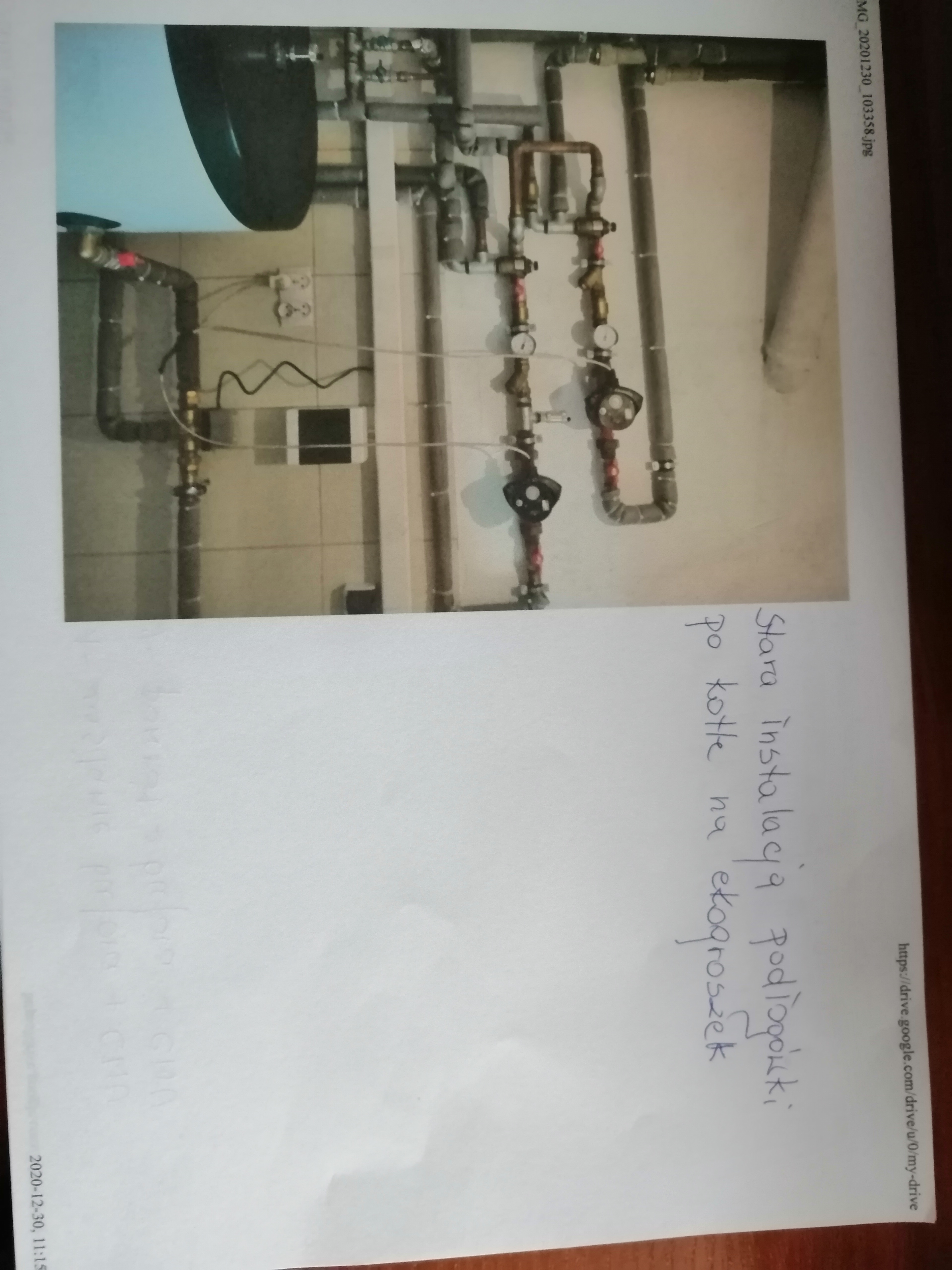

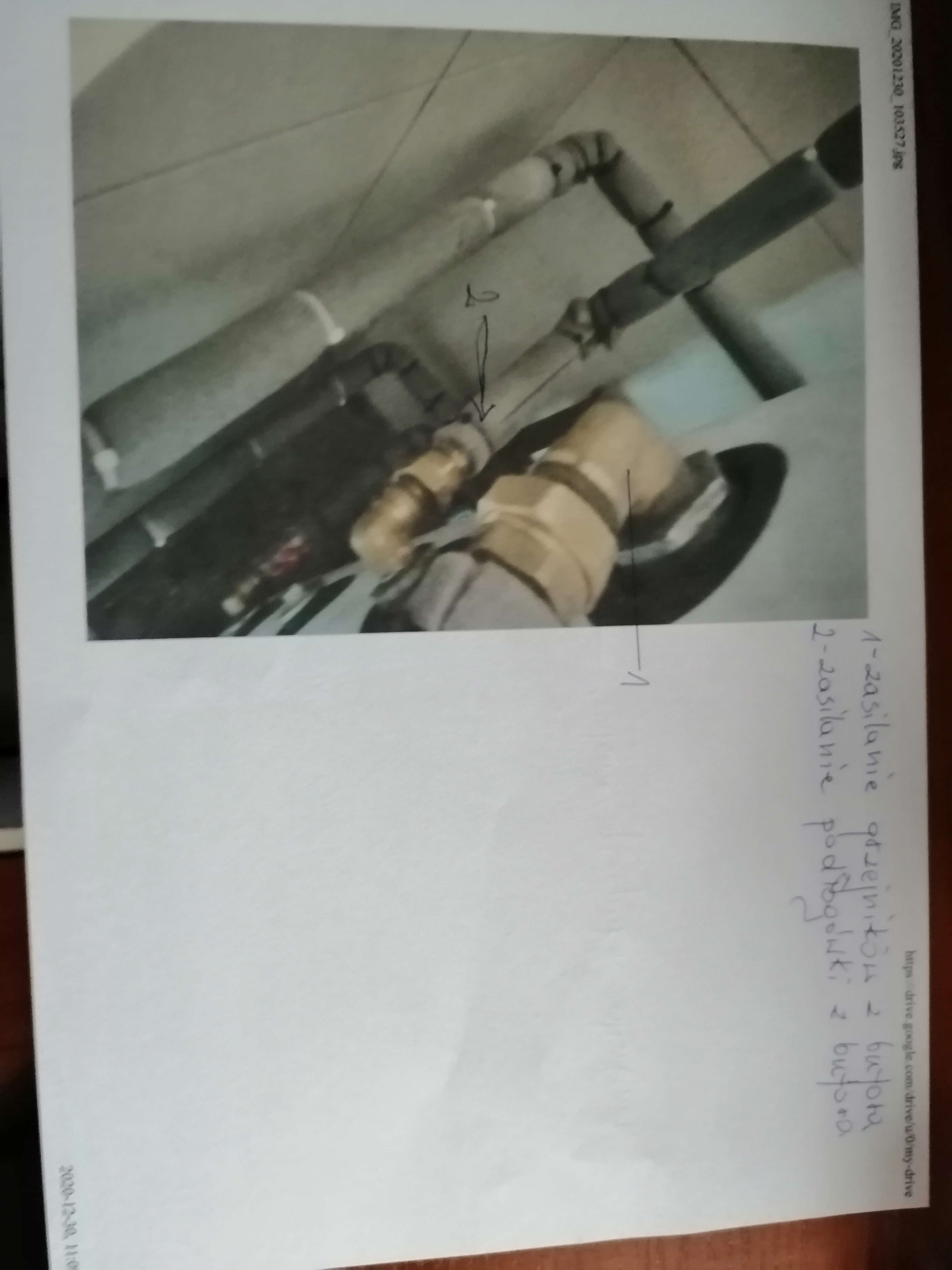

    Good morning, I have a Kaisai air-water heat pump, installation with a buffer and underfloor heating, every now and then I get an error for low water flow and the pump turns off, which may be the reason. Regards
  • #2 19146401
    Plumpi
    Heating systems specialist
    Posts: 7998
    Help: 861
    Rate: 2627
    Probably too little flow.
    Have you checked the filters? Maybe an airlocked system?
    How do you have the buffer connected? As a coupling or in series?
    Do you have floor shorts? Radiators? Any controls? Valves?
    With so little information about your installation, we can only guess.
  • #3 19146463
    truskawek37
    Posts: 412
    Rate: 51
    I had an eco-pea coal boiler, I replaced it with a PC, power supply for the buffer and DHW from the heat pump, further from the buffer, output to the installation of floor heating on the ground floor - upstairs, 2 pumps behind the buffer on the ground floor and upstairs, three-way valves for floor heating, the installation was left after the boiler, 2 ladders in the bathrooms are powered from the buffer, return from the buffer and HUW connected to the heat pump
    Added after 3 [minutes]:
    I installed the buffer so that the pump sees the buffer and has the right amount of water to prevent frosting, not what is behind the buffer, I just wanted not to modify the already existing installation.
    Added after 1 [hours] 19 [minutes]:
    I'm sending photos

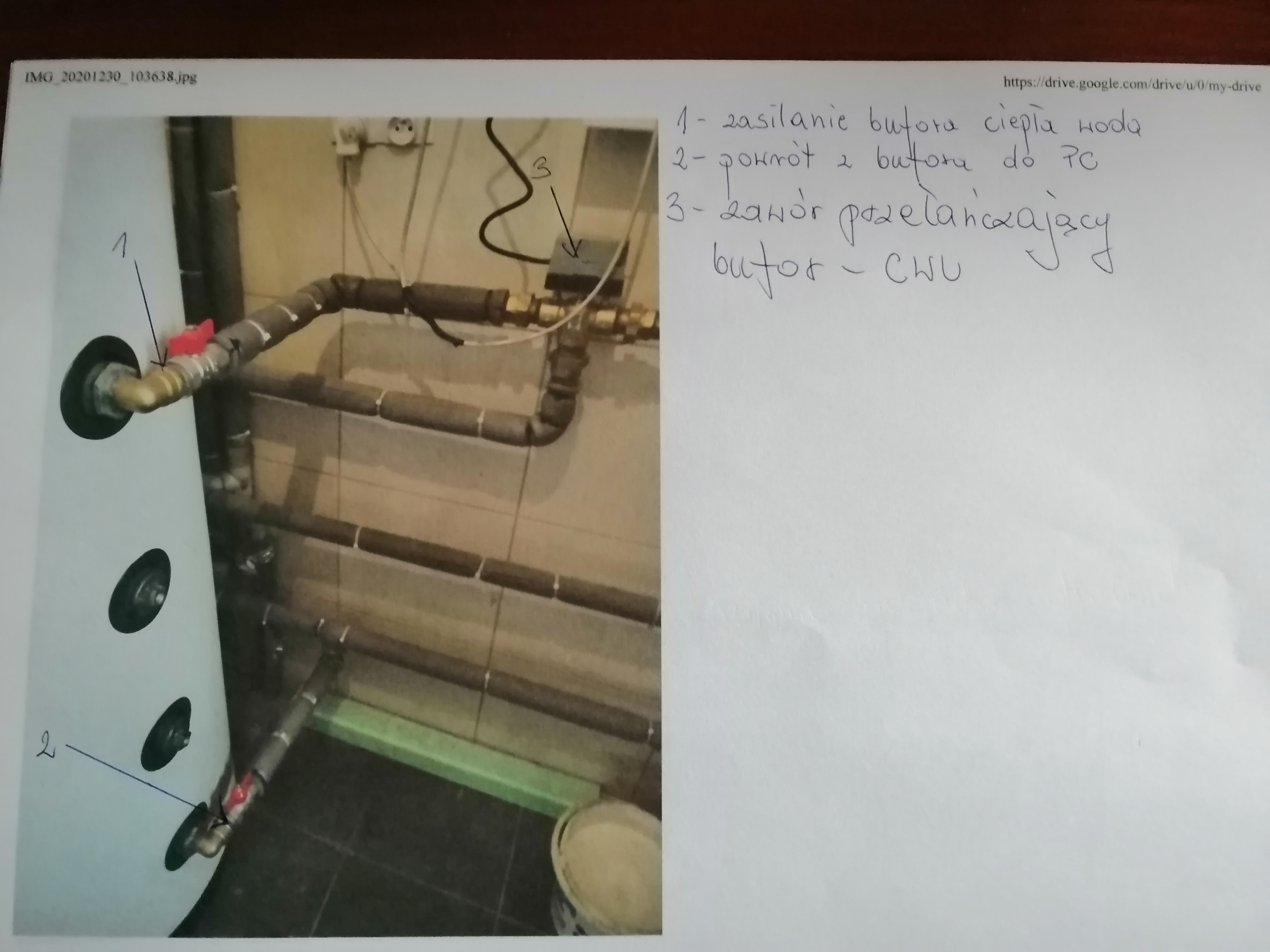

  • #4 19192126
    truskawek37
    Posts: 412
    Rate: 51
    Buffer connection
    • Kaisai Air-Water Heat Pump Error: Low Water Flow Issue with Buffer and Underfloor Heating IMG_20201230_113730.jpg (3.06 MB) You must be logged in to download this attachment.
