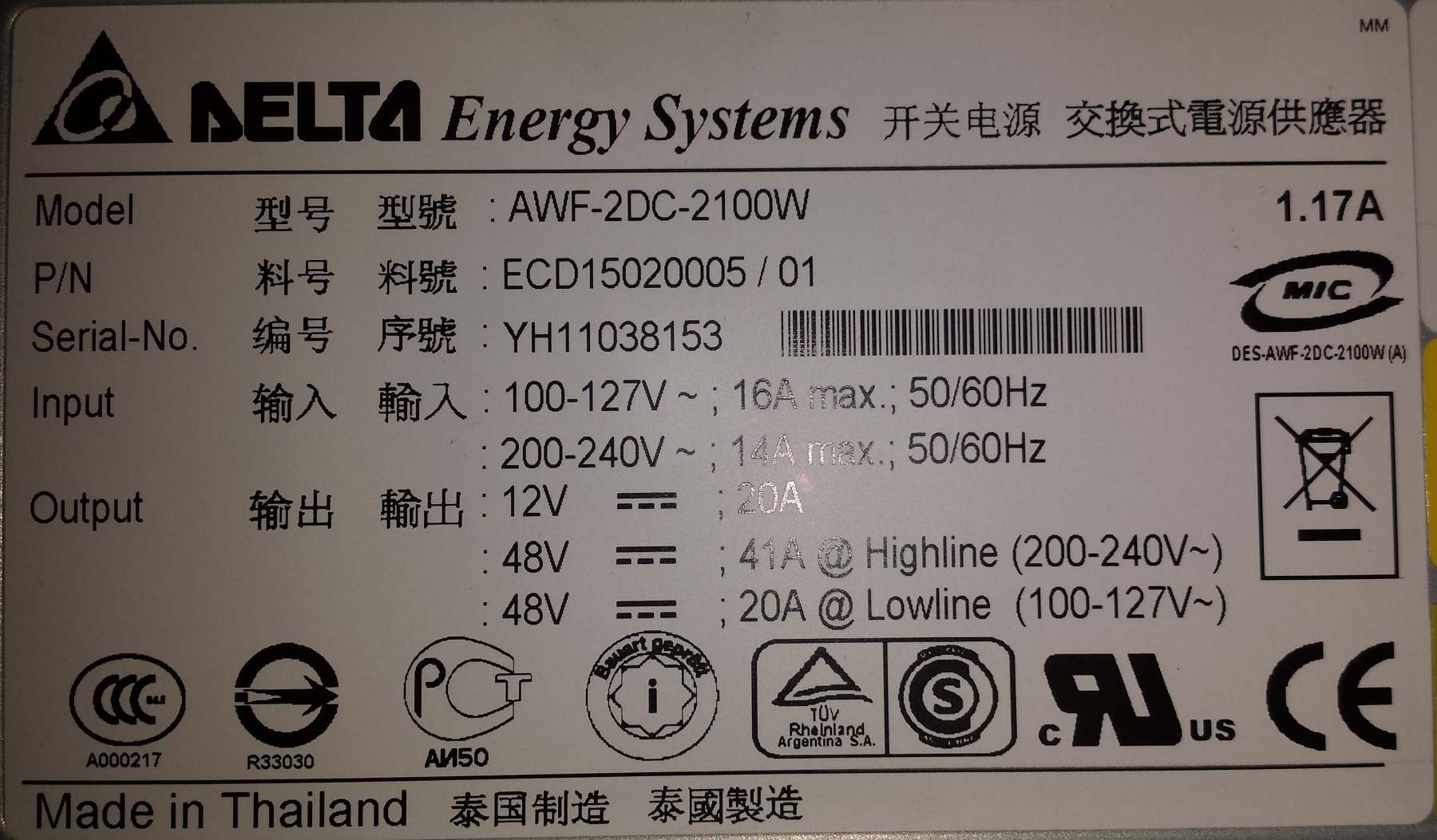

    The power supply mentioned in the title comes from the SPARC Enterprise M4000-M5000 family of servers. I need a "pinology" of the control socket of this power supply.
    Can some of my colleagues help?

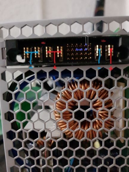

    I also found this photo (I even included it in my post, but the vigilant moderator removed it for me)
    The power supply starts up after such a connection, but for me it is not enough.

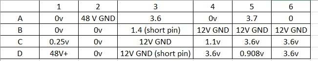

    Maybe some of your colleagues know the specification of the power connector on the SPARC M5000 server. That would set me up.
    These servers also use ASTEC power supplies with the symbol AA23990. This power supply has an identical power connector
    Added after 11 [minutes]:
    I found something like this or someone can confirm it because there are some discrepancies in these data:

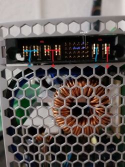

    Due to the need to use this power supply on an ad hoc basis, I managed to drive the fans
    adding the PWM regulator on the TC648B with a thermistor and it flashes.
    But the topic is worth reviving because the cost of a server power supply that offers really high power is ridiculously low.
    So it would be worth taking full advantage of its possibilities.
