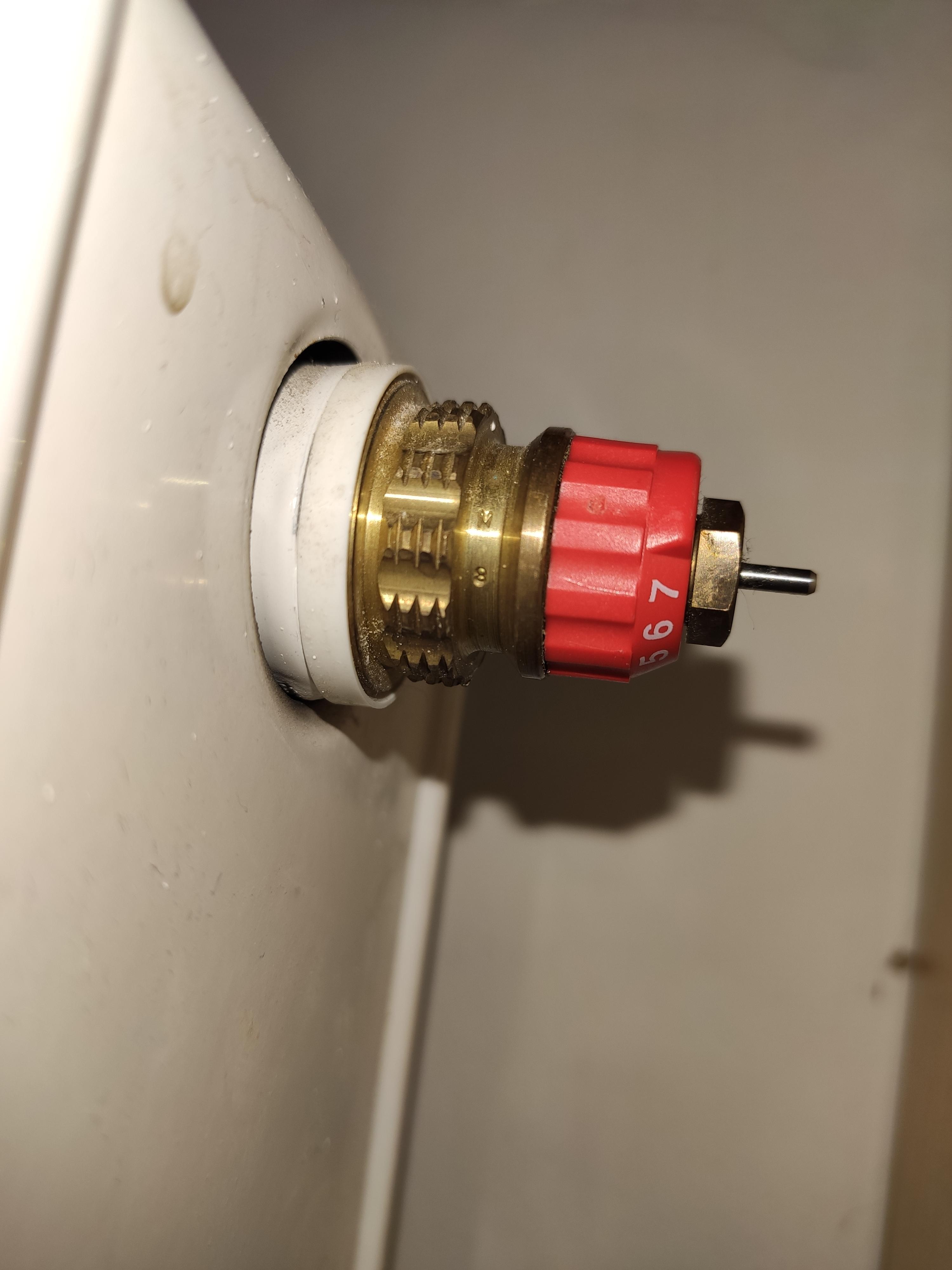

    Hello. I have a question, maybe someone had a similar problem. I have a radiator with a head (as in the photo). I am unable to turn it off. When I turn the red head with numbers, it turns easily in every direction. The only thing I can do is to slightly reduce the flow of water and heat in the radiator (the noise of water in the radiator decreases). I can`t turn off the radiator. At the bottom of the radiator I have such valves (2nd photo). Thank you in advance for any help.

    The photo shows only the valve, someone has dismantled the thermostatic head.
    The flow is controlled by how deep this protruding "rod" is pressed.

    You have two options, either you "find" a cap that you screw on instead of the head and then cut off the water flow to the radiator, or you unscrew the two caps at the bottom and close the water flow to the radiator there.

    I bought the apartment "with a radiator included" a week ago. And I discovered a partially hidden radiator behind the cabinets that cannot be turned off. The photos show the existing condition. Is there the correct valve under the caps? And I can easily unscrew them - the caps? And only under them is a valve that will block the water flow to the radiator?
    You can unscrew the caps, there should be Allen keys under the caps, about 6 mm, screw them on and it`s ready. You can even dismantle this radiator - that`s what these local valves are for.

    Screw a new head onto this valve and you will easily close the hot water flow to the radiator.

    The radiator is behind the cabinets and the head was probably not installed due to lack of space. There is still a cap, but it is from a specific valve manufacturer, as it may not fit from another one, and you will probably need to screw the valves under the radiator.
    the entire element in the first photo is a connection with shut-off valves, one on the supply and the other on the return.
    There will be Allen keys under the nuts, which can be used to completely disconnect the radiator from the installation.
    In practice, this valve is used to isolate the radiator from the installation for the duration of some renovation, maintenance, etc., or you can do the so-called orifice, i.e. limit the water flow and thus reduce the amount of heat the radiator will give.
    In the second photo you have a thermostatic valve, which requires a thermostatic head to work properly, which is missing in your case.
    The red element is used to make the so-called initial adjustment and setting the appropriate water flow.
    You can limit the water flow only with the red element or additionally with those at the bottom in the first photo.
    If you want the radiator to heat, you need a head, and if you want to "turn it off" completely, you turn both Allen keys on the lower connection and that`s it. But sometimes, after unscrewing these nuts, water may leak from the Allen key at the bottom. If the connection is functional, after unscrewing the nuts at the bottom, no water can leak there and it must be dry.

    Thank you for your answers and help. It was enough to unscrew the caps at the bottom and tighten the appropriate valve with an Allen key. Regards
