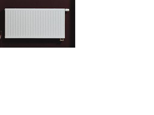

    Hello, have you never seen a radiator like this?
    Comap thermostatic head – radiator heats on snowflake at 9–10°C, why?
  • #18 7436525
    J. Kleban
    Level 25  
    Posts: 935
    Help: 12
    Rate: 190
    Honestly, I haven't seen it :-(
    Does anyone have his picture on the other side?

    J. Kleban wrote:
    ... Does anyone have his picture on the other side?
    And there may be a cross-section:
  • #20 7441327
    J. Kleban
    Level 25  
    Posts: 935
    Help: 12
    Rate: 190
    Thanks for the photo !
    I see that I have been left behind :-)
    But that's nothing, a man learns all his life and dies stupid.
