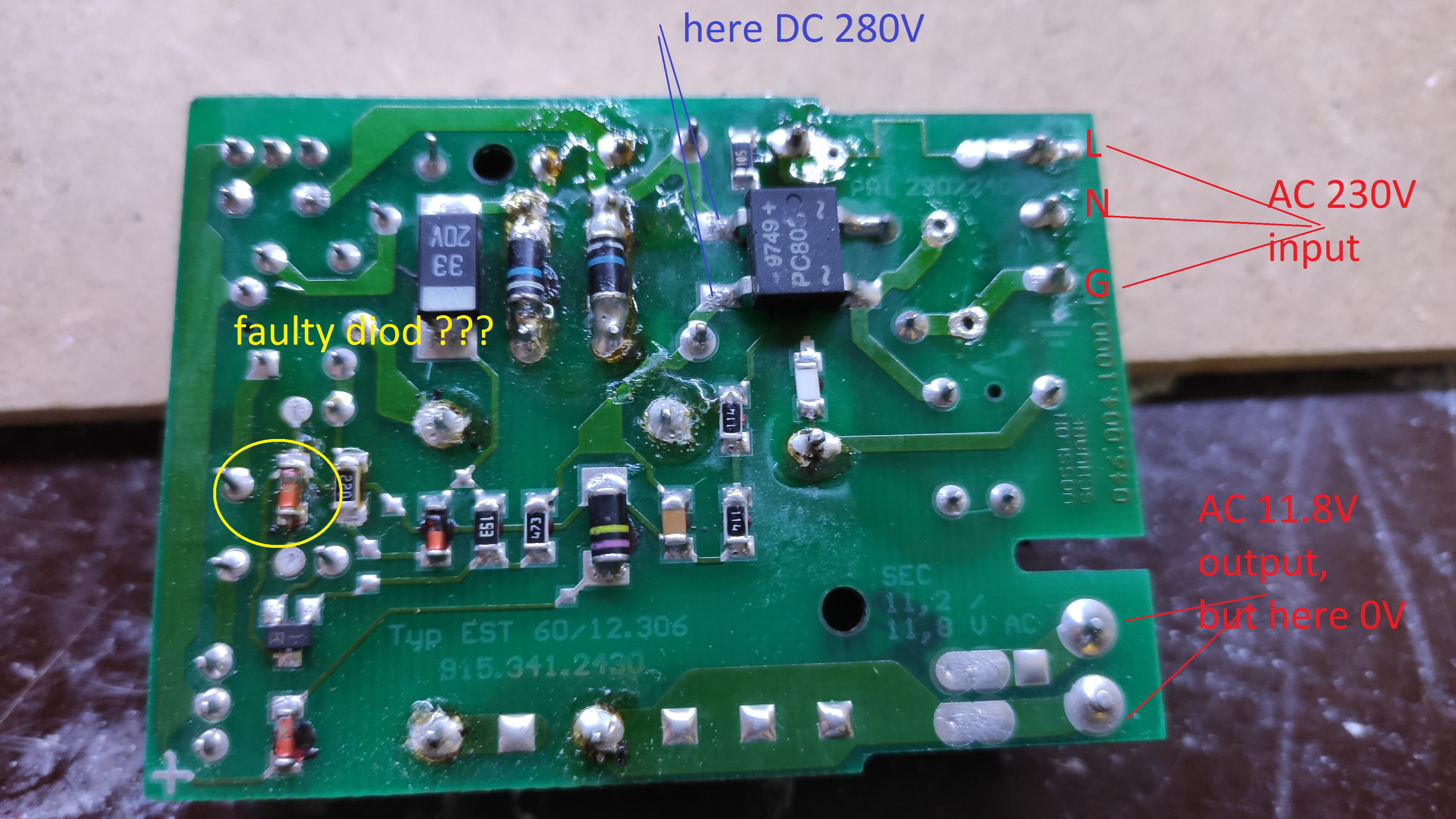

    Hello, I need help to diagnose this simple (but not for me) power supply for halogen light, I have found nothing shorted, all capacitors ok, transistors also ok, only one diode (if it is diode) marked in yellow circle on picture is OL (digital multimeter shows OL). Where could be problem, thanks in advance for any help
    • Power Supply Issue: Halogen Light AC 11.8V Output Not Working - Diagnosing Components 1609419717661.jpg (2.84 MB) You must be logged in to download this attachment.
    • Power Supply Issue: Halogen Light AC 11.8V Output Not Working - Diagnosing Components 1609419717655.jpg (4.21 MB) You must be logged in to download this attachment.

    The measurement diode must be removed. If the meter continues to read 0, the diode is shorted and must be replaced.

    All semiconductors for measurement outside the wafer
