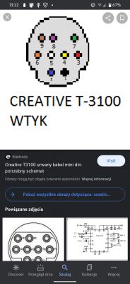

    Broken DIN 9 Pin on A320 Creative Speaker: Need Pin Identification for Reconnection
    here is a pinout but I also need help ... which pin is for what, I am specifically interested in which pin is for the subwoofer?

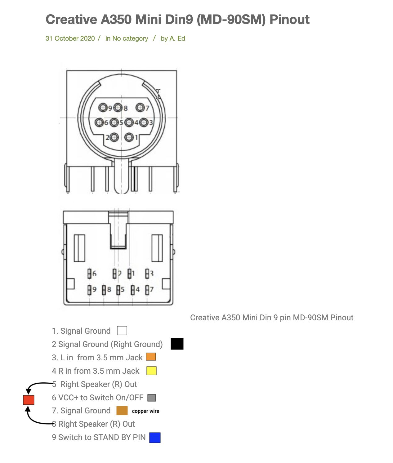

  • #7 21541043
    kiezekaelin
    red >>20738726
    Diagram of Mini Din9 (MD-90SM) connector pinout for Creative A350 with pin descriptions.
