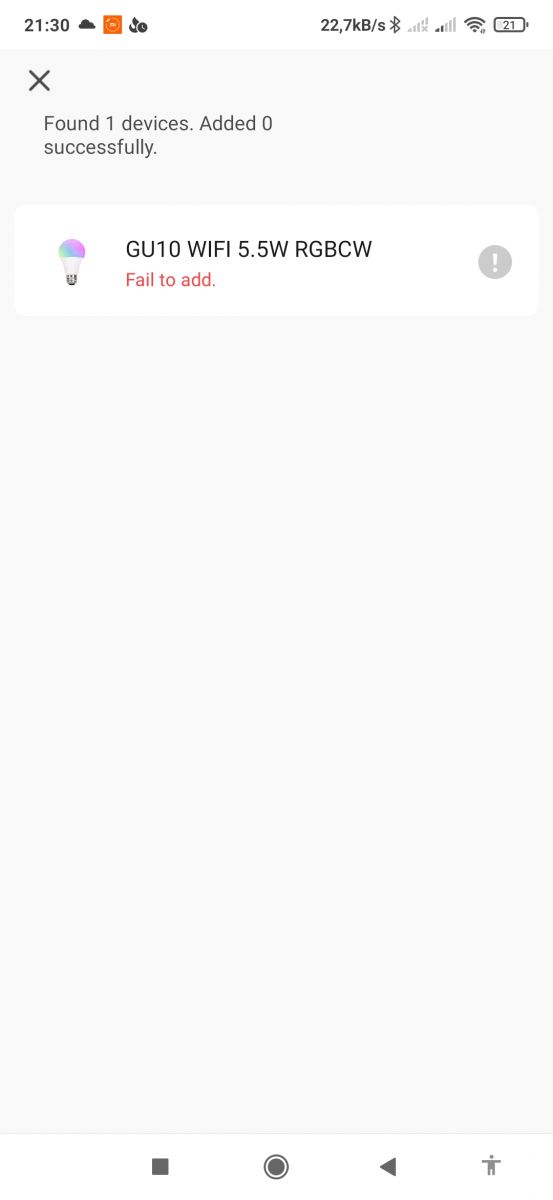

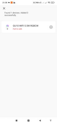

    Hello. I recently purchased smart bulbs. I can not connect them to the phone, I did everything according to the attached instructions without effects. In the end, I tested them by connecting through the hot spot created on the second phone where they connected without any problem. And here the question is, what could be wrong that they do not want to connect via the normal internet. I connect on the 2.4G band.

    Bulb model: Kobi Smart LED GU10 5W RGB
    What else information? All I know is that this is not a light bulb or telephone problem. I tested on another phone with the same result and only creating a hot spot and connecting to it gave the effect and it worked without any problems.

    If the bulbs connect to the hot spot on the phone (which I assume you had at hand), it means that they work and I would look for the problem elsewhere.
    I bet on Wifi. Perhaps one of the devices (light bulb or phone) was not connected to the same wifi network all the time when adding the device to the app

    So I know as much as before. I just don't know why there is a problem with the wifi. The bulbs need to be paired so they do not connect immediately to the first better wifi, only in the application you need to select the network and then they start to connect, I made sure several times that the wifi was selected properly (2.4 band).

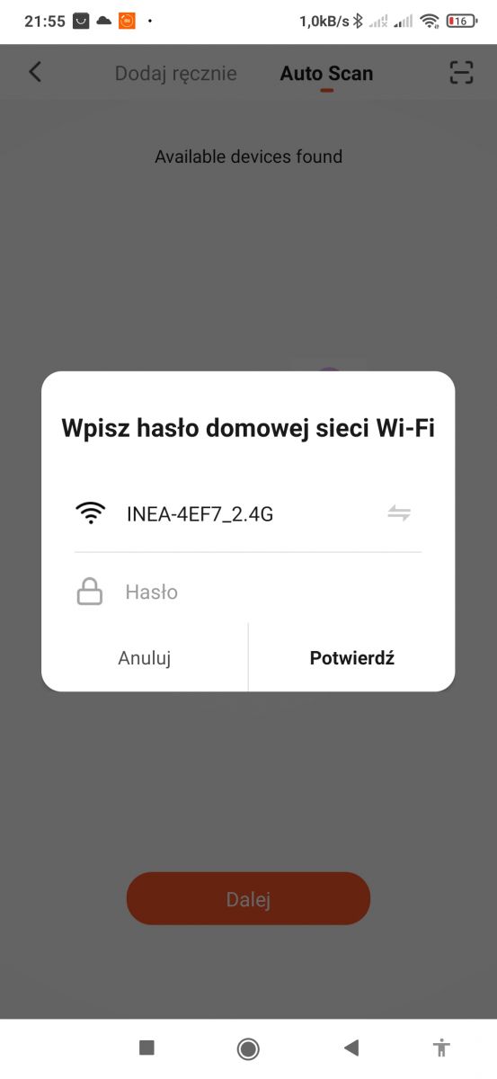

    The simplest mistake that comes to my mind is maybe you entered the Wifi password incorrectly on the app?
  • #7 19293151
    Neaxx
    Posts: 10
    Well, I have entered the password so many times that I already enter it from memory, but it is correct because I always check it. I managed to connect one bulb, but when unscrewed and screwed in it was described as "off the mains". As if she did not see wifi suddenly, although I have a router in my room.

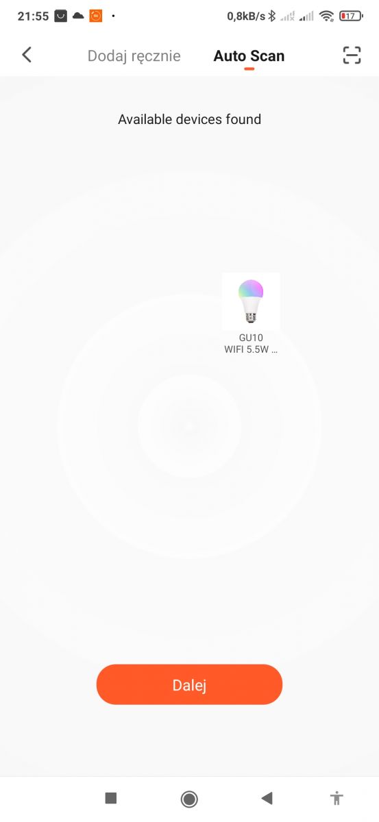

    Are you trying to add bulbs manually or by car? After looking at the photos, I played with my dimmers. I noticed that in automatic mode, the app does not detect devices. Maybe that's the problem

    Check how your WiFi security is set - this may be the problem. Try to set WEP and see if it will connect successfully.

    -App location must have access to full location (not just while running)
    -The device (Android for me) must have unchecked permission to locate devices nearby in the settings of the pairing application
    Then the app easily found and I could add a bulb-type device
    (even in 5 GHz network)

    So much setting, playing and it was enough to give these two permissions to the application (for me on android 13) mentioned in the above post and everything works without a problem ...

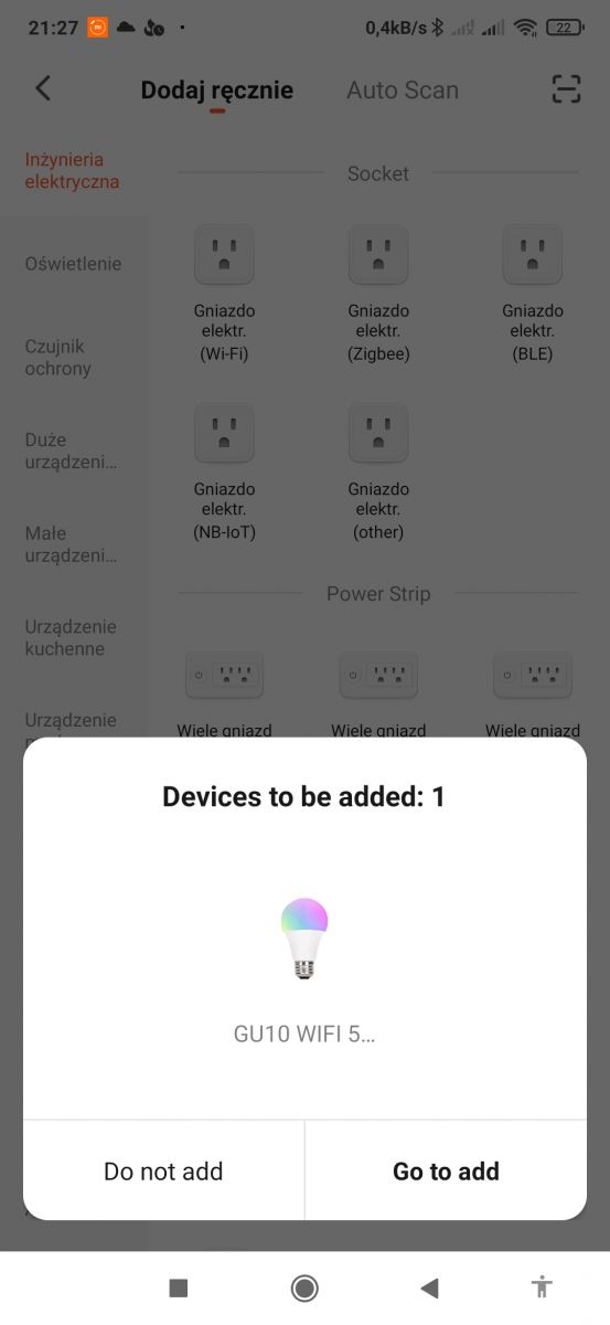

    With me everything worked without a problem until. The moment I changed my router from UPC to Play BOX NET router HFC (KAONMEDIA CO., LTD) everything went haywire.
    The problem is that the app (Smart Life or Tuya) detect the smart LEDs with no problem but the add process takes several minutes and fails.
    When I do a hotspot from the other phone then the add process goes through without a problem.
    Adding location permissions etc doesn't help (by the way, through the hotspot everything works and I don't change the app permissions)
    the router is definitely to blame, but I don't know what else I can set there to make the process of adding smart LEDs successful.
    I also have the same problem with the air purifier, the air conditioner and the Roborock hoover.
