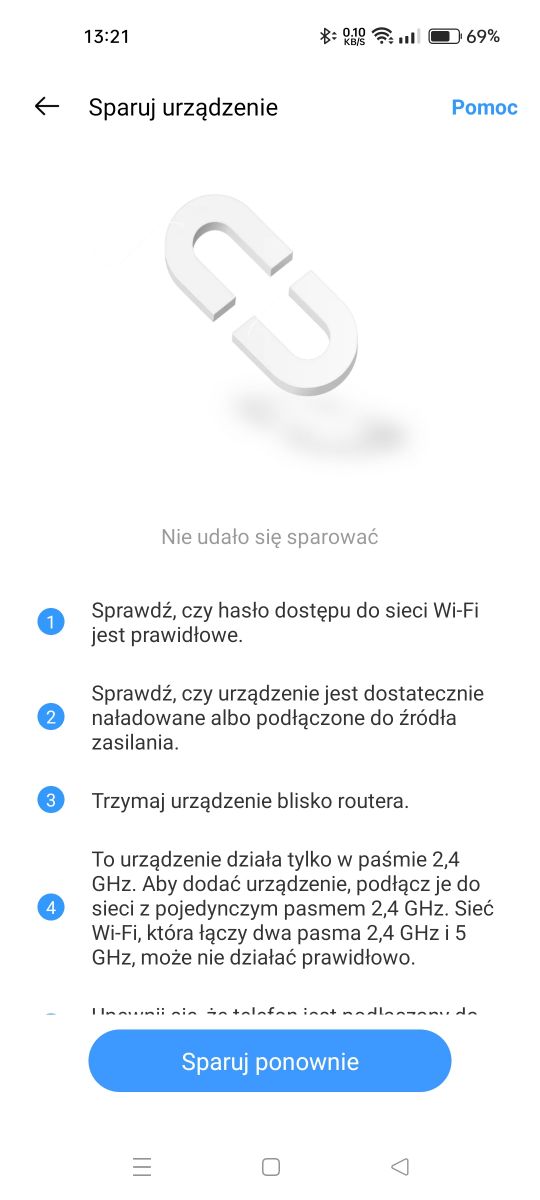

    App screen showing a pairing error with suggestions on how to resolve the issue. Hello, I have a problem with the smart bulb. Namely it does not want to connect to the app. I keep getting a message like the one in the picture.
    #2 21387867
    Posts: 14747
    Rate: 12847
    And, according to the picture, the network is surely 2.4GHz?

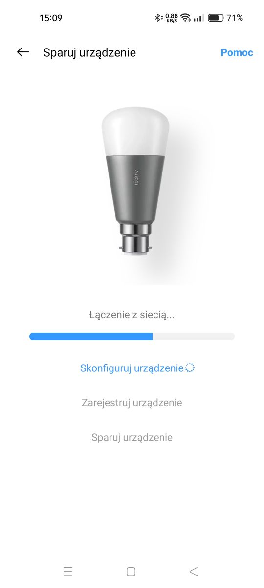

    Screenshot of a device pairing app showing the bulb configuration stage. Hi, during pairing it gets to this point and sort of crashes. I thought it was the app's fault, but it's the same on another phone.
  • #6 21388082
    Posts: 14747
    Rate: 12847
    And do you only have one piece of this bulb? I'm just asking because it might be worth trying on another piece.
