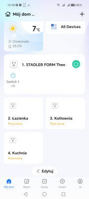

    Being at home I can control them both via home wifi and with wifi off. BT I have disabled completely. While at home I can check the network connection status of each of these sockets, their address etc. I am very surprised that while at home I can control them using mobile data and while at work I cannot.
    While at work I use the company wifi and the mobile data. In both cases I cannot control just these three sockets. The others shown in the picture I can seamlessly regardless of my location.

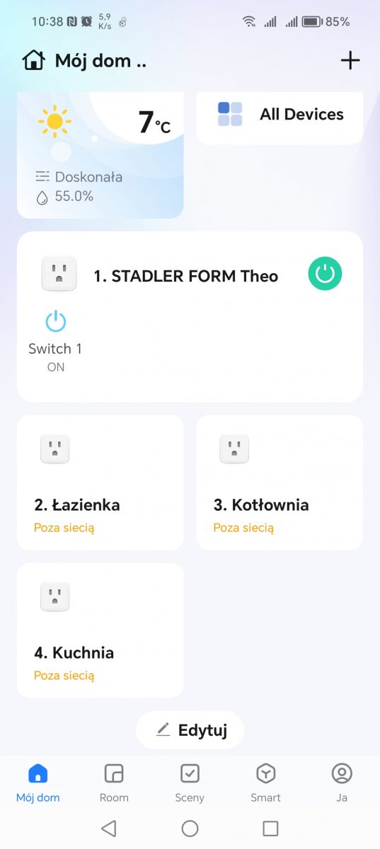

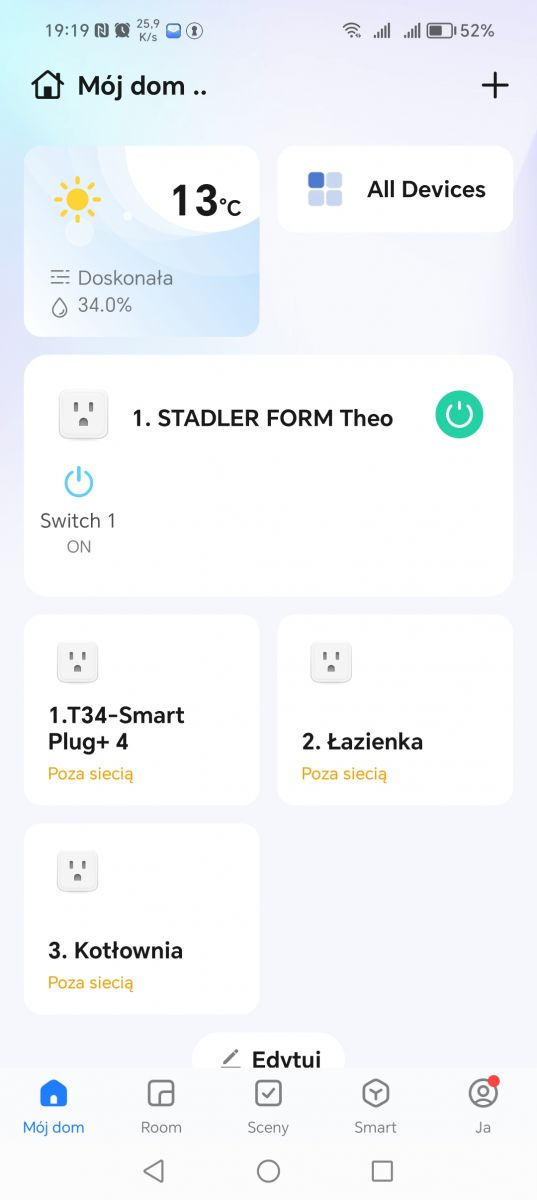

    The status of the app when I am 'away' from home is shown in the image below.
    Smart home app screen showing connection statuses and weather. .

    I would rather be inclined to think that we are leaving something out. To the best of my knowledge Tuya has no way of 'determining' whether you are connecting over mobile internet from home or work. This is provided that when testing at home you have WiFi and BT turned off.
    I'd sooner look for the problem somewhere else, e.g. maybe you have that WiFi on at work and someone on the router has blocked the Tuya ports (but then it wouldn't connect at all), or e.g. when you leave for work someone in the family turns off the extension cord to save electricity....
    Well, but the next step of diagnosis would probably be to determine if then these sockets are working when you are e.g. outside the house? Or on the road...
    Maybe, for example, you paired these sockets with a hotspot on your phone or something.... disconnect them from the app and pair again, making sure you give the home WiFi directions.
    You can also try at home to go into the router, into the DHCP address list and determine the IP addresses of these sockets and enable pinging of such an address on the laptop and look to see if, for example, the socket somehow loses connection to the router.
    In the console, type (change IP address to socket address).
    ping 8.8.8.8 -t
    Maybe by some miracle there is an IP address conflict or something else is causing the router to not see the socket, only then, it would be more of a coincidence that it disappears when you are at work.

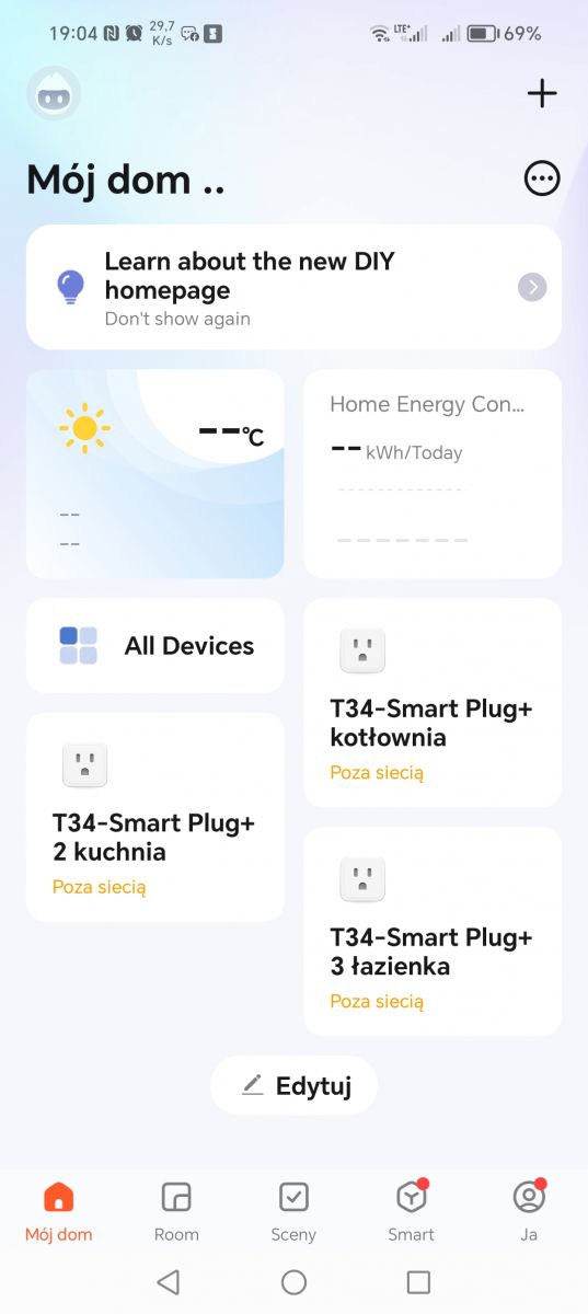

    After yesterday's tests, a little clarification has been made:
    1. it's not the network that's the problem - I'm at work now and I can control the sockets and view them.
    2) The sockets lose contact with the network after some time, even when they are switched on. Simply unplugging them from the power supply and plugging them back in immediately returns them to normal operation. Switching them on and off manually using the button on the housing does not help.
    3. these sockets are T34-Smart Plug+.
    In the socket settings, as well as the app, all options that can put them to sleep are disabled.
    This is not the action I would expect.
    One thing puzzles me. In the settings for these sockets I have an item for "Relay status" which is a radio channel controller for remote control of devices. I have the option set to "Remember last status". It seems to me that the setting is correct, but maybe change it to "ON"?
    I'll try installing Tuya today, maybe the app itself doesn't feel like working properly with these sockets, although that seems unlikely to me.

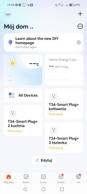

    Added after 10 [hours] 50 [minutes]: .
    And all three outlets off the grid. Roughly 12 hours after being plugged in they lose the network. Regardless of whether any operations were performed via wifi or not. Where to look for a rescue?
    Screenshot of a smart home management app showing the status of sockets. .

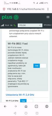

    Added after 13 [minutes]:

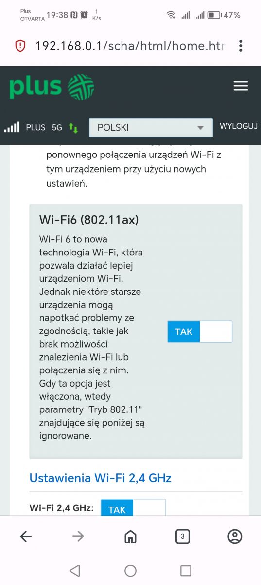

    I logged into the router and found something like this:
    Screenshot of a router configuration interface with information about Wi-Fi 6 (802.11ax). .
    Maybe this is causing these problems?
  • #11 21490928
    Posts: 14699
    Help: 656
    Rate: 12744
    Try switching off and checking

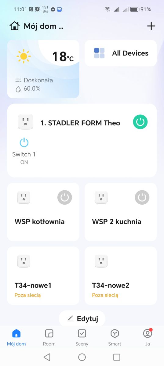

    I did an experiment and again bought two Chinese sockets at a promotional price of 3.80pln each. Such a promotion for new users. The T34s arrived. I connected, configured and just when I thought it was ok.... the sockets are out of network.
    Mobile app screen showing the status of smart home devices. .

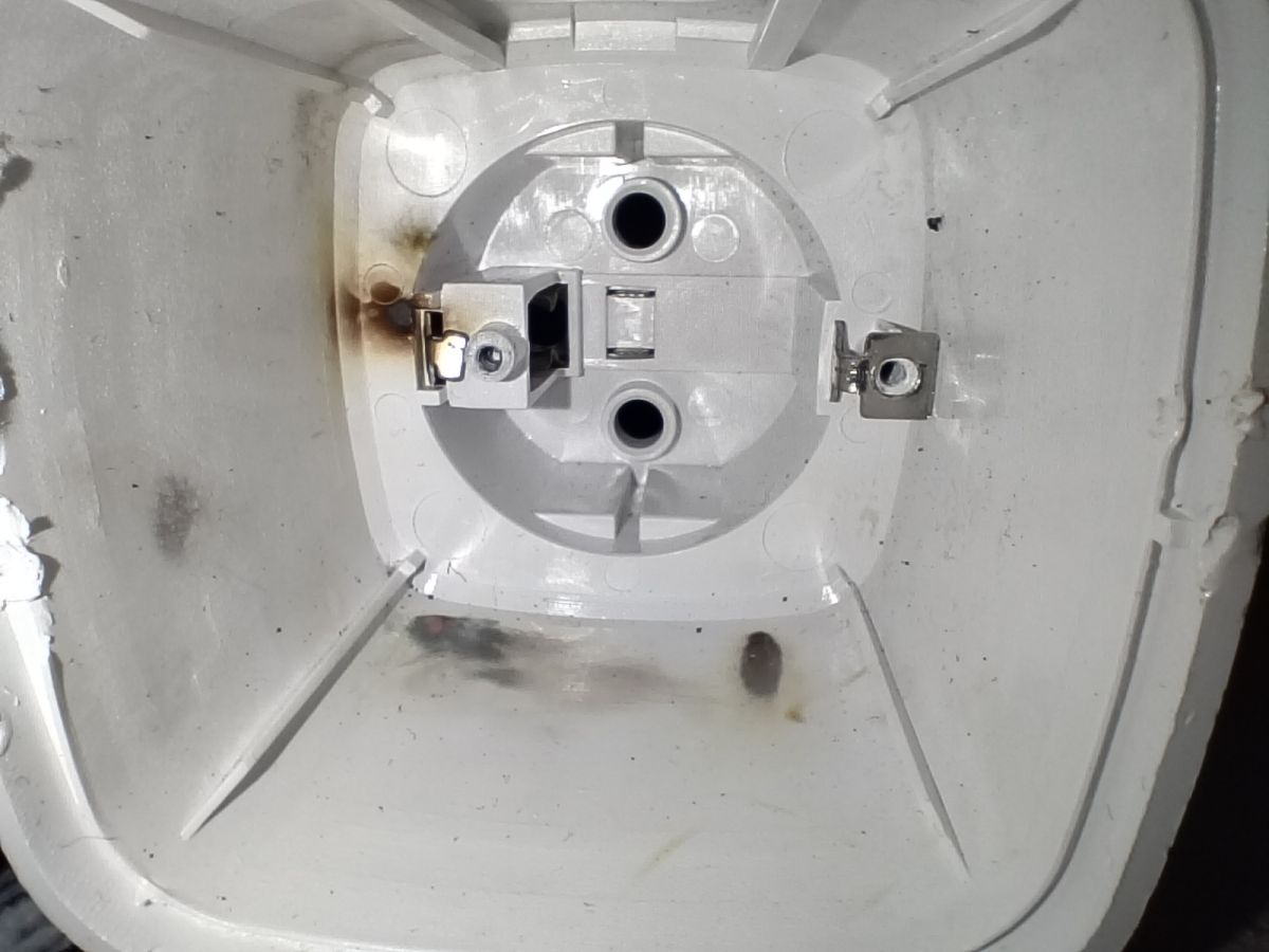

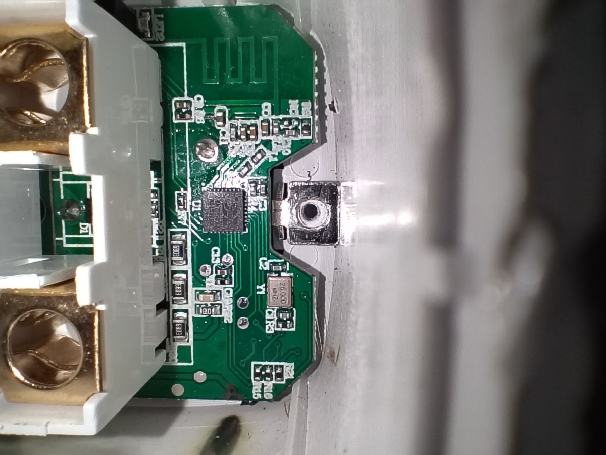

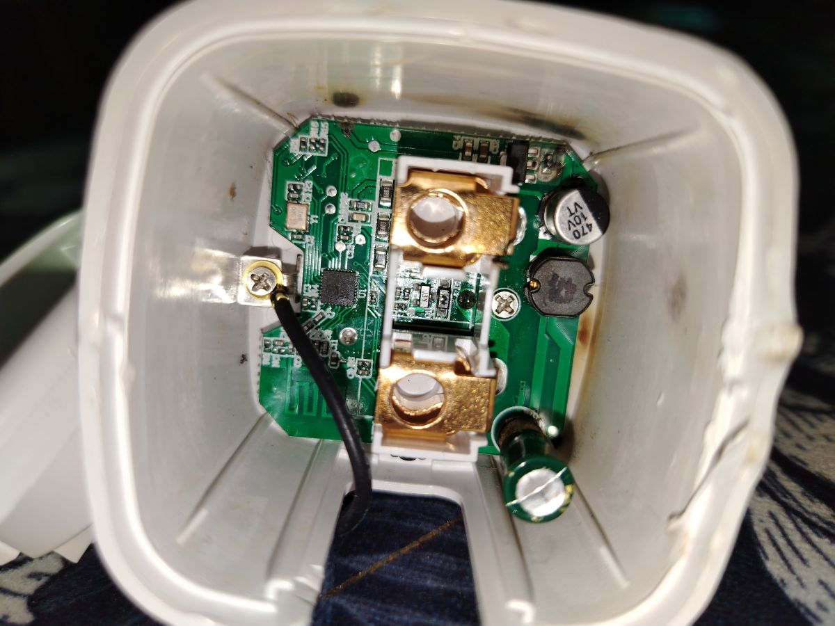

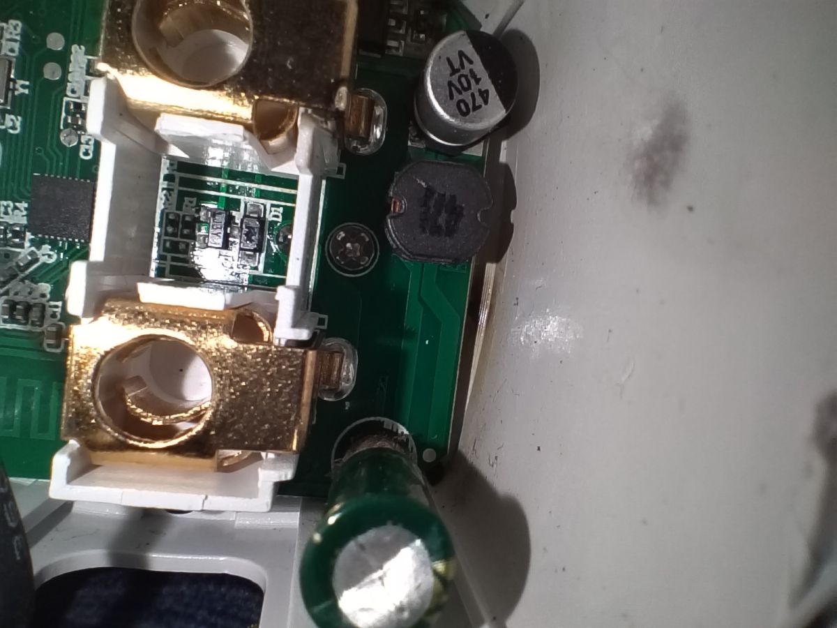

    I will informatively write that one of the WSP sockets fried without the slightest load. I'll take it apart at my leisure and see what's inside.
    In conclusion, I can write to tell you to give up buying such sockets on ali.

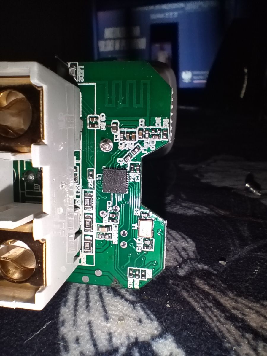

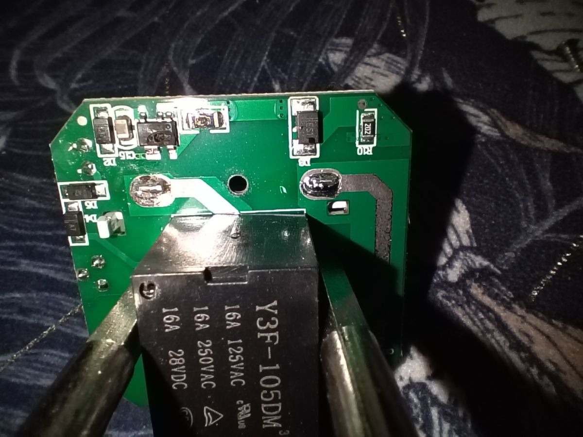

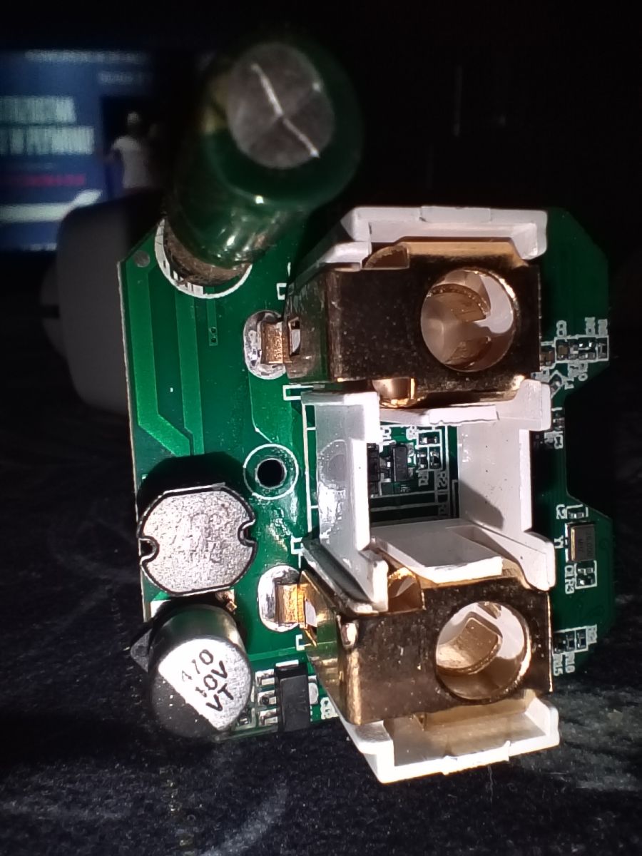

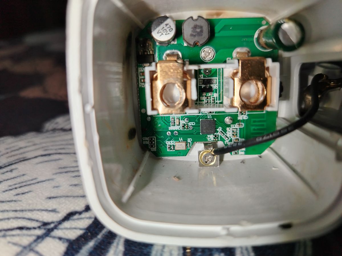

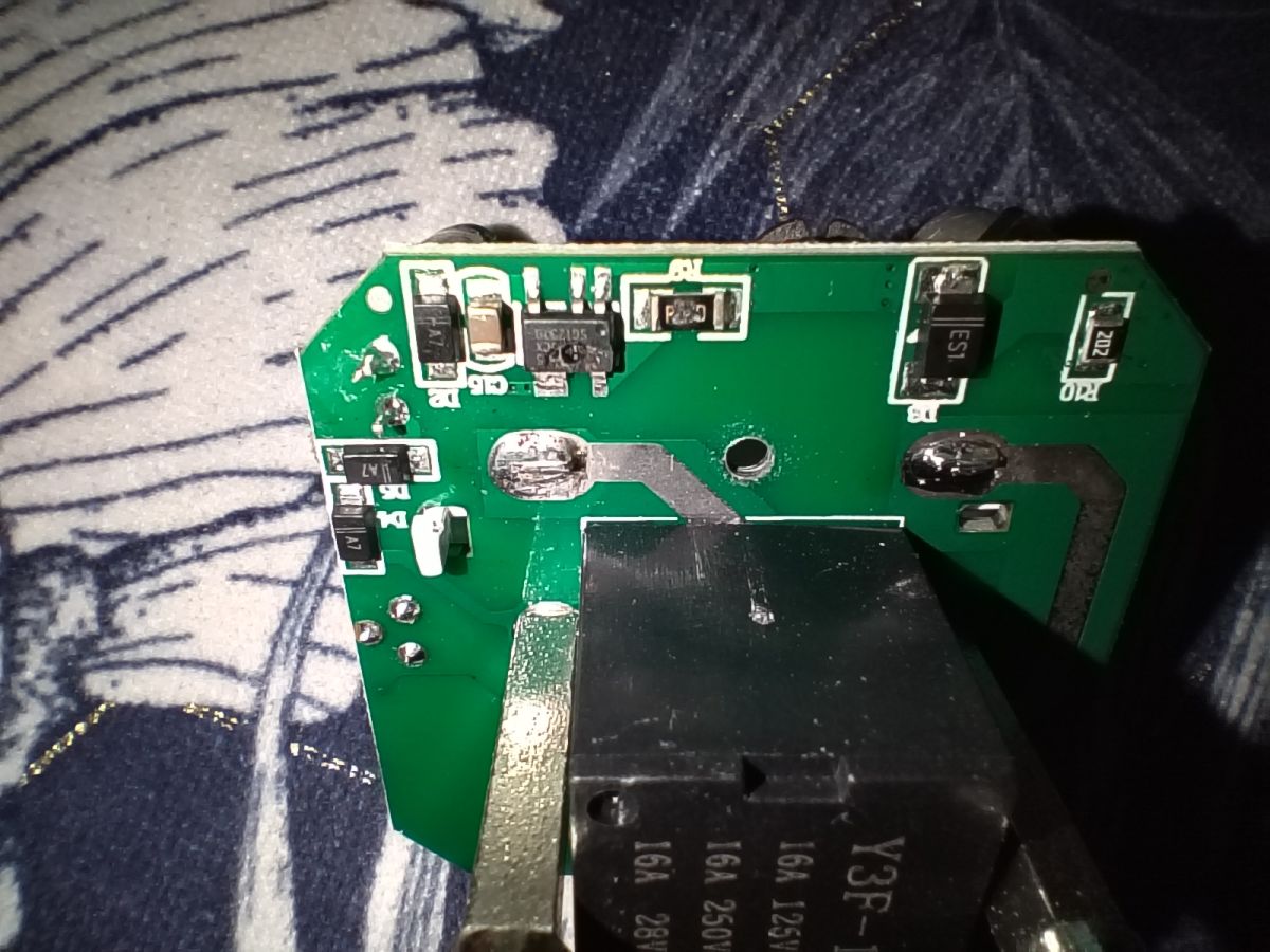

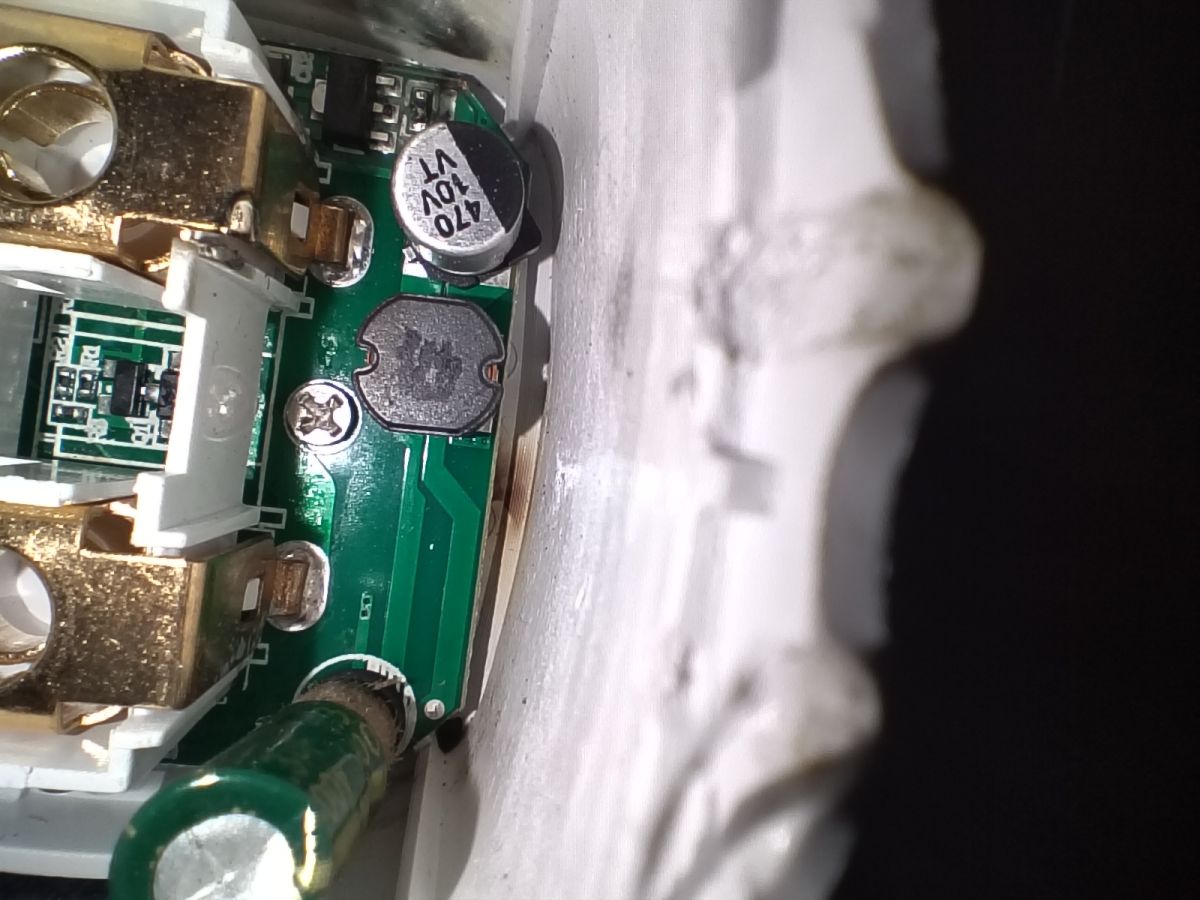

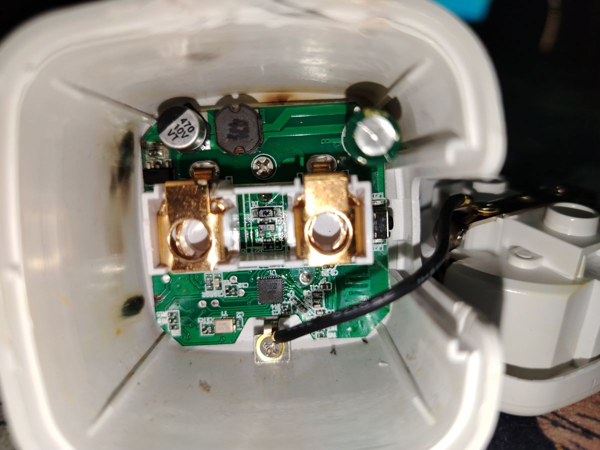

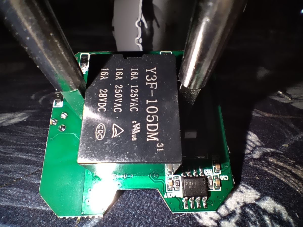

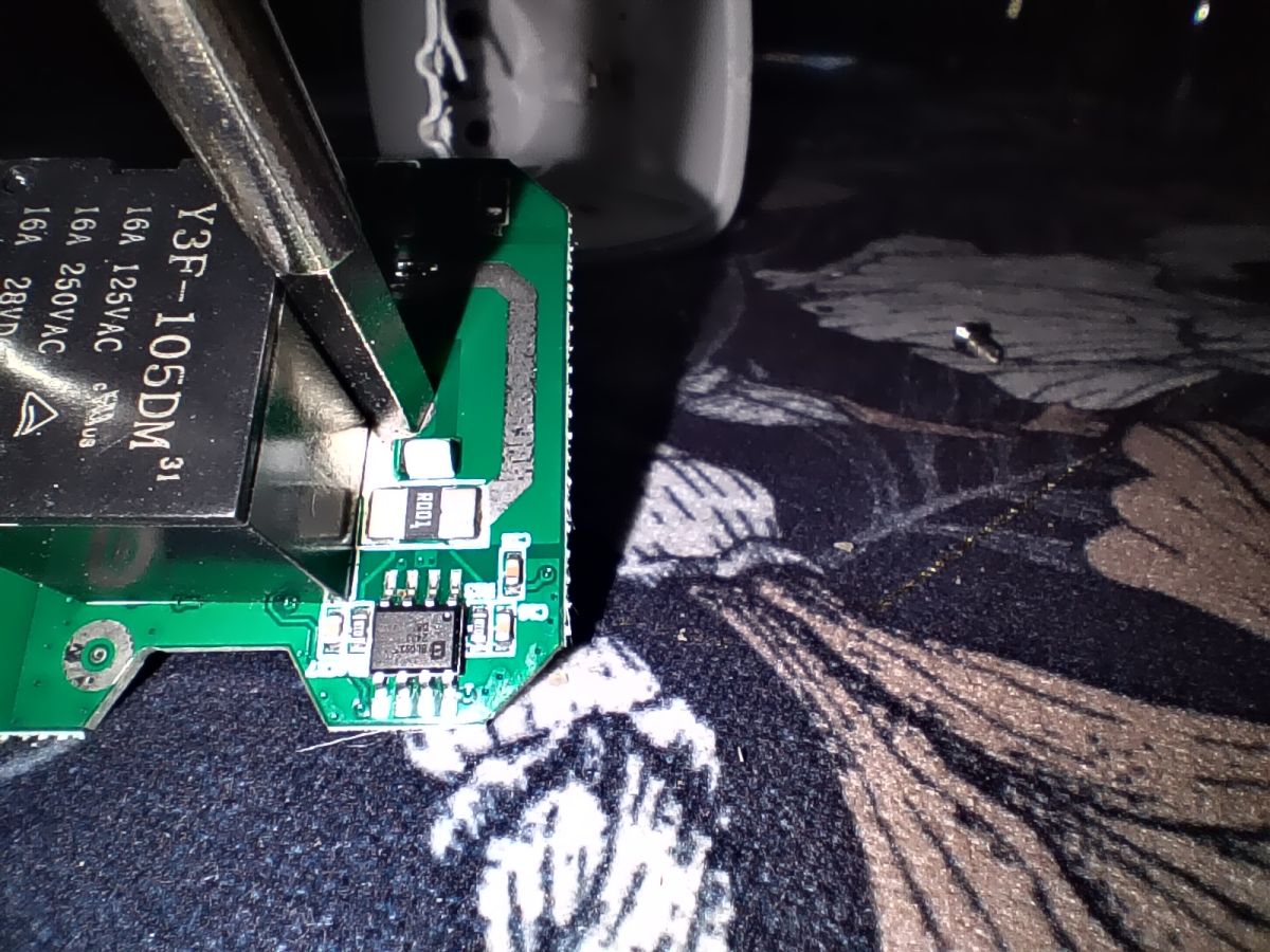

    Close-up of a printed circuit board with electronic SMD components. .
    Interior of a plastic electrical junction box with visible burn and scorch marks. .
    Printed circuit board with electronic components and part of an electrical socket. .
    Close-up of a circuit board with electronic components and large brass connectors. .
    Close-up of a circuit board with a Y3F-105DM relay and several SMD electronic components. .
    Close-up of a circuit board with a Y3F-105DM relay and the tip of metal pliers. .
    Y3F-105DM relay mounted on a green circuit board, held by metal clamps. .
    Top view of a printed circuit board with electronic components inside a device, featuring two large metal connectors and a capacitor. .
    Close-up view of a circuit board with electronic components and brass connectors. .
    Close-up of a printed circuit board with electronic components inside a plastic housing. .
    Close-up of electronic components, including brass terminals and a capacitor on a PCB. .
    Close-up of an electrical socket interior with a circuit board and electronic components visible. .
    View of the inside of a disassembled electrical socket with a visible circuit board and electronic components. .
    Interior of an electrical device with visible PCB and electronic components. .
    Interior view of an opened electrical plug with a visible circuit board and electronic components. .

    My T34 plugs go offline after several hours. What’s the practical next step?
    A user observed all three T34 units losing network after ~12 hours. Unplugging and re‑plugging restored operation, while the local button didn’t. Disable any sleep options, then re‑add the device and watch for recurrence. If behavior persists, treat it as a device/firmware fault and consider replacement. [Elektroda, marcinradom, post #21489970]
    Does the “Relay status” setting affect Wi‑Fi or cloud connectivity?
    No. That setting only defines what the relay does after a power loss. Options are Remember last state, On, or Off. As one expert put it, "This is the state of the relay when power is lost." It doesn’t fix radio disconnections. [Elektroda, p.kaczmarek2, post #21489990]
    How do I check if my router or IP conflicts are causing dropouts?
    Use a quick network check.
    1. Open your router’s DHCP list and note each plug’s IP.
    2. From a laptop, continuously ping each IP (and 8.8.8.8) to spot timeouts.
    3. Correlate ping drops with app Offline events to isolate Wi‑Fi or device faults. An expert tip: "Maybe by some miracle there is an IP address conflict." [Elektroda, p.kaczmarek2, post #21489005]
    How do I correctly unpair and re‑add a Tuya/Smart Life plug?
    Follow a clean re‑pair.
    1. In device options, choose "Disconnect and wipe data" or "Remove."
    2. Let the app detect the plug via Bluetooth, then enter your home SSID and password.
    3. Wait for it to join your router, then test over mobile data outside Wi‑Fi. This ensures proper provisioning to your actual Wi‑Fi. [Elektroda, p.kaczmarek2, post #21489022]
