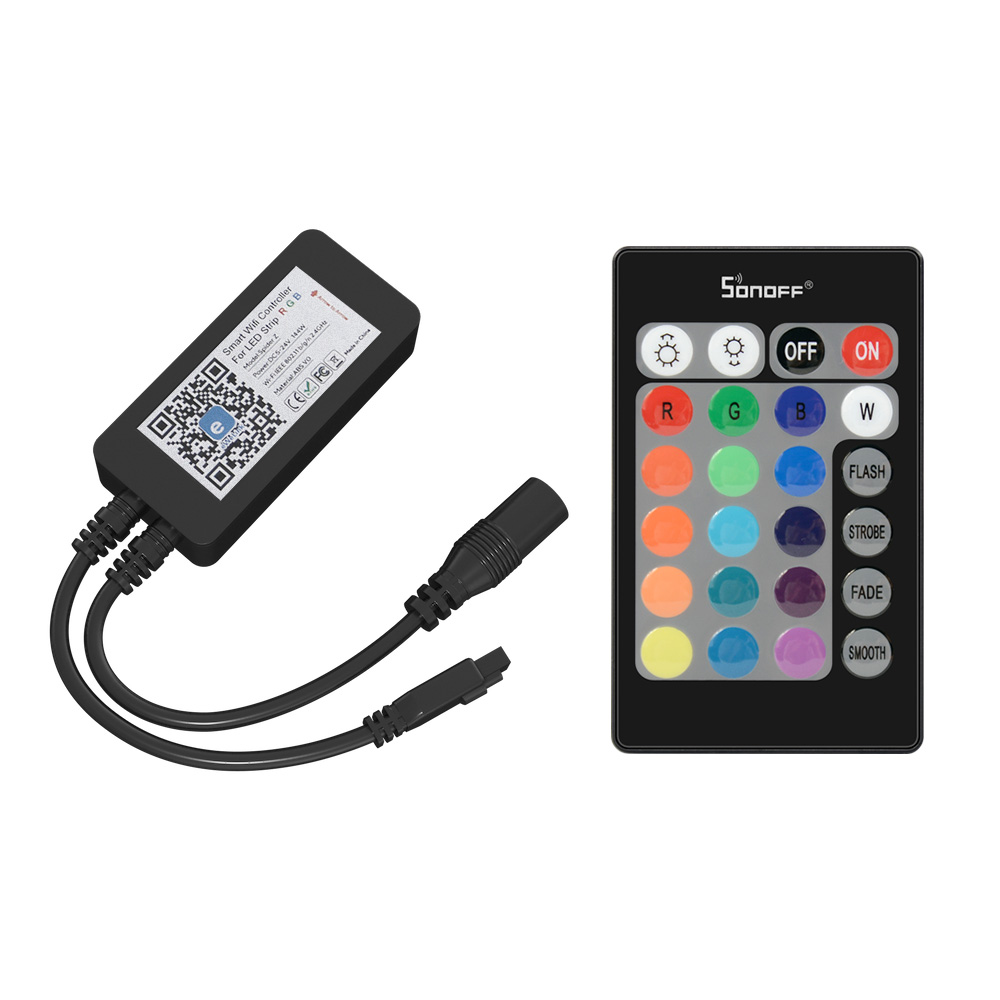

    Is there perhaps Sonoff L1 software on the suple. I uploaded the Gui generic and used the RGB H801 board but I think in my controller the outputs to the RGB falls on another Gpio and nothing works. I can see the rgb controller in the supli but it is not responding. (The blue diode only lights up or goes off in it when I turn it off from the supli) Or maybe someone knows what Gpio to set to RGB for the sonoff L1 controller. ]

    pawka_pk
    Level 22  
    Posts: 760
    Help: 18
    Rate: 84
    Well, yes, these two chips i.e. ESP and N76E003AT20 communicate with each other and from the latter comes the control on the RGB. I don't know what I can upload now to put this over wifi in some arbitrary application. Previously there was ewewlink but I can't find anything for the RGB controller.

    Successful. But I don't remember what gipio I found there :-) .
