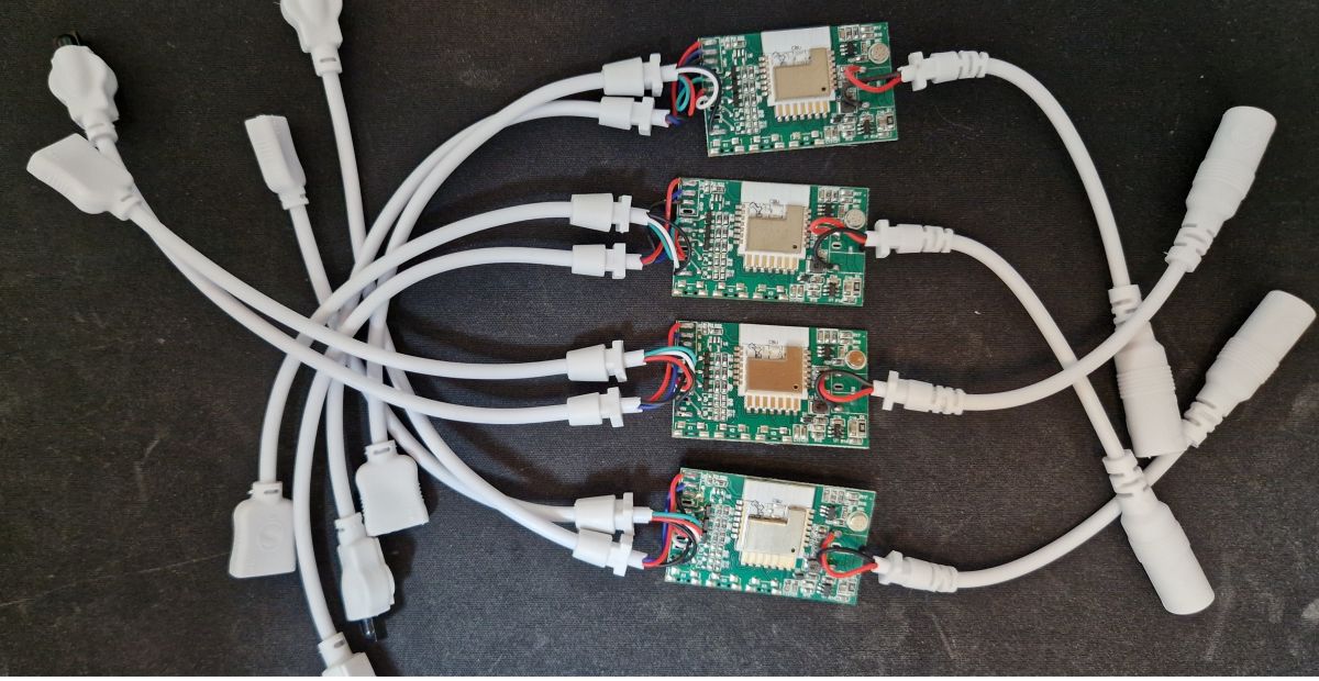

  • Four LED strip controllers with cables .
    My colleague @DeDaMrAz and I bought some Tuya LED strip controllers to convert them to work with Home Assistant. Here I will show how to change their batch, configure their GPIO and also how to handle IR (remote control) events in OpenBeken . In addition, we'll also take a look inside the power supply - how much has the Chinese saved on it?

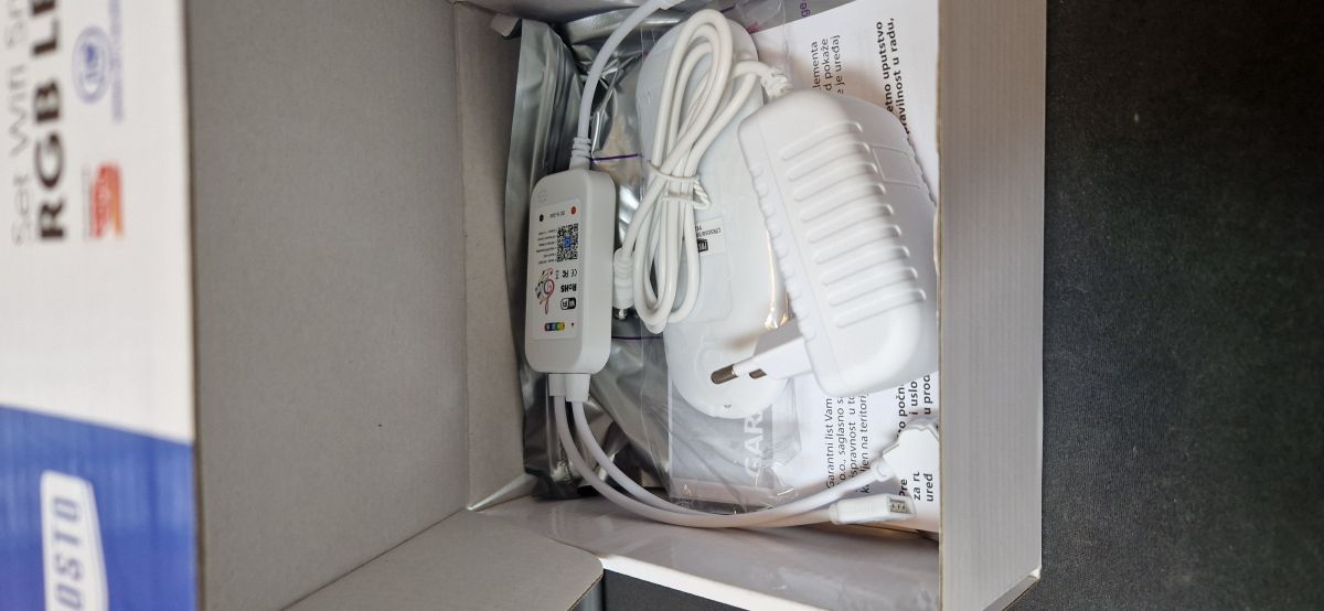

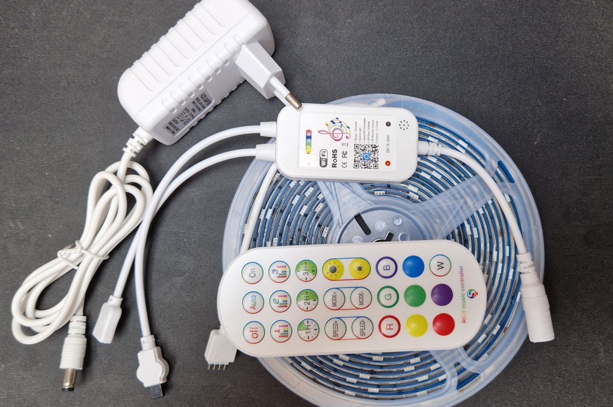

    Let's start with the kit presentation. That's what you get for €18:
    Packaging of WiFi smart RGB LED strip set .
    Designation:
    White box with markings and a barcode on the side. .
    There is also an LED strip and remote control inside, and even a power supply:
    Contents of the LED strip set box with a power supply. .
    The remote control included has a battery.
    Tuya LED strip control kit with controller, strip, power supply, and remote. .
    Interior, OpenBeken upload, GPIO .

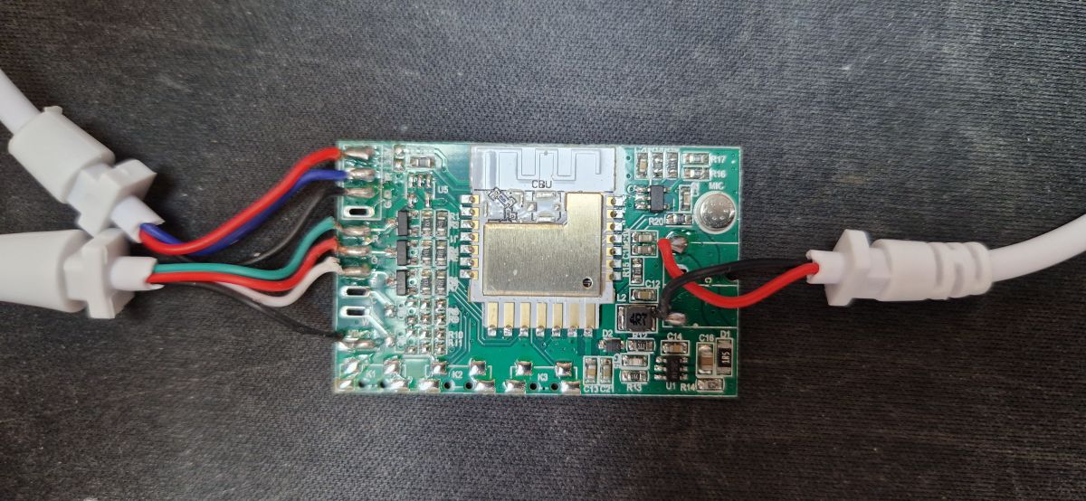

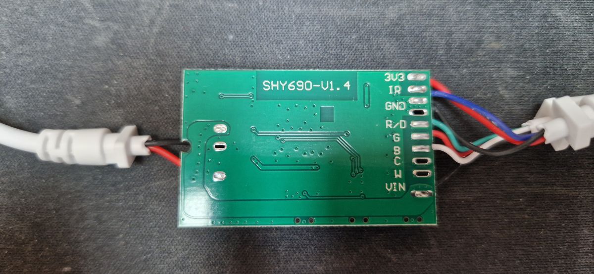

    The casing is a snap. We take a look inside:
    CBU module with connected wires on a dark fabric background LED strip controller circuit board with connector labels. .

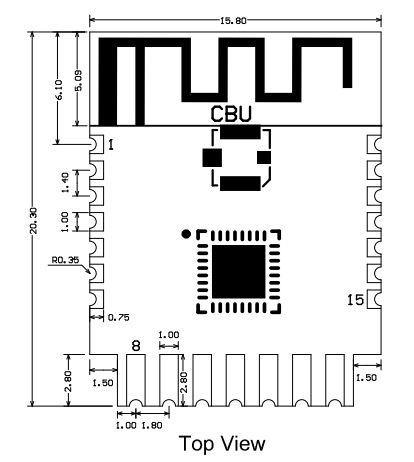

    Inside is the CBU module, which is BK7231N . Here is the CBU pinout:
    Diagram of the BK7231N CBU module with labeled pins. .
    Its pinouts (from Tuya documentation; untranslated):
    P7 . .
    Pin number . Symbol I/O type Function
    1 1 P14 I/O Common GPIO, which can be reused as SPI_SCK (Correspond to Pin 11 of the IC)
    2 P16 I/O Common GPIO, which can be reused as SPI_MOSI (Correspond to Pin 12 of the IC)
    3 P20 I/O Common GPIO (Correspond to Pin 20 of the IC)
    4 P22 I/O Common GPIO (Correspond to Pin 18 of the IC)
    5 ADC I/O ADC, which corresponds to P23 on the internal IC (Correspond to Pin 17 of the IC)
    6 RX2 I/O UART_RX2, which corresponds to P1 on the internal IC. (Correspond to Pin 28 of the IC)
    7 TX2 I/O UART_TX2, which is used for outputting logs and corresponds to P0 of the internal IC (Correspond to Pin 29 of the IC)
    8 P8 I/O Support hardware PWM (Correspond to Pin 24 of the IC)
    9 P7 I/O Support hardware PWM (Correspond to Pin 23 of the IC)
    10 P6 I/O Support hardware PWM (Correspond to Pin 22 of the IC)
    11 P26 I/O Support hardware PWM (Correspond to Pin 15 of the IC)
    12 P24 I/O Support hardware PWM (Correspond to Pin 16 of the IC)
    13 GND P P Power supply ground reference Power supply reference ground
    14 3V3 P Power supply 3V3
    15 TX1 I/O UART_TX1, which is used for transmitting user data and corresponds to Pin 27 of the IC. For the MCU solution, please refer to CBx Module.
    16 RX1 I/O UART_RX1, which is used for receiving user data and corresponds to Pin 26 of the IC. For the MCU solution, please refer to CBx Module.
    17 . P28 I/O Common GPIO (Correspond to Pin 10 of the IC)
    18
    18 CEN I/O Reset pin, low active (internally pulled high), compatible with other modules (Correspond to Pin 21 of the IC)
    19 P9 I/O . Common GPIO (Correspond to Pin 25 of the IC)
    20 P17 I/O Common GPIO, which can be reused as SPI_MISO (Correspond to Pin 14 of the IC)
    21 P15 I/O Common GPIO, which can be reused as SPI_CS (Correspond to Pin 13 of the IC)
    Test point CSN I/O Mode selection pin. If it is connected to the ground before being powered on, enter the firmware test mode. If it is not connected or connected to VCC before being powered on, enter the firmware application mode. Correspond to Pin 19 on the internal IC.
    We uploaded OpenBeken to:
    Following the Flashers instructions:
    You can also watch our instructional videos, especially those under BK7231N:
    https://www.youtube.com/watch?v=L6d42IMGhHw&a...czAXT94BuSGrd_GoM&ab_channel=Elektrodacom
    Thus, we first made a copy of the batch of all four devices, available here:
    https://github.com/openshwprojects/FlashDumps/commit/dd22f9c6b013a32e96f7e23ccbd2e5c719571104
    and then we uploaded the OBK.
    OpenBeken template:
    Tutorial for uploading the template:
    Everything works, also with Home Assistant, see OBK pairing instructions:

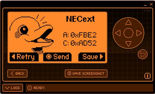

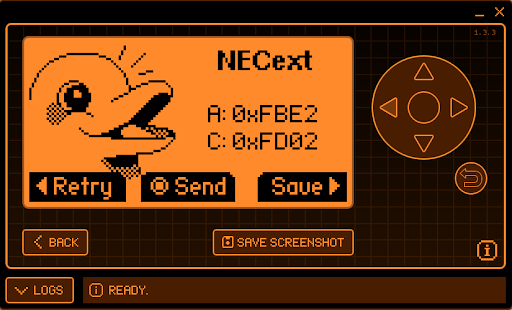

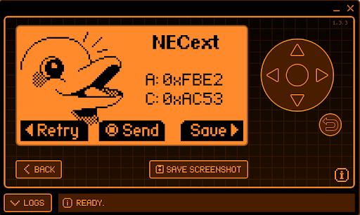

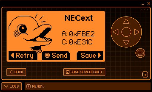

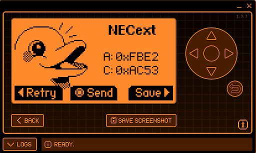

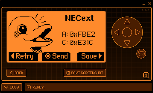

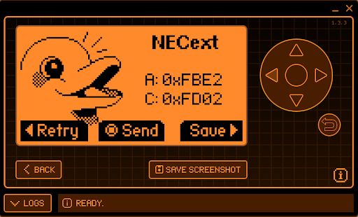

    We started by testing with the Flipper Zero, although the OBK would also work well. The remote control uses the NEC. Here's a preview of some basic keys:
    Red:
    Screenshot of Flipper Zero displaying NEC IR codes. .
    Green:
    Screen showing NEC remote codes on an electronic device.
    Blue:
    Flipper Zero device screen displaying IR NECext codes.
    White:
    Flipper Zero screen with NECext settings and Pac-Man-like symbol .

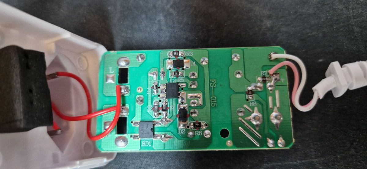

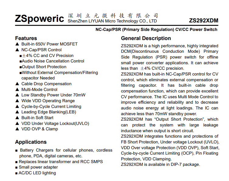

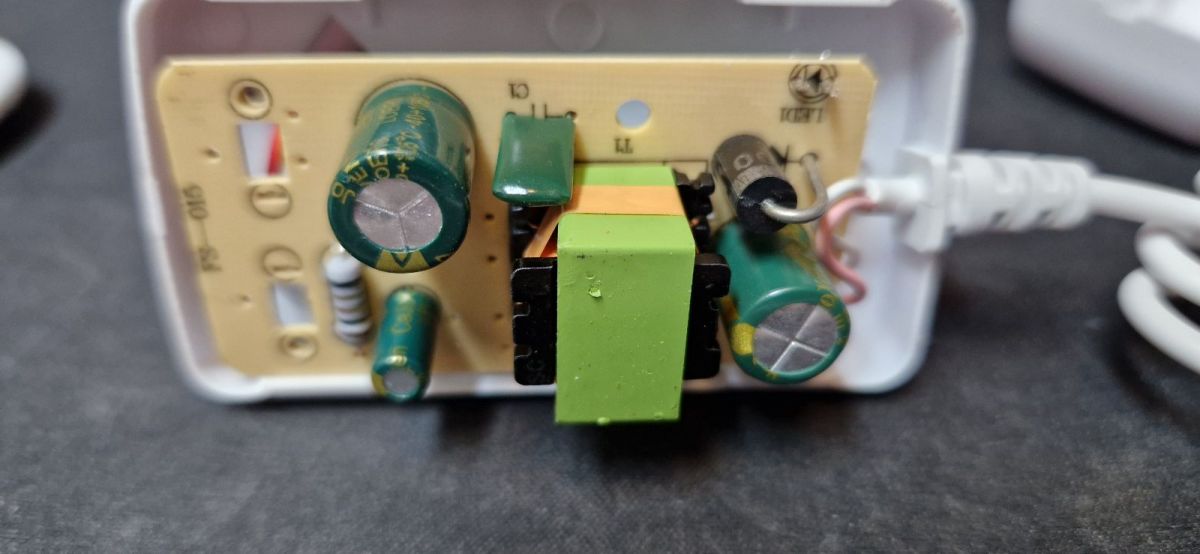

    Interior of the power supply .
    Again, a glued enclosure. We are looking at:
    Interior of LED power supply with electronic components. Image of the inside of an electronic module with visible components. .

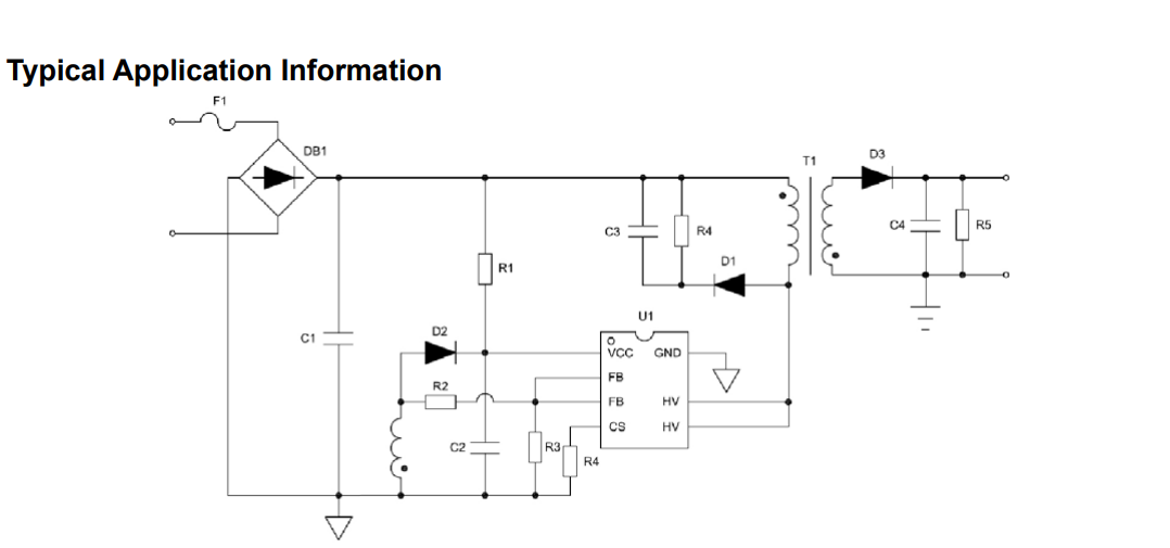

    A complete classic. As usual. Simple fuse resistor at the input and integrated flyback controller PSR (Primary Side Regulation). Only an auxiliary winding for the power supply with a rectifying diode and a gasifier (on the second diode and with this green capacitor). On the secondary side a Schottky diode and one capacitor (hopefully low ESR):
    Specifications for ZS292XDM by ZSpoweric .
    Typical power supply application schematic .
    Simply the same as usual.

    Pretty good kit, but the power supply is budget as usual.

What hardware is inside the power supply bundled with the LTK5050/30RGB-WF/5, and how safe or budget is that flyback design?
It uses a very simple budget flyback supply. "Flyback" is an isolated switch-mode power-supply topology that stores energy in a transformer during switching, a common low-cost choice for compact adapters. The thread describes an input fuse resistor, integrated PSR controller, auxiliary winding with rectifier diode, a secondary Schottky diode, and one output capacitor. The author calls it a complete classic and explicitly labels it budget, not premium. [#21220256]
