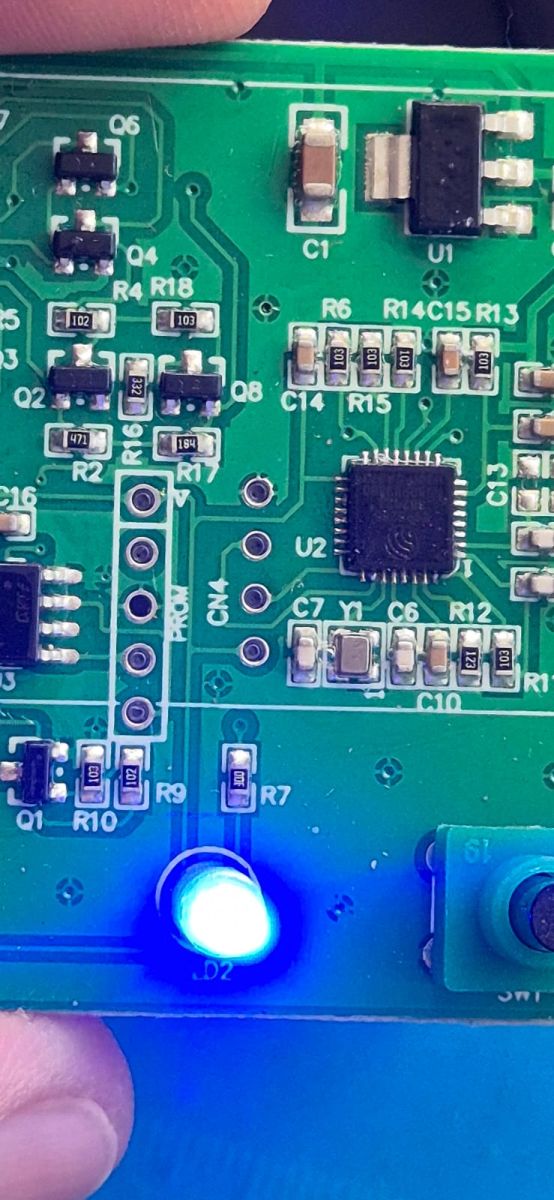

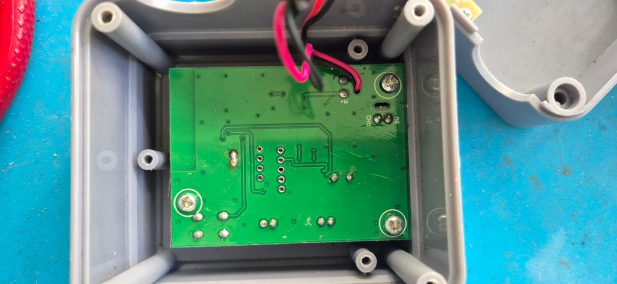

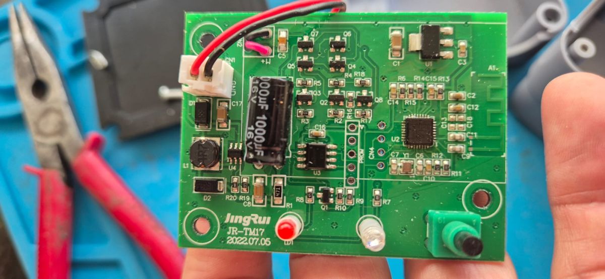

    Hi,
    I have this watering equipment. It's basically a 5V solenoid connected to this board.
    This board has an ESP8285 and works with SONOFF eWelink APP.
    I'd like to flash it with esphome. Since I cannot do it with the DIY mode, I need to flash with the pins.
    But the pads to program it have no labels. And I'm a newbie.

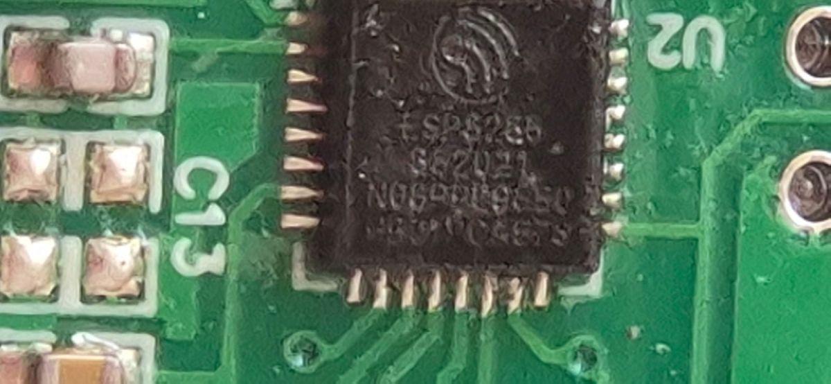

    I tried to match to an ESP8285 pinout reference, but it's difficult.
    Could, please, somebody here help me identify these pads, so I can flash it ?
    Thanks a lot !!!
    My best regards.
    Here are the pictures.

    And why didn't the datasheet help you?

    Because I'm not sure about the tracks. I could identify TX and RX, but VDD, GND and I think I need GPIO, right? Those I'm not sure.
    VDDPST seems to be que 3.3V input. There's VDDA too, but I'm not sure if it's being used.
    GPIO0 looks to go to a resistor. GND seems to go nowhere, unless those back tracks are for then...
    I'll try the multimeter later. But I think mine is not sharp enough.
