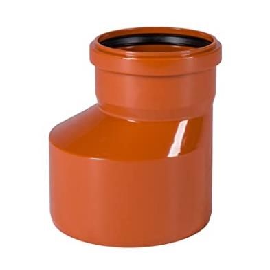

    This is a trapper for cast iron pipe:
    Sealing the sewage pipe passing through the wall in the bathroom.
    And this is the toilet bowl trap:

    If it has a regular vertical pipe diameter 160, maybe something like this:
    And if it`s an old cast iron one, maybe something like this:
    Although it probably fits into a regular pipe too.
