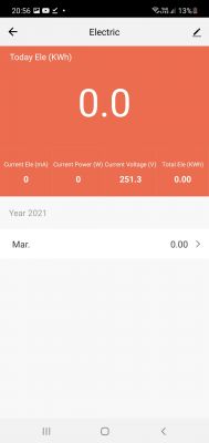

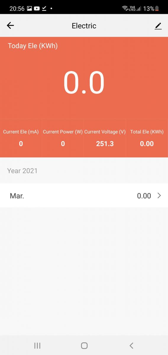

    Hello colleagues.
    I need help writing a letter to PGE to lower the voltage in the network. I have already written one letter and received the answer in the attached photos. I called the case handler.
    The answer I got in short is that I should set the inverter to reduce power, or to consume energy on a regular basis. I have 13kW panels and there are problems with the production of more than 7kW. So I explain to him that I do not intend to reduce anything and that I plan to expand the installation by another 4kW because this is what I need to balance myself on a yearly basis. And I am trying to convince you that the prosumer is to consume energy on an ongoing basis and not store it in the network for the winter. Come on shock.
    The voltage that prevails in the network during a sunny day is even 260V. Today, even with the fog and the production at the level of 300 W per phase, the voltage was 250V and this one tells me that it is the fault of the photovoltaic. I presented them with the measurements at 9 p.m. with a voltage of 251V and this is also the photovalta's fault.
    From 22.00 to 6.00 they lower the voltage on the MV and then I have a voltage of 230-235V.
    I tell him how to a normal peasant to lower the taps by 5% and he will be calm. And the fact that they have 40 meters on this line and they will not turn off the electricity twice a year because in winter it will probably have to be raised. I will add that I am the last one on the line and I have never noticed that my voltage was too low.
    Summing up, he said that he did not lower because despite 252V by 21h they are normal.
    I can set my inverter to 270V but I think this will be the last resort.

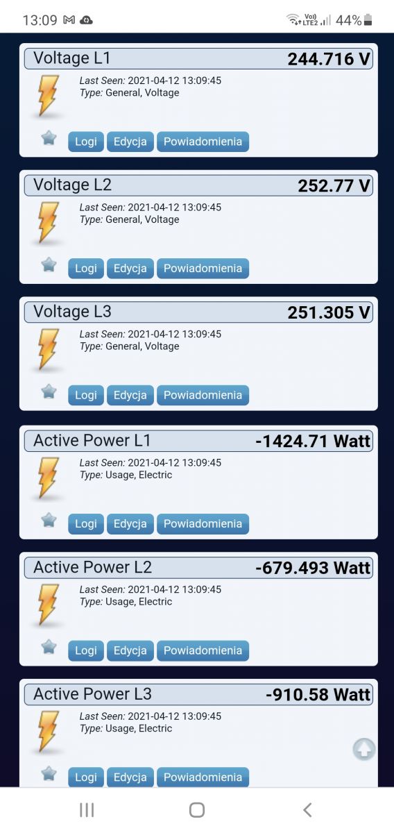

    Where do you measure voltage? These are the values from the inverter, RG or connectors?
  • Measured phase voltages match the PGE meter
    #3 19375816
    przemasd
    Posts: 79
    Rate: 21

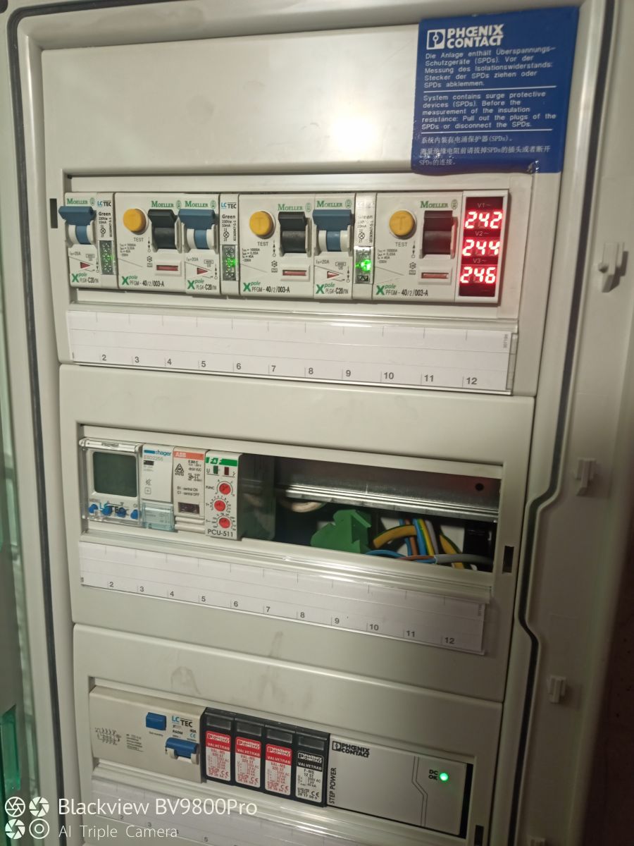

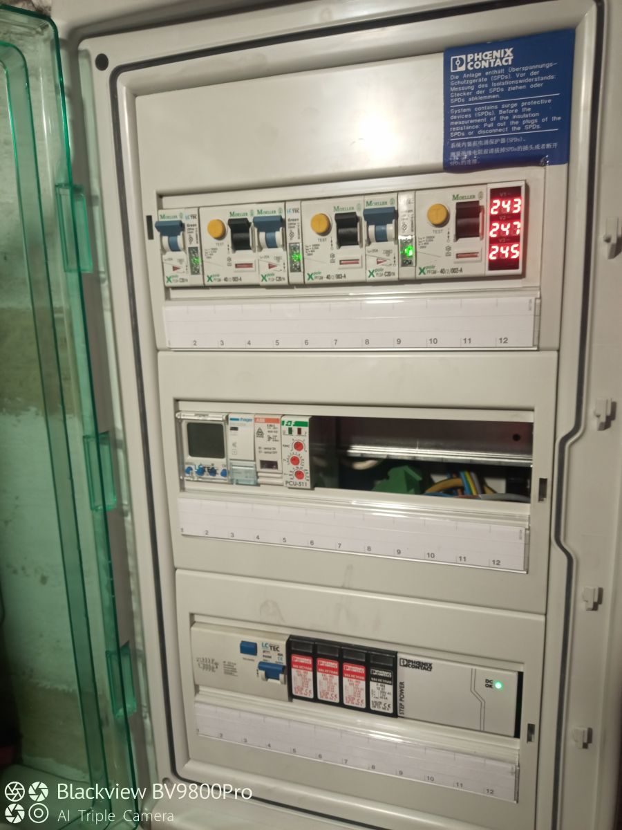

    I measure the voltage in the main switchboard. There is 15m of 5x10mm? cable from the switchgear to the meter. Measurements on the PGE meter coincide. One of the measurements is shown at 21:00 from a socket inside the building.
    PS The gentlemen from PGE took the measurements in the medium sunlit time and the values given in the letter were measured on my meter while the installation was turned off. When it was on, it was a few more volts. One screen is from today you can see what voltages on the phases with how little production.

    Write down what voltage you have in the network with the installation completely switched off when you notice that the inverter increases it to a higher value. You may find that your neighbors and their inverters are similar to yours. The increased voltage on the external network forces your inverter to raise the voltage even more to break through the meter to the "other side". Often people forget that others also have photovoltaic installations. Then they are deeply disappointed.
    Enter the voltage now (today) as it is at off. installation and provide it when the inverter strongly raises them. I'm very curious.
    Regards.

    As I wrote above. I am interested in the voltage in the external network when it is sunny and your photovoltaic installation is turned off. Completely disconnected from the network. The point is to know the voltage value in the "public" grid when the sun is operating strongly and the neighbors' inverters increase the voltage.

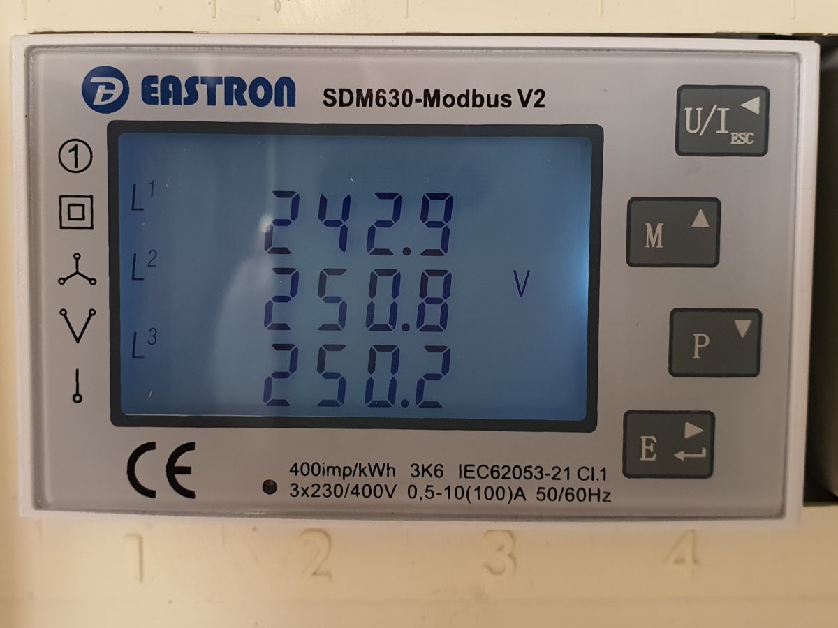

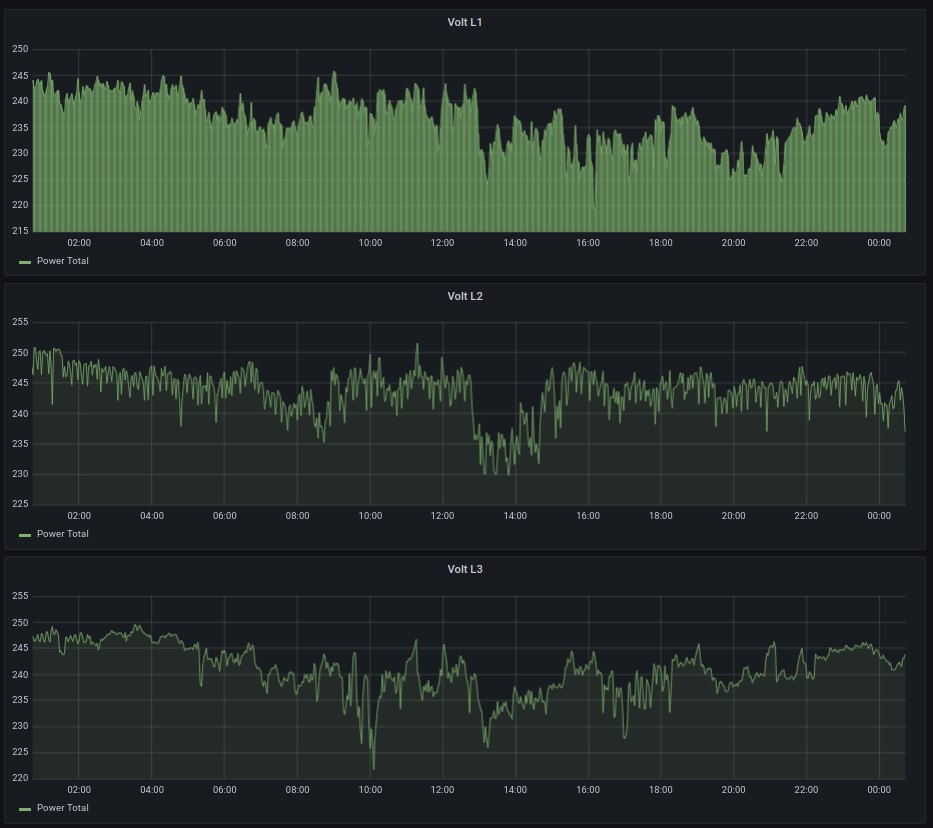

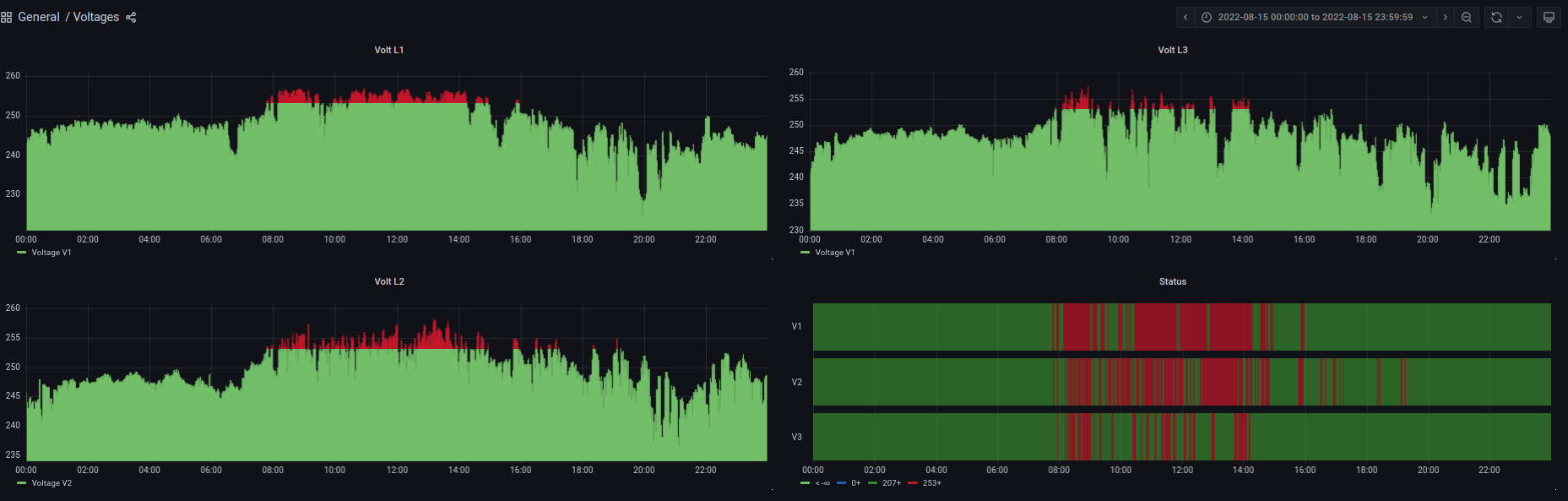

  • Monitoring 250–260V grid voltage with OR-WE-517 meter
    #22 20416002
    Vein
    Level 22  
    Posts: 743
    Rate: 51
    How to fight to reduce the voltage in the network? In my place, in the middle of winter, in the middle of the night, the "rest" voltage is 250V. How am I supposed to sell anything online under these conditions? In the summer, my installation does not work as it works, as a result, I pay the installment for the PV installation and bills for the energy used, you say "turn on the load", I can't turn on, but what if the neighbors have higher voltages on their inverters that it can jump over 260V? As I reported to PGE, the ambulance was coming after sunset, with information that they had such an order from above ... I have monitoring, data is collected from the Orno OR-WE-517 meter compliant with EN50470-1:2006, EN50470-3:2006 MID Directive 2014/32/EU
