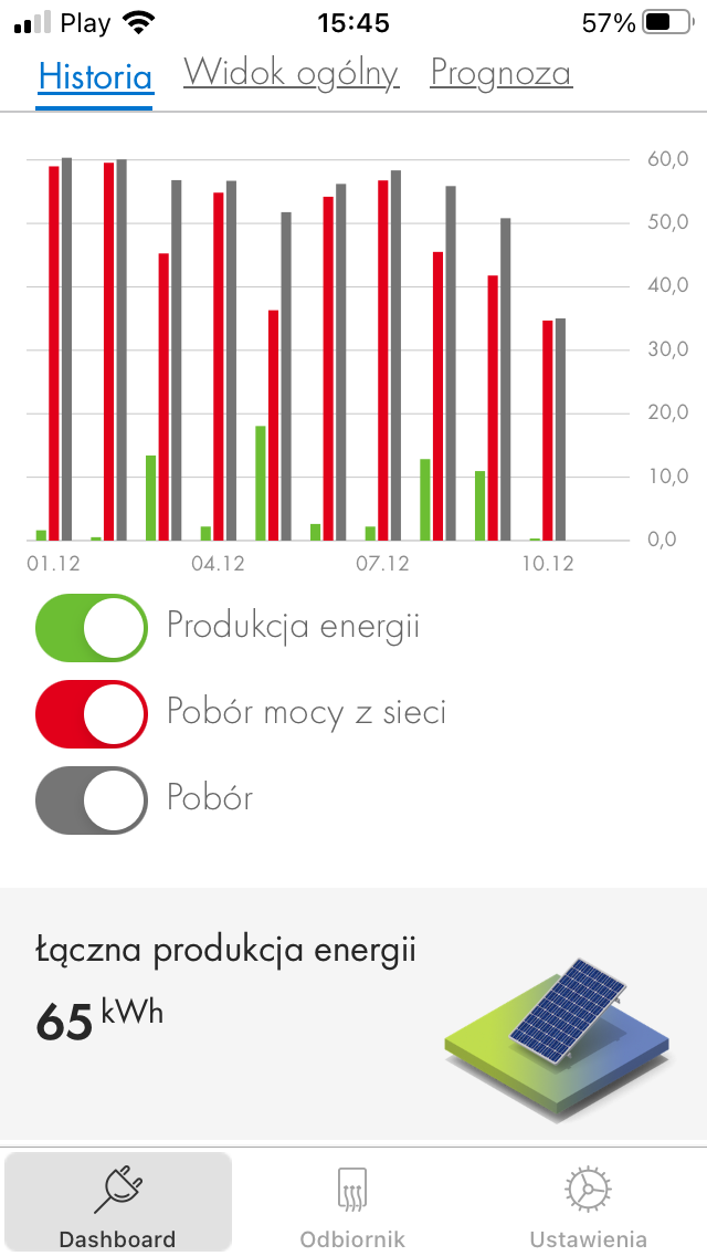

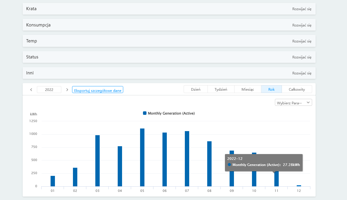

  • #43 20326590
    cysiekw
    Level 42  
    Posts: 5431
    Help: 1003
    Rate: 1410
    Today, December 9, a friend who has 4KW installations announced that he produced 3.2KW for 9 days
  • #44 20326612
    prose
    Level 36  
    Posts: 3037
    Help: 173
    Rate: 850
    With 7 kWp at my place.
    My OFF-GRID 880W installation in a single-family house - independent of the ener
  • #45 20328228
    Leon444
    Level 26  
    Posts: 948
    Help: 48
    Rate: 355
    At my place, at 11kW, 65kWh production for 10 days in December, which is less than on one sunny May day ?
