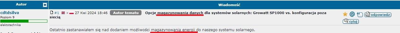

    • Exploring Storage Options for Solar Systems: Growatt SP1000 vs. Off-Grid Setup Dane czy energia.jpg (36.34 KB) You must be logged in to download this attachment.
  • #3 21062996
    DiZMar
    Posts: 32674
    Help: 2889
    Rate: 6640
    I already know. The confusion was made by translator (automatic ).
