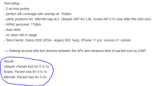

A MikroTik 'mesh' is not recommended here; the thread advises using wired access points with the same SSID/password, and if you need seamless roaming, choose gear that supports fast roaming such as UniFi or TP-Link MR4 instead of independent MikroTik APs [#19443307] [#19443375] [#19443392] [#19443422] On MikroTik, AP-to-AP switching can be quick, but it is not true roaming: the connection is dropped when the client changes APs, which can interrupt VoIP, voice, and video even though browsing and streaming usually survive [#19443433] [#19443542] The thread also says MikroTik is not planning to implement home roaming [#19443542] UniFi is reported to work with one SSID and one password, with users describing it as stable 'turn on and forget' Wi‑Fi; suggested models were UAP-AC-LITE for 2x2 MIMO clients or UAP-AC-PRO for 3x3 MIMO clients, powered by PoE [#19443570] [#19445155] Wireless uplink/mesh on UniFi can work, but it was described as much slower and suitable mainly for browsing, so cable backhaul is preferred [#19444526]

    On the Mikrotik forum I found a comparison of roaming on different devices. In fact, MT performs poorly.
    Mikrotik Mesh Network: Reviews, Performance & Comparison to Other WiFi Solutions
  • PoE power does not reduce Ethernet throughput
