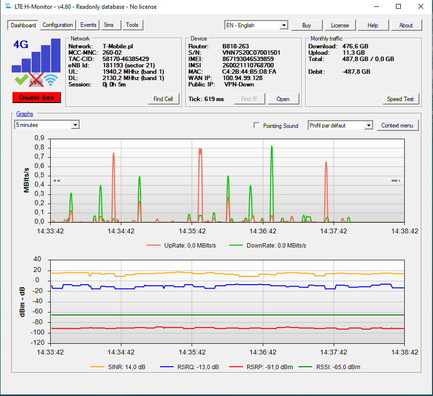

    Added after 1 [hours] 38 [minutes]:
    I have followed the topic you provided. Unfortunately, I can't add my results there, I will attach them here. At 2600MHz, there is no range at all on the router. The same is true at 1800MHz, but when I try to measure, I think the BTS changes every now and then because there are 3 lines once, then 2, then 0 and so on from time to time. Even speedtest at 1800 is barely doable because it hangs after the download test.
    2600MHz:
    Experiences and Concerns Regarding Magenta Business and T-Mobile Services Experiences and Concerns Regarding Magenta Business and T-Mobile Services
    2100MHz:
    1800MHz:
    Car:
    And these messages about connecting to BTS:

    You would have to know if the connection is in both cases from the same BTS (eNB id) and on the same bands. Otherwise, the comparison may not make sense again.
    Well, both internet sites are one and the internet is the same. One is the mother of the internet in magenta business, the other is the same independent net with a separate sim card. I would like to add that on the Internet, where there is a problem now, there was no one before choosing these two services for this one tariff), how can I check it? where do these lags come from?
    Does it work for BTS to show me speedtest the same values as before the problem, but the limitation is BTS-T-mobile, not BTS-My location? Sorry when I talk nonsense, but I'm trying to get it somehow.

    The transfer limitation for you are base stations in which you are within range:
    - eNB 181193 is a short-range omnidirectional antenna at Alpejska 42 (Institute of Cardiology) and LTE is only in the 2100 by 10 MHz band (in the 15 MHz plans), so currently you will not get more than about 70 Mb / s from it
    - eNB 280335 is a station at Mrówcza 243, more overloaded and much further, so additionally the transfer is reduced by a generally weak signal (2600 - 15 MHz + 2100 - 10 MHz + 1800 - 10 MHz + 800 - 10 MHz)
    - eNB 5256 Play you catch from ul. Żegańska 1 (chimney of the Międzylesie Heat Plant) and has 4 LTE bands (2600 - 20 MHz + 2100 - 15 MHz + 1800 - 15 MHz + 800 - 5 MHz)
