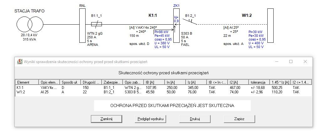

    Hi.
    Technical parameters of the connection:
    Power 18 kW, protection 32A. The length of the WLZ is approximately 22 m. Power-hungry devices - 1-phase heat pump, thermal power 7 kW (electric power max 3.5 on one phase, plus graduated heaters 3-6 kW on the second phase), 7.5 kW induction divided into 2 phases, probably some car charging in the future electric charger 3f 11 kW from the power connector in the garage. Some say 4x10, others 4x16 (for the future), and some say about aluminum, and this is where I started to consider it, because copper prices are a failure. Aluminum is probably 4x25, so I would be 600 hundred points ahead of Cu.

    #3 19454627
    tyqva
    Level 36  
    Posts: 2775
    Help: 333
    Rate: 1164
    R1990 wrote:
    ...Aluminum is probably 4x25 so I would be 600 hundred points ahead of Cu.
    YAKY 4x25mm² meets your needs.

  • #10 19459154
    tyqva
    Level 36  
    Posts: 2775
    Help: 333
    Rate: 1164
    R1990 wrote:
    ...A 10mm2 wire won`t withstand 32A for a long time?
    It won`t last under certain conditions, so I wouldn`t sign it.
    But the proposed AL 25 fulfills your dreams; will withstand and 30 kW.
