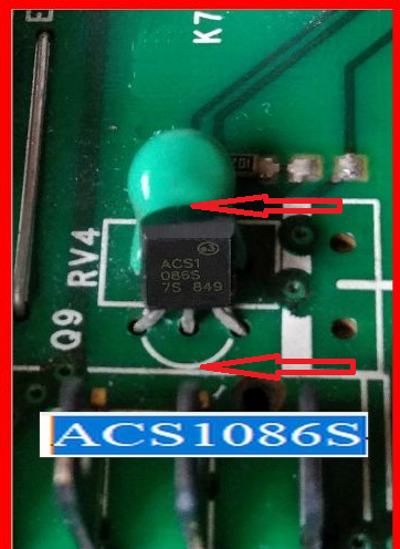

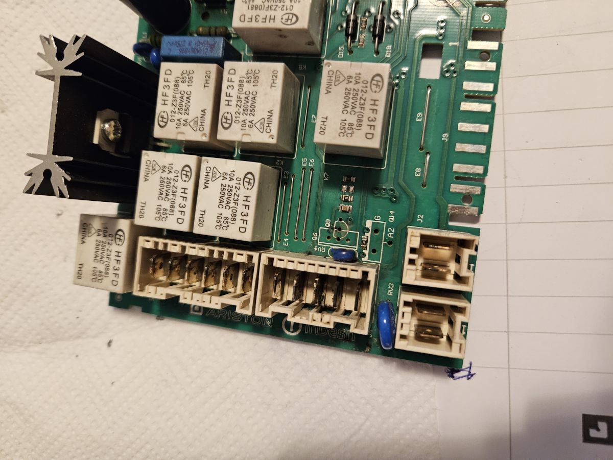

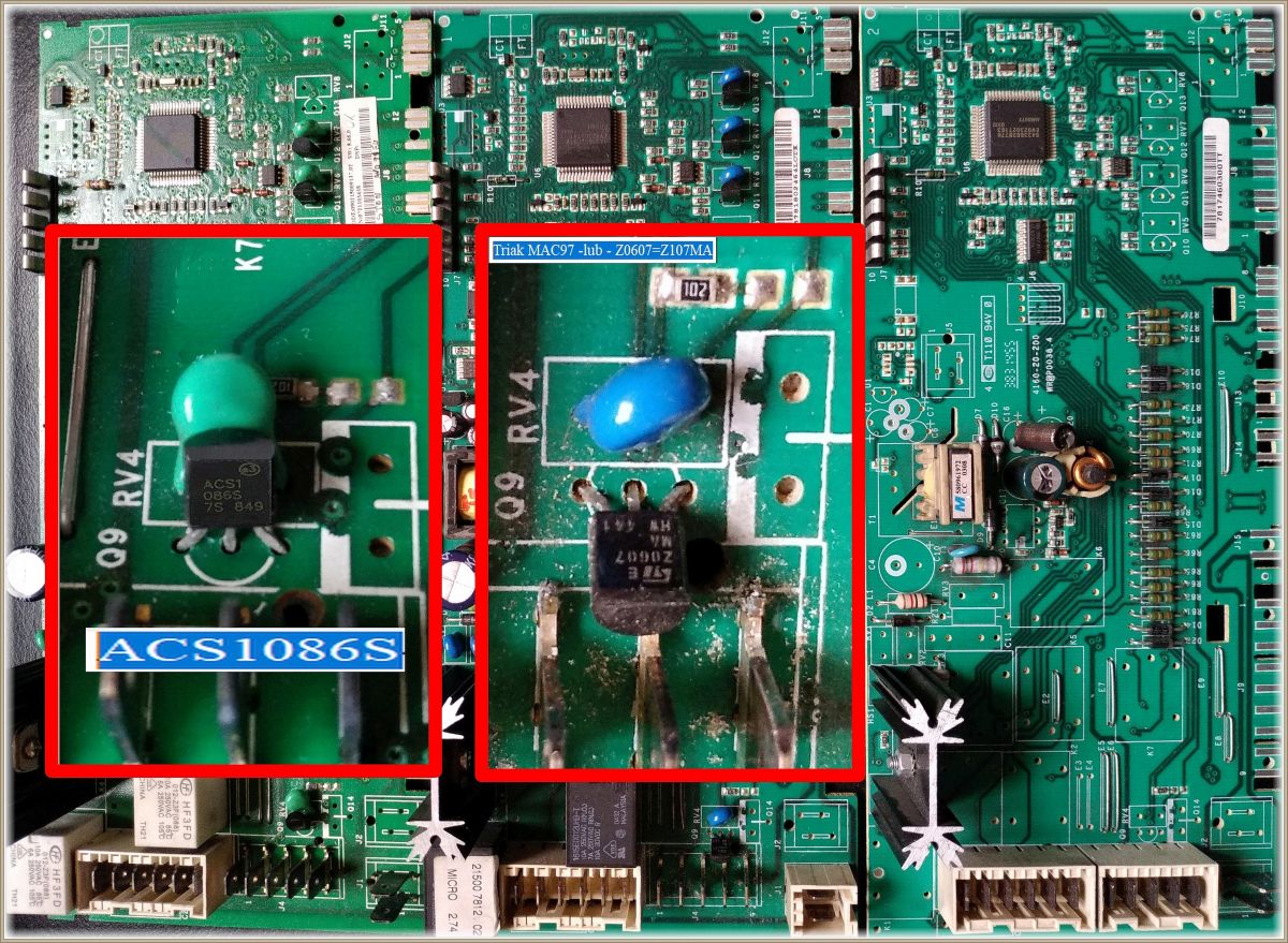

  • #7 21235569
    fadilveh2
    Bitte kannst du mir helfen. Ich habe gleiche Platte aber Q9 kleine tr ist kaputt bei dir kannst du lesen und sagen Bezeichnung. Gleich neben Ty Q14. Es ist für Türschlosssteuerung. Danke. Printed circuit board with visible relays and other electronic components.
  • #8 21236077
    TONI_2003
    Moderator
    Posts: 15334
    Help: 2195
    Rate: 3826
    Printed circuit boards with integrated circuits and electronic components. .
  • #9 21237221
    crazycavan
    Level 20  
    Posts: 271
    Help: 48
    Rate: 134
    Tony in the left picture the triac ACS1086S is mounted upside down
    ACS1086S chip mounted upside down on a circuit board.
  • #10 21237255
    TONI_2003
    Moderator
    Posts: 15334
    Help: 2195
    Rate: 3826
    @crazycavan I know what I'm posting! That's why it's the factory that gave it that way depending on what they gave to the PCB and in what design (you choose what solution you have) and I hope I've made myself clear....
