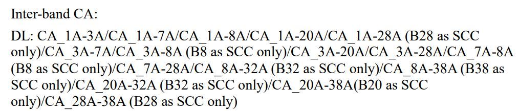

    Here you need to look at the specific device model and technical specification.
  • LTE category does not define exact band aggregation

    Thank you very much cheetah. Your information has cleared up a lot for me. From what I can see on the website https://www.lte-anbieter.info/technik/kategorien-und-3gpp-release.php there is a column "Carrier bis". It shows that Cat 6 modems aggregate 2 bands, but which one needs to be checked in the specification (btw the link to the Huawei B325 specification refers to the local file :-) )
    I am looking for an LTE modem that aggregates at least 3 bands. As I understand it, I need to look for Cat 8 modems or higher?
    Btw, in the Huawei B535 specification, as I understand it, inter-band CA specifies what bands are aggregated:
    LTE Cat 6 Modem: Band Aggregation, Modem Capabilities & 300MBit/s Download Speed eg CA_1A-3A means 1800MHz-2100MHz?
