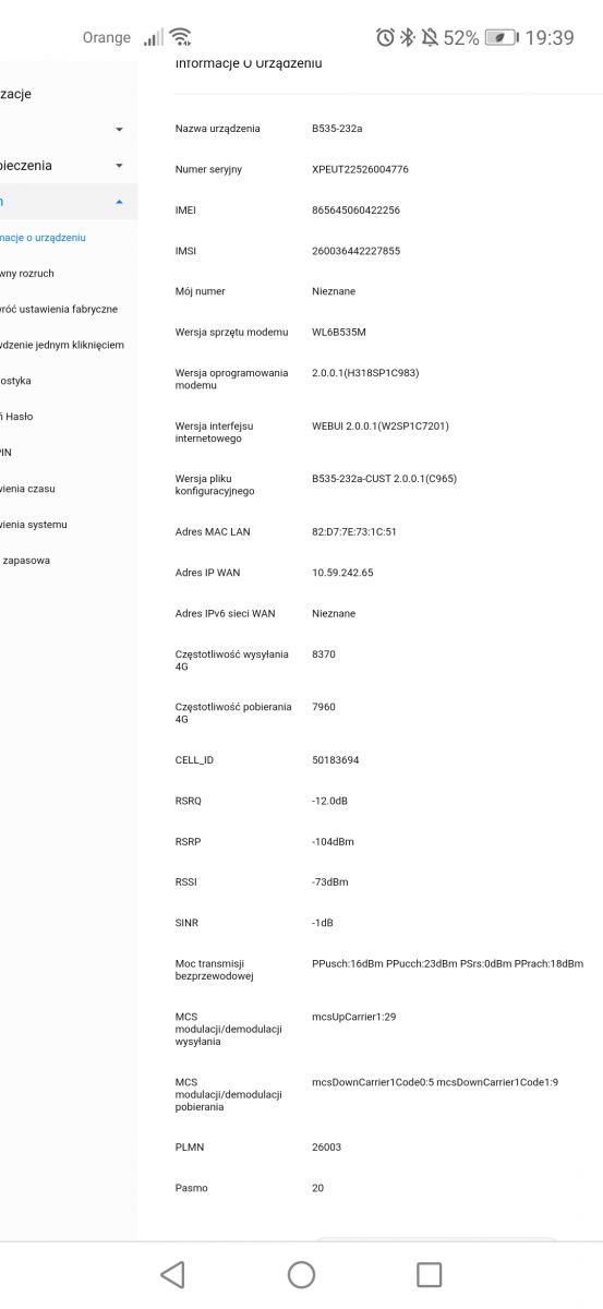

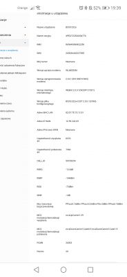

    when entering the settings, you can see that it connects only to one b20 band, if it were to aggregate something, it seems to me that it would say b20 + something else. Apparently there are programs to force aggregation because I can`t find it in the device menu. I`m connecting to BTS ID 96030. Supposedly there are several bands there

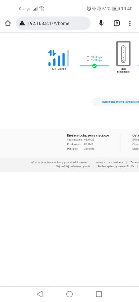

    BTS NetWorks Dubicze Cerkiewne operates in the LTE2100+1800+800 aggregation, only the base band is shown in the Device information, if there is an aggregation of 2 bands, the WebUI on the main page shows LTE+. you didn`t show the screenshot from Information.

    so I can`t force aggregation of only two bands I have selected??? this is what it looks like on the device Huawei B535-232a: LTE band aggregation, learn how to force connection in other bands Huawei B535-232a: LTE band aggregation, learn how to force connection in other bands

    Aggregation of 2 LTE bands, as the basic LTE800 from this BTS and a second additional LTE1800 or LTE2100 band. Sector one, at 800MHz, poor signal parameters and terrible SINR. How does the DL/UL speedtest perform in these conditions? Provide an approximate location, how far are you from this BTS?
    Of course, you can force specific individual bands and check LTE2100/LTE1800 and LTE800, each with screenshots with BTS data and signal parameters and speed tests, but on LTE capacitive bands the signal is probably even worse. After these tests, the selection of 2 bands for aggregation, screenshots from the HiLink and speedtest applications, and finally the decision to purchase an external directional antenna.
