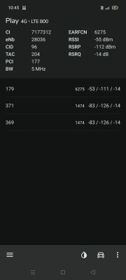

    Hi. I want to see which BTS I'm connecting with. I have Play.
    Network cell info shows me a different ID than btsy in the area. I am using the bts search map.

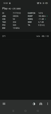

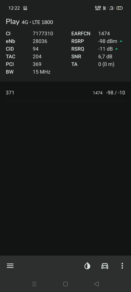

    The station is not added to the btsearch.pl database, where are you using it? In general, it's a drama because you have very poor signal parameters on pseudo LTE800, this band in Play is irrelevant, it's only 5MHz wide and usually clogged amen. PCI on LTE1800 appears in the neighbors, but these are the remains of the signal.

    You are unlucky because it seems that you are located between two sectors on this BTS, as evidenced by similar signal parameters from two different PCI, both on LTE800 and LTE800, unfortunately, but inside the coverage is only on LTE800. Compare with https://jackiewiczowie.blogspot.com/2014/10/parametry-sygnau-lte.html
