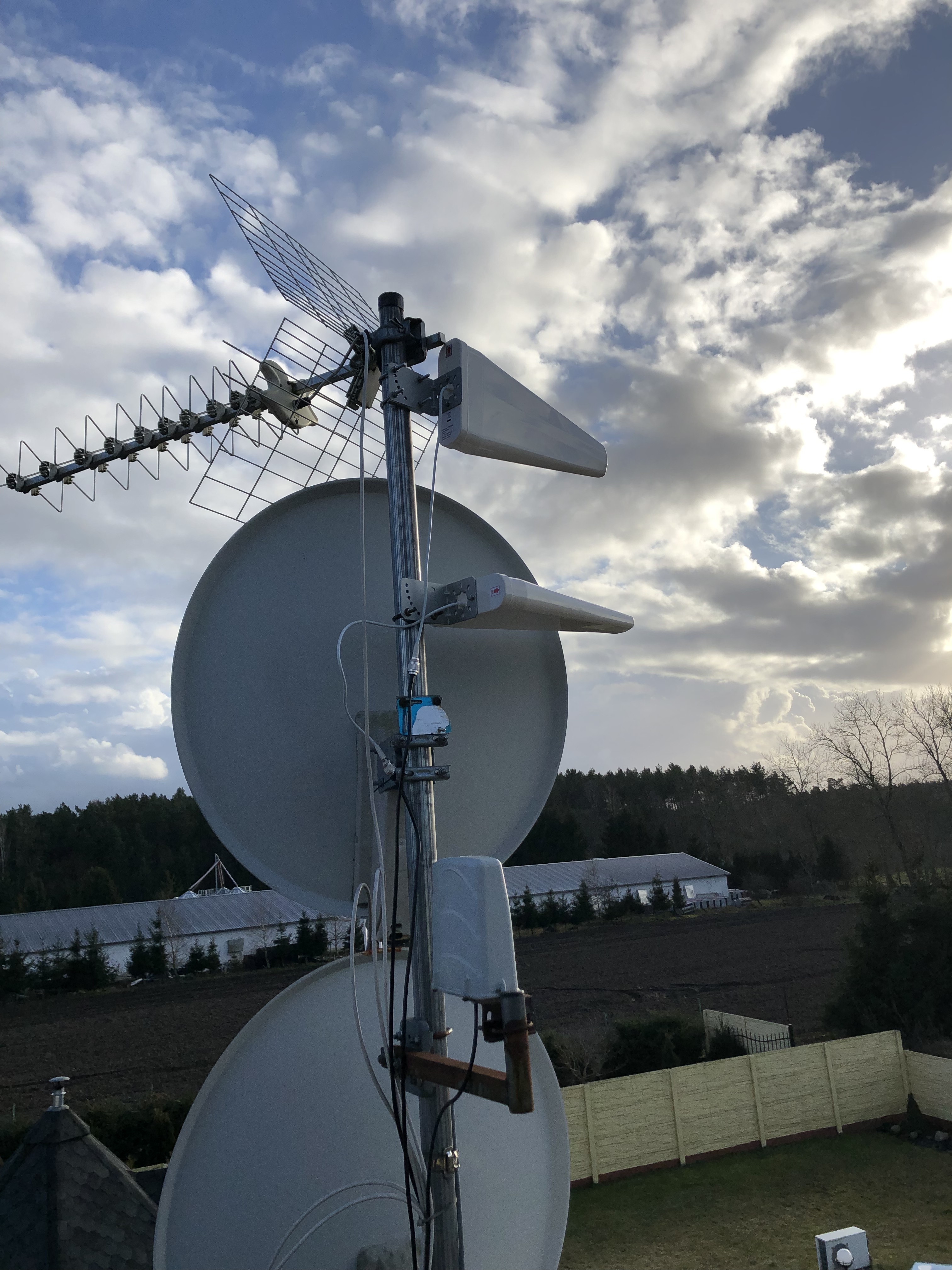

    The antennas came today. For now, I have set my eye on Słowacki because it is really hard today and it is already dark. On lte 1800 I have one dash more than before and 2600 do not catch. This dash may be more due to the fact that my cable is now 5 meters long and before it was 10 meters. I have these entens one under the other about 40 cm. Can the x-cross setting change something here, since it does not catch the 2600 at all? And the second question is whether the location of the antennas next to the satellite dish can interfere with something or it will not have an impact?
    And the question is whether the antennas should be positioned as in the picture or otherwise? How to Check BTS Connection on PC with Huawei B592-22s Router & Typhoon Antenna (76-004 Sieciemin)

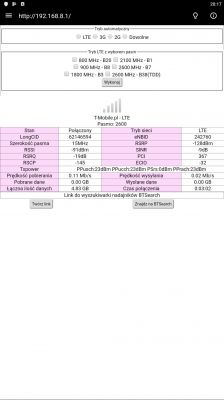

    Today a new huawei b715 router came and I caught the 2600 band for a while, but it was 0 lines rsrp -128. I would like to check from what bts I caught the 2600 to set the antenna in that direction. enbid242760, longcid 62146594. On bts search, it shows me a lot when I'm looking for this enbid, but it's about 30km from me, so it's a bit far away at 2600. I'll be thankful if someone tells me what bts I was able to connect with

    Yes, the antenna is set to the haystack at the station. I did not think that from such a distance you can catch the signal at 2600. Will replacing the antenna with cybertech improve something and is it a game worth the candle?

    From Mielno you will not get the correct signal on LTE2600. You have B715, antennas for Dworcowa, so check what bands work on it and how: LTE2100, LTE1800, LTE800 and finally LTE2600 again. Show screenshots from HManager and speedtests.

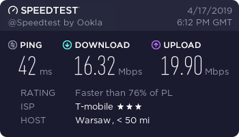

    lte 1800 train station

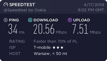

    lte 800 bts karnieszewice lawns

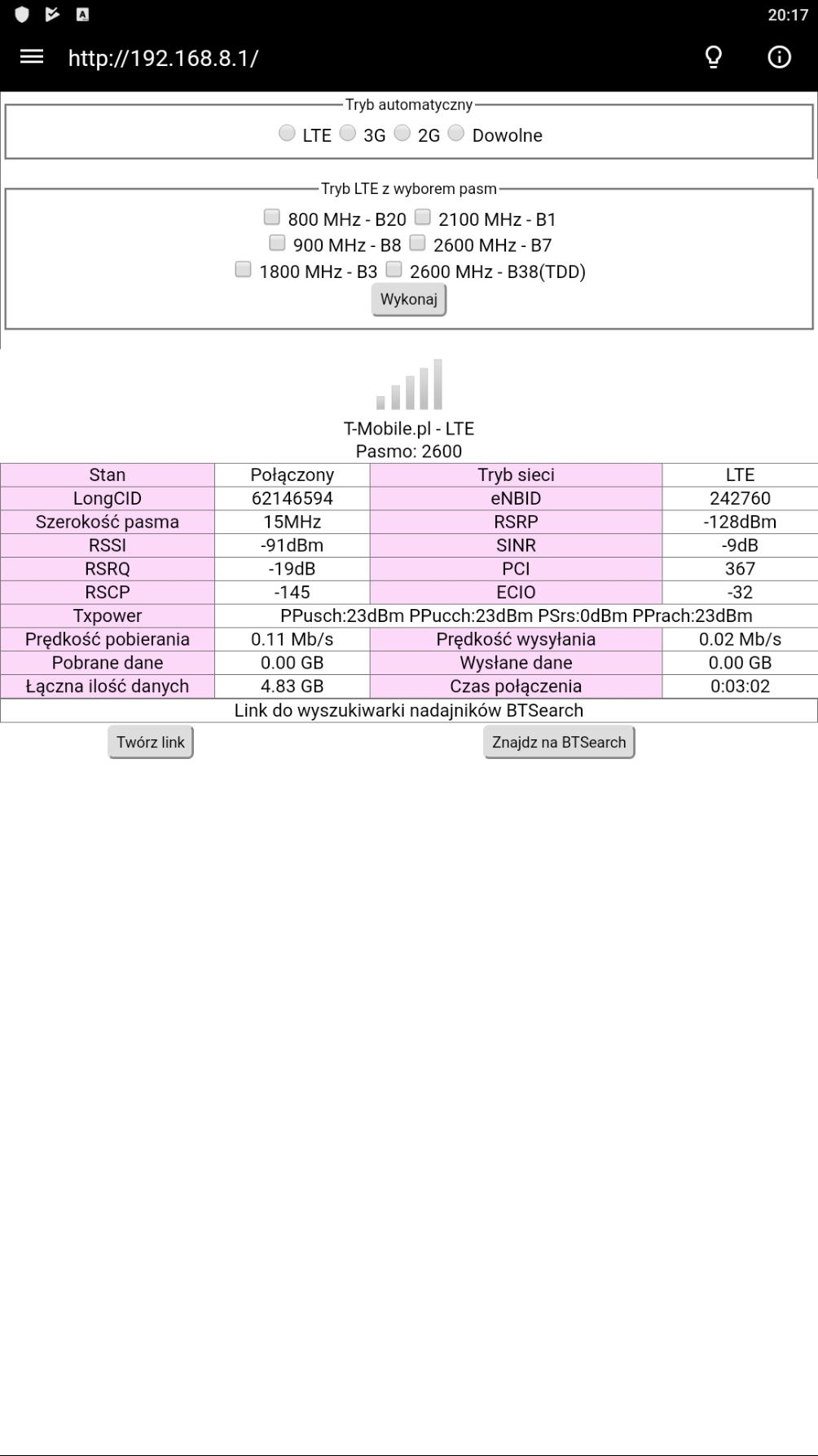

    lte 2600
    dl 2.60 Mb / s ul 0

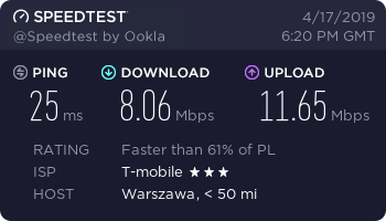

    And this is how I tried to set aggregations 800 + 1800 + 2600
