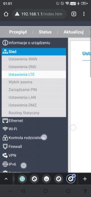

    hello I need help configuring the ZTE MF258 router
    The router works in the T mobile network, I have a fixed IP address assigned, but for it to work, I have to change the APN in the router from INTERNET to DATA and I can't find where I can change it.

    In the connection settings (access point) you probably put some screenshots.

    What do you have in WAN settings?
    You need to search for an APN profile.

    and here's the catch because I can't find and looked through the entire menu
    is there no instructions on the net for this router or I can't look for it ??

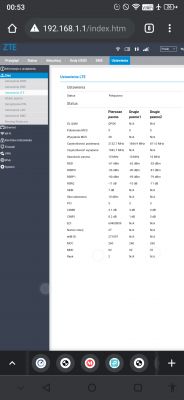

    In this FW version, the Settings-Network-APN management tab is missing, the same was true for WF830 / 860, access to this option has been added to the smartadmin account, you are logging in as admin as standard?

    I do not know the FW for T-mobile for this equipment, but as far as I know, B04 has a selection of LTE bands from the admin position, but it is not possible to change the APN, you have equipment from T-mobile, they sold you an offer with public IP, so ask them or contact ZTE Polska via their Mesenger.
    You have sufficient signal parameters on LTE2100 / 1800 from BTS Józefowo.
