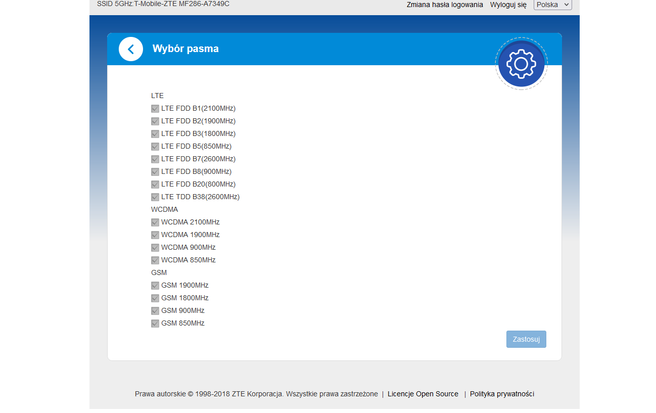

    Is band aggregation possible in the ZTE MF286 router?
    Router with T-Mobile logo.
    Is there any application for this, I know that huawei can have phone applications.
    I tried to look in the router settings on the website there is no band aggregation option.

    Exploring Band Aggregation in ZTE MF286 Router: T-Mobile Logo, Huawei Apps & Web Settings oh shit I found something but I can't click anything it's greyed out
    Added after 3 [minutes]:
    I have a completely different menu "Settings tab - Network settings - Band selection?" I didn't like what you wrote
    Added after 37 [seconds]:
    location Masovian Voivodeship near Warsaw

    If you have to cooperate like this, unfortunately, I don't see any chance of helping you, the Band Selection tab is standard in all ZTE, easy to find, as well as the note that changing the band is possible only after disconnecting from the Internet, i.e. OFF after logging into the router and then selecting the bands is possible in it. After selecting a band or 2 bands, the selection is confirmed and manually connected to the network on ON.

    Force both at once and check if this aggregation will turn on on MF286, this router was available in several versions, it differs in the LTE modem used and thus the aggregation of LTE bands.
  • 2100 and 1800 band selection reduced speed

    I supposedly connected, i.e. in these settings I marked 2100 and 1800 and surprisingly the weaker result from 34 mb / s to 1800 fell by connecting and I have 20 mb / s
    only if it aggregated, I don't know, maybe it just went to 2100 because I have no information anywhere because on huawei it says "1800 + 2100" and there is nothing here
    Added after 5 [minutes]:
    maybe not that there is nothing, just information with which bts I am connected and that's it
    Added after 35 [minutes]:
    well, yes, I have the band number and now it is set to 2100 and I marked 2100 and 1800 hmm

    If it does not aggregate B1 + B3, then you have the MF286, the oldest first version, it probably also had a battery under the flap at the back.
