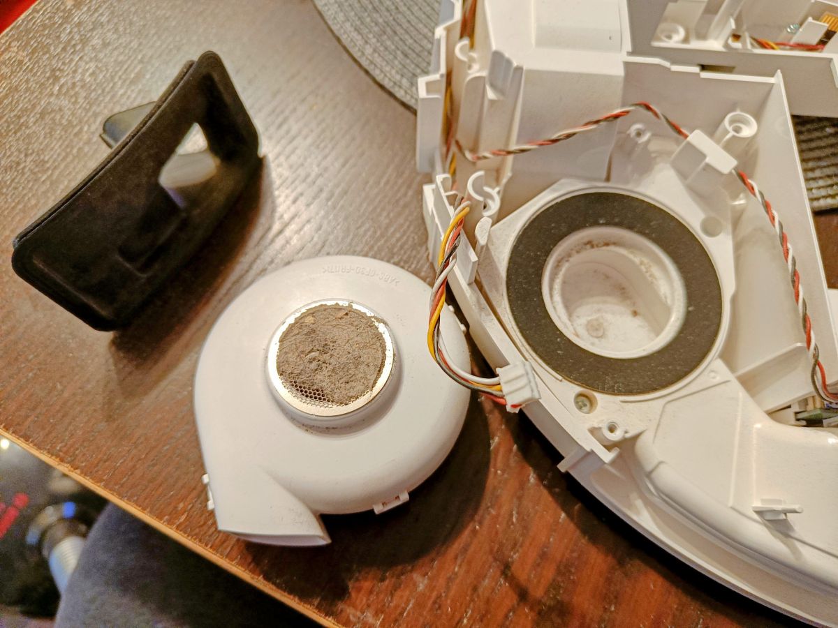

    I started it. I cleared it.
    I once tried it myself, without any video, but I didn't know that the flap with buttons in my S5 only presses into place. I took courage and the catches released. I've reached the end of the video :)
    After cleaning the blower and putting it back together, the robot is as good as new.
    You can't hear it at all!
    Dismantled parts of a robotic vacuum with a dust-covered blower.

    gruberto wrote:
    The robot after cleaning the blower
    But it`s crap, you`re vacuuming with a torn filter in the tank or something, after all, whatever gets sucked in, blows away. I opened my S6 after 4 years because I had to replace the motherboard, there was nothing on the strainer, nor a simple coating on the sponge, and I have a very large house.
  • Dust buildup on the blower diffuser strainer
    #20 20981092
    gruberto
    Posts: 24
    Sebastian_M26 wrote:
    Are you vacuuming with a torn filter in the tank or something?
    - no, everything is replaced on an ongoing basis. This is what a vacuum cleaner looks like after 4.5 years of driving around a 68-meter house. It still went through the blower and settled on this sponge with a mesh at the end. Dust particles pass through the filter and settle on this strainer. I don't have any special crap in my house, most of the floors are tiles, only two rugs and that's what it looks like...
    BTW: Ad hoc blind cleaning can be done with a flexible hose inserted into this large diffuser
