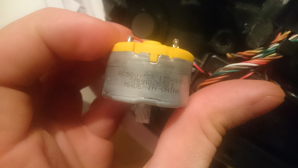

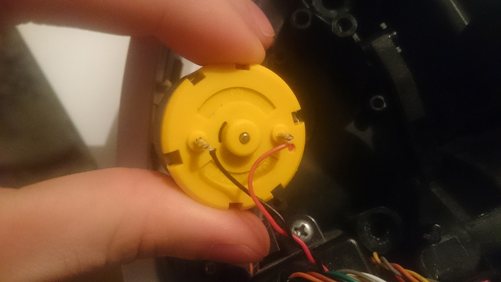

    Good morning,
    at some point the rotating brush in the ILIFE V7S automatic vacuum cleaner stopped working. I decided to fix it myself and removed the motor that is there and is responsible for turning the brush.
    I am asking for help in identifying and finding a match, because unfortunately entering data from the engine into Google did not bring satisfactory results.
    SMC Motor
    RC500-KW / 13500 / DV
    SMHN086508
    Diameter: 3 cm
    Body height: 1.9 cm
    Picture attached
    Thank you for any tips that will help me repair this system.
    • Repair ILIFE V7S: Identify & Find Matching SMC Motor for Rotating Brush (RC500-KW/13500/DV) DSC_0925.jpg (97.11 KB) You must be logged in to download this attachment.
    • Repair ILIFE V7S: Identify & Find Matching SMC Motor for Rotating Brush (RC500-KW/13500/DV) DSC_0926.jpg (105.86 KB) You must be logged in to download this attachment.

    How do you know it's a motor. Measure the tension if it occurs. As it comes then you can try to choose the engine.

    Connect the motor for a moment to the 9V battery - is it rotating?

    A little update from my site.
    I was able to fix it by replacing the engine.
    Unfortunately I did not find the perfect one as it was originally installed, but I found a similar https://www.aliexpress.com/item/1pc-J451-Roun...ar-Energy-Supply-MICRO-DC-MOTOR-Carbon-Brush- Reversing-with-brass-Gear / 32780265051.html
    Answering the previous question. Yes, I checked the previous engine and it turned, but very slowly. He lost power.
    best regards
  • #5 16426192
    398216 Usunięty
    Posts: 34223
    Help: 3925
    Rate: 9344
    If you still have one, check that the commutator is not dirty. Often at high loads, the brushes spark and commutator slots get soiled that they "stick" partly to close sections. Just clean / wash (IPA) and (as long as the brushes themselves are not burned out) will continue to work.
