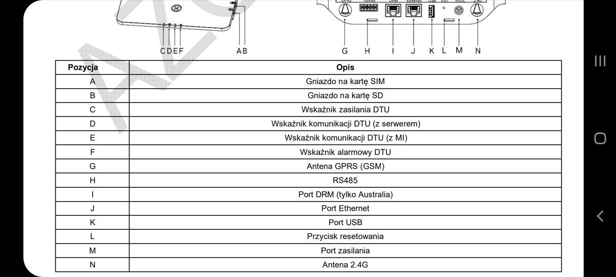

    On the back panel of the DTU is the "RST" button.
    This is a classic button where you usually press e.g. a pen waits for some seconds and the settings reset.
    I've been trying to hold it down, however, and the DTU does not want to reset its settings to factory defaults - it gives no sign at all that it is resetting anything.
    Did anyone reset Hoymiles DTU-Pro to factory settings?
    I tried to press the button for a longer time normally during operation or during startup but no result.

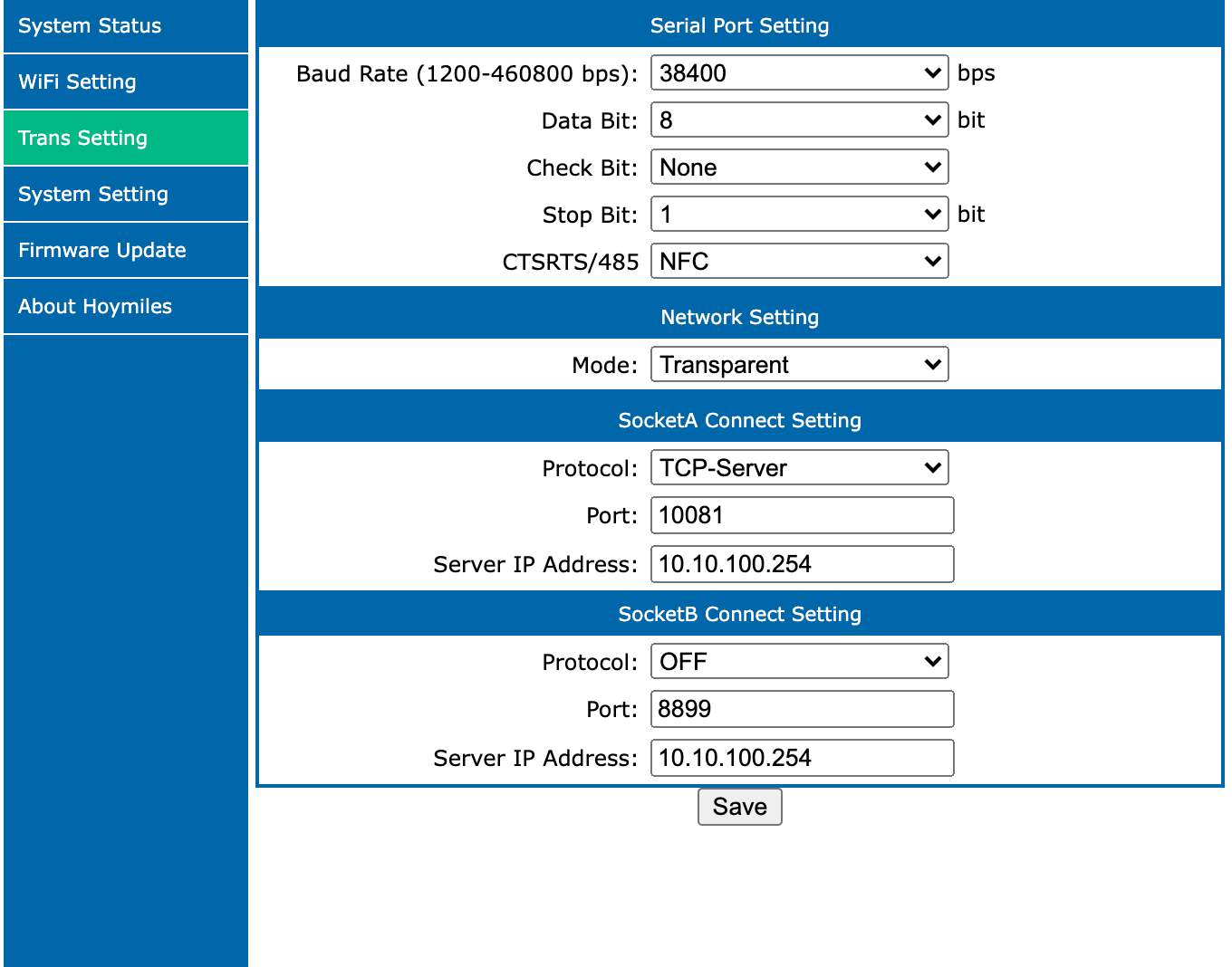

    I have exactly the same thing.
    Connecting via ETH cable doesn't actually change anything. The router to which I connect sees the DTUpro, assigns it an address but it is impossible to connect to it. Even manually entering network parameters (instead of DHCP) does not help.
    Two devices checked and the same thing. Factory settings after reset and re-set and same thing.
    What could be wrong
    We are in the process of downloading another router because we suspect that the two checked are faulty.
    Added after 23 [minutes]:
    Struggling with Hoymiles DTU-Pro Configuration and Resetting IP Settings After Modification
    Is there any error in the above settings. Can someone compare it?

    I think the above settings apply to communication with the Hoymiles server - I do not know.
    Mi over ethernet also did not connect - over wifi immediately.

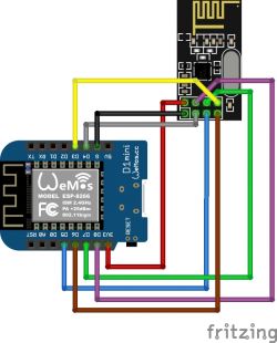

    You need to buy ESP8266 and NRF24L01+ connect according to the diagram
    Program the Ahoydtu using the online tool available at this link
    https://ahoydtu.de/getting_started/
    After installation, search for AHOY-DTU wifi network and go to the configuration page at http://192.168.4.1

Browser won’t open the config page—what checks help?
Ensure you are on the DTU’s subnet (10.10.100.x). If still blank, clear DNS cache and try http://10.10.100.254 directly. Some routers block 10.10.* ranges; use a static IP on your laptop (10.10.100.20/24) and retry [Elektroda, grzegrz1, post #19730848]

I want direct radio logging without the DTU—what hardware helps?
Flash AhoyDTU firmware onto an ESP8266 paired with an NRF24L01+ radio module; then configure via http://192.168.4.1 [Elektroda, kmarkot, post #20614545] "A €5 wireless sniffer beats buying another DTU," notes one contributor.
