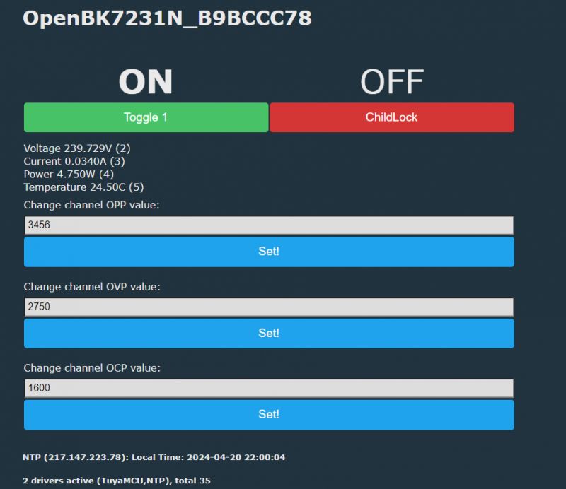

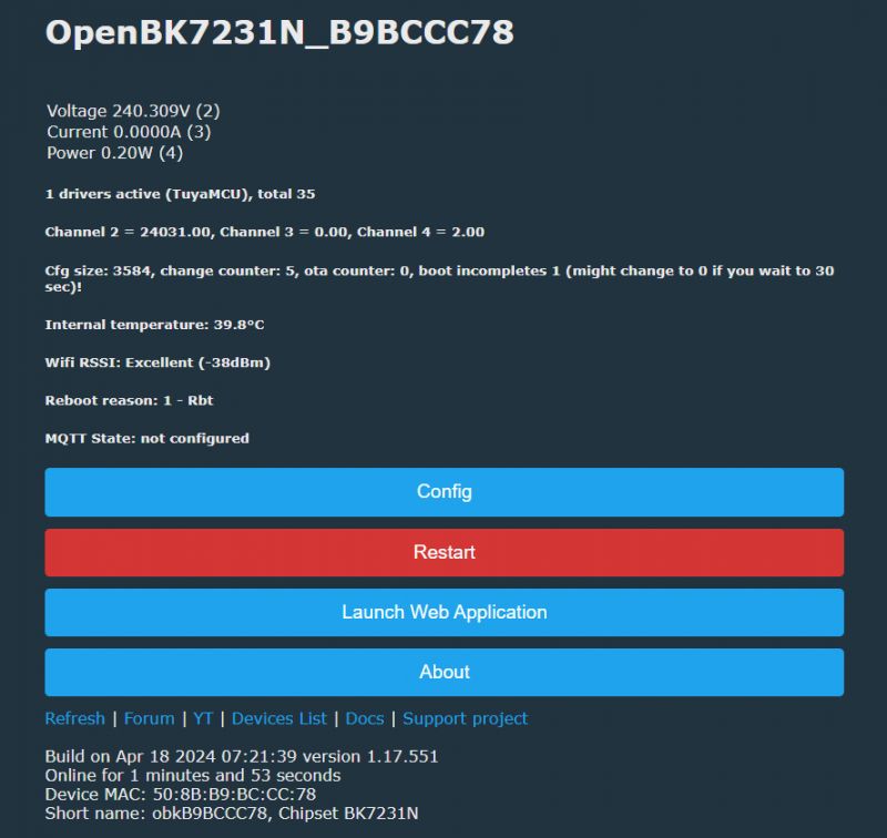

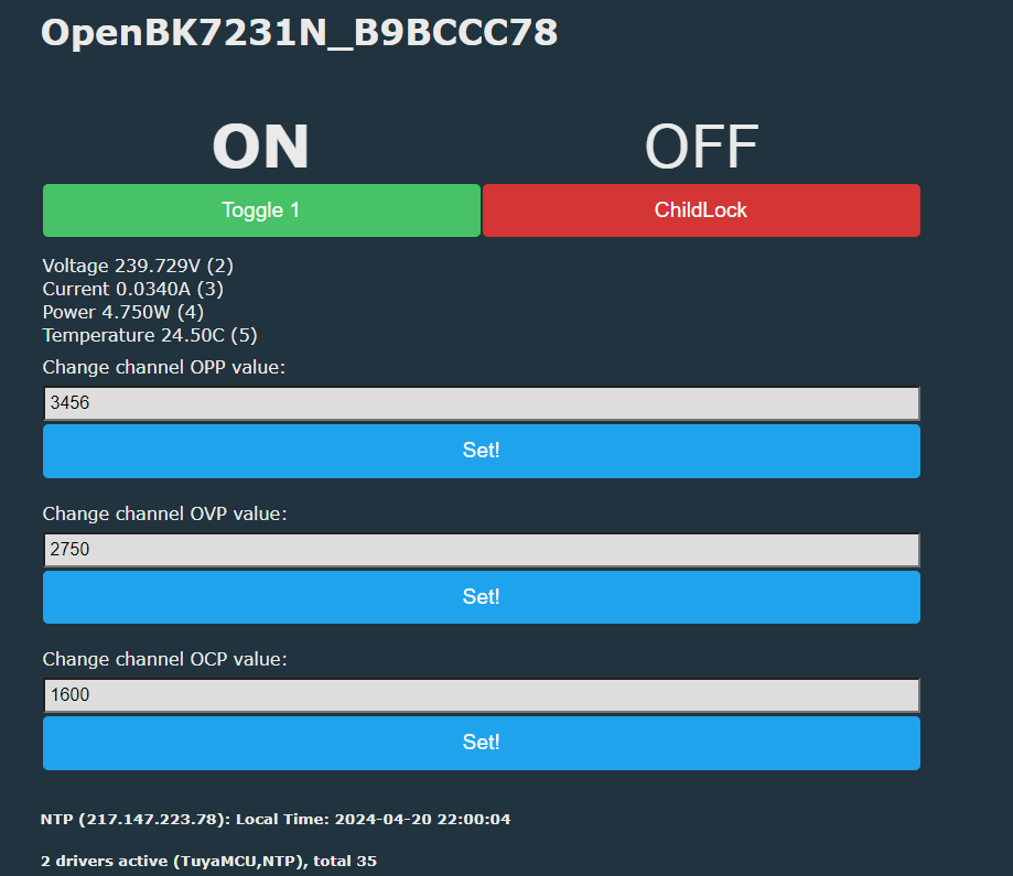

  • An Atorch S1TW-FR LCD energy meter/thermostat was converted into a fully local, cloudless controller.

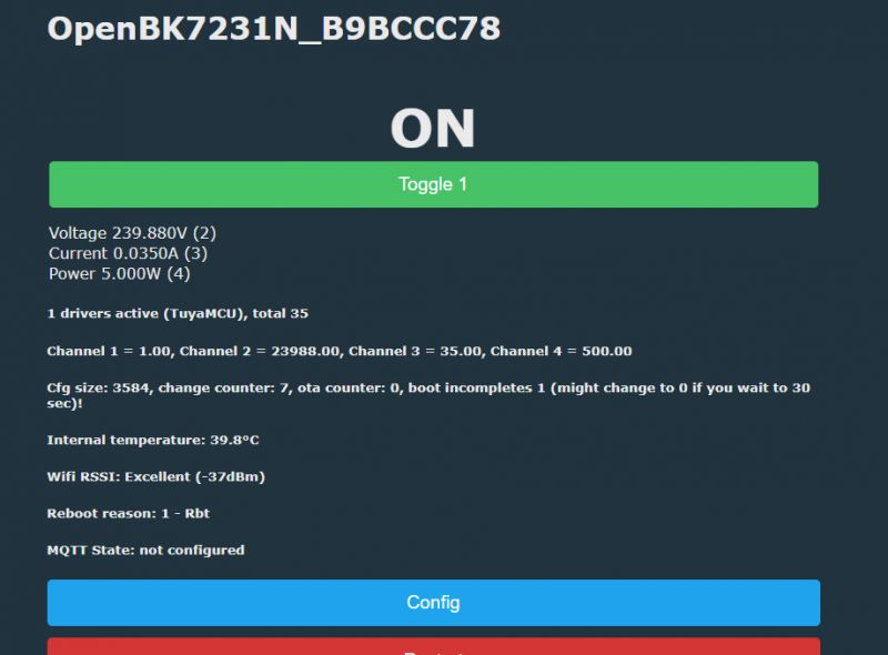

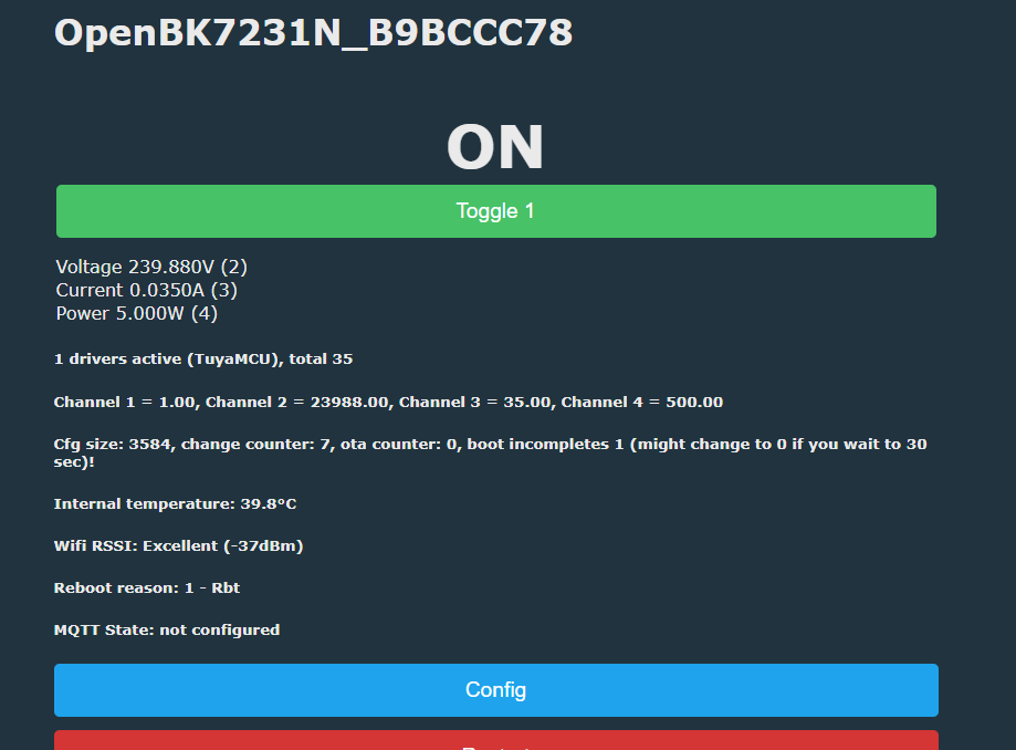

  • The build flashes OpenBeken onto the CB3S BK7231N WiFi module and maps it to the onboard TuyaMCU over UART.
  • The board uses an HF32FV-16 relay, BL0942 metering, a CH573F RISC-V MCU, and captures dpIDs for voltage 110, current 108, power 109.

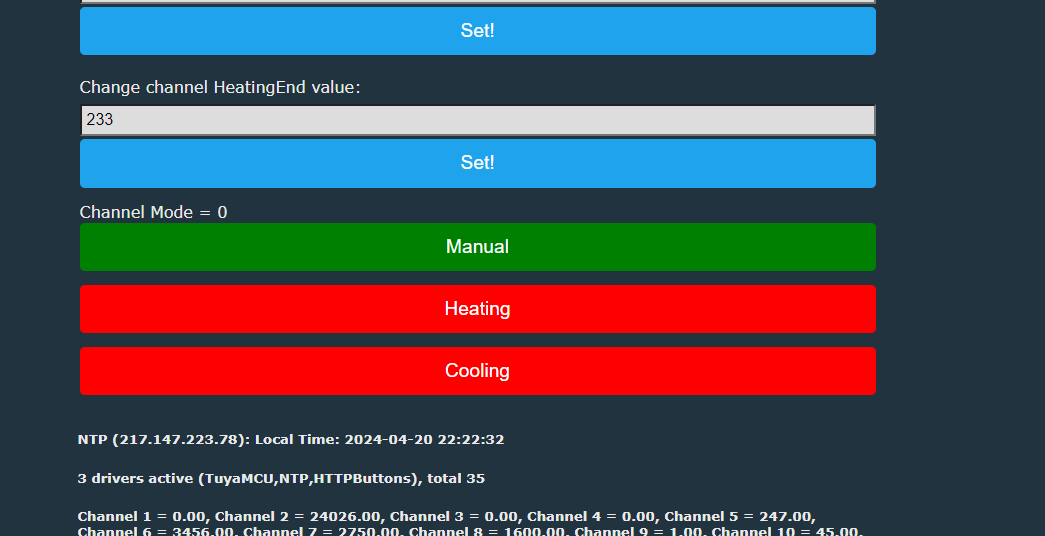

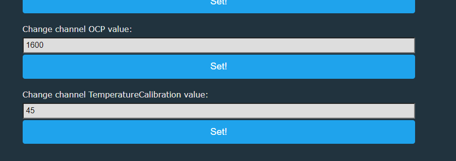

  • OpenBeken restores relay control, temperature reading, thermostat modes, child lock, and editable OPP, OVP, OCP, calibration, and schedule fields.
  • Home Assistant discovery still misses the HTTPButtons buttons, and UART sniffing needs isolation because the board lacks galvanic isolation.

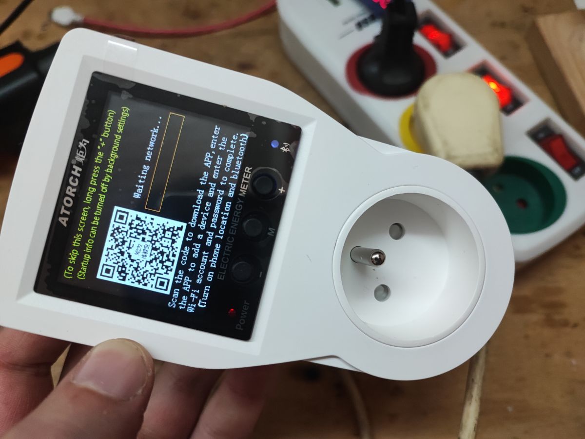

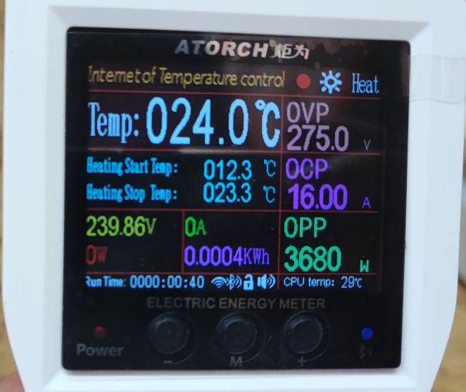

  • ATORCH electric energy meter with an LCD screen, waiting for network connection. .
    Here I will show step by step how an advanced energy meter/thermostat with LCD screen can be converted so that it can operate 100% locally, without the cloud and without the manufacturer's servers. I'll be converting the S1TW-FR discussed earlier here, to do this I'll upload OpenBeken to the WiFi module and configure it accordingly to communicate with the TuyaMCU on board.

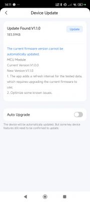

    It is worth reading the previous section here, where I showed pairing this meter with Tuya:
    Energy meter/thermostat with LCD - S1TW-FR - first impression, Tuya application .

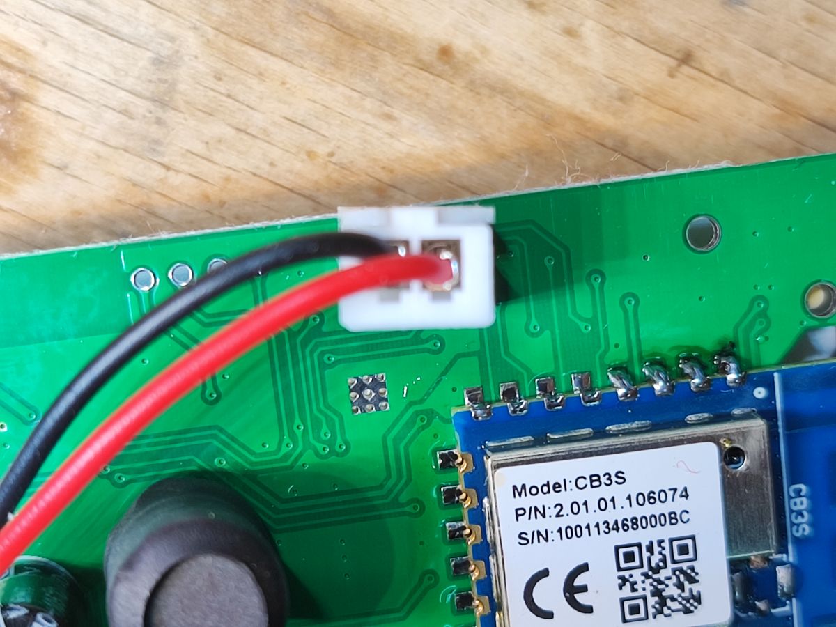

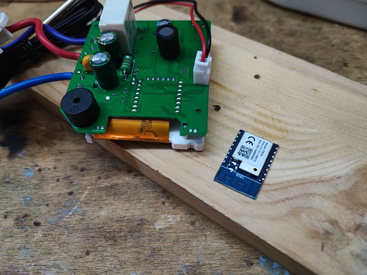

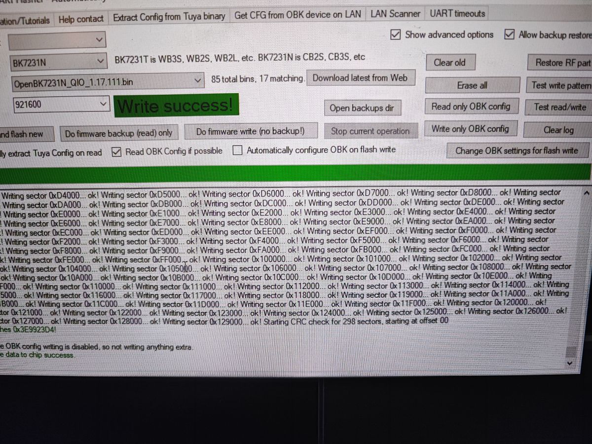

    3. soldering the WiFi module to upload OpenBeken via UART
    4. configuration of OpenBeken based on the acquired TuyaMCU dpID data

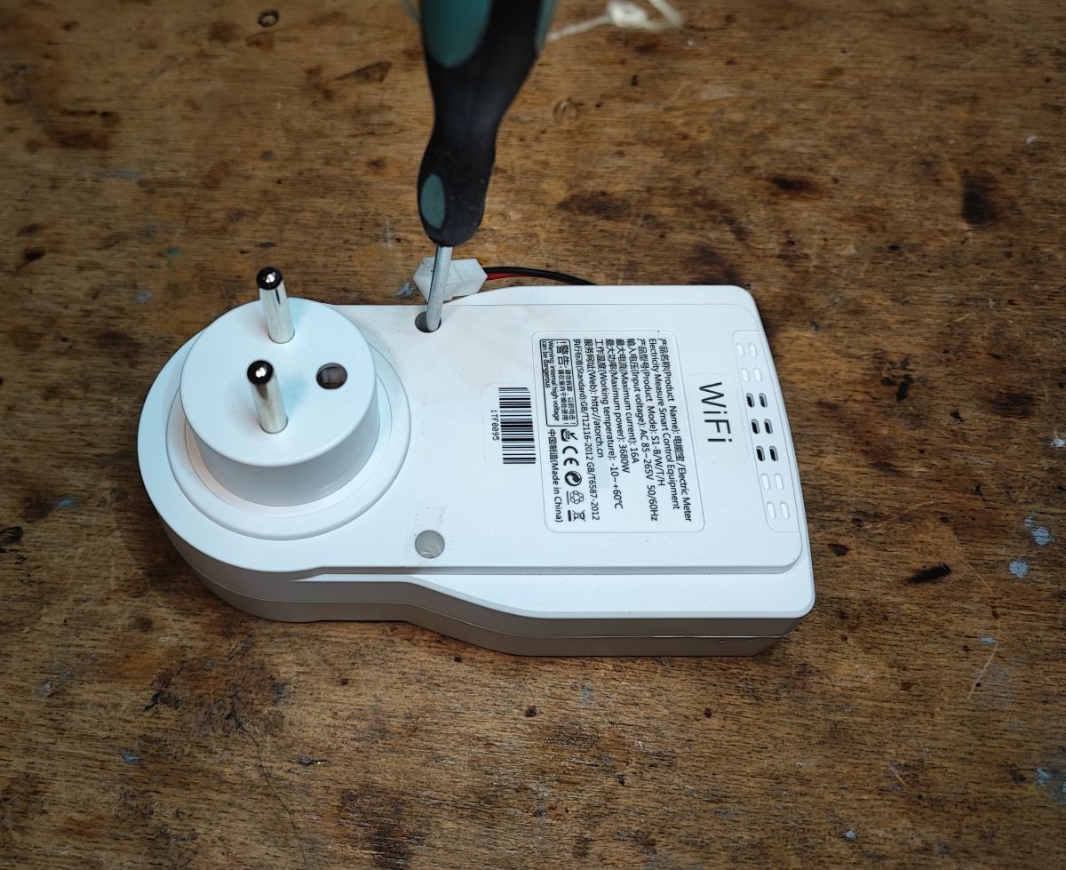

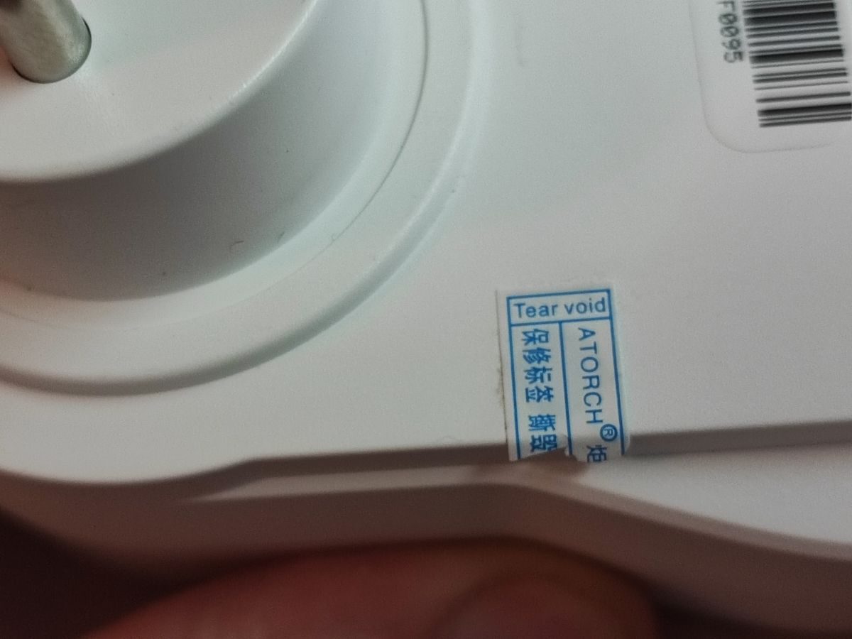

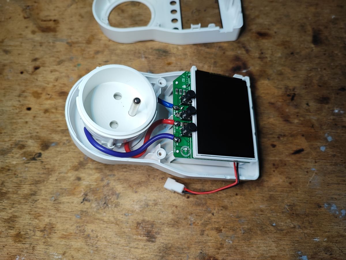

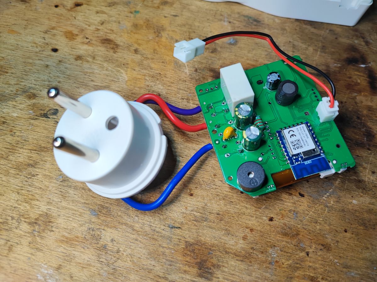

    Interior of S1TW-FR .
    We remove the seal and look inside:
    Photo of the S1TW-FR plug-in energy meter on a wooden surface, showing the plug socket and specification label. Close-up of a warranty seal with the text Tear void on a plug-in energy meter. .

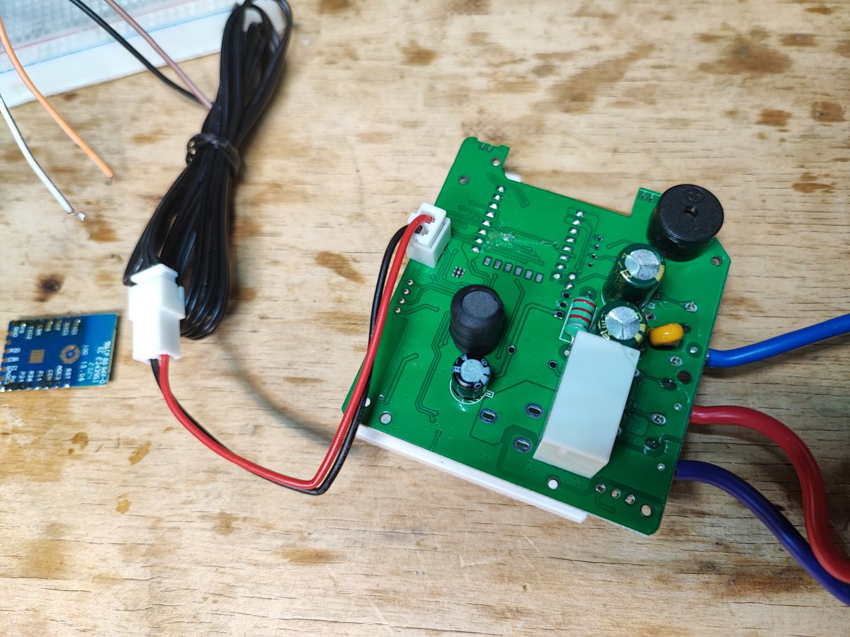

    We remove the housing:
    Interior of an open S1TW-FR energy meter showing the circuit board and wiring. .

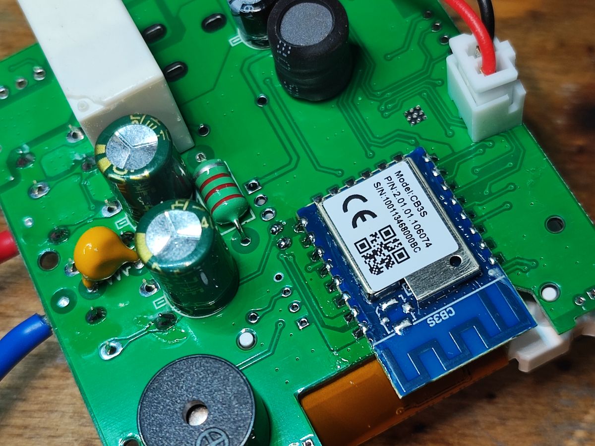

    S1TW-FR thermostat PCB with desoldered WiFi module on a wooden table .

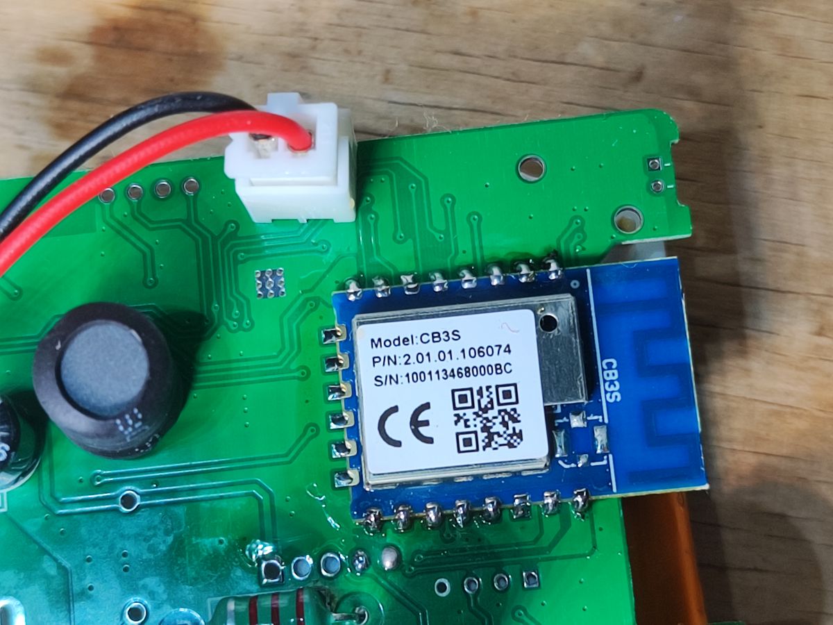

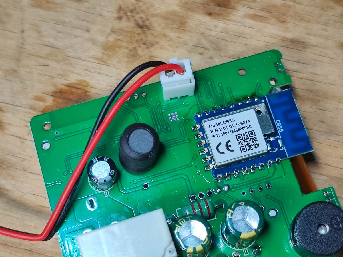

    The whole is based on the CB3S module (BK7231N); you can upload OpenBeken :
    CB3S module on a device circuit board. .

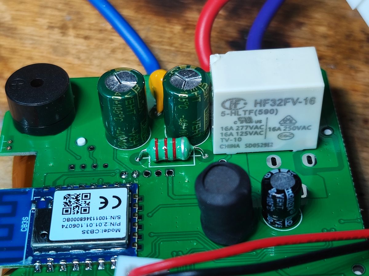

    But first, let's take a look at the interior. The relay is an HF32FV-16 for 16A 250VAC:
    View of the interior of the device's circuit board featuring a CB3S module and HF32FV-16 relay. .

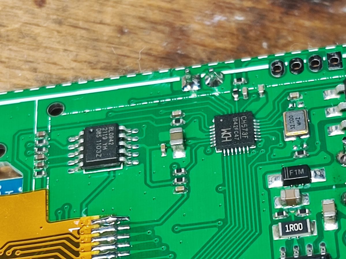

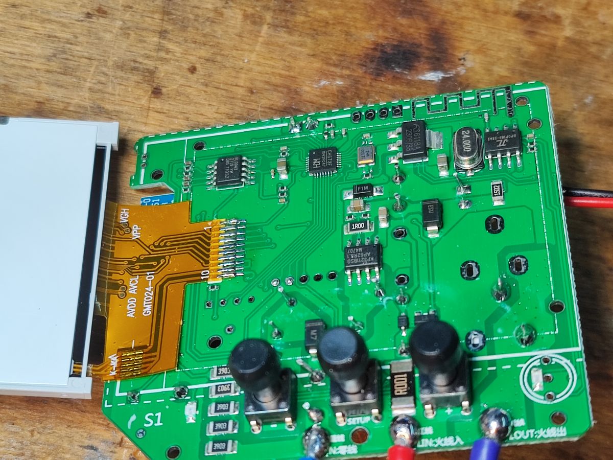

    There is more going on on the other side of the board. That's because this device is based on the TuyaMCU, so here we have a WiFi module separately, and an additional microcontroller separately:
    Photo of a circuit board of an energy meter/thermostat with exposed LCD section. .

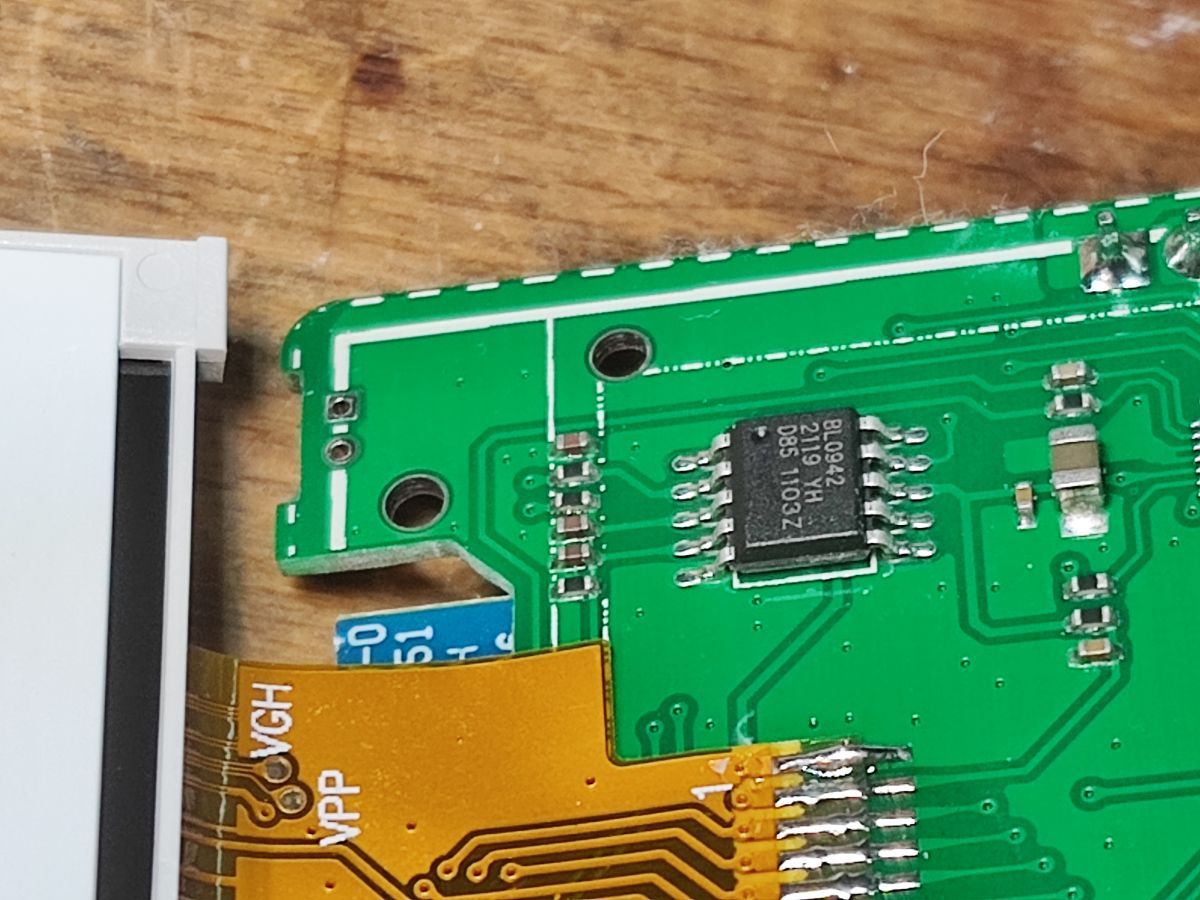

    BL0942 here is responsible for measuring current, voltage and power, it reports the results to the microcontroller right next to it:
    Close-up of a printed circuit board with a BL0942 chip. .

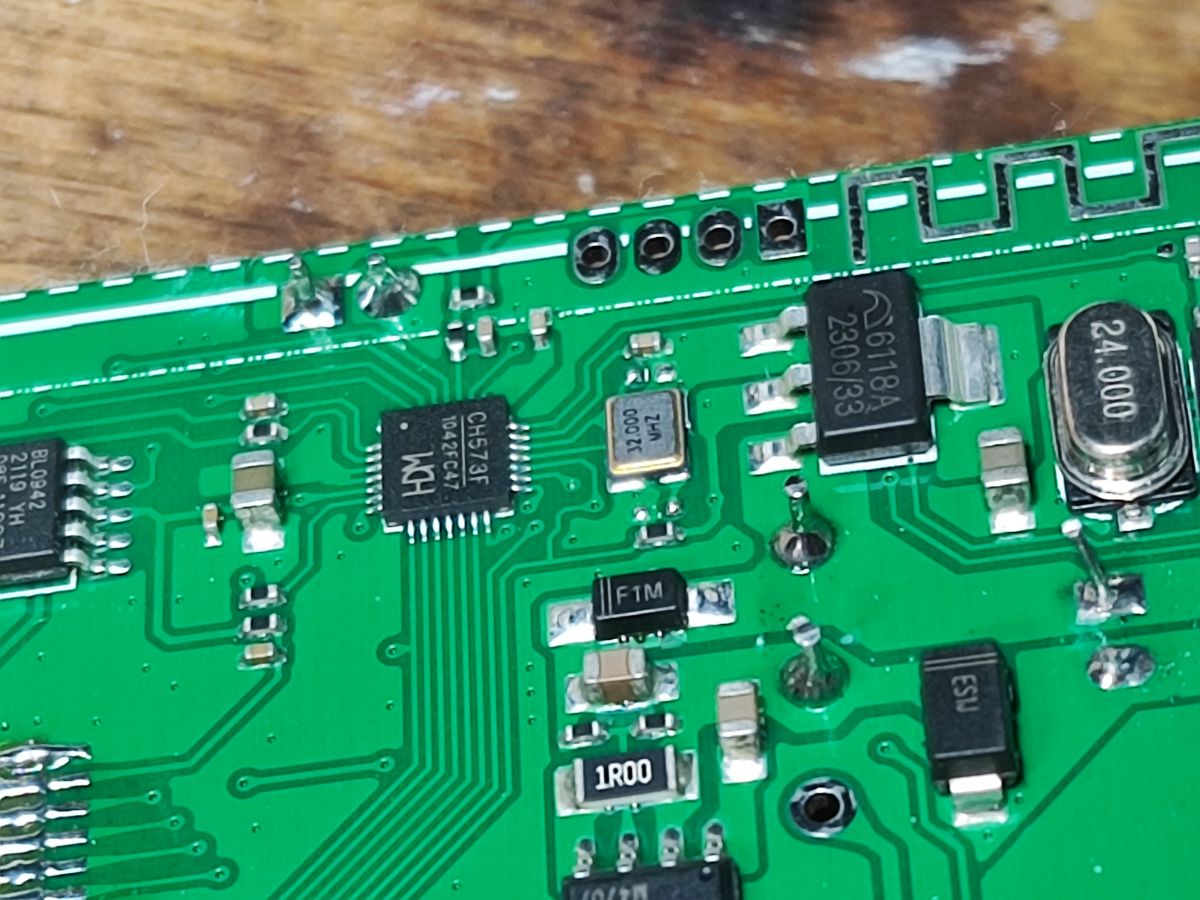

    This MCU next to it is the CH573F (32-bit RISC-V):
    Close-up of a PCB with CH573F microcontroller and BL0942 chip. .

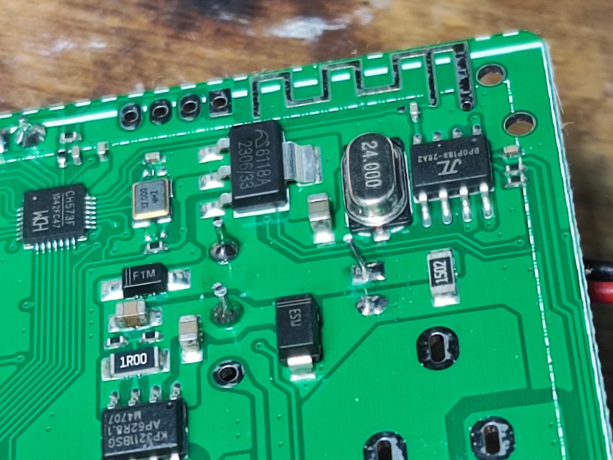

    It is powered by a 3.3V LDO:
    View of the S1TW-FR circuit board with component markings. .
    I was curious about the BP0P189 chip, I think it's something from Bluetooth. I wonder why, since the BK7231 already has BT. I associate the JL logo with other similar chips.

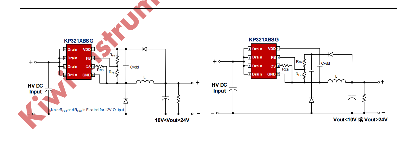

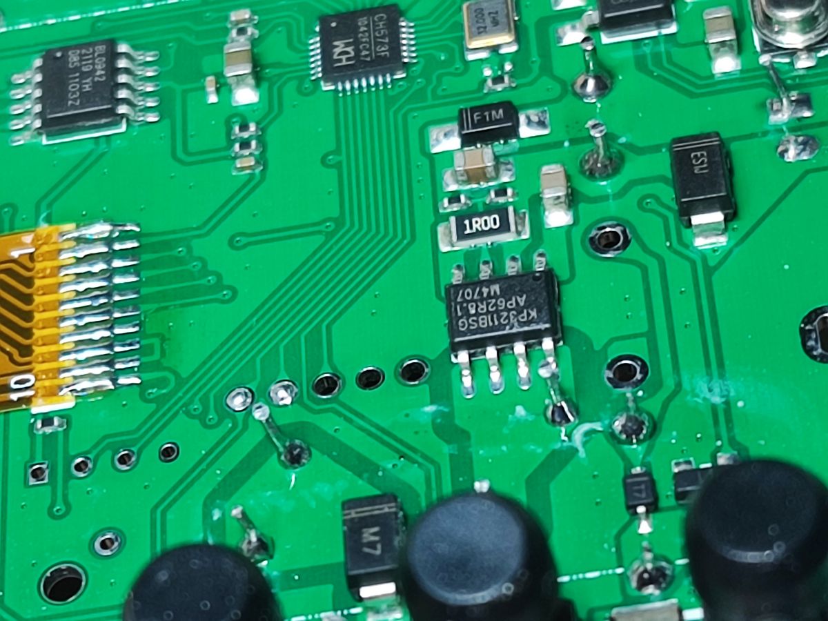

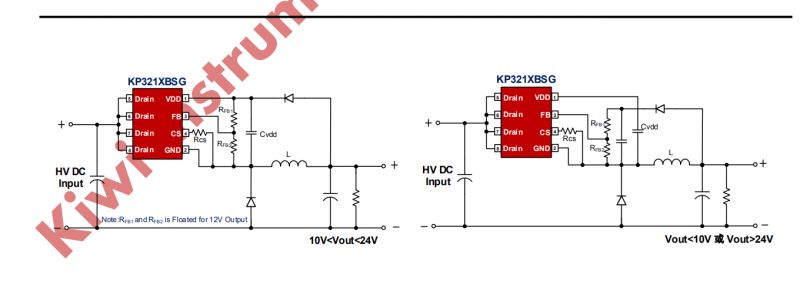

    There remains the question of power supply. These are provided by the KP3211BSG.
    Close-up of a circuit board with integrated circuits of the S1TW-FR. .
    This is a non-isolated inverter controller, there is no flyback power supply:
    Electrical schematic of KP321XBSG power controller .

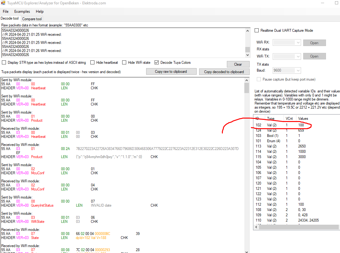

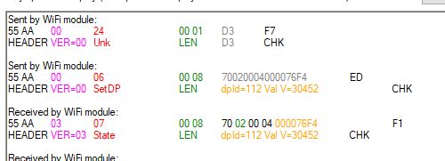

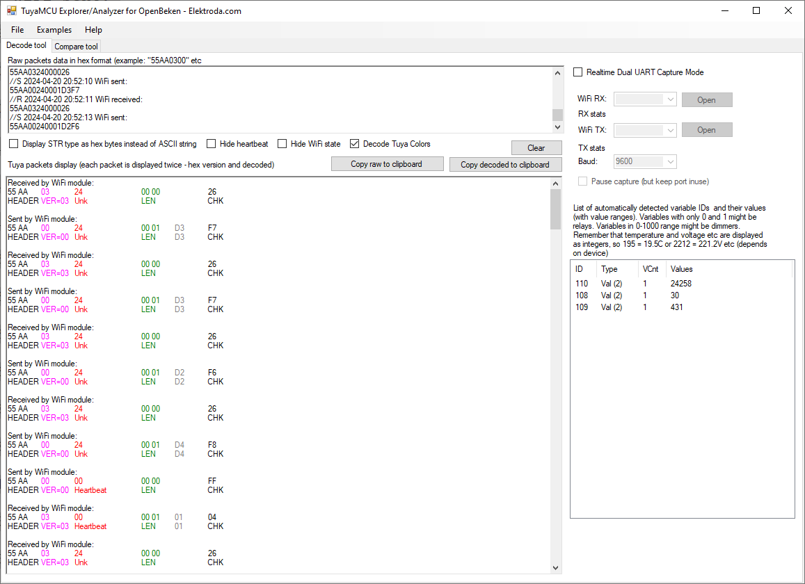

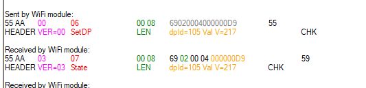

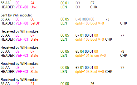

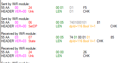

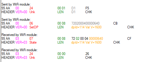

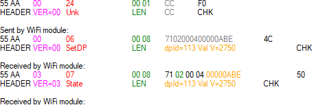

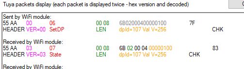

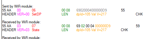

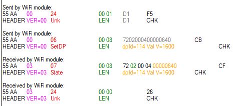

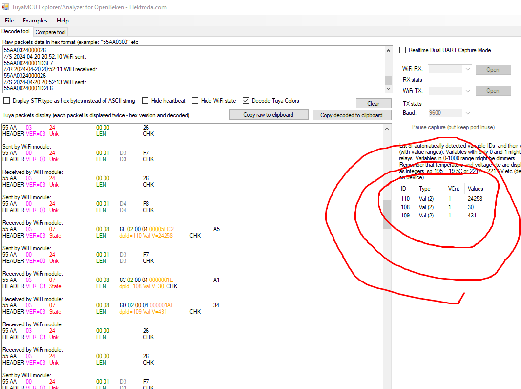

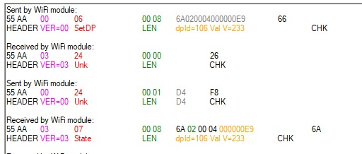

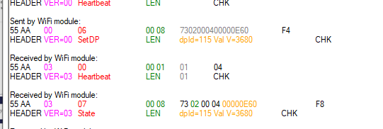

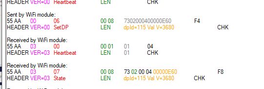

    Communication intercept .

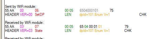

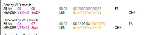

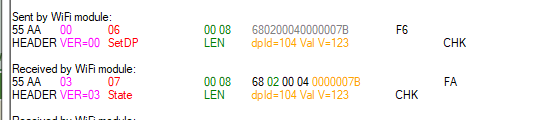

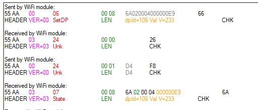

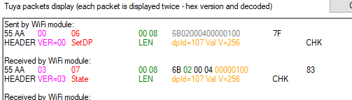

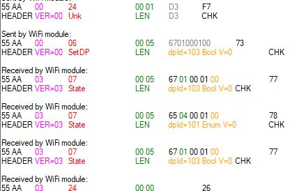

    In accordance with the topic on TuyaMCU I have intercepted communication on the RX/TX lines:
    TuyaMCU protocol - communication between microcontroller and WiFi module .
    I used my analyser to capture:
    . TuyaMCU analyser - UART packet decoder for Tuya devices - dpID detector .
    Due to the lack of galvanic isolation with this device, the capture should preferably be done via suitable opto-isolators on both UART lines!!! .
    Alternatively, a completely disconnected (battery-powered) device can be used.
    Here is the captured data, each operation separately. The data presented can be pasted into my analyser to see the dpID of the variables and their types and values. Feel free to experiment on your own. The data so defined will then be used to write the OBK configuration for this device.
    Fragment with measurements (dpID 110, 108, 109): .

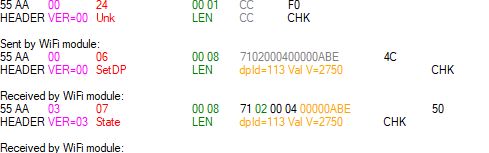

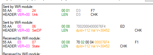

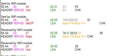

    Screenshot of TuyaMCU Explorer program showing decoded data. .
    Temperature 18.8°C and other measurements :

    //R WiFi received:
    55AA0307000866020004000000BC39
    //S WiFi sent:
    55AA00240001D4F8
    //R WiFi received:
    55AA030700087C0200040000029328
    //S WiFi sent:
    55AA00240001D4F8
    //R WiFi received:
    55AA030700086E02000400005E8D70
    //S WiFi sent:
    55AA00240001D3F7
    //R WiFi received:
    55AA030700086C0200040000001EA1
    //S WiFi sent:
    55AA00240001D6FA
    //R WiFi received:
    55AA030700086D020004000001AC31
    //S WiFi sent:
    55AA00240001D2F6
    //S WiFi sent:
    55AA00000000FF
    //S WiFi sent:
    55AA00240001D4F8
    //S WiFi sent:
    55AA00240001D3F7
    //S WiFi sent:
    55AA00240001D5F9
    //S WiFi sent:
    55AA00240001D3F7
    //R WiFi received:
    55AA030000010104
    //S WiFi sent:
    55AA00240001D4F8
    //S WiFi sent:
    55AA00240001D4F8
    //S WiFi sent:
    55AA00240001D0F4
    //S WiFi sent:
    55AA00240001D3F7
    TuyaMCU Explorer screen with UART data .

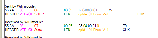

    Turning on and off several times:
    //S WiFi sent:
    55AA00240001D3F7
    //S WiFi sent:
    55AA00060005670100010073
    //R WiFi received:
    55AA03070005670100010077
    //R WiFi received:
    55AA03070005650400010078
    //R WiFi received:
    //S WiFi sent:
    55AA00240001D3F7
    //S WiFi sent:
    55AA00060005670100010174
    //R WiFi received:
    55AA03070005670100010178
    //R WiFi received:
    //R WiFi received:
    //R WiFi received:
    //S WiFi sent:
    55AA00240001D3F7
    //S WiFi sent:
    //R WiFi received:
    //R WiFi received:
    //R WiFi received:
    //S WiFi sent:
    55AA00240001D2F6
    //S WiFi sent:
    //R WiFi received:
    //R WiFi received:
    //R WiFi received:
    //S WiFi sent:
    55AA00240001D3F7
    //S WiFi sent:
    55AA00240001D4F8
    //S WiFi sent:
    55AA00240001D6FA
    View of UART communication between WiFi module and microcontroller. .
    Child Lock on and off:
    //S WiFi sent:
    55AA00240001D1F5
    //S WiFi sent:
    55AA00060005740100010181
    //R WiFi received:
    55AA03070005740100010185
    //S WiFi sent:
    55AA00240001CEF2
    //S WiFi sent:
    55AA00240001CDF1
    //S WiFi sent:
    55AA00060005740100010080
    //R WiFi received:
    55AA03070005740100010084
    //S WiFi sent:
    55AA00240001CDF1
    //S WiFi sent:
    55AA00240001D1F5
    //S WiFi sent:
    55AA00240001D2F6
    Screenshot of communication analysis with a WiFi module. .

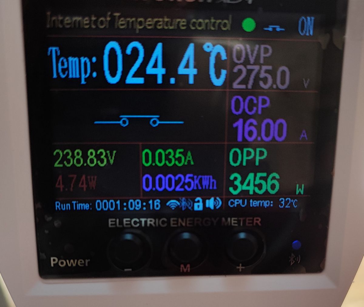

    Changed OVP from 265 to 275:
    //S WiFi sent:
    55AA00240001CFF3
    //S WiFi sent:
    55AA00240001CBEF
    //S WiFi sent:
    55AA00240001CCF0
    //S WiFi sent:
    55AA000600087102000400000ABE4C
    //R WiFi received:
    55AA030700087102000400000ABE50
    //S WiFi sent:
    55AA00240001D1F5
    //S WiFi sent:
    55AA00240001D3F7
    //S WiFi sent:
    55AA00240001D1F5
    //S WiFi sent:
    55AA00240001D0F4
    //S WiFi sent:
    55AA00000000FF
    //R WiFi received:
    55AA030000010104
    //R WiFi received:
    //S WiFi sent:
    55AA00240001D1F5
    Analysis of TuyaMCU communication data on a WiFi module. .
    Changed OCP from 10A to 16A:
    //S WiFi sent:
    55AA00240001D0F4
    //S WiFi sent:
    55AA00240001D1F5
    //S WiFi sent:
    55AA00240001D0F4
    //S WiFi sent:
    55AA00240001D1F5
    //S WiFi sent:
    55AA00240001D1F5
    //S WiFi sent:
    55AA000600087202000400000640CB
    //R WiFi received:
    55AA030700087202000400000640CF
    //S WiFi sent:
    55AA00240001D1F5
    //S WiFi sent:
    55AA00240001D3F7
    //S WiFi sent:
    55AA00240001D2F6
    //S WiFi sent:
    55AA00240001D2F6
    //S WiFi sent:
    55AA00240001D3F7
    //S WiFi sent:
    55AA00000000FF
    //R WiFi received:
    55AA030000010104
    //S WiFi sent:
    55AA00240001D4F8
    WiFi communication data with TuyaMCU, displayed as UART packets. .

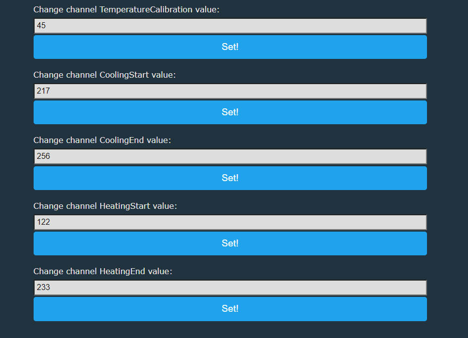

    Changing the temperature calibration from 0 to 4.5°C:
    //S WiFi sent:
    55AA00000000FF
    //S WiFi sent:
    55AA00000000FF
    //S WiFi sent:
    55AA0001000000

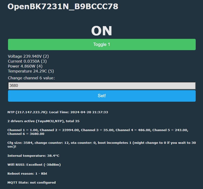

    Change OPP from 3000W to 3680W: .
    //R WiFi received:
    //S WiFi sent:
    55AA00240001CCF0
    //R WiFi received:
    //S WiFi sent:
    55AA00240001D2F6
    //R WiFi received:
    //S WiFi sent:
    55AA00240001D2F6
    //S WiFi sent:
    55AA00000000FF
    //S WiFi sent:
    55AA000600087302000400000E60F4
    //R WiFi received:
    55AA030000010104
    //R WiFi received:
    55AA030700087302000400000E60F8
    //R WiFi received:
    //S WiFi sent:
    55AA00240001D0F4
    //R WiFi received:
    //S WiFi sent:
    55AA00240001D3F7
    //R WiFi received:
    //S WiFi sent:
    55AA00240001D2F6
    Interface displaying communication data between WiFi module and microcontroller. .
    Set cooling start at 21.7°C:
    //R WiFi received:
    //S WiFi sent:
    55AA00240001D1F5
    //S WiFi sent:
    55AA0006000869020004000000D955
    //R WiFi received:
    55AA0307000869020004000000D959
    //R WiFi received:
    55AA0307000565040001027A

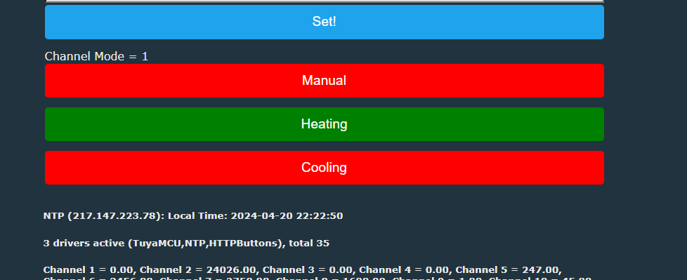

    Changing the cooling mode to heating:
    //R WiFi received:
    //S WiFi sent:
    55AA00240001D2F6
    //S WiFi sent:
    55AA00000000FF
    //R WiFi received:
    55AA030000010104
    //R WiFi received:
    //S WiFi sent:
    55AA00240001D3F7
    //S WiFi sent:
    55AA00060005650400010175
    //R WiFi received:
    55AA03070005650400010179
    //R WiFi received:
    //R WiFi received:
    //R WiFi received:
    //S WiFi sent:
    55AA00240001D4F8
    //R WiFi received:
    //S WiFi sent:
    55AA00240001D5F9
    //R WiFi received:
    //S WiFi sent:
    55AA00240001D4F8
    Screenshot of TuyaMCU protocol analysis
    Setting the heating start at 12.3°C:
    //R WiFi received:
    //S WiFi sent:
    55AA00240001D4F8
    //S WiFi sent:
    55AA00060008680200040000007BF6
    //R WiFi received:
    55AA03070008680200040000007BFA
    //R WiFi received:
    //R WiFi received:
    //R WiFi received:
    //S WiFi sent:
    55AA00240001D5F9
    //R WiFi received:
    //S WiFi sent:
    55AA00240001D6FA
    //R WiFi received:
    //S WiFi sent:
    55AA00240001D6FA
    Details of TuyaMCU communication protocol between WiFi module and microcontroller. .
    Changed kWh price to 304.52:
    //S WiFi sent:
    55AA00240001D3F7
    //S WiFi sent:
    55AA0006000870020004000076F4ED
    //R WiFi received:
    55AA0307000870020004000076F4F1
    //R WiFi received:
    //S WiFi sent:
    55AA00240001D4F8
    //R WiFi received:
    //S WiFi sent:
    55AA00240001D6FA
    //R WiFi received:
    //S WiFi sent:
    55AA00240001D4F8
    Screenshot of data communication between the WiFi module and the device. .
    Changing the heating stop to 23.3°C:
    //S WiFi sent:
    55AA000600086A020004000000E966
    //R WiFi received:
    //S WiFi sent:
    55AA00240001D4F8
    //R WiFi received:
    55AA030700086A020004000000E96A
    //R WiFi received:
    //R WiFi received:
    //R WiFi received:
    //S WiFi sent:
    55AA00240001D4F8
    //R WiFi received:
    //S WiFi sent:
    55AA00240001D6FA
    Screenshot of captured UART communication between microcontroller and WiFi module in TuyaMCU format. .

    Changing the firmware .
    We already have the dpIDs and their roles collected, so we start with just uploading OpenBeken. This requires the WiFi module to be soldered out or at least cutting off its communication with the MCU, as the TuyaMCU uses the same UART port as the programming. I decided to solder out the module myself:
    Image of the interior of an energy meter with the CB3S WiFi module beside it. .
    Then connect the USB to UART converter, according to my flasher's instructions:
    Breadboard with electronic components Prototype setup with USB adapter on a breadboard .
    Computer screen displaying the process of flashing OpenBeken firmware on BK7231N. .
    Here the configuration cannot be automatically loaded.

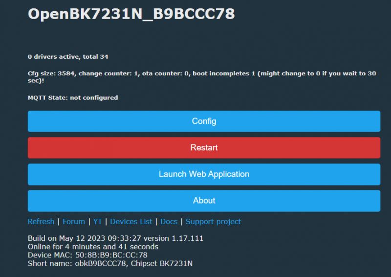

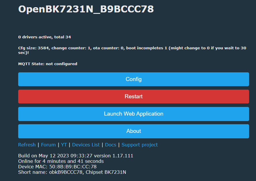

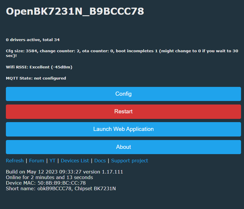

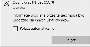

    After uploading the OBK we are greeted by the OBK access point and web panel:
    WiFi network connection window for OpenBK7231N_B9BCCC78 .
    Screenshot of the OpenBeken interface with configuration buttons. .
    Only then should the module be soldered in place:
    Internal layout of the S1TW-FR device with visible CB3S module CB3S module mounted on a circuit board. Close-up of a CB3S module on a circuit board with black and red wires. WiFi module CB3S on a printed circuit board of an electronic device. .

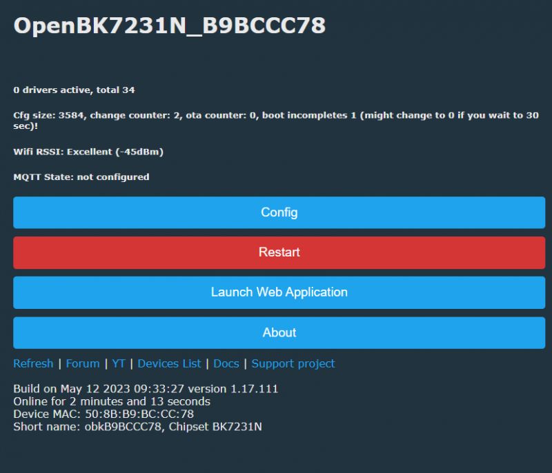

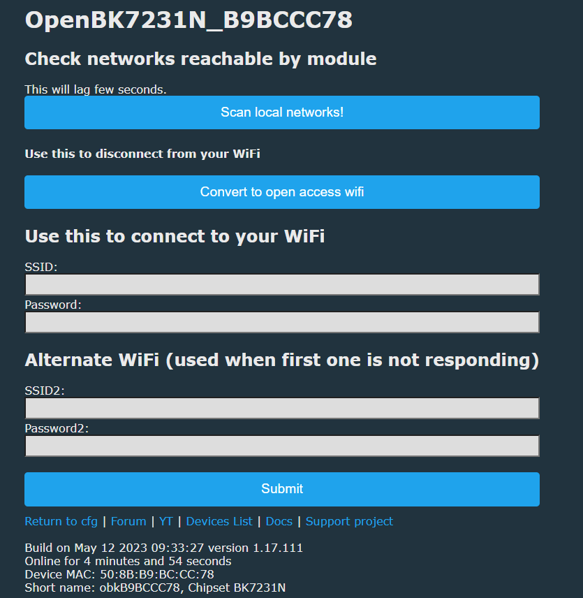

    First, of course, we set up our WiFi data:
    OpenBK7231N configuration panel with WiFi network options .
    Then only we will configure the TuyaMCU.
    OpenBeken configuration panel for BK7231N module .

    So far, however, the screen is stuck on startup:
    Energy meter display with electrical socket and buttons. .
    Let's write the first, minimal autoexec.bat needed for the screen to respond. You need to run the TuyaMCU driver and force WiFi state 0x04 (we simulate connecting to the cloud this way):
    startDriver TuyaMCU
    tuyaMCU_defWiFiState 4
    Result:
    ATORCH electric energy meter display with temperature and voltage data .
    Now it is time to read the voltage, current and power. Thanks to the UART packet capture performed earlier, we know under which dpID these values are hidden.
    TuyaMCU Explorer interface for UART data analysis. .
    We enter these into our script and map the dpID to the channels.
    startDriver TuyaMCU
    // channel types
    setChannelType 2 Voltage_div100
    setChannelType 3 Current_div1000
    setChannelType 4 Power_div10
    // linkTuyaMCUOutputToChannel dpId verType tgChannel
    // voltage
    linkTuyaMCUOutputToChannel 110 val 2
    // current
    linkTuyaMCUOutputToChannel 108 val 3
    // power
    linkTuyaMCUOutputToChannel 109 val 4
    // NOTE: test code only so I can refresh quickly without restarting
    tuyaMcu_sendQueryState
    In addition, I added a one-time tuyaMcu_sendQueryState to the script in order to get the measurements faster. This is a prompt call for TuyaMCU to share its state with us.

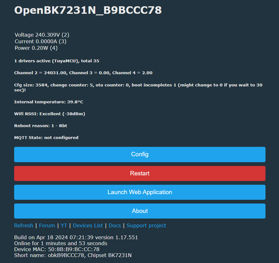

    Here is the result - it looks ok, although I guess the power needs improvement?
    OpenBeken user interface on WiFi configuration screen

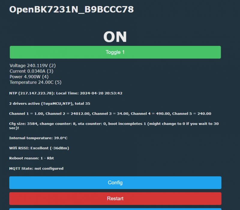

    Here is the result after running the above script:
    OpenBeken screen displaying device measurement data .

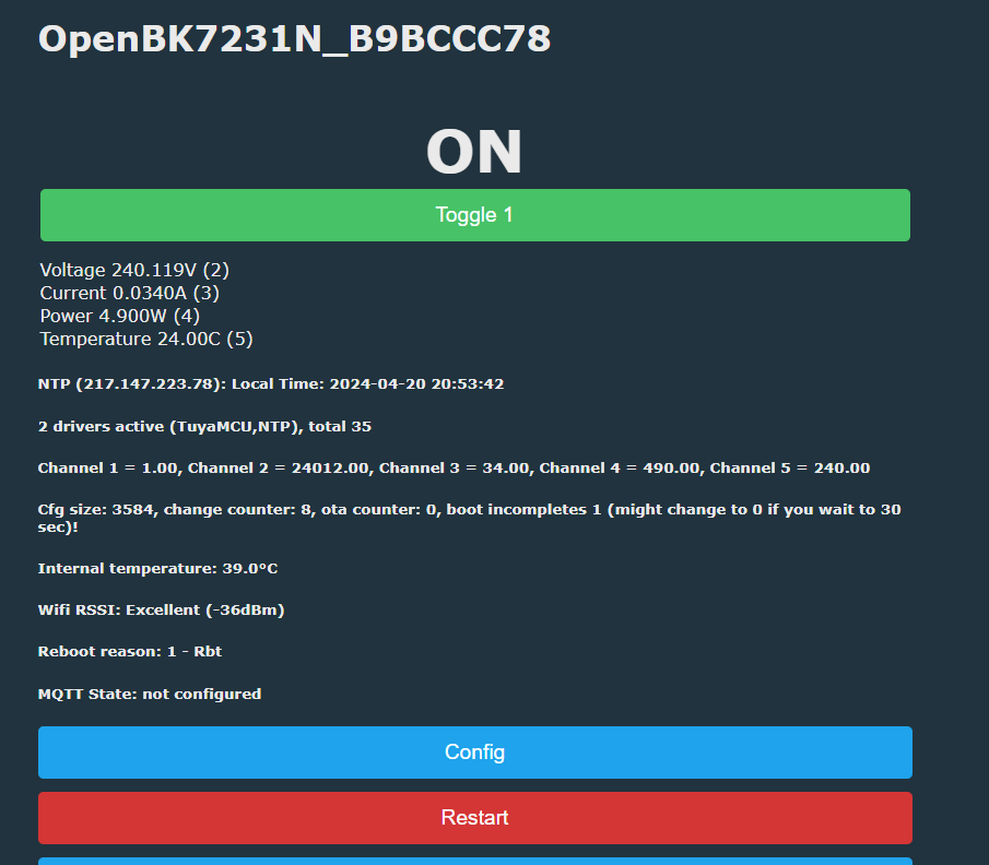

    Here is the result, the temperature on the OBK panel:
    Control panel screen for OpenBeken displaying voltage, current, power, and temperature readings. .

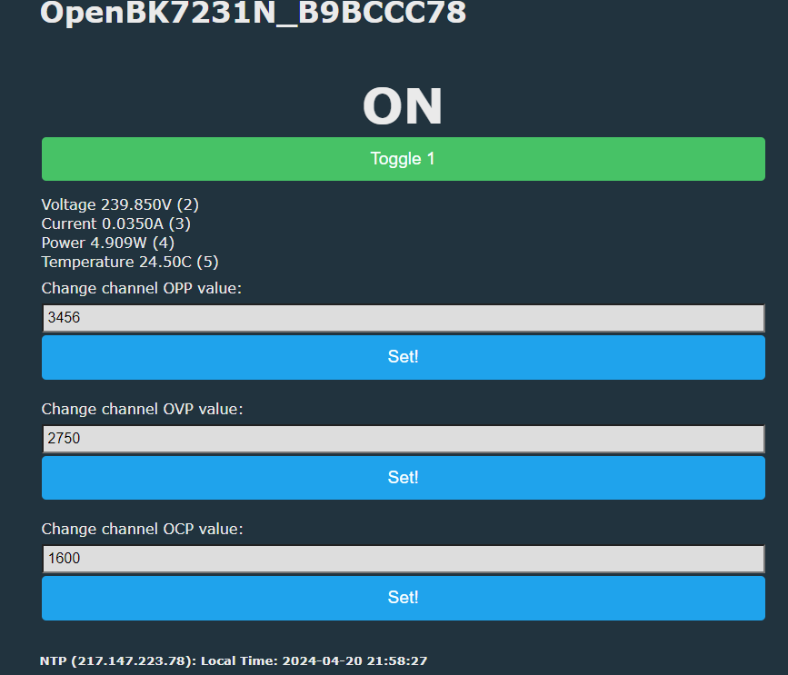

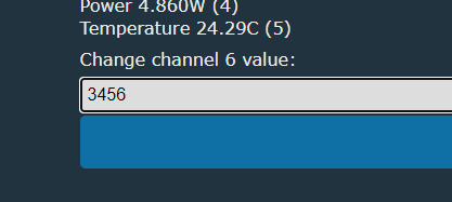

    In this case the communication works both ways, we can also enter a different value here ourselves and change the maximum power value.
    OpenBK7231N interface with toggle switch on. .
    Once entered, the device responds correctly:
    OpenBeken channel value configuration screen.
    The new value is on the display:
    Display of an advanced energy meter with temperature and power data .
    An analogy can be made for OVP and OCP:
    startDriver TuyaMCU
    startDriver NTP
    // channel types
    setChannelType 1 Toggle
    setChannelType 4 Power_div100
    setChannelType 5 Temperature_div10
    setChannelType 6 TextField
    setChannelLabel 6 OPP
    setChannelType 7 TextField
    setChannelLabel 7 OVP
    setChannelType 8 TextField
    setChannelLabel  8 OCP
    // toggle
    linkTuyaMCUOutputToChannel 103 bool 1
    // voltage
    // current
    // power
    // temperature
    linkTuyaMCUOutputToChannel 102 val 5
    // OPP max power (limit)
    linkTuyaMCUOutputToChannel 115 val 6
    // OVP
    linkTuyaMCUOutputToChannel 113 val 7
    // OCP
    linkTuyaMCUOutputToChannel 114 val 8
    Here are the new text fields:
    OpenBeken control panel with current measurements and setting change options. .
    The child lock function, which is to protect the panel from the child, is in turn specified by a boolean type variable, so a toggle is useful here too, just like for the relay:
    startDriver TuyaMCU
    startDriver NTP
    // channel types
    setChannelType 9 Toggle
    setChannelLabel 9 ChildLock
    // toggle
    // voltage
    // current
    // power
    // temperature
    // OVP
    // OCP
    // child lock
    linkTuyaMCUOutputToChannel 116 bool 9
    This allows us to control the child lock function. When changed on the OBK panel, the padlock on the device screen also changes:
    OpenBeken configuration panel with thermostat and energy meter settings .
    This device offers temperature calibration on the side of the MCU itself. This is also where the text box comes in handy:

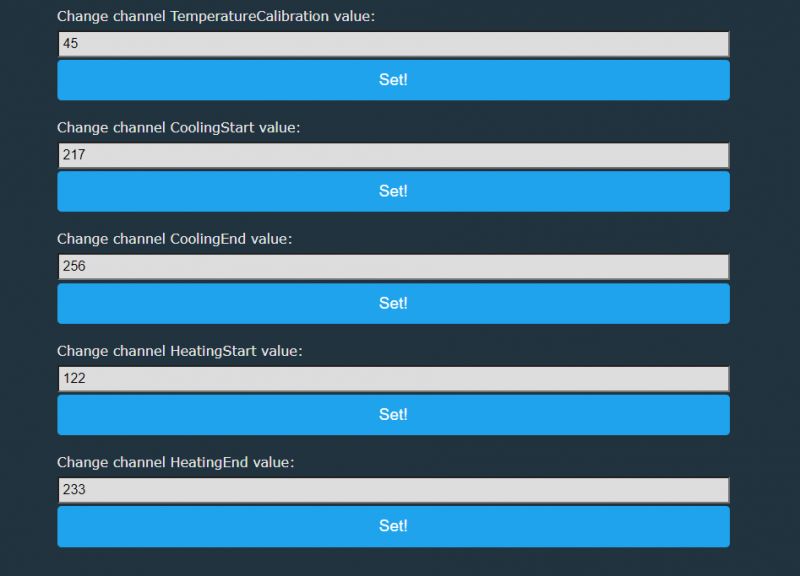

    Result:
    OCP and Temperature Calibration settings in the configuration panel .
    It is worth remembering that a simple text field does not multiply, so the 45 entered is 4.5°C.
    Similarly, you can add fields for thermostat settings, i.e. heating start, heating end, cooling start, cooling end fields.
    setChannelType 10 TextField
    setChannelLabel 10 TemperatureCalibration
    setChannelType 11 TextField
    setChannelLabel 11 CoolingStart
    setChannelType 12 TextField
    setChannelLabel 12 CoolingEnd
    setChannelType 13 TextField
    setChannelLabel 13 HeatingStart
    setChannelType 14 TextField
    setChannelLabel 14 HeatingEnd
    // toggle
    // voltage
    // current
    // power
    // temperature
    // OVP
    // OCP
    // child lock
    // temperature calibration
    linkTuyaMCUOutputToChannel 117 val 10
    // CoolingStart
    linkTuyaMCUOutputToChannel 105 val 11
    // CoolingEnd
    linkTuyaMCUOutputToChannel 107 val 12
    // HeatingStart
    linkTuyaMCUOutputToChannel 104 val 13
    // HeatingEnd
    linkTuyaMCUOutputToChannel 106 val 14
    Additional fields on the web panel.
    Temperature settings interface with editable fields.
    The choice of operating mode (normal, heating, cooling) is determined for us by a variable of type enum. You will have to do a bit of fiddling to display it. Of course, it could be displayed as a number, but what for? Better to add separate buttons with nice captions. To do this, we'll use the HTTPButtons driver and add a listen for changes to the channel selected for that mode (addChangeHandler) so that we can manipulate the button colours accordingly and show them which mode is on:
    startDriver TuyaMCU
    startDriver NTP
    // channel types
    setChannelType 15 ReadOnly
    setChannelLabel 15 Mode
    // toggle
    // voltage
    // current
    // power
    // temperature
    // OVP
    // OCP
    // child lock
    // CoolingStart
    // CoolingEnd
    // HeatingStart
    // HeatingEnd
    // mode
    /// 0 is manual
    // 1 is heating
    // 2 is cooling
    linkTuyaMCUOutputToChannel 101 val 15
    startDriver HTTPButtons
    setButtonEnabled 0 1
    setButtonEnabled 1 1
    setButtonEnabled 2 1
    setButtonLabel 0 Manual
    setButtonLabel 1 Heating
    setButtonLabel 2 Cooling
    setButtonCommand 0 "setChannel 15 0"
    setButtonCommand 1 "setChannel 15 1"
    setButtonCommand 2 "setChannel 15 2"
    alias clear_buttons backlog setButtonColor 0 red;setButtonColor 1 red;setButtonColor 2 red
    clear_buttons
    addChangeHandler Channel15 == 0 backlog clear_buttons ; setButtonColor 0 green
    addChangeHandler Channel15 == 1 backlog clear_buttons ; setButtonColor 1 green
    addChangeHandler Channel15 == 2 backlog clear_buttons ; setButtonColor 2 green
    Here is the result on the OBK panel:
    OpenBeken user interface with colorful buttons for different modes. .
    The buttons are visually appealing and responsive:
    Control panel with Manual, Heating, and Cooling modes in OpenBeken app .
    Interestingly, when I set, for example, Heating, and then change the relay status at the very top of the OBK page, the unit itself returns to Manual. Everything works!

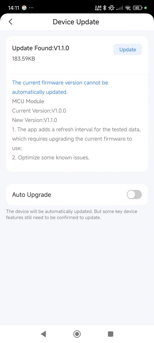

    If the TuyaMCU (CH537F) is a lower version than 1.1.0, the Tuya app will offer an update.
    I attach the OTA binary the Tuya app downloads to update the MCU - for anyone that might find this interesting.
    Screenshot of a firmware update window displaying information about a new MCU version (V1.1.0).
    • Atorch_S1TW-FR_MCU_1.1.0_WCH_CH573F.bin (183.59 KB) You must be logged in to download this attachment.

    And here is firmware dump of the described device (before pairing):
    https://github.com/openshwprojects/FlashDumps/commit/46d6a6584563a567d0cd32b849ab2a96c7972d34
    If you have a Tuya developer account and want to share dpIDs extracted with this method, feel free to do so.

    But what does a "cooling" dpID mean anyway?
    It's one of possible options of operation mode enumeration mentioned in the main article. The following device has 3 supported modes:
    - manual (called "socket")
    - cooling
    - heating

  • The thermostat-related Celsius setpoints use integer values scaled by ×10, so 21.7 °C, 25.6 °C, 12.3 °C, and 23.3 °C appear as raw numeric writes. [#21313613]
  • Protection and control values shown in testing include OVP 265→275 V, OCP 10→16 A, OPP 3000→3680 W, and temperature calibration 0→4.5 °C. [#21313613]

How do I read voltage, current, power, relay state, and temperature from the S1TW-FR in OpenBeken using the correct dpIDs?
Map the known dpIDs to typed OpenBeken channels and use the right scale helpers. The working set shown is relay 103 bool, voltage 110 val, current 108 val, power 109 val, and temperature 102 val. The author uses Voltage_div100, Current_div1000, Power_div100, and Temperature_div10, then calls tuyaMcu_sendQueryState to refresh values quickly. That produces live readings in the OBK panel and keeps the device display consistent. [#21313613]
