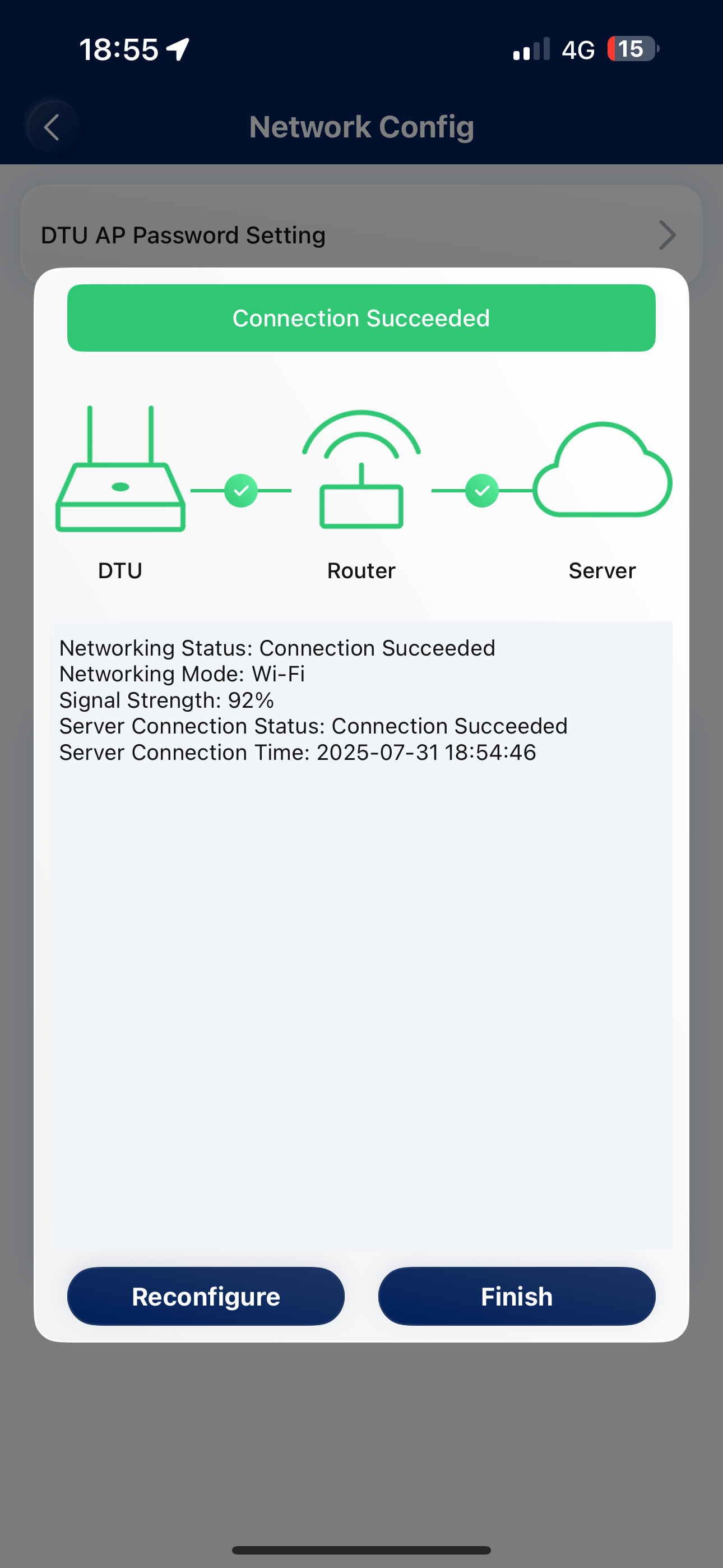

    richymx
    >>21625916
    I followed the instructions to the “t”, the DTU is properly connected to the WiFi, with flashing green lights and no more than 15 meters away from the micro inverters.
    When I used the installer app in guest mode like I mentioned, I got the DTU communicating with the micro inverters for exactly 30 minutes, I feel the problem lies in the plant being configured before the DTU went online so the configuration hasn’t properly been uploaded to the s-miles cloud.

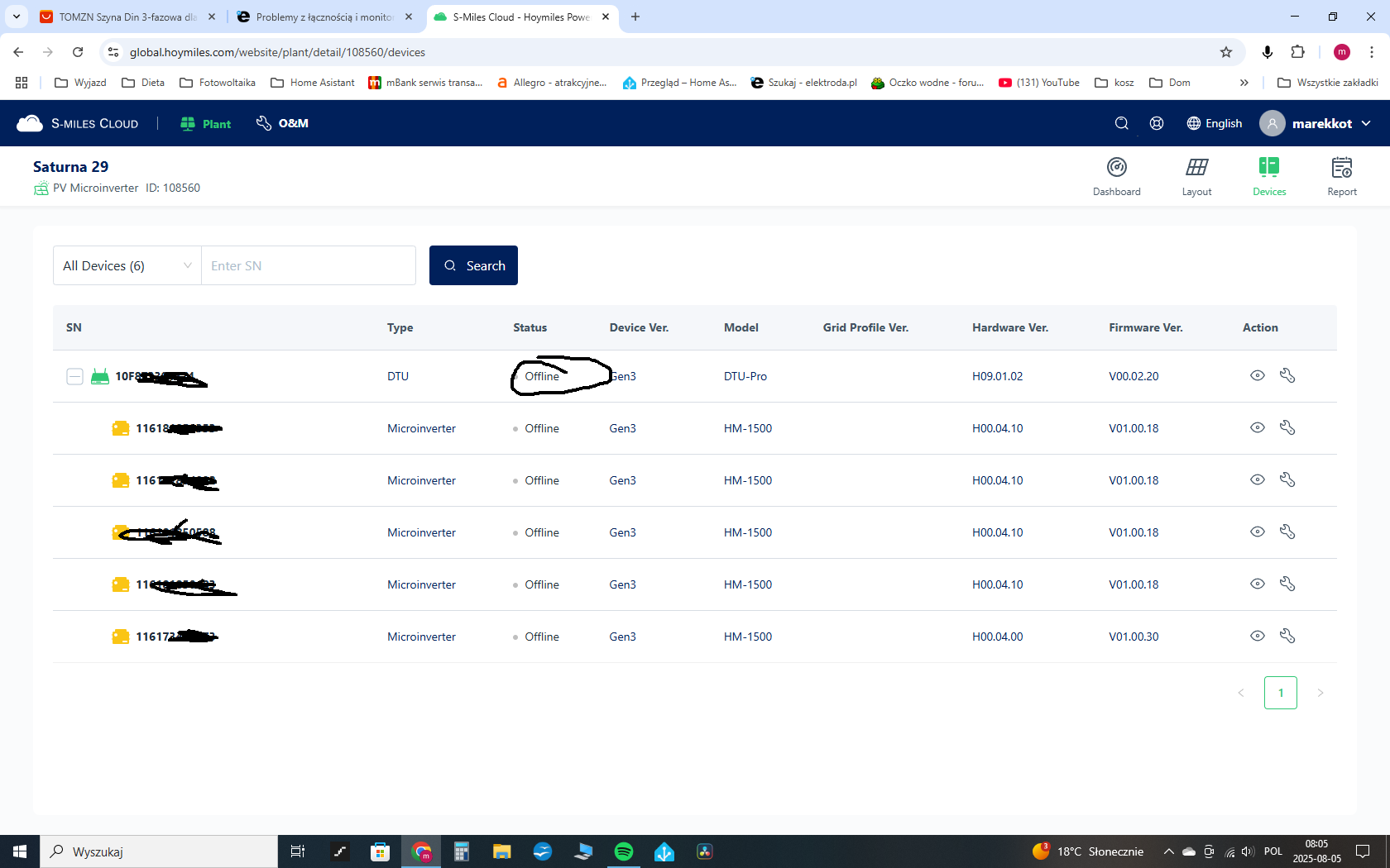

  • #6 21626235
    kmarkot
    Posts: 1376
    Help: 127
    Rate: 361
    I'll ask again if the devices are added to the S-miles account?
    And are they in the list of devices?
    Device list in Hoymiles system with all statuses marked as “Offline” .
    what is the status of the devices ?

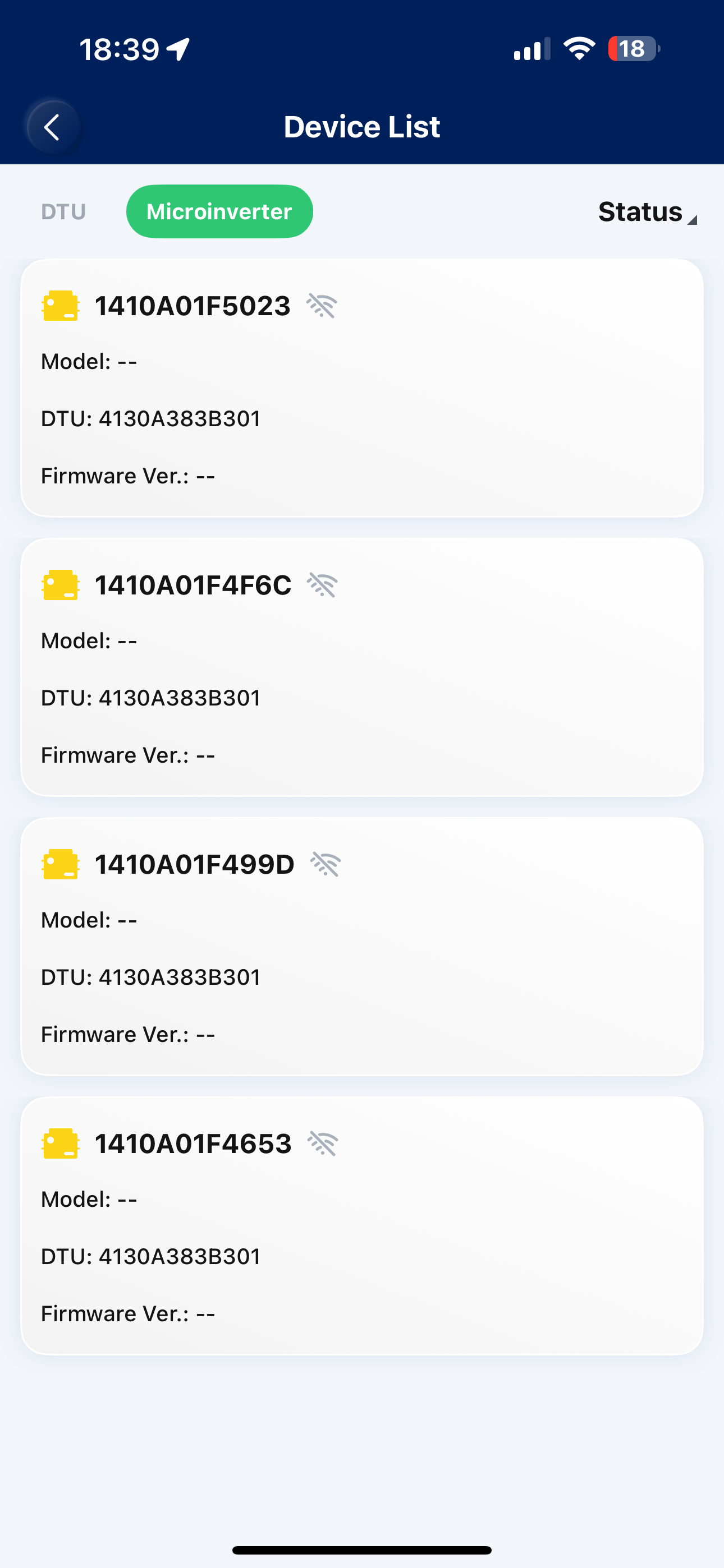

  • #7 21626721
    richymx
    >>21626235
    Yes, the devices were added to the plant, here’s the picture of the plant details, all serial numbers are verified correct.
    List of microinverters with serial numbers and no connection signal
    Network configuration screen showing “Connection Succeeded” and connection details
