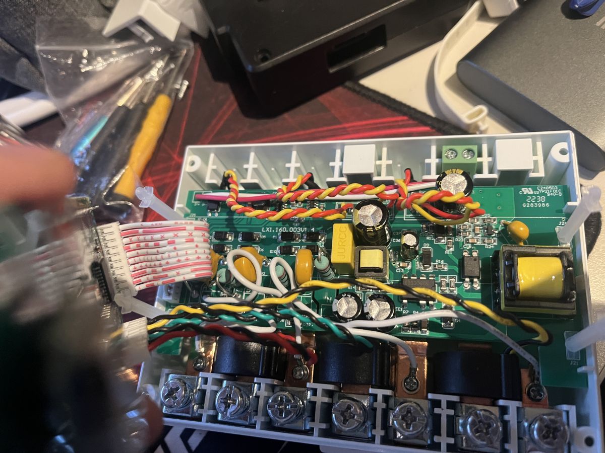

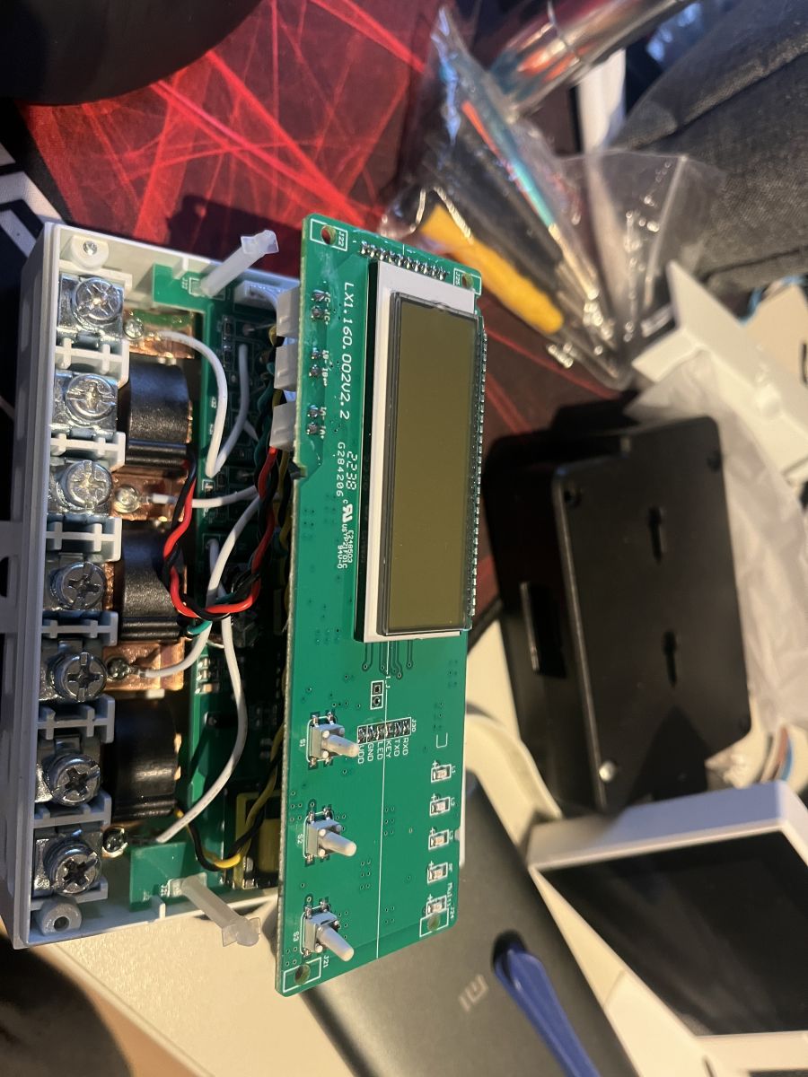

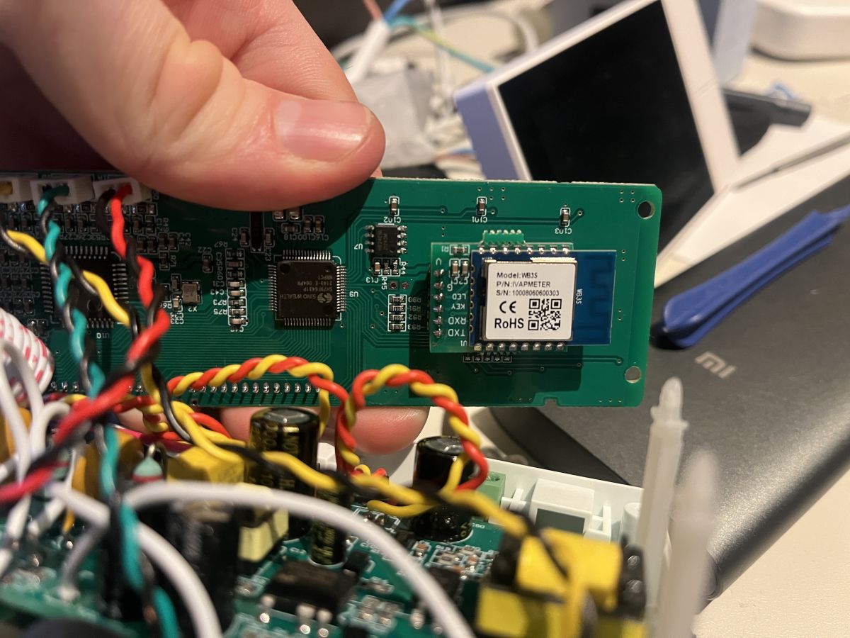

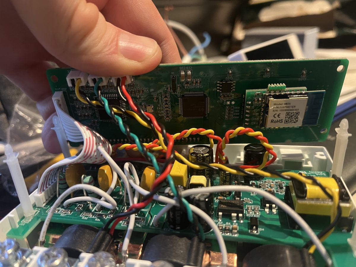

    My device is a 3Phase Hiking Tomzn Power Meter DTS238-7, very similar to all tomzn devices posted here. No matter the value I insert on tuyaMcu_defWiFiState (0,1,2,3,4,5), the health check will always say:
    "ExtraDebug:TuyaMCU:TuyaMCU heartbeat_valid = 1, product_information_valid=1, self_processing_mode = 0, wifi_state_valid = 0, wifi_state_timer=0"
    I have run out of options by now and I really don't know what else to do.
    Some interesting facts that may or may not be relevant:
    1) when this device connects to the WiFi, a blue LED will blink or be fixed on the top right of the device, but this never happens
    2) the device IS connected to the WiFi network, even connects to MQTT if needed
    3) tried wiping all the config several times, even removing the WiFi config, but no luck
    4) tried going to ESPHome and then back, but no luck
    The reason for all this is that the device is sending bogus data on dpid 6,7 and 8 (the dpids that have the voltage, current and power readings), and I read that these tuya devices need to believe that they're connected to start sending real data (just FYI: the device readings on the device screen are fine, the problem is on the readings of the TuyaMCU chip)
    Is there any way of flashing these devices completely from zero via the web? like flashing all partitions and starting from a clean slate. I don't have any tools to flash via pins

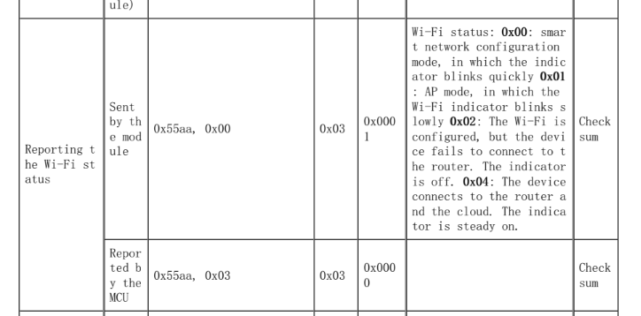

    Have you tried running tuyaMcu_defWiFiState at runtime? Maybe you are assigning this command before you start the TuyaMCU driver?
    Have you tried playing around with other commands, like tuyaMcu_sendRSSI?

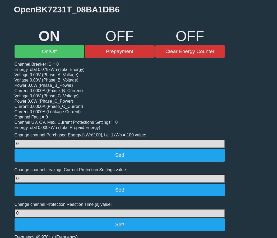

    DPId 6,7 and 8 have the exact same length and those 3 come raw along 17 and 18 (which are alarms). Exactly the same as the TOMZN TOMPD-63-LW, but instead of monitoring 1 phase, it monitors 3 (dpid 6,7 and 8)
    I say that there's bogus data since the values in DP Id 6 (the one I have connected right now) doesn't show anything (see image). While I see values in the device display
    [url=https://obrazki.elektroda.pl/1938128000_1714948615.png]View of the MGF-T3-SMART electrical meter with a display showing a value of 232.7 V.
    OpenBK7231T user interface with buttons and energy statistics.[/url]
    I also tried to set up tuyaMcu_defWiFiState at runtime, here are the results (still wifi_state_valid = 0):
    Debug:CMD:cmd [tuyaMcu_defWiFiState 4]
    Info:CMD:[WebApp Cmd 'tuyaMcu_defWiFiState 4' Result] OK
    ExtraDebug:TuyaMCU:Will send TUYA_CMD_WIFI_STATE.
    Info:MAIN:Time 1004, idle 246071/s, free 76344, MQTT 0(63), bWifi 1, secondsWithNoPing 940, socks 3/38
    Info:MAIN:Time 1005, idle 243041/s, free 76576, MQTT 0(63), bWifi 1, secondsWithNoPing 941, socks 2/38
    Info:TuyaMCU:Received: 55 AA 03 00 00 01 01 04
    Info:TuyaMCU:ProcessIncoming[v=3]: cmd 0 (Hearbeat) len 8
    Info:MAIN:Time 1006, idle 492100/s, free 76576, MQTT 0(63), bWifi 1, secondsWithNoPing 942, socks 2/38
    Info:MAIN:Time 1007, idle 247245/s, free 76576, MQTT 0(63), bWifi 1, secondsWithNoPing 943, socks 2/38
    Info:MAIN:Time 1008, idle 244760/s, free 76344, MQTT 0(63), bWifi 1, secondsWithNoPing 944, socks 3/38
    Info:MAIN:Time 1009, idle 241695/s, free 76576, MQTT 0(63), bWifi 1, secondsWithNoPing 945, socks 2/38
    Info:MAIN:Time 1010, idle 248586/s, free 76576, MQTT 0(63), bWifi 1, secondsWithNoPing 946, socks 2/38

    Anyone that can lend me a hand here about what could be the next steps? I'm now wondering if flashing the bin file in https://www.elektroda.com/rtvforum/topic3928897.html might restore any functionality? BTW: I flashed ESPHome to the device and the wifi light is not working either, so I came back to OpenBeken.
    Pictures of disassembly below:
    Image of the interior of an electronic device with a circuit board and LCD screen. Main circuit board of an electronic device with connected cables. Image showing a disassembled electronic device with a visible circuit board and wires. Interior of an electronic device with a visible circuit board and components. The image shows an electronic circuit board with connected wires and a module labeled as VMS Model.

  • #9 21081636
    Posts: 14770
    Rate: 12913
    Do you have manual for this device? How does one put it into pair mode with Tuya firmware?
    Maybe you need to press some buttons or hold them so it first starts the pair procedure and then fake the pairing in OBK?
  • Original Tuya pairing uses down button and blue light

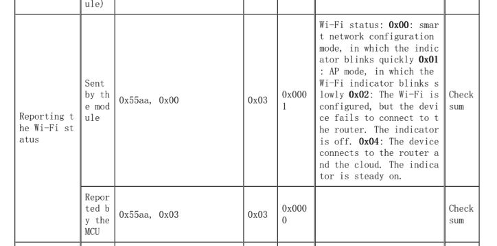

    #12 21094089
    Posts: 14770
    Rate: 12913
    Are you really sure you didn't enable tmSensor by accident?
    That pdf is normal TuyaMCU, it says it should support 0x03:
    Fragment of a communication instruction table for TuyaMCU, including Wi-Fi status information.
    Maybe try manually calling tuyaMcu_sendCmd 0x03 04?
    Or do:
     uartSendHex 55AA000300010407
    which is the same as the other command I shown.
    If you search for it, you can read that it helped people:
    https://www.elektroda.com/rtvforum/find.php?q=55AA000300010407

    paoliniluis
    Level 4  
    Posts: 17
    A few things I discovered while sending uartSendHex commands: the device believes it's in AP mode even if the device is already connected to the WiFi without any problem:
    Info:MAIN:Time 531, idle 249266/s, free 77696, MQTT 1(1), bWiFi 1, secondsWithNoPing 462, socks 3/38
    ExtraDebug:TuyaMCU:TuyaMCU heartbeat_valid = 1, product_information_valid=1, self_processing_mode = 0, WiFi_state_valid = 0, WiFi_state_timer=0
    Info:MAIN:Time 532, idle 253079/s, free 77912, MQTT 1(1), bWiFi 1, secondsWithNoPing 463, socks 2/38
    Info:MAIN:Time 533, idle 252139/s, free 77912, MQTT 1(1), bWiFi 1, secondsWithNoPing 464, socks 2/38
    Info:TuyaMCU:ProcessIncoming[v=3]: cmd 0 (Heartbeat) len 8
    I sent uartSendHex 55AA0005000004 (check if it's in smart network config or AP mode), and it replies with 55 AA 03 00 00 01 01 04 (AP mode)
    sending a uartSendHex 55AA000300010407 makes no difference, the device stays in WiFi_state_valid = 0, and won't provide any valid data in that state
    it's wild that the device is connected to the wireless network, with an IP and everything, but it still believes that it's in AP mode.
    any other idea? BTW: I tested basically everything on the document, but there's one that I can't make it work which is "resetting the WiFi"; I send fakeTuyaPacket 55AA0304000006 but it replies with
    Debug:CMD:cmd [fakeTuyaPacket 55AA0304000006]
    Info:TuyaMCU:ProcessIncoming[v=3]: cmd 4 (WiFiReset) len 7
    Info:TuyaMCU:ProcessIncoming: unhandled type 4
    Info:CMD:[WebApp Cmd 'fakeTuyaPacket 55AA0304000006' Result] OK
    I don't know what the "unhandled type 4 means"

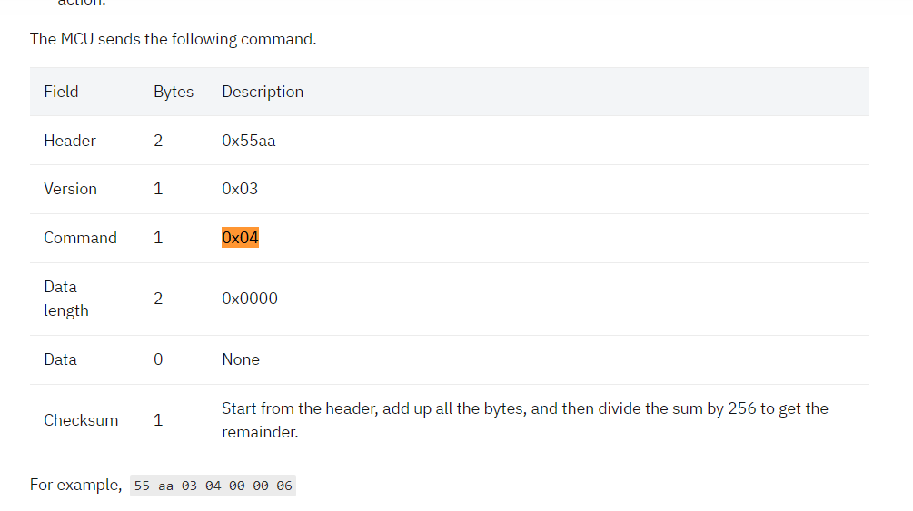

    Posts: 14770
    Rate: 12913
    Btw, are you doing full power off and power on cycle between autoexec.bat changes? It seems to be important, I've just had another user saying that was the cause of his problems...
    Your logs indicate that packet 0x04 is not handled by OBK, let's look it up...
    Screenshot of an MCU command table with command 0x04 highlighted.
    Let me try adding it....
    https://github.com/openshwprojects/OpenBK7231...mmit/041e316cf51d13b0e48409e720f474d228e606a1
    Wait for build, do OTA and try again.
  • wifi_state_valid stays 0 after WiFiReset packet

  • #16 21101029
    Posts: 14770
    Rate: 12913
    And requesting dpIDs (with query state) still yields no useful data?
  • #17 21437858
    paoliniluis
    Level 4  
    Posts: 17
    The light needed to be on for the device to report the data
  • #18 21437864
