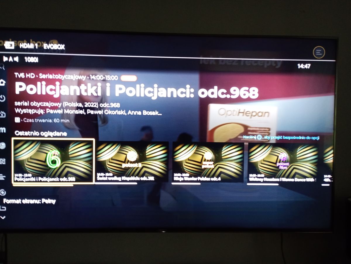

  • #43 21629475
    KAROL19766
    Posts: 218
    Help: 5
    Rate: 37
    Since yesterday they have changed something and now every time I turn on the decoder this shit appears .... How to turn it off . I do not know if it is because of their update ????
    Set-top box interface showing episode info for “Policjantki i Policjanci”
  • #44 21629663
    netTv
    Level 32  
    Posts: 1462
    Help: 193
    Rate: 579
    This is not an option.
