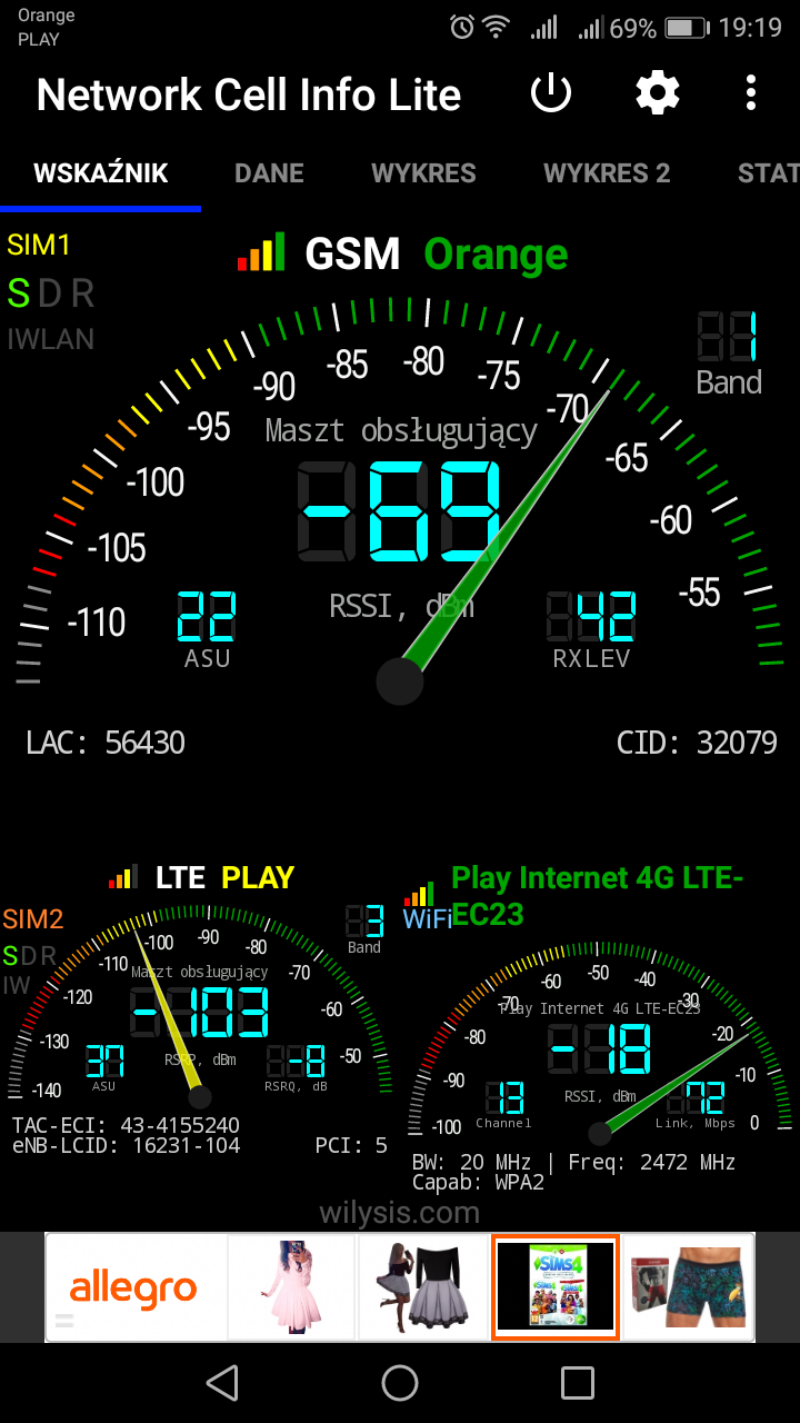

    Please help. When I picked up the phone in Play, I got "free" internet. The lady in the living room suggested an Alcatel link zone router. I mainly care about wifi. The internet is very slow. I did the speed test, but I don't know if it is used for wifi at all. Currently, I also use the Internet from Orange with Huawei 3372 and the antenna from cybertech and the results are about 10 mbps. My contract is ending soon and I'm not going to extend it. I was hoping that the one from Play would be enough. My location is 78-600 Wałcz Ul. Przedmiejska, unfortunately I live on the ground floor. Please. For help
    • Improving Internet Speed in Play with Alcatel Link Zone Router: User Experience Screenshot_20171229-181756.png (149.03 KB) You must be logged in to download this attachment.

    The speed of the internet changes at the window? What range does Play catch in your place of residence?

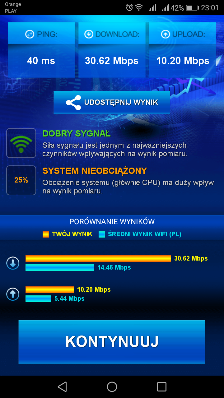

    Similar data next to the window. I also took a screenshot from another application. I'm only interested in play, I want to quit from Orange. I was still thinking about buying another mobile device.

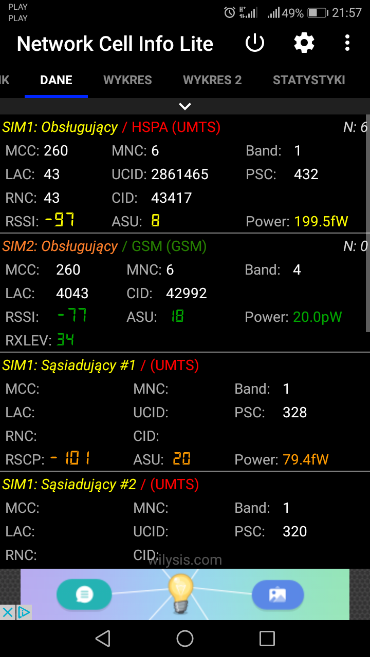

    Thank you for your answer, I have 2 cards in my phone, Play is a SIM 2 card. Unfortunately, my husband was subscribed to the company in November, so I can't give Alcatel back. I would like to buy a mobile router, e.g. huawei e5785 (is it ok?) Is what in the attachment is enough? Dot SIM 2

    Connection with LTE1800 on BTS Play na Młynie. Signal parameters poor but good SINR, so the sector is not overloaded, what the speeds look like, make a speedtest and show the result. Also show the test when the phone is outside the window. Why mobile MiFi and what budget?

    As I wrote in Play, the internet was like an addition to 2 phone calls per company. I didn't buy it on purpose. After my adventures in Orange (here, fortunately, I got advice about buying an antenna from cybertech and somehow almost 2 years passed). Alcatel is my mistake. But I can always sell it and buy Huawei
    Added after 4 [minutes]:
    Both measurements are taken on the phone, in the Huawei e3372 (bought from Play) there is only the Orange card (connected to the cybertech antenna)

    Off the topic, I was shocked when I did the speed test with Orange (Huawei e3372 + cybertech antenna). I think something has improved.
