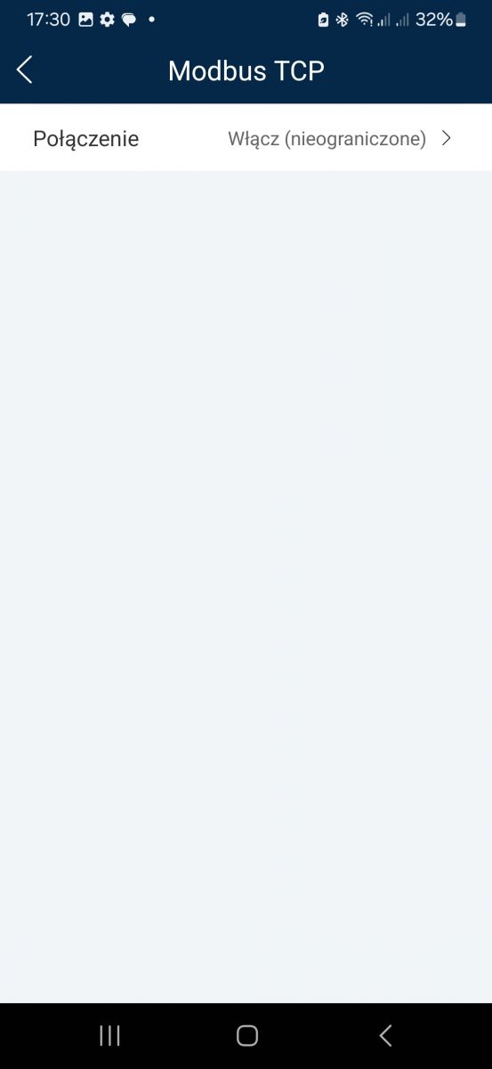

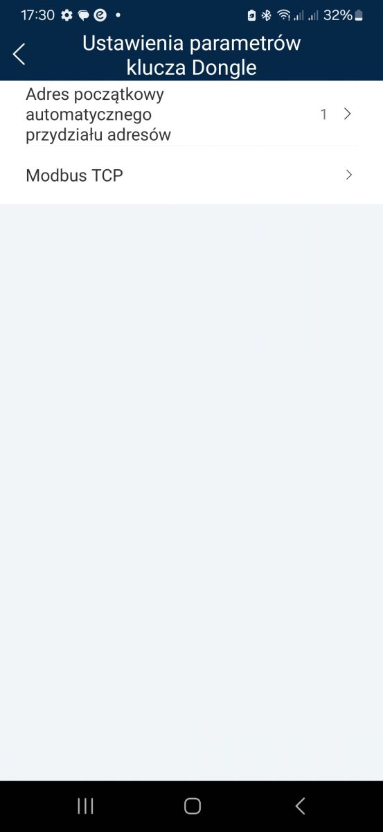

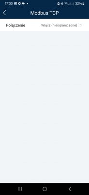

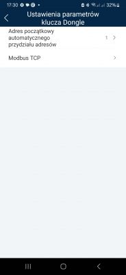

    #65 21391501
    kwlp
    Posts: 35
    Rate: 16
    And to me it does not read :( What am I doing wrong. Currently Dongle V100R001C00SPC116, I have the installer access and I don't know if I changed the alu correctly here:
    Screenshot showing Dongle key parameter settings on a phone..
    Modbus TCP app screen showing buttons Połączenie and Włącz (nieograniczone)..
    and now I add in the HA integration, enter the IP Dongle, port 502 or 6607, ID:1
    and unfortunately it does not connect. What am I doing wrong ?
  • #66 21391737
    pinelesss
    Posts: 20
    mate, not in Dong's settings, but in the inverter settings you need to enter. Network SUN.... >>21391501 >>21391501
  • #67 21417847
    kwlp
    Posts: 35
    Rate: 16
    It worked, however, I had to update the dongle.

  • #69 21855102
    kwlp
    Posts: 35
    Rate: 16
    Actually, I can't remember anymore, but as I wrote. You need to connect to the inverter, not the dongle, and update it, because with the older version it actually didn't work. And after logging into the inverter, enable modbus. That's all
